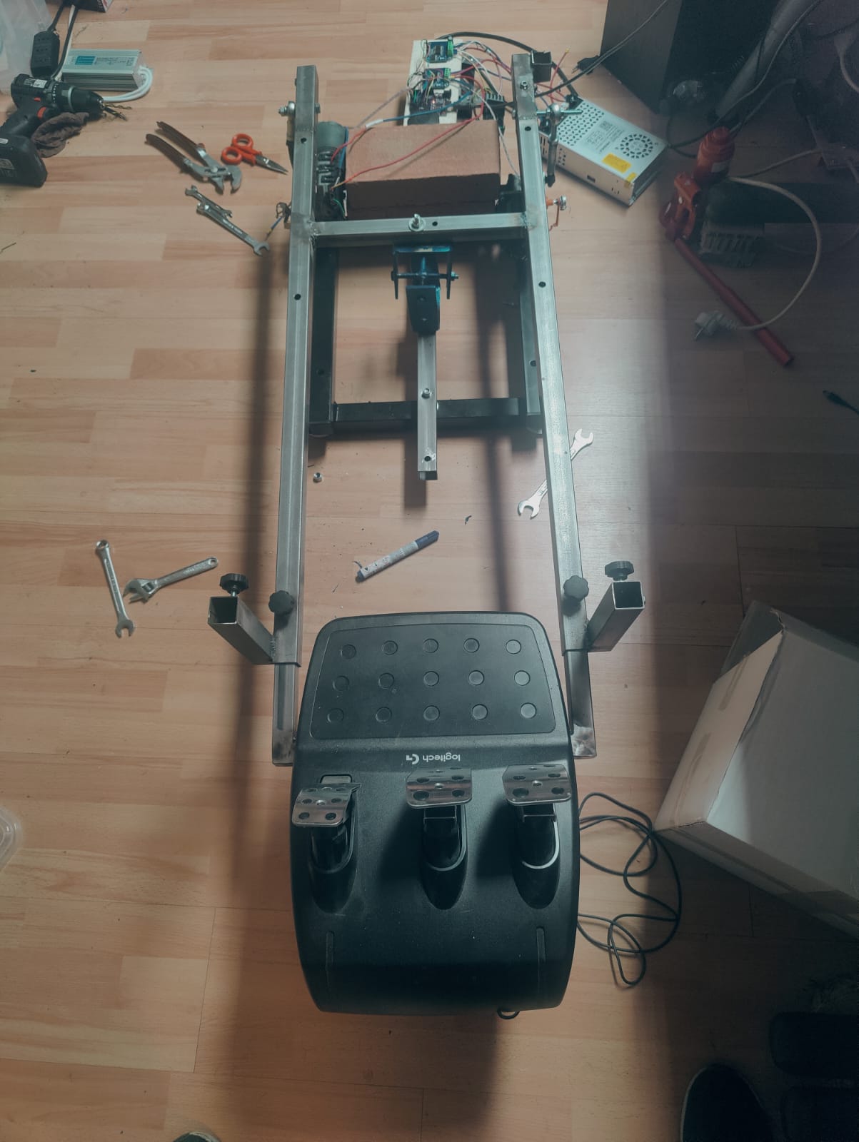

    Update: quite disappointed. I have set up all system, everything working all right until I add some weight - pedals and wheel. After this, motors aren't able to move the system reliably. One of the two, especially, cannot pull the seat (it can push it all right though), and after a while the motor driver shuts off perhaps due to overheating, even if it feels not that hot to the touch. Too bad, I really thought those two motors were big enough to be able to move the whole system. Might there be anything I overlooked?
    21,592
    151,215Coins
    Can you please post some pictures of your rig, so we can get an idea of design and possibly related issues.

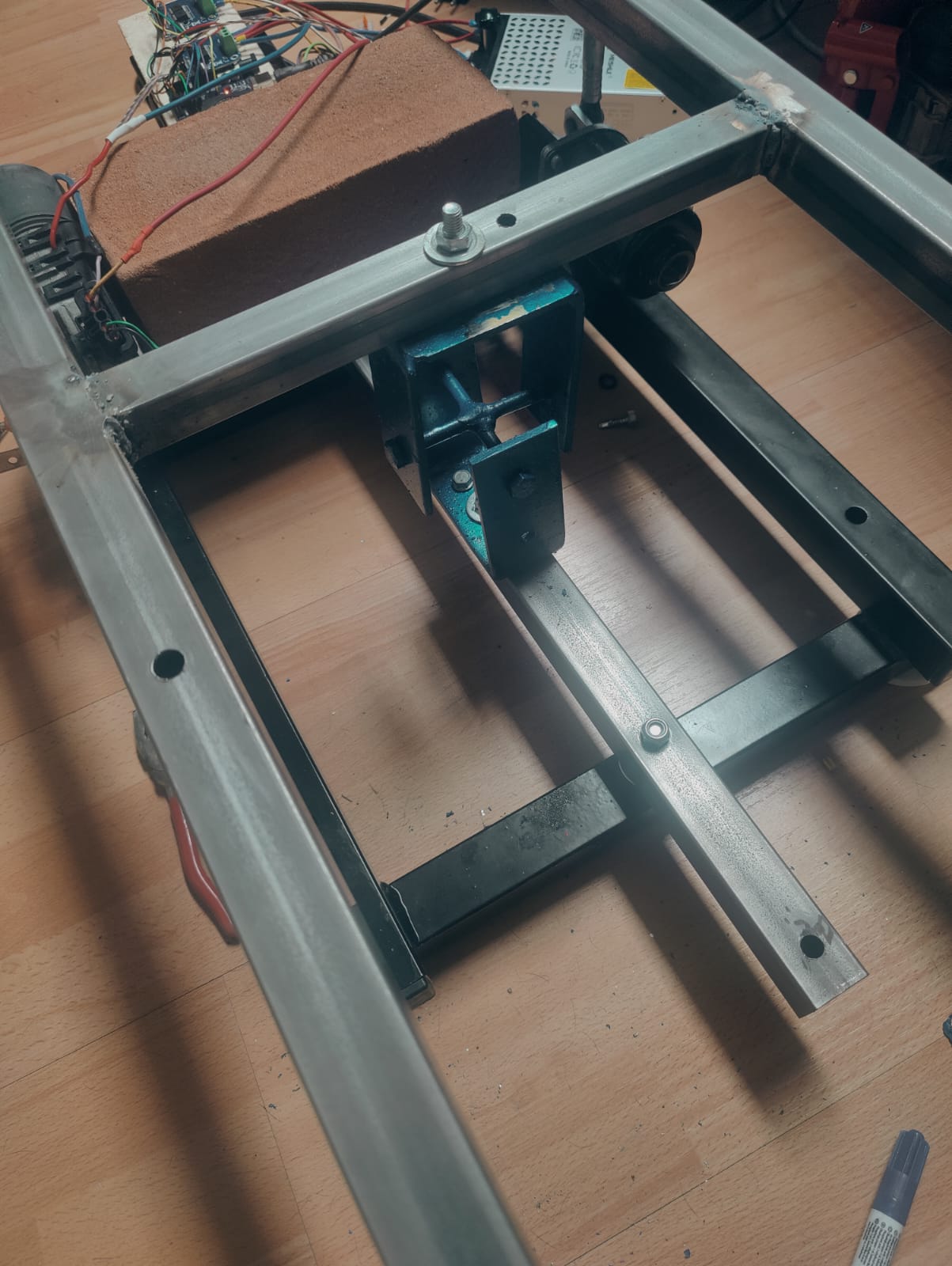

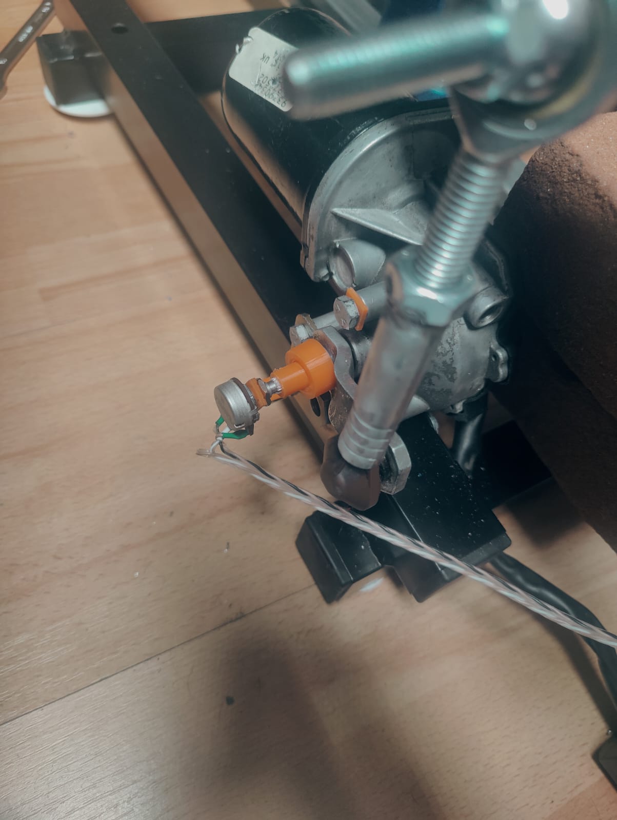

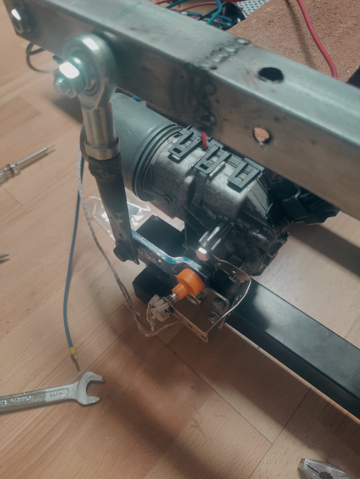

    of course, here they are:
    Self-made U-joint:
    First motor:
    Second motor:

    UPDATE of the update: apparently there is a better wiring option for my first motor. When removing the shell connection, I used the remaining two wires, which gave the highest speed but apparently not the highest torque. I then decided to extract the third pole of the motor and I test it, thus obtaining lower speed but seemingly higher force. Now it seems to behave better. Will try the same trick with the other motor as well. I'll keep you updated.

    As per my earlier advice, when using wiper motors, which are not very powerful, you need to have a lot of inherent design leverage, by that I mean the motors being placed the furthest from the pivot point as possible.

    Yep, I have done that, according to the physical limits set by my steel frame... But now, after playing around with motor pins, the situation has much improved, even if from time to time one of the two drivers still shuts down after a while... I still have to find out why...
