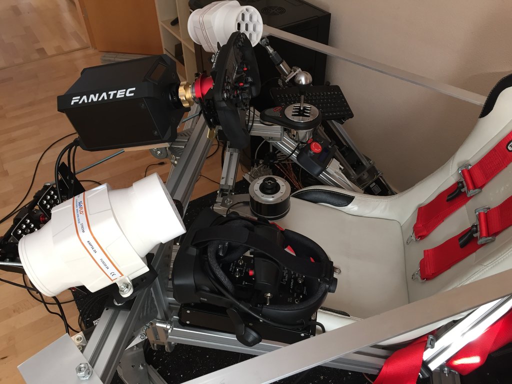

    i wanna proudly show you my new 6DOF Rig, which I have just "finished". It's working really nice for now, but of course in Future, i will be optimise more and more. I kept the Actuators simple, to get an easy start.
    I needed a startpoint, to get Experience. Maybe later, i will go for more crazy Actuators. In this Thread i will keep you updated.
    Before i get to details... it's highly important to me to thank you all. I wanna thank the Forum so much. Without the Forum, it would have been simply impossible for me to build such a great Rig. I would like to mention @noorbeast by Name. Your tireless help, for ALL here, is just insane and actually cannot be praised strongly enough. really....
    To my Rig: My technical Possibilities are very limited. I have little technical Equipment and not even a Workshop. That is the Reason why I have chosen this Profilesystem. This also meant that I didn't have to weld.
    In the last Second of Planning, i changed from 24V Brushed Motors to Servos. And this was the best Thing (in my opinion) i could do.
    I use like many others the typical AASD Servos and this awesome Motion Controller:
    https://www.xsimulator.net/community/threads/new-6dof-aasd15-servo-motion-controller.15356/
    Thankfully Noorbeast again has shown me :)
    The Next is the Software... for this Seat, i had to change to Flypt, one important Reason was the Motion Compensation via Virtual Tracker. This two Tools are so insane. And that's why I would like to encourage or ask every satisfied User, to give the two Guys a Donation. They more than deserve it.
    For now, i don't wanna write to much. I will keep you updated here, if i will change some Things.
    This is not a Buildthread. So you can write Questions or whatever. Maybe I can help some People here and there.
    My last Video. Sry for bad Quality...something went wrong and i noticed it too late. The next Video will be better. :)
    And here you can check out my new V2 Version. I love it!

    Thank you. :)
    My Goal was to create Actuators that are easy to build. The Idea didn't come from me, I got it from the Forum here and optimized it at some Points. I don't know if I'll stick with it, but at the moment I can't complain.
    I would argue that this will not be the End of the Journey.
    But for you, I've made an Effort to put together a List. I bought everything in Germany, but since most People like to order from ALI express, I looked up the Counterparts there. The Partslist is only for one Actuator. I can't say exactly what the Price was for one. It was definitely much more expensive than ALI express. But i got Everything within 2-3 Days. Approximately i have paid 250€ per Actuator without Servormotor. I think it will be much cheaper with ALI.
    Ok, what do you need:
    1x Carbon Rod https://de.aliexpress.com/item/32750896586.html
    1x Linear Bearing https://de.aliexpress.com/item/32696759834.html?spm=2114.12010615.0.0.h2pIkp
    2x V-Slot 60x20x500 (sry not on ALI) https://www.banggood.com/Machifit-2...K_Zio428MUEsRPWeWvc4MUVWVVRtMREgaAt8qEALw_wcB
    1x Spindledrive https://de.aliexpress.com/item/3237...lgo_pvid=2a0a0512-eb5a-456c-9e2a-6a6dc7f1c496
    1x FK12 fixed Bearing https://de.aliexpress.com/item/32765008578.html?spm=a2g0o.detail.1000060.1.65ef7761CGOuw9&gps-id=pcDetailBottomMoreThisSeller&scm=1007.13339.169870.0&scm_id=1007.13339.169870.0&scm-url=1007.13339.169870.0&pvid=78e8a869-6c26-4058-9fce-eedd053c38cd&_t=gps-id:pcDetailBottomMoreThisSeller,scm-url:1007.13339.169870.0,pvid:78e8a869-6c26-4058-9fce-eedd053c38cd,tpp_buckets:668#0#131923#64_668#0#131923#64_668#888#3325#20_668#888#3325#20_668#2846#8115#2000_668#2717#7560#267_668#1000022185#1000066059#0_668#3468#15609#219_668#2846#8115#2000_668#2717#7560#267_668#3164#9976#783_668#3468#15609#219
    1x MotorClutch 16x12 (16 for the 90ST Servo) https://de.aliexpress.com/item/4000...earchweb0_0,searchweb201602_,searchweb201603_
    1x M12 Shaftcoupler https://de.aliexpress.com/item/1005...earchweb0_0,searchweb201602_,searchweb201603_
    Very Important: GOOD Glue: https://de.farnell.com/3m/2216-b-a-...LuJNI-w5IOOLTj4YeWgPJ7RWQc1g01eRoCLkcQAvD_BwE
    And small Things like
    M10/M12 Washer, Nuts, Threaded Bar's
    M12 Ballhead
    Many M4 and M5 Screws/Washers/Nuts, for the Bearings and the Profiles
    And the Aluminuim Plates:
    3 Pieces : 120x120x8mm (lower Plates)
    1 Piece : 60x90x6mm (the upper Plate)
    And there are 4 Parts to 3D Print. If needed, I can upload them.
    I hope the List is complete. :)

    And that's exactly what I'm not good at helping with. I just built on it and if it did not fit, I have shortened or lengthened the Profiles. On my Rig, for example, the Problem is that I can not tilt far forward if I want to use roll at the same Time. But because I can not weld, I am very limited. If you now have so much longer Actuators, then it becomes much more difficult. Try asking People who work with the same Spindle Length. And I have a second Advice! I could have used it myself before: Use FlyPT Mover as a Sizetest. You have there the possibility to enter your estimated Dimensions and then you can see how long everything must be, so that you reach your Ways.
    But I'll still give you my FlyPT Measurements as a starting Point:
    L1 1180
    L2 150
    L3 150
    L4 1110
    Middlepos 1250
    Range 185

    Hey Friends,
    i would like to report again with a News. I used this Seat, now for 17 Months. With absolute Fun and
    i can say, that this construction has proven to be very very stable. But i'm a Person who always
    tries to optimize and i'm never for long satisfied. That's why i built a V2 Version of my Seat.
    This time, it's a completely own Construction. The Actuators are mostly 3D printed (that was an inspiration of Departed Reality). But my idea was to try to mount the Spindle (ball bearing) on top as well, to get a very low vibration run. What can I say...it worked and i'm completely thrilled with my V2. I still have to find out the Stability in the long run. But 8 Hours of racing, including 3 Hours of Rally (without any Problems), show already that the Seat can not be completely that bad.
    I'm now in any Case very happy and can say that the initial Choice with the 1605 Spindles was the wrong Decision.
    Technical data Earlier: 1605 spindle 500mm long
    and today: 1610 spindle 700mm long
    Despite significantly more Spindletravel, my Rig is much flatter/lower thanks to the new Design, which allows me to "turn up" the Seat much more, without it lifting off. :D
