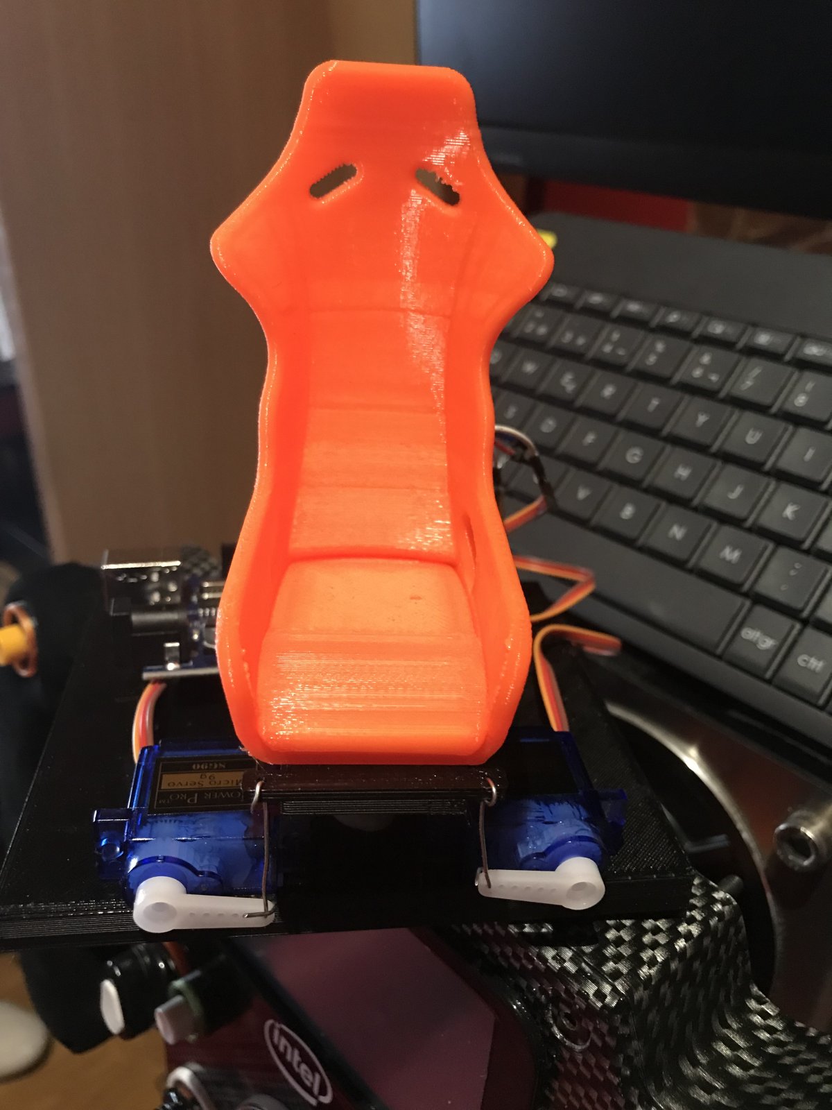

  15. sbdtoni
    sbdtoni Member
    Jun 5, 2019
    42
    207Coins
    +13 / 0 / -0
    Hi guys first of all many thanks for your help with this project I just finished my mini motion 2 dof and this is a result I can’t upload video is too large :confused:
    Kind regards

  17. sbdtoni
    sbdtoni Member
    Jun 5, 2019
    42
    207Coins
    +13 / 0 / -0
    hi Noorbeast another time thanks, this is the video from youtube
