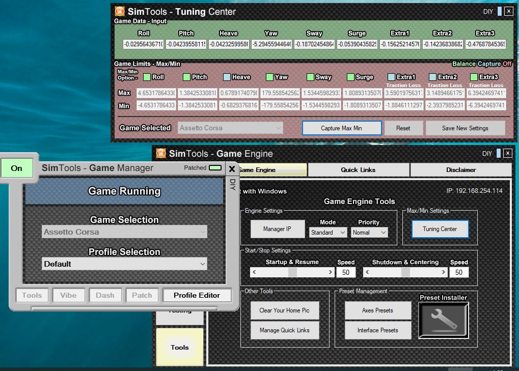

    Just checking, is there no data in the top row of the Tuning Center when AC is running in a race?

    Hi Sir Noorbeast,
    Yes, at first there's no data. But now, finally has the movement. What I did is reset the tuning center, click the Capture Max Min, run the AC at least 1 lap, then the Sim Tools automatically indicates "Game Running" and the data's appeared at the tuning center.

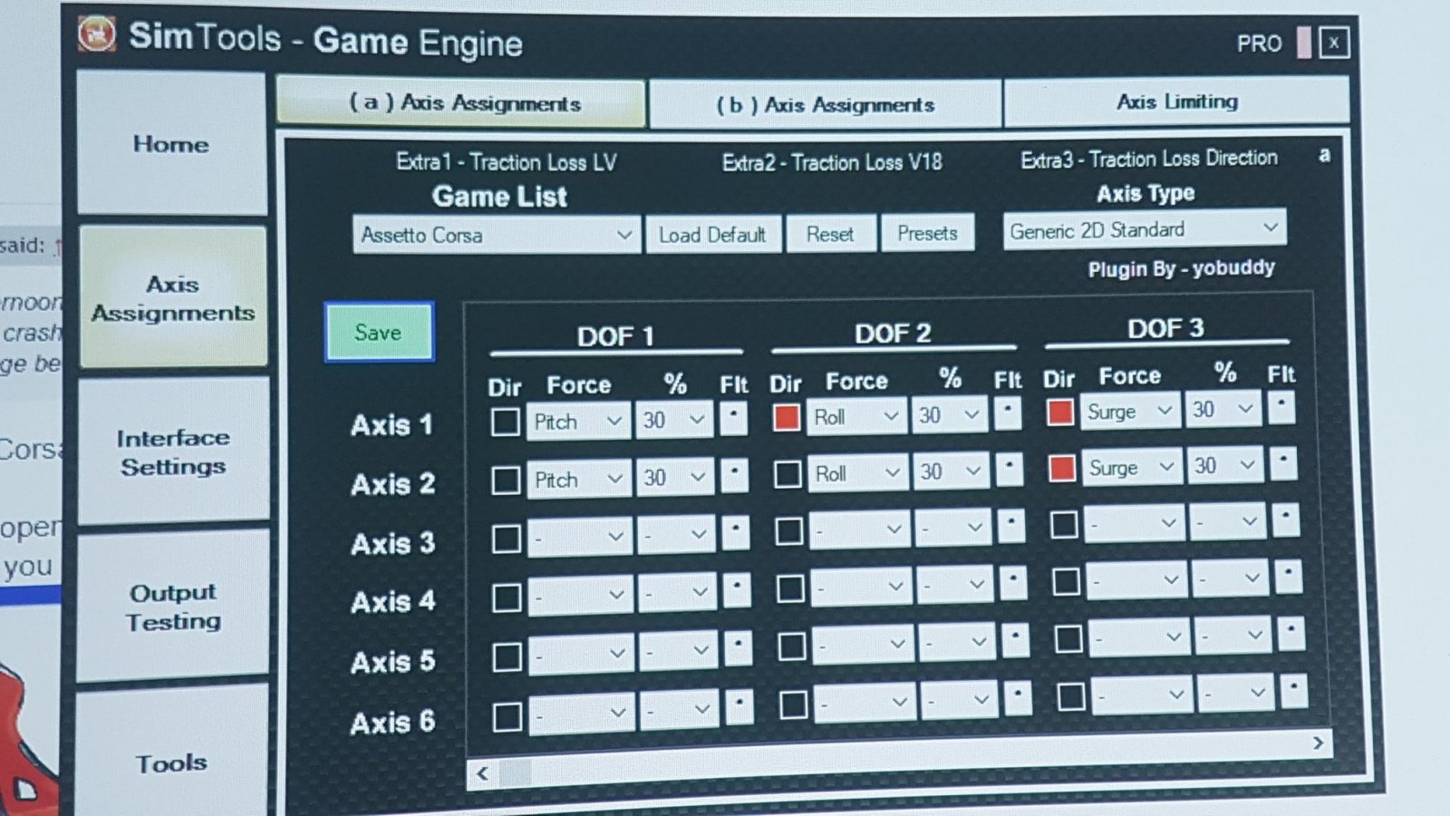

    Hello, I WILL try t'his method because I can't make motion with t'he latest update.

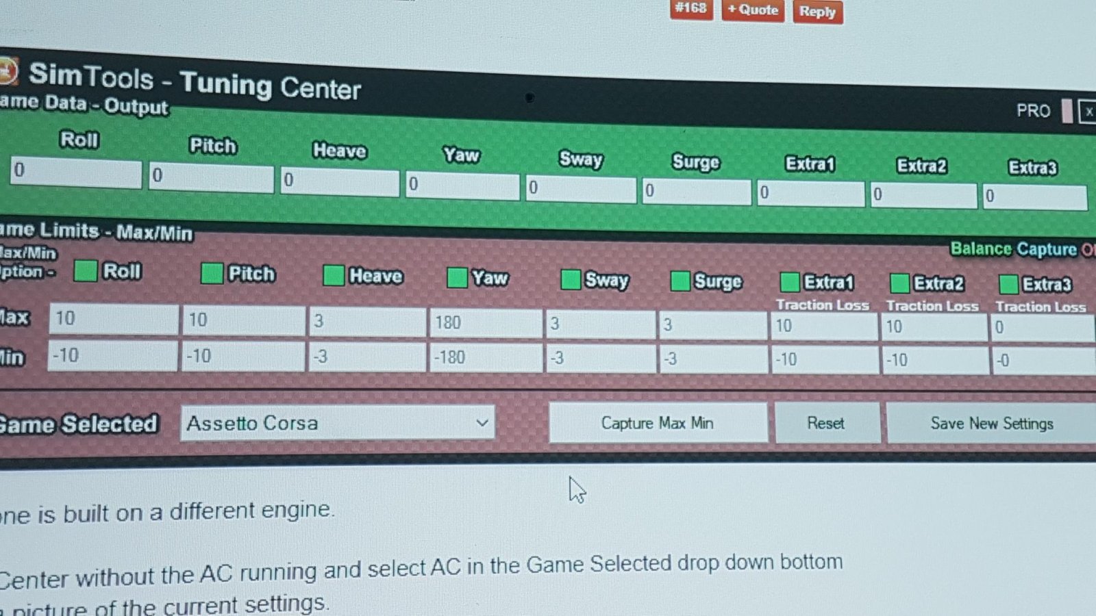

    Assetto Corsa Competizione is built on a different engine.

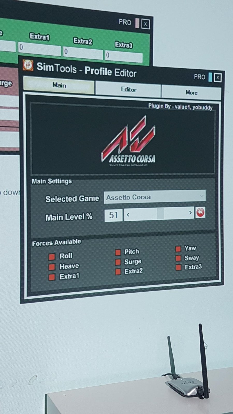

    You can open the Tuning Center without the AC running and select AC in the Game Selected drop down bottom left. Can you please post a picture of the current settings.
    You can also try dropping the Intensity Level % in Game Manager -> Profile Editor

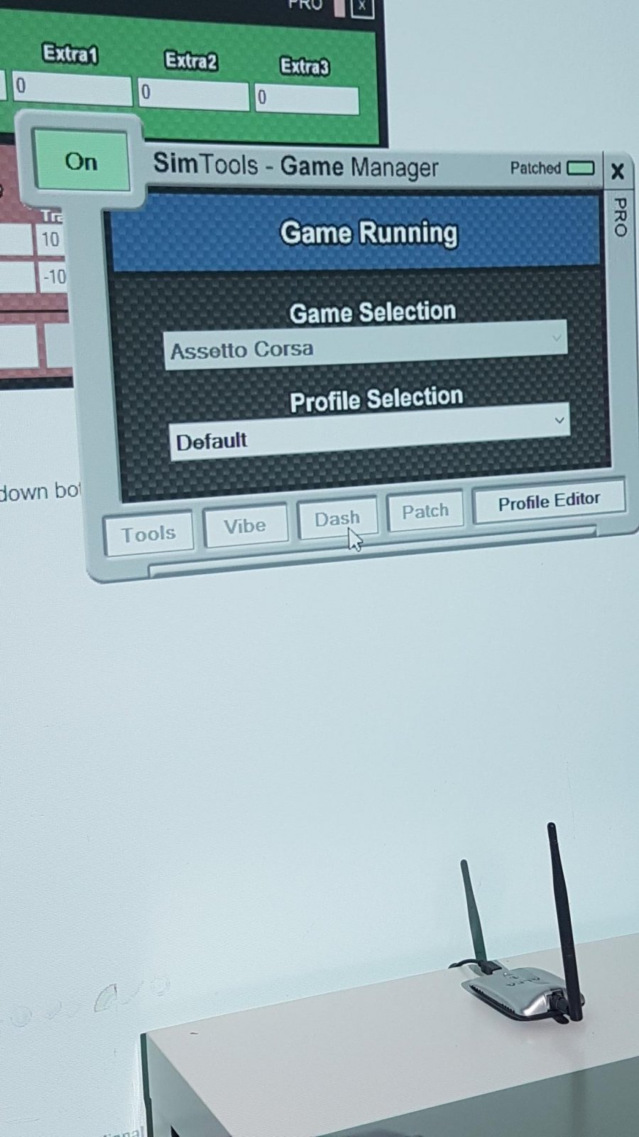

    It's very strange. When i start a race, im going to a task bar, touch the game engine icon, and suddently dessapear, stops and I try to open game engine another time, opens, but not dectect the game (axis assignements are not lock in blue). Sometimes Game manager appears blue detecting the game.

    When I suggested backing off the Intensity Level I had in mind something like 95-97%, just to ease any spikes.

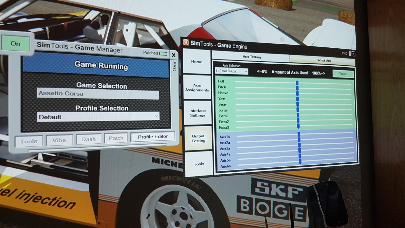

    in this moment, in this menu, the game engine is death, and game manager detects the game. in the past, game manager detects the game before this menu, in a doble click in the desktop icon of the game.

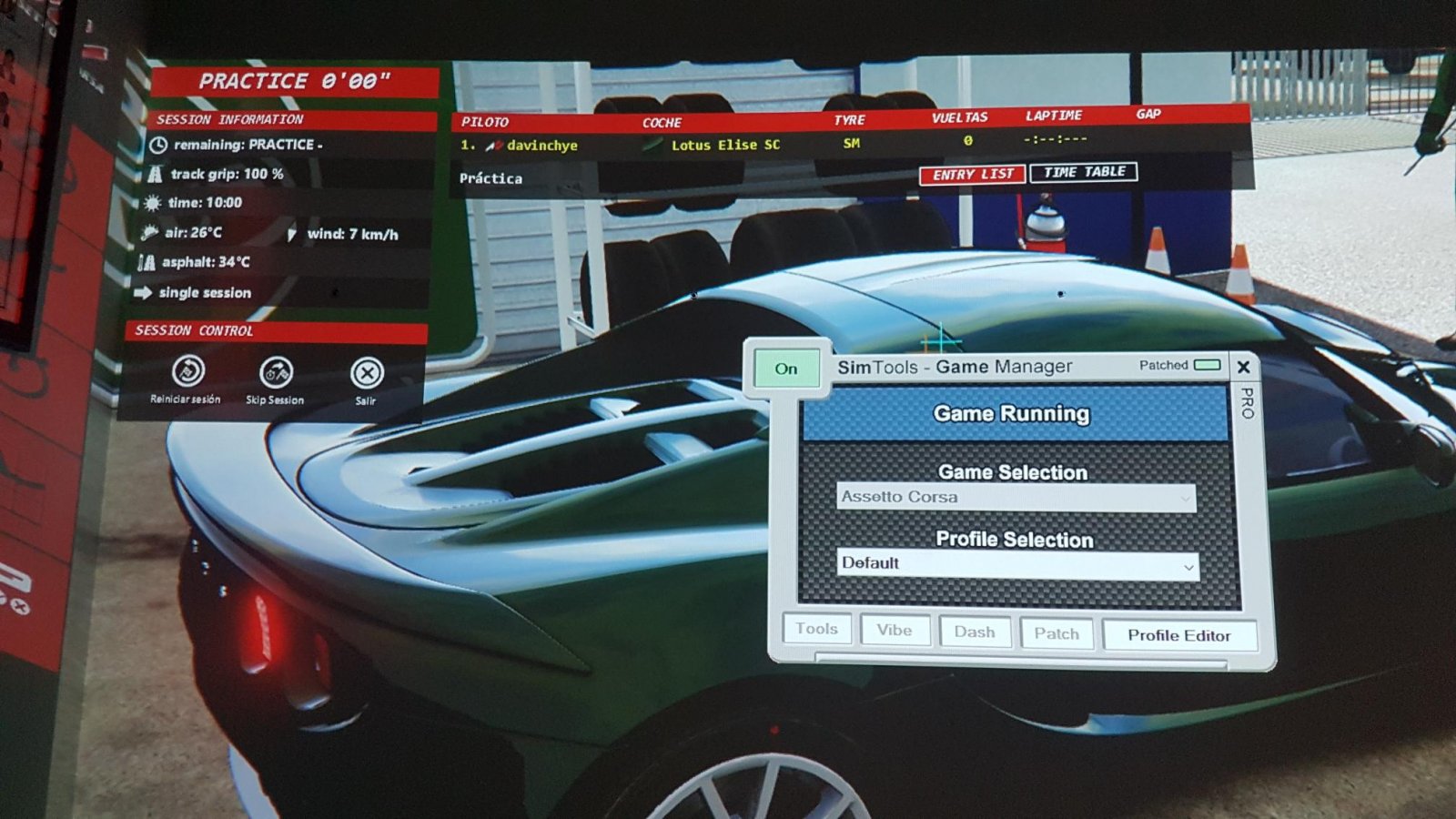

    here a pictures of my setup. Game Running only when im racing, not at the biggining of the game. The game engine continues stoped and crashing. If i open it in the midle of the game, it can't recibe any virtual data.
    I try to erase a folderr App data in my documents, but all continues exacly.
