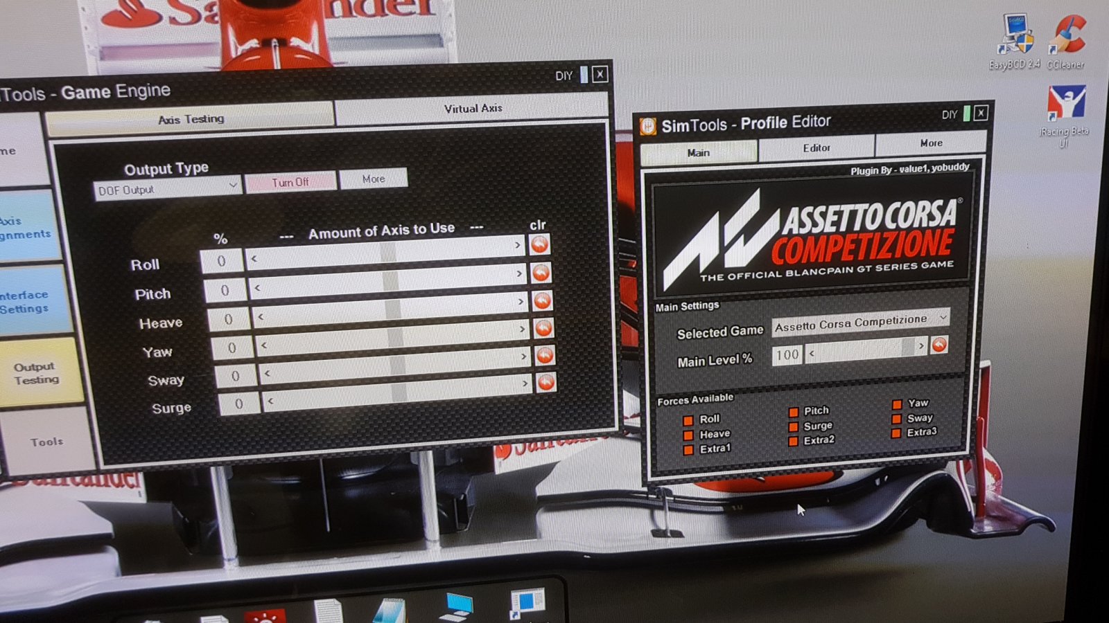

    hi sorry to bother you all, I am having issue with getting the motion for ACC to work I seem to get it shutting the game engine down once I start to load the sim.
    any ideas what I have done wrong.
    installed the patch as per normal but says installed and then patch it and says installed but when I run the game and check the task bar the engine just closes before the first screen comes up, game manager says its working and is blue.
    thank you all in advance

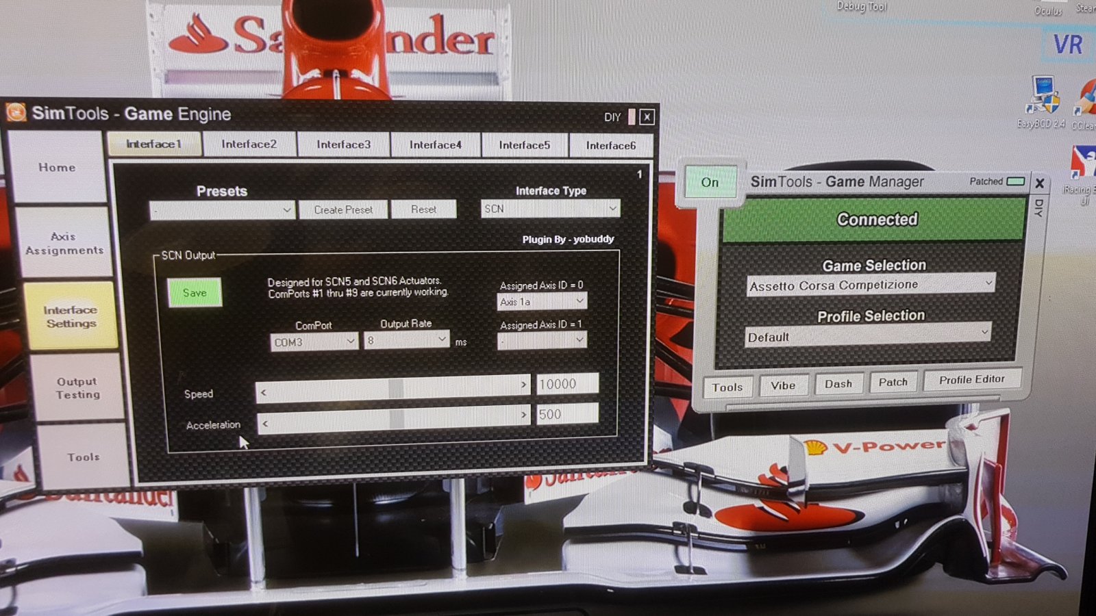

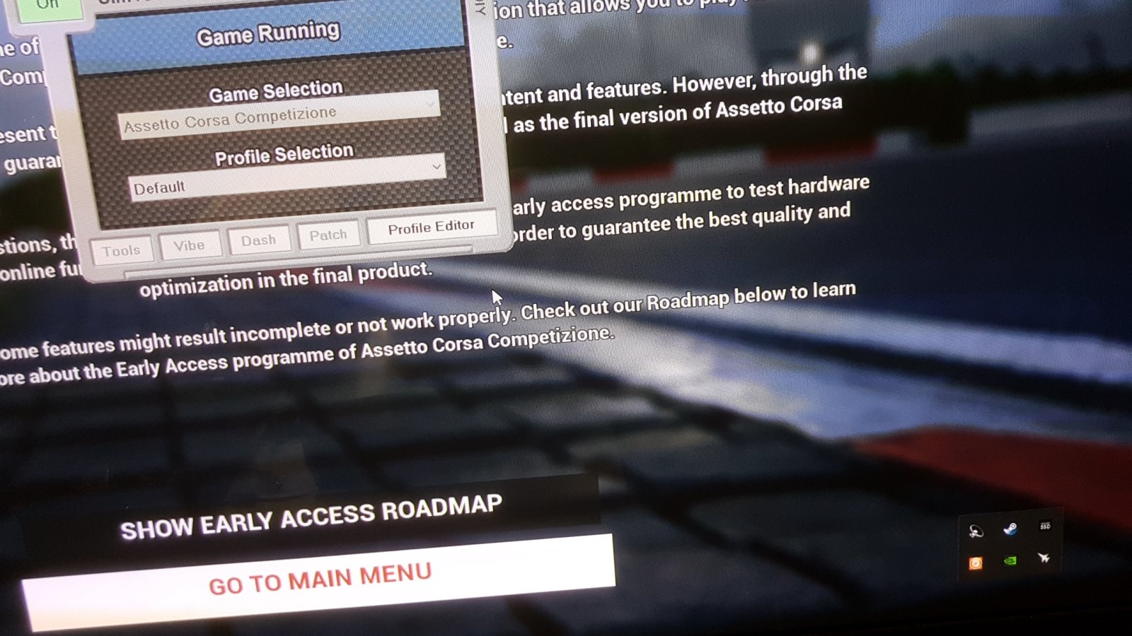

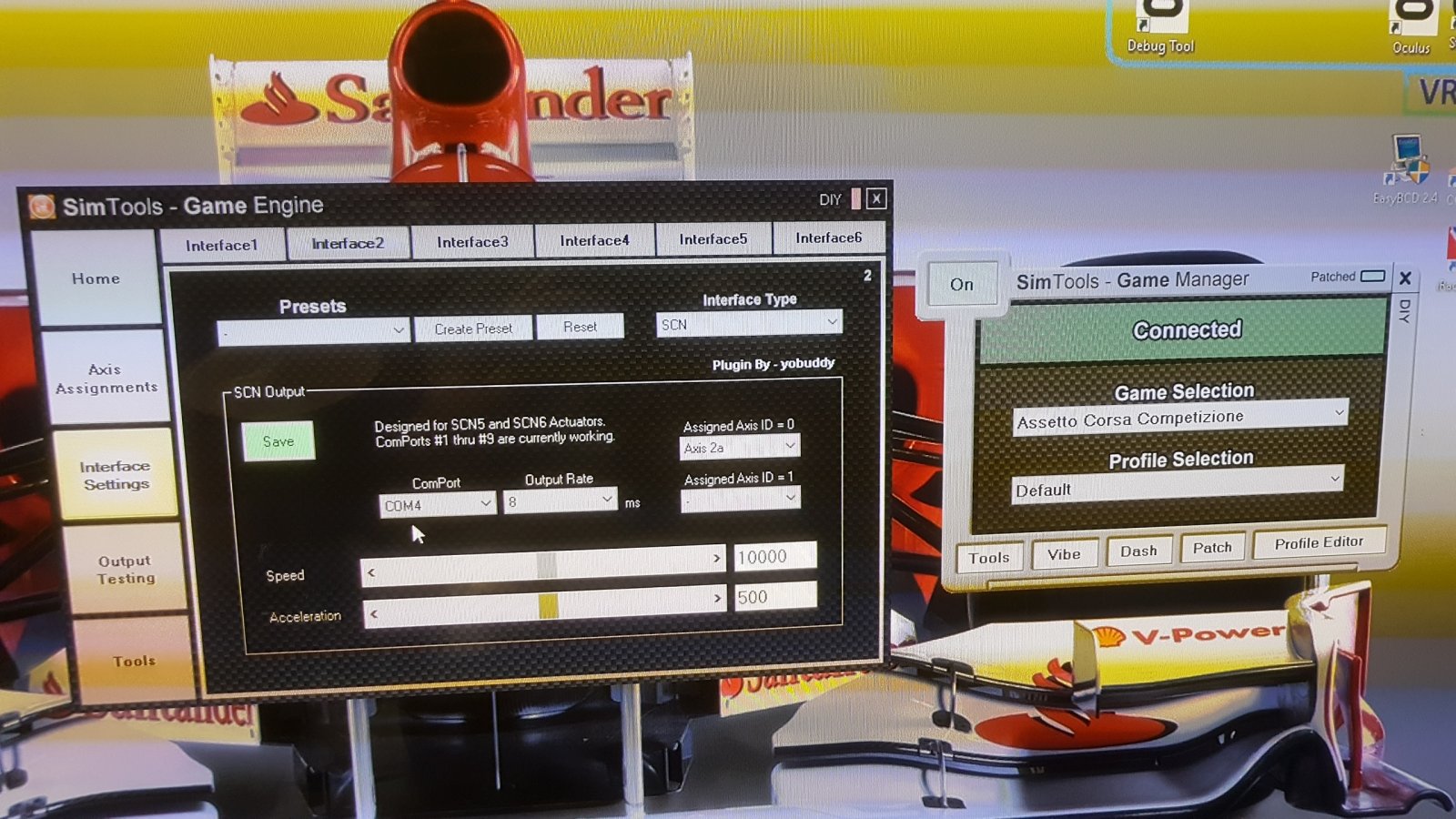

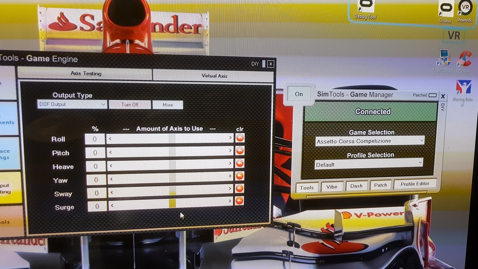

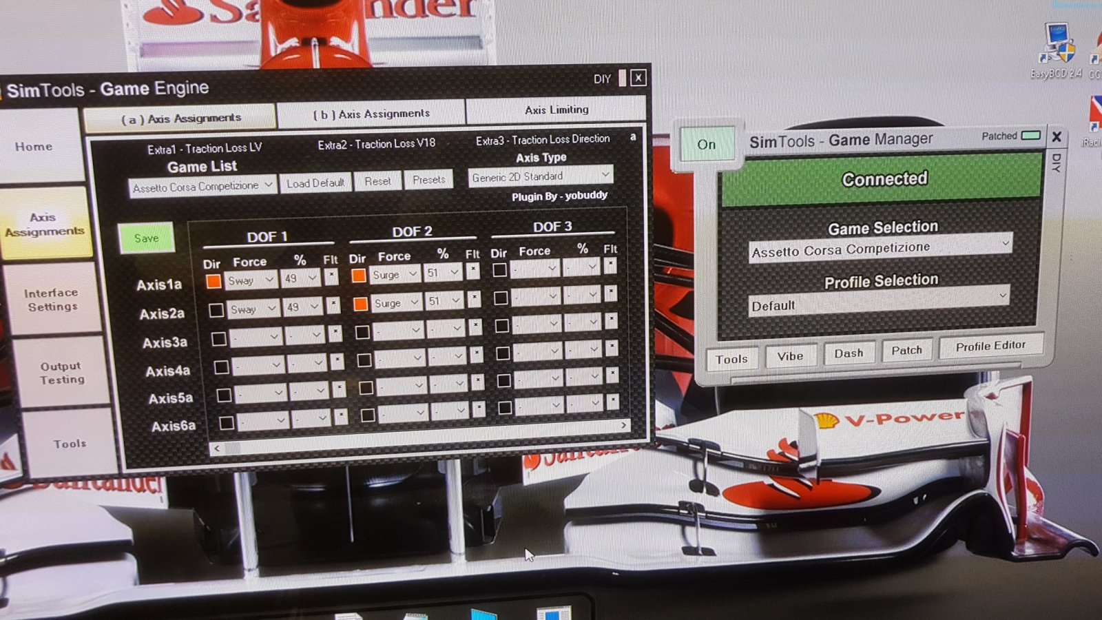

    These are my setting but not sure what your after.
    Game runs then the shuts the main engine down yet says good and blue on game manager no motion or sign of it's working in the sim.

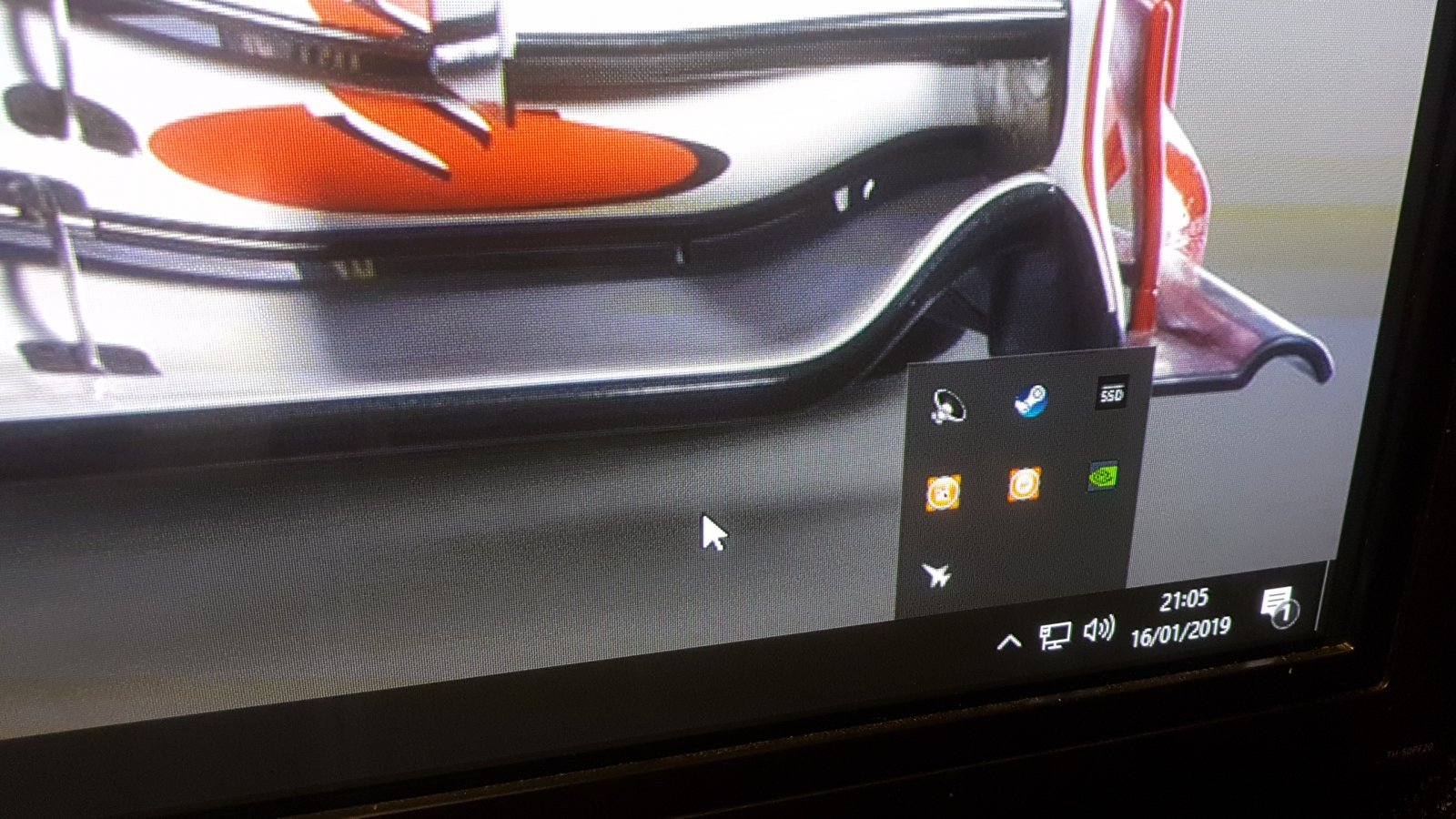

    So from now I launch the game and the game engine ahuts down if i press windows key its not there in the task bar anymore.
    Is it some kind of admin I need to use for this SIM.

    @f1iceman,
    Are the IP addresses for both GameManger and GameEngine 127.0.0.1?
    In the second pic it looks as if GameManger is connected, but GameEngine is not.
    (GameEngine has a little red square in upper right corner of GUI indicating its not connected)

    No, it would be either the default 127.0.0.1 for both unless they were edited.
    I think the service got updated with this new conflicting port.
    So it may not have been a problem till now?
    Let me know how it goes!
