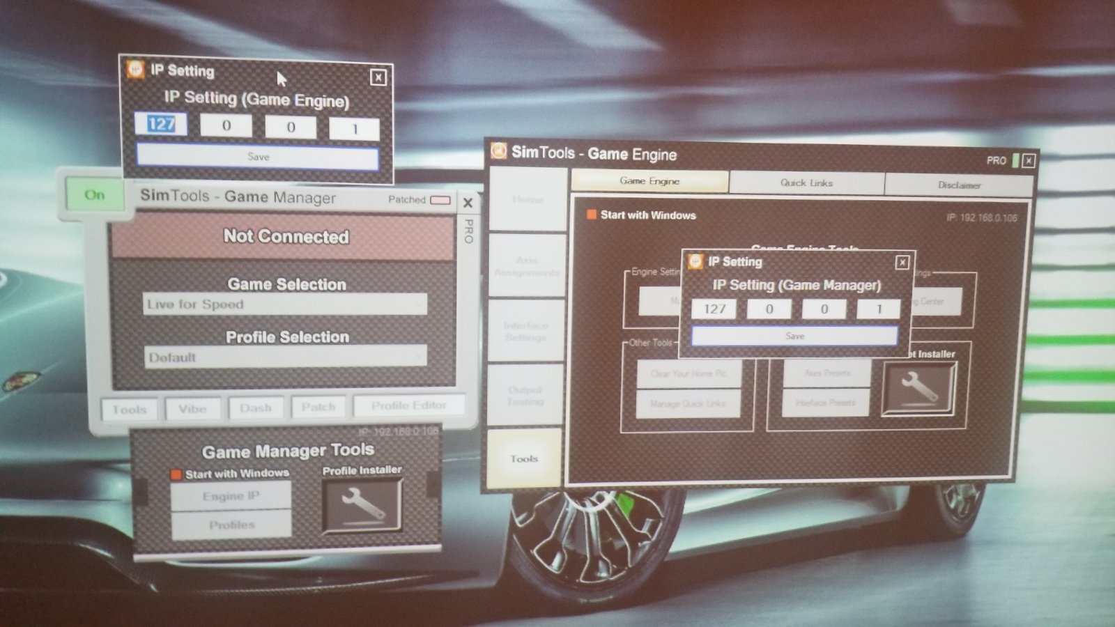

    This is the engine and the manager running after the reinstall and with the TCP and UDP permissions automatically created by my firewall after the first time I ran both programs. 20181221_053640.jpg
    22,215
    154,759Coins
    +11,213 / 57 / -2
    Have you again tried shutting off the firewall and antivirus temporarily since the reinstall of SimTools, as something on your computer is the most likely culprit.

  8. yobuddy
    51,761Coins
    +5,206 / 19 / -0
    Hi John,
    Coming from someone that has repaired PC for a living for over 15 years, I can tell you that what you are seeing here is not normal.
    First, I would install AVG Free and be done with win Defender, if thats what you are using.
    Second, I would restart the PC in safe mode and see if the apps connect, if they do, you have something loading with windows that is blocking communication.
    To be fair, it seems like the problem is with your PC and not the Sim.
    In 5 years + of SimTools, we have never seen communication only blocked in a single direction.
    So there isn't a simple answerer here and it's going to take some investigation I'm afraid.
    Please try the steps I suggested above and let me know how it goes,

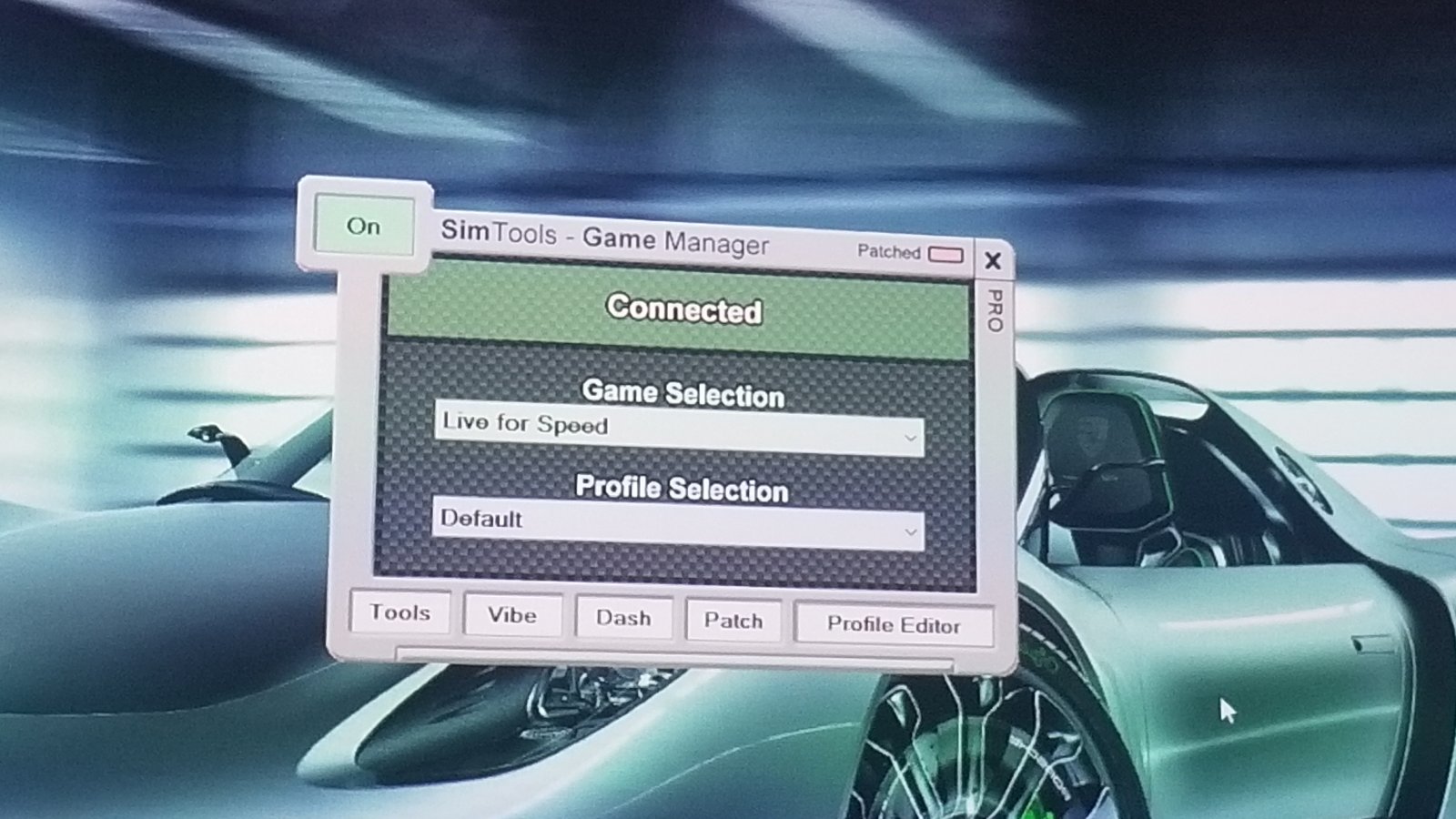

  9. John Wilson
    John Wilson New Member
    Dec 16, 2018
    22
    Boston
    199Coins
    Hi @noorbeast,
    I have not even installed the plugins yet. I am just attempting to get the game manager and the game engine to connect with each other before moving onto connecting with a game. (In previous installs I have installed the plugins and the motion works correctly from the game engine)
    Hi @yobuddy,
    I greatly appreciate all this help. I agree that this has something to do with my computer.
    I did install AVG Free, it installed antivirus software but not firewall. This didn't change the situation.
    I restarted my computer this morning and safe mode with networking and they connected!! So again I agree it is something with my computer.
    I restarted again in normal mode and completely turned off my firewall, the two did not connect, so I'm thinking something else is loading which is causing the problem.
    I haven't needed to use safemode before to diagnose a problem so I am now going to research how safemode works and what the differences are, maybe I can find a way to turn things on one at a time and see when the problem starts to happen.
    Thank you for these suggestions, if you have something else for me to try, now that we know it works in safe mode I am all ears and will try it.
  10. John Wilson
    Dec 16, 2018
    22
    Boston
    199Coins
    @noorbeast @yobuddy
    Problem solved!!!
    So after starting in safemode and seeing the manager connected I had to look up what safe mode really did and found what was referred to as a "Clean Boot" where I used msconfig to turn off all non-windows services.
    I traced the problem to a service that was running called:
    AsusGameFirstService made by AsusTek
    I am on an Asus machine so I can only imagine this came installed on my computer. Regardless of where it came from I enabled all other services and the manager and engine are still connected!
    THANK YOU!
    I understand that since I did not build this rig myself I was far behind the curve in terms of the details of how all of this works and I could not have found this solution without your help, again, thank you!
