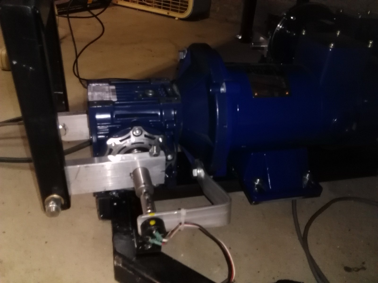

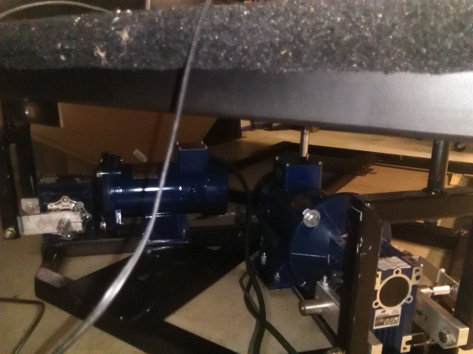

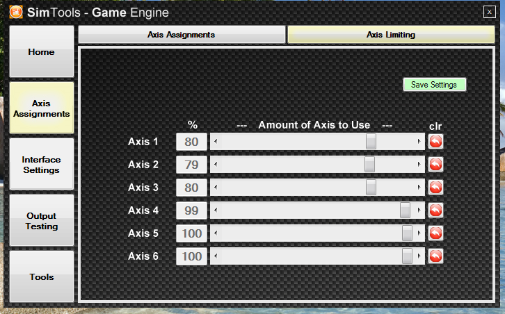

    Why do I need to keep resetting my Arduino board for motion when I bank right? Motor #1 keeps shutting down. Both motors are setup the same in SCM3.

    Can you please post pictures of all of your settings, and a video of the rig and game screen would also assist trouble shooting.

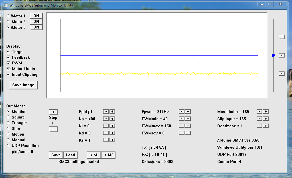

    https://github.com/SimulatorMotorController/SMC3Utils
    Clip Input Used to create a band at either limit of the target range beyond which any values sent to the SMC3 are clipped. In addition to this clipping, if the motor feedback does move beyond this range (typically through inertia), the SMC3 will attempt to brake the motors hard by driving them in reverse until they are back out of this limit zone. The value can be anything from 0-255 (however can’t be less than the current limit setting). Reverse braking is applied in the band between the Clip Input and the Max Limit settings. Reverse braking can be disabled - refer to PWMrev.
    Max Limits Used to create a band at either limit of the feedback range beyond which if the motors move (typically through inertia) the SMC3 will automatically shutdown the drivers and keep them disabled until reset. This is essentially a safety mechanism if something goes wrong. The value can be between 0-255 (however can’t be greater than the current clip setting).

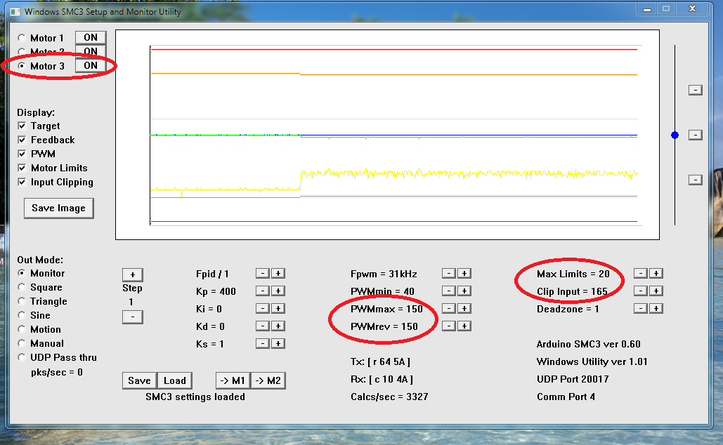

    I set both for max load to 20 and I still have the same problem. It only happens when the actuator to motor #1 is in it's upper position. All other functions work fine. I replaced the hall pot , and that was not the problem. The only thing I have not done yet is to replace the motor controller or the motor. I have installed a reset switch on my platform so that I can reset the Arduino board from the platform. I would rather fix the problem rather than use the switch. And yes this is a scm3 issue but it is the Arduino board reset that I found to somewhat fix the issue. Thank You and HAPPY THANKSGIVING TO ALL

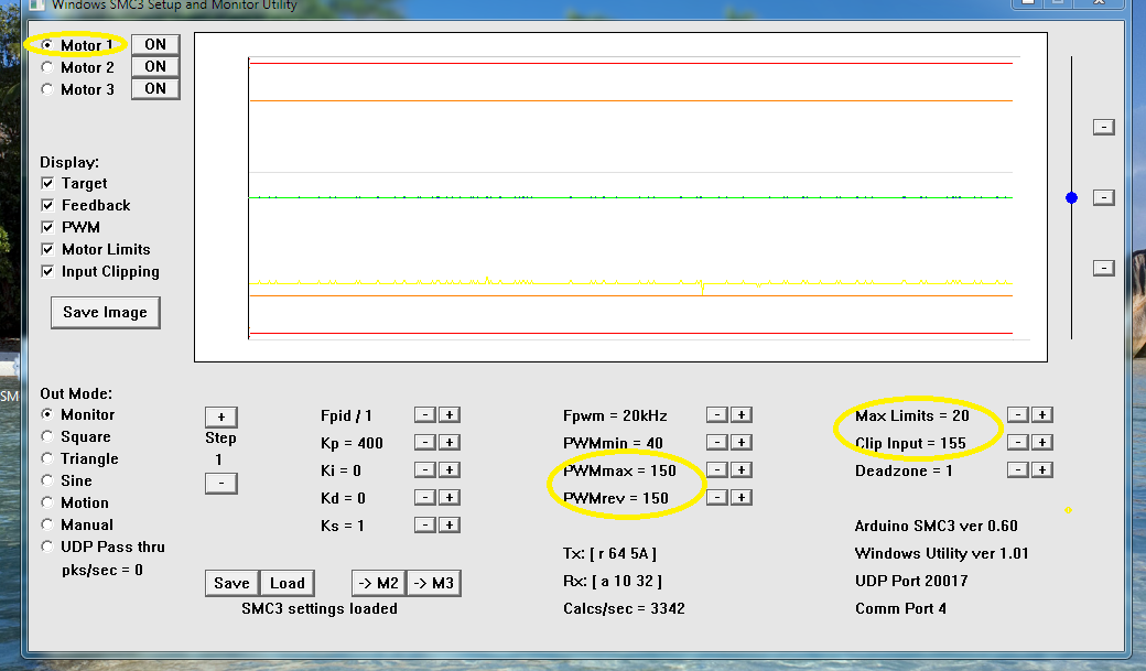

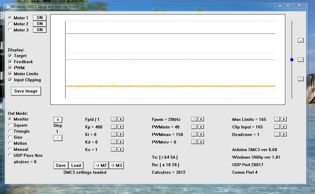

    With my Max Limits set to 20 and my Clip Limits set to 155, I still have the problem . Thanks for the reply.

    Have you tweaked your PWMrev, that affects how hard the brakes are applied once the Clip limit is reached?
    Best to re-post current SMC3 settings each time you change them.

    My PWMrev is at 150 the same as my PWMmax now and still not working. Could the problem be my motor controller board?? I will posy pictures later because my problem is 2 story's below me.

    I would have expected your PWMax to be higher, and Fpwm to be 25kHz.

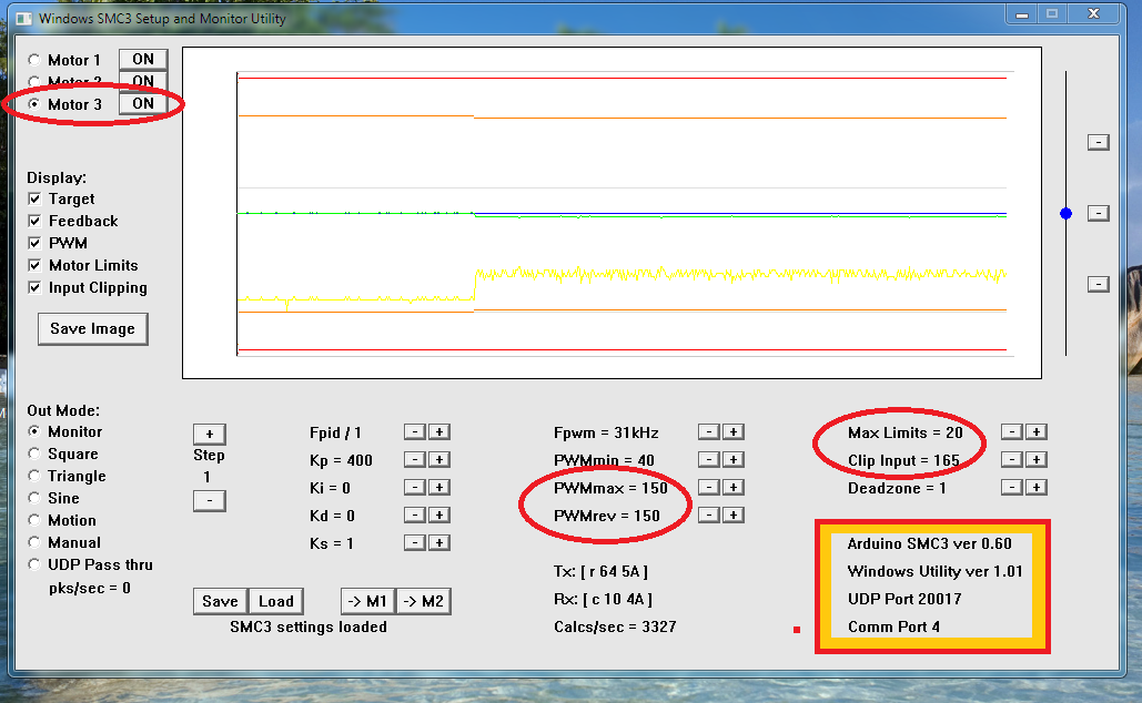

    @yobuddy
    Could this possibly be the problem (miss match of ver)
