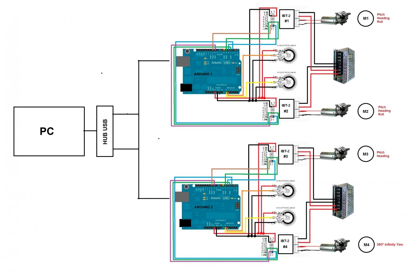

    RacingMat
    Please can you tell me if this scheme is right for me to use 2 arduino uno and 4 ibt2 to make a 4dof flight simulator using your 2dof code?

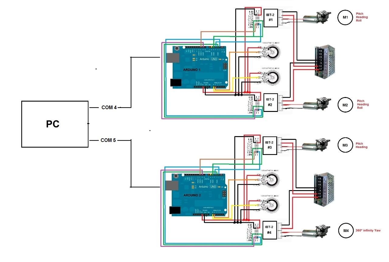

  3. nicolasp
    nicolasp New Member
    Aug 1, 2015
    15
    são paulo, brazil
    23Coins
    Or would the correct schematic be this?

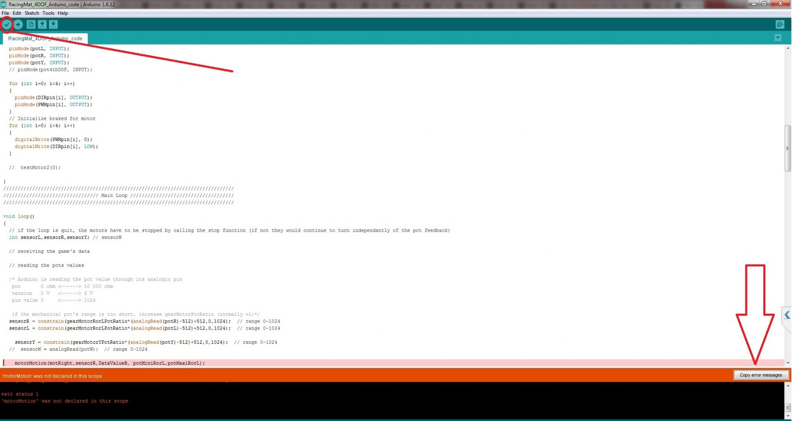

    Hi Mat.
    compile error message.
    I do not know where I'm wrong.
  5. RacingMat
    2,233
    21,085Coins
    Hi
    What did you change in the code ?
  6. phonghornet
    phonghornet New Member
    Aug 19, 2018
    27
    190Coins
    2DOF, 3DOF, DC motor, Arduino, 4DOF, 6DOF
    Hi Mat
    I found the error thank you.
    The directory that I save contains special characters, so I can not compile it.

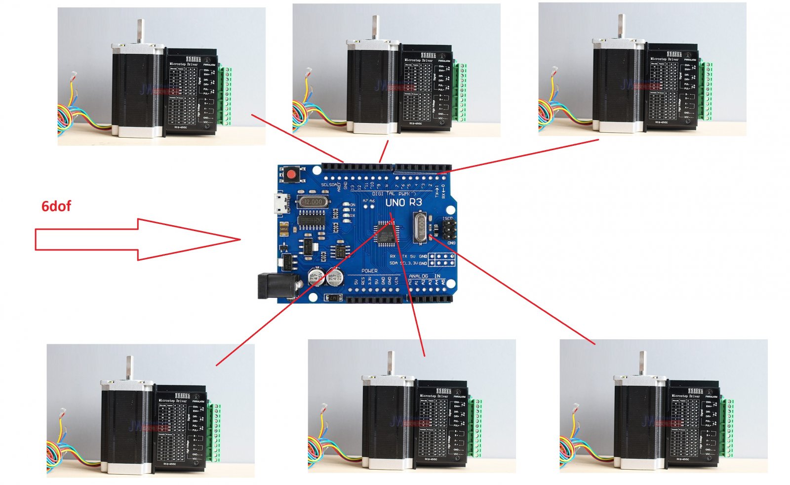

    I am wanting to build an arduino + simtool + stepper motor.
  9. RacingMat
    2,233
    21,085Coins
    Sorry, but I would advise you to stick to a known recipe ! Trying to innovate while being new to arduino will be hard and costly to my opinion ;-)

    can i use 4 ibt2 whit this code?
    if so does anyone have a connection diagram?
    want to try to make a 4 dof, when my first project is finished :)

    I now use the smc3 code for my first project. but I want to control 4 motors. for my next project. I was wondering if that is possible with 4 ibt2?
  16. noorbeast
    22,086
    154,124Coins
    +11,170 / 57 / -2
    Use 2 Arduinos and SMC3.

  18. noorbeast
    22,086
    154,124Coins
    +11,170 / 57 / -2
    See my previous comment where I consider the easiest way to drive 4 motors is 2 Arduinos, each driving 2 motors using SMC3, as that way you have all the benefit of the SMC3 utility for configuration: https://www.xsimulator.net/communit...-dirpin-hbridge-board.4614/page-6#post-176494
