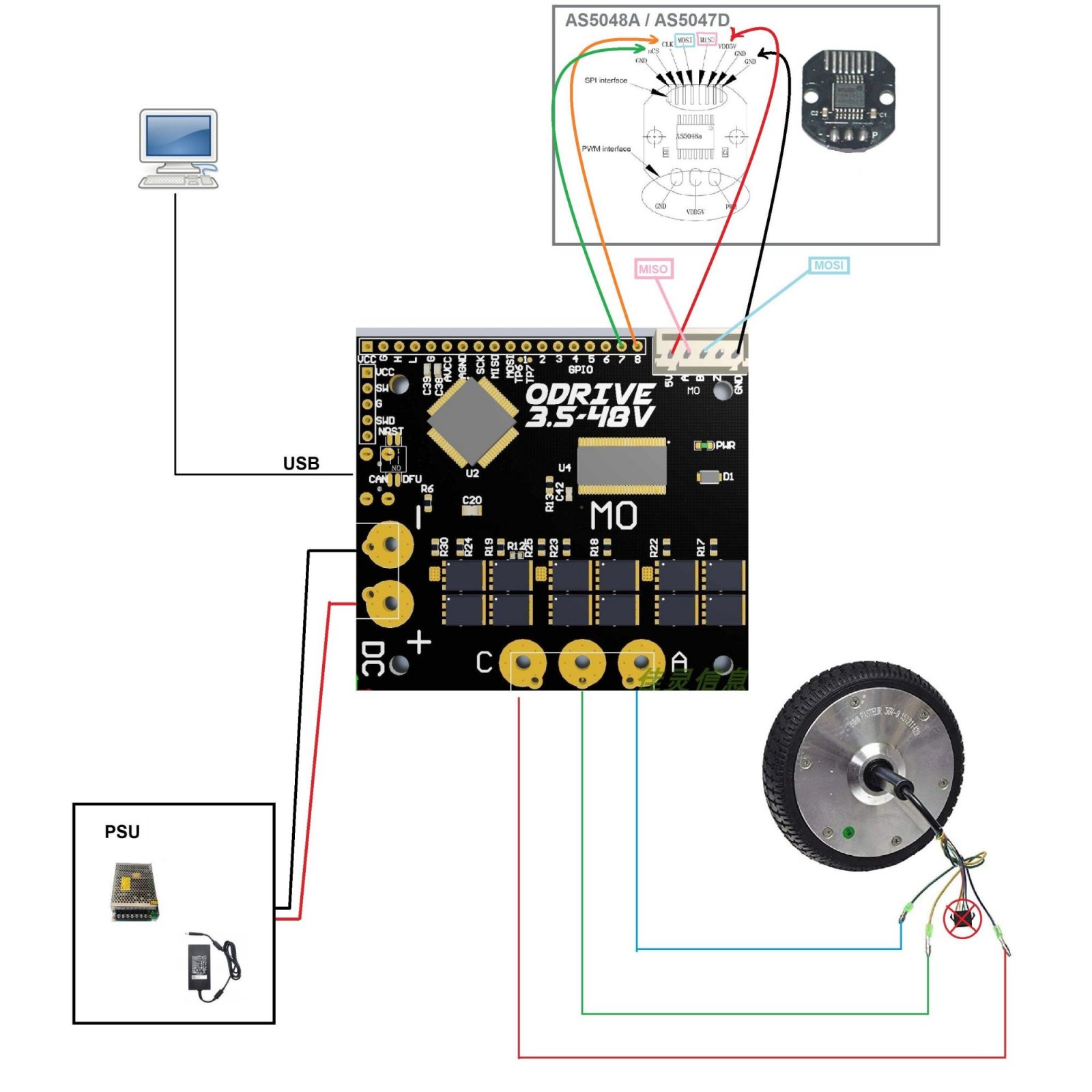

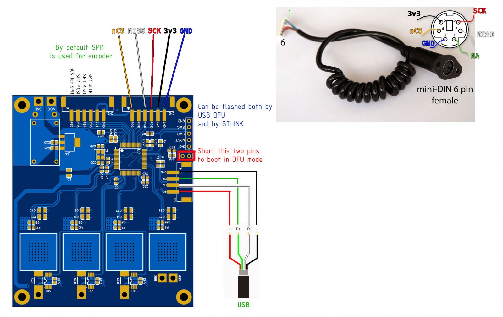

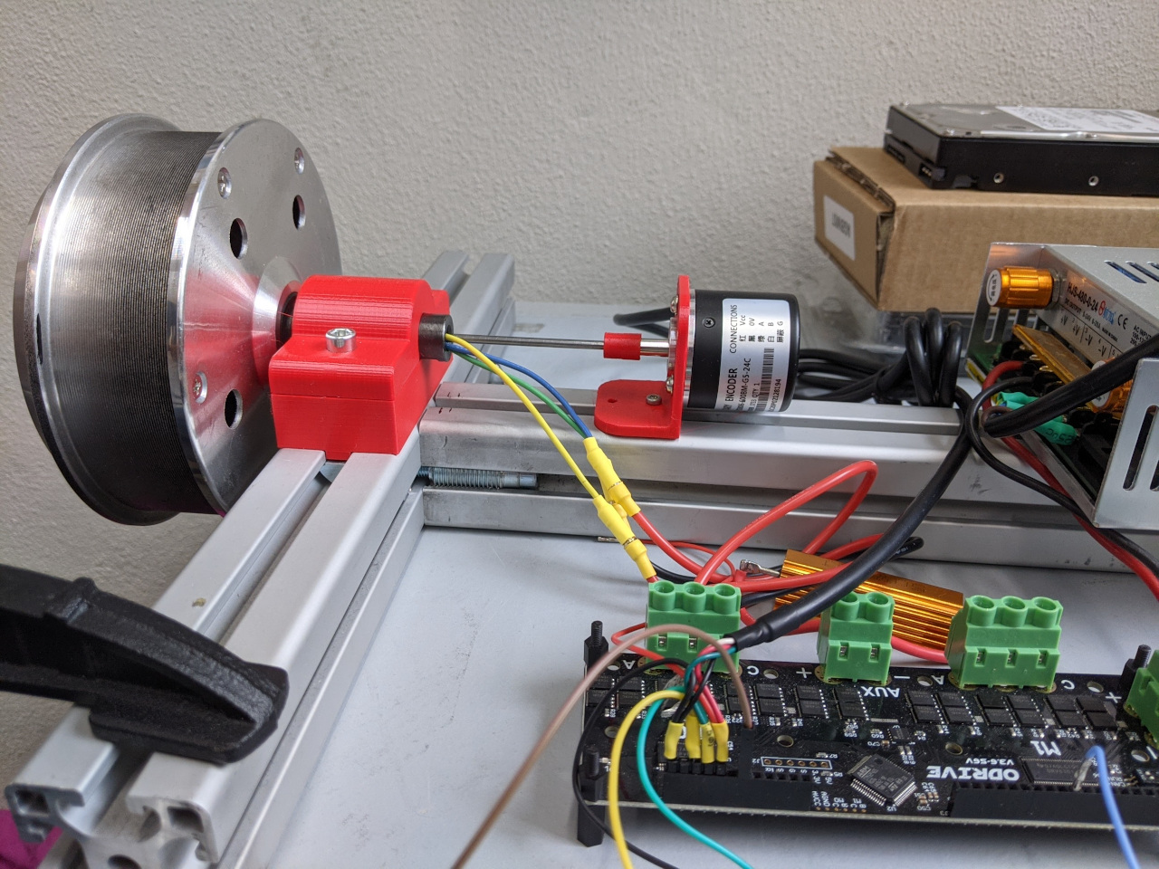

    Is this an AS5047 encoder? Very nicely done!
    Can you sell me one of your custom boards or would it be possible to run your joystick firmware with two non SPI encoders?
    Here is a picture of my (testing) installation. I also drilled the shaft completely from front to end and took a 3mm wire to drive the encoder.

    Yes

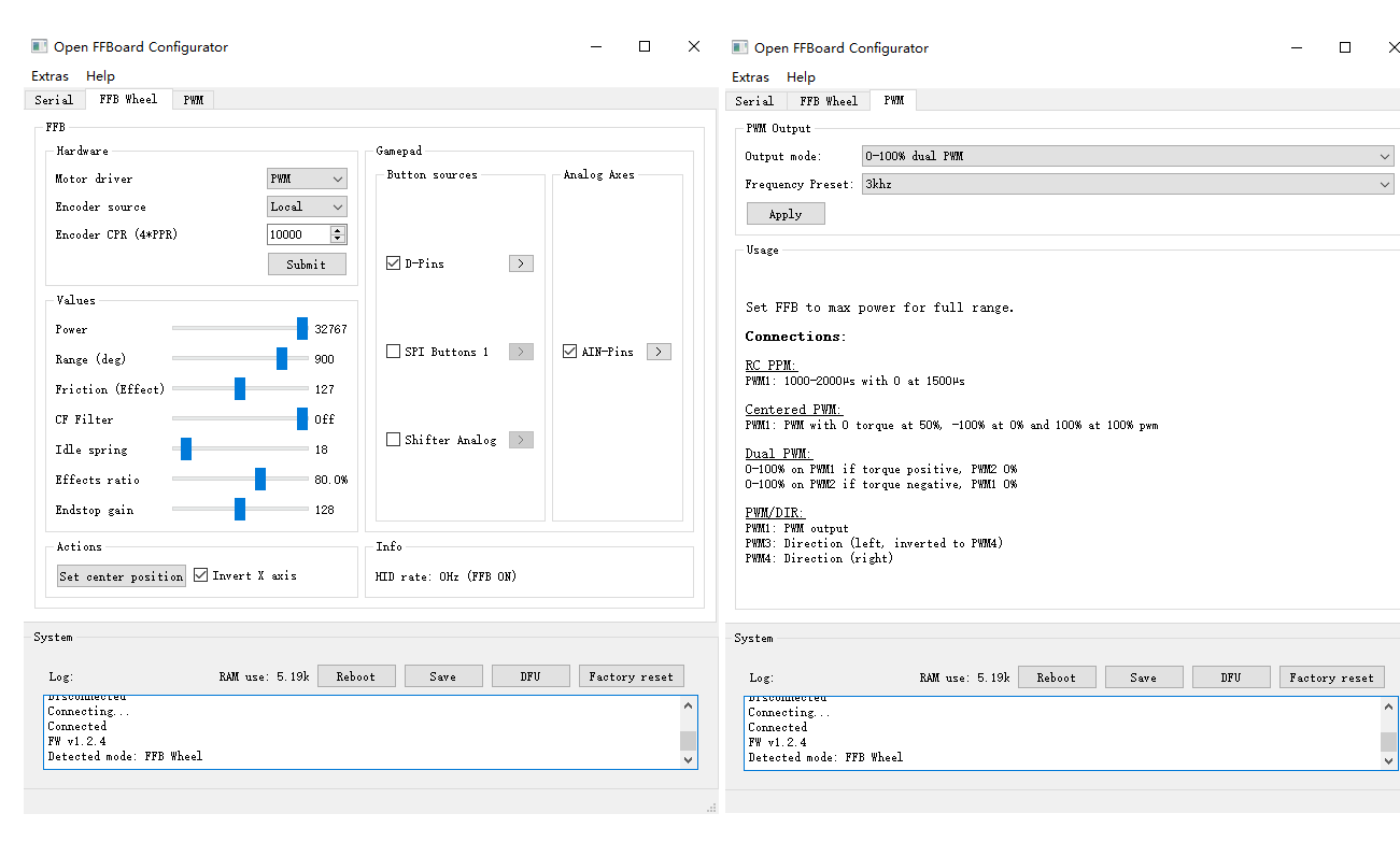

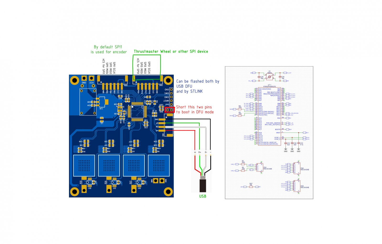

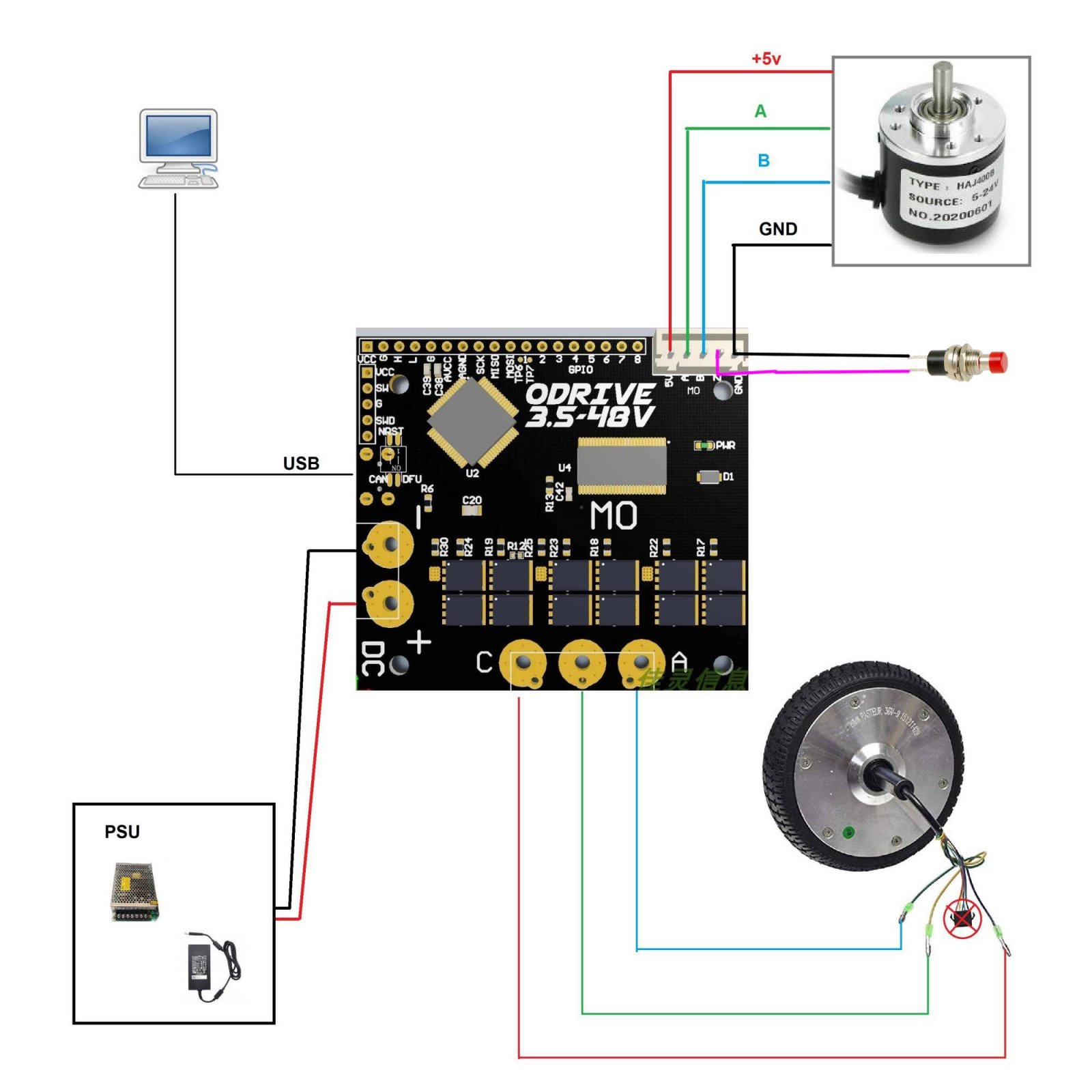

    https://github.com/o-devices/bldc-ffb-joystick-base here is everything related to joystic project including link to board project so you can order it on JLCPCB. Firmware for it is there as well. I do not have enough time to remade joystick firmware for incremental encoders right now. May be at some point in future.
    You can test wheel firmware as wel on your ODrive. https://github.com/o-devices/bldc-ffb-wheel/tree/master/firmware. Just connect a button to Z gpio for first encoder to reset zero position of the wheel.

    Thanks for the links! Will download and test it.
    I know how to order a PCB at JLCPCB for your controller but I have no idea how to order a
    prebuilt PCB one. Can you help me?
    Do you have any plans to opensource your FFB joystick firmware?

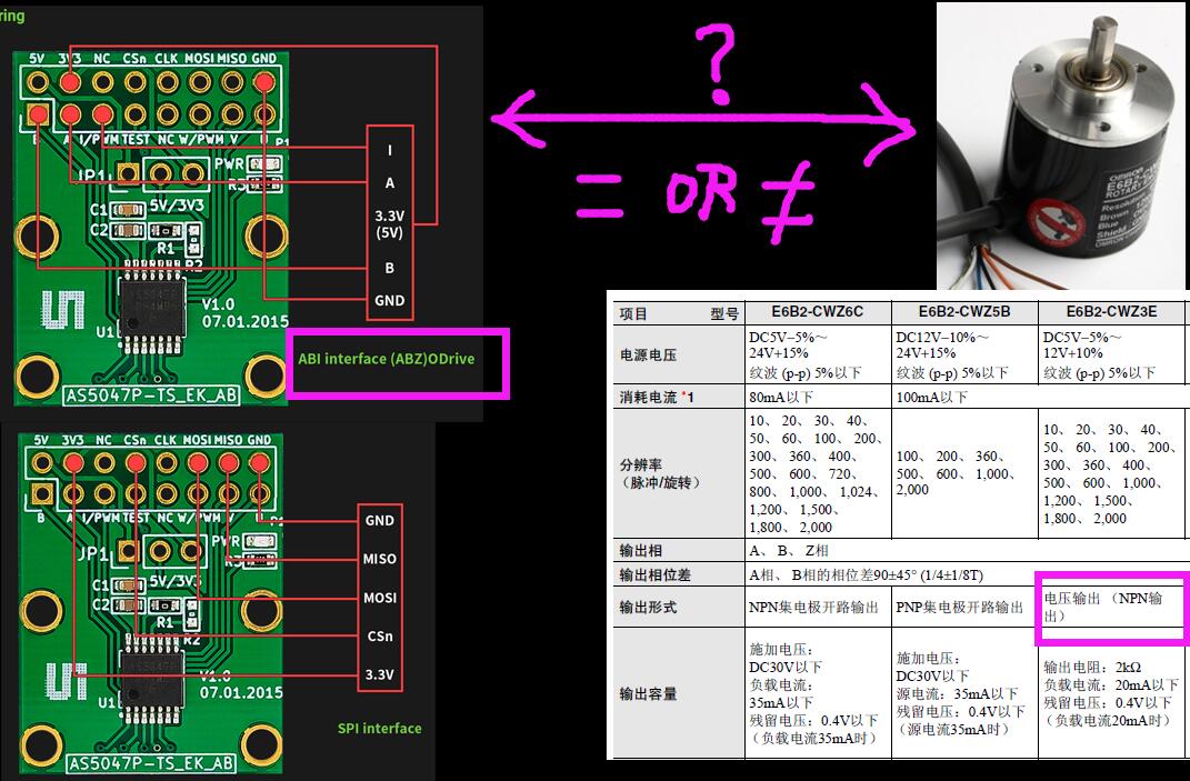

    :)Another question is whether the ABI output of the magnetic encoder as5047p can directly replace the PNP output of the grating encoder
    I want my Hoverboard Motor to be as simple as yours
    After my test, it can be replaced, and the price is much cheaper than that of photoelectric encoder
    Next I will cover the motor on my scooter

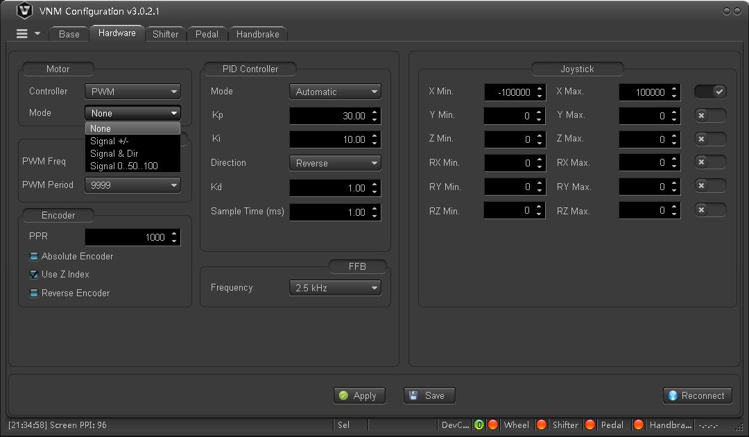

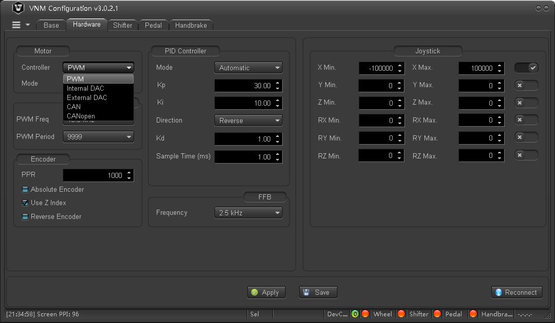

    Hi mate I see that you are using the vnm firmware I'have only one question for you where should I plug the pwm and the direction cables from the esc?
  12. fzxj520
    fzxj520 Active Member
    May 14, 2015
    176
    1,341Coins
    +90 / 1 / -0
    The pin definition of vnm firmware is almost the same as that of mmos firmware, vnm firmware can set pwm 0-50-100 output. I tested the VNM_WHEELBASE_V1_STM32F407.hex firmware with richardburnsrally and found something wrong. Although the maximum left and right angle limit force is normal, the in-game force feedback output is very, very weak (all settings are turned on to 100% force feedback).

    Hi, I have 250w hoverboard motor and odrive3.6 bought from aliexpress. When I try to calibrate motor, I get umknown current measurement error. How can I fix it?
  16. Roman Smoliakov
    Roman Smoliakov New Member
    Oct 31, 2020
    20
    161Coins
    +30 / 0 / -0
    Why you need to calibrate it? Which software. My firmware works without need to calibrate motor.

    Do you have a wiring diagram for your custom controller similar to the ones for the ODrive? With the colors, labels, etc.
  18. Roman Smoliakov
    Oct 31, 2020
    20
    161Coins
    +30 / 0 / -0
    But I recomend you to go with ODrive. Firmware development for custom board is frozen for now because of difficulties with sourcing components for it. So I base my devices on ODrive in observable future

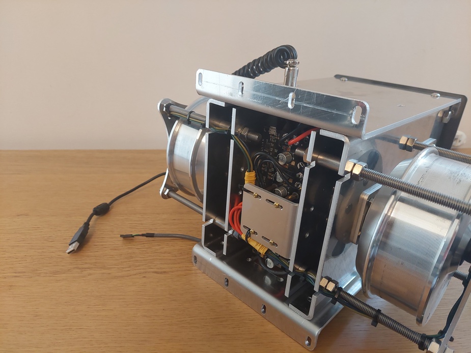

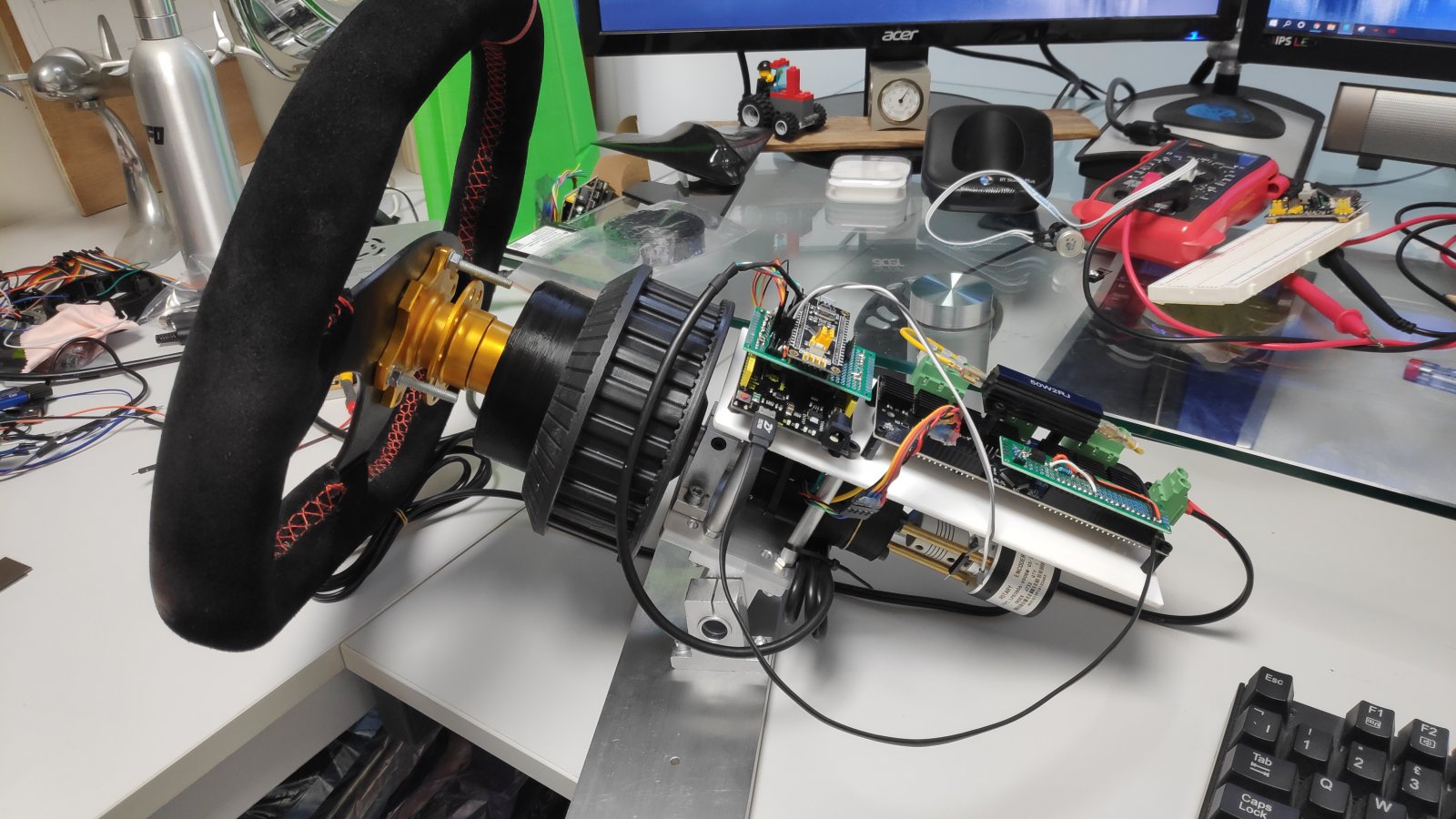

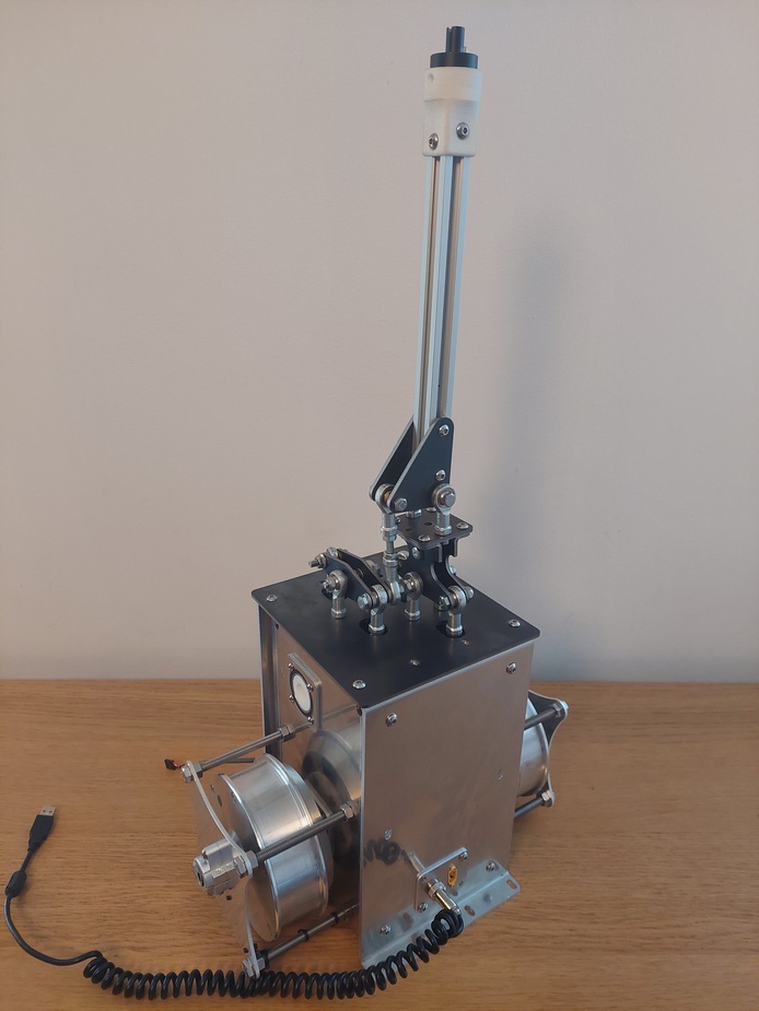

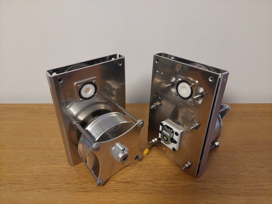

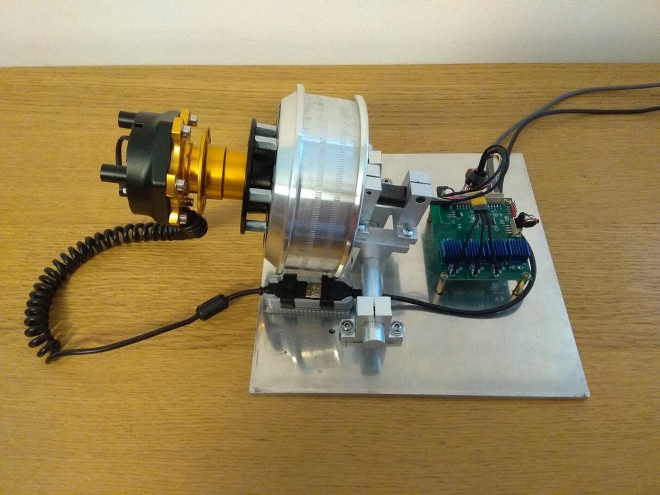

  20. QuinrodD
    QuinrodD YawVR1
    May 22, 2023
    32
    self employed
    223Coins
    3DOF, Motion platform
    Can you kindly link to that wheel adapter with the coiled cable? Is this for the Thrustmaster wheel rims? Also, in another picture you have the coiled cable from inside a Thrustmaster wheel Base, where did you get this one? Links would be great, thanks!
