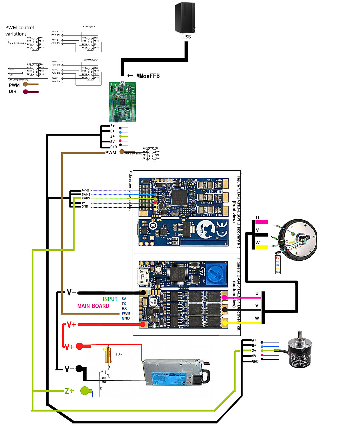

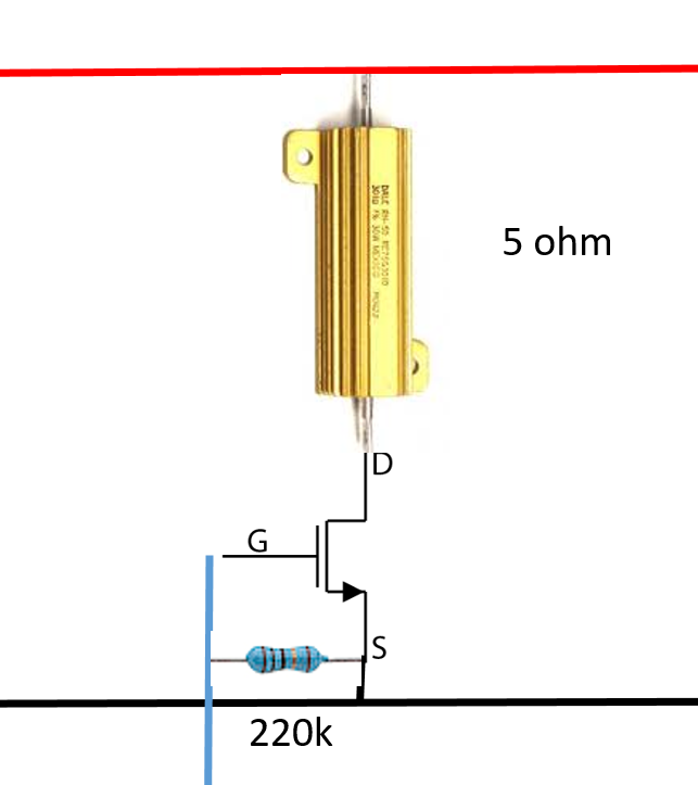

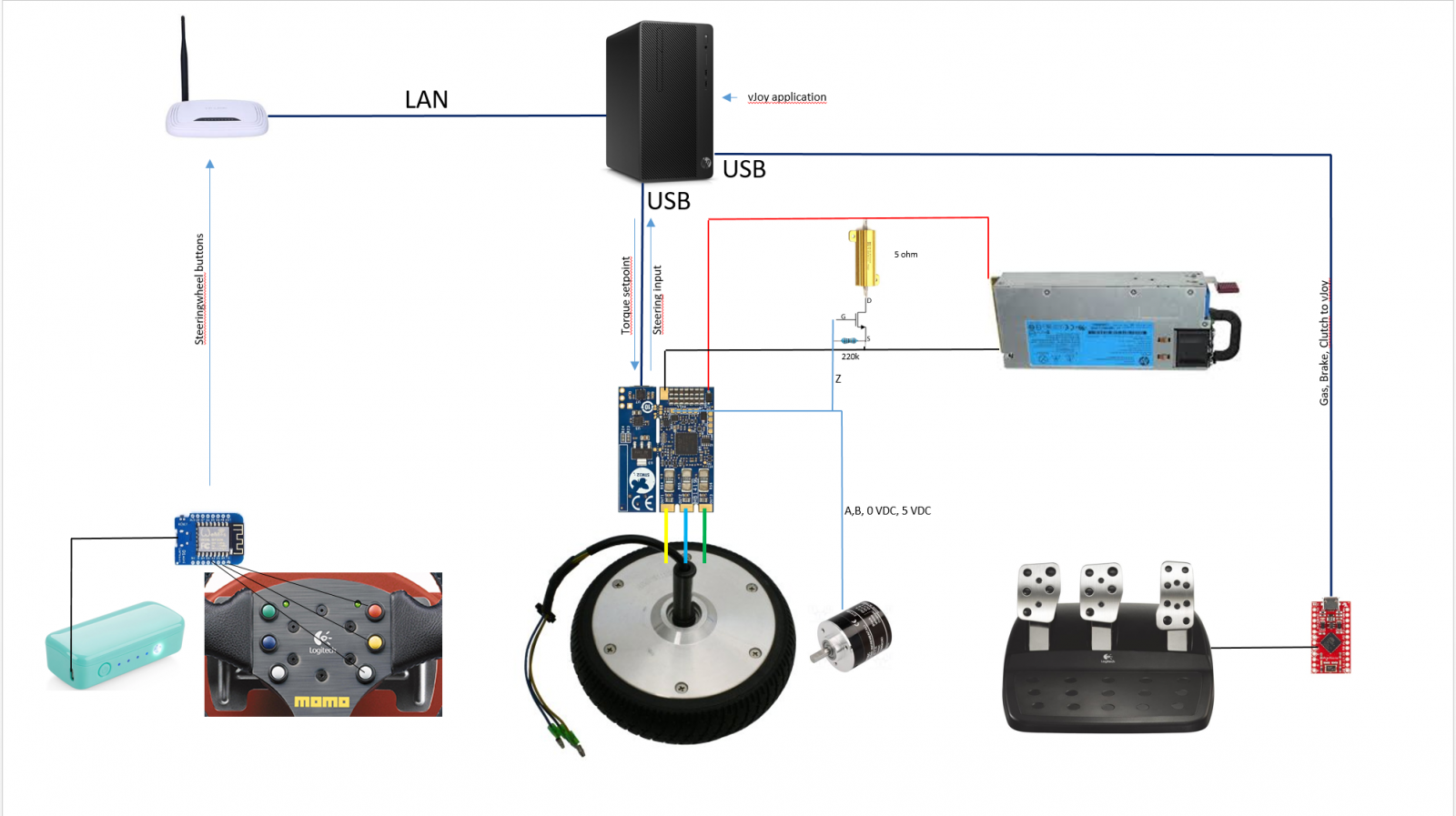

    Could you show the circuit with brake resistor or some more info regarding the connections.

    I made a simplified schematic of my build. The braking circuit is as simple as the picture shows.

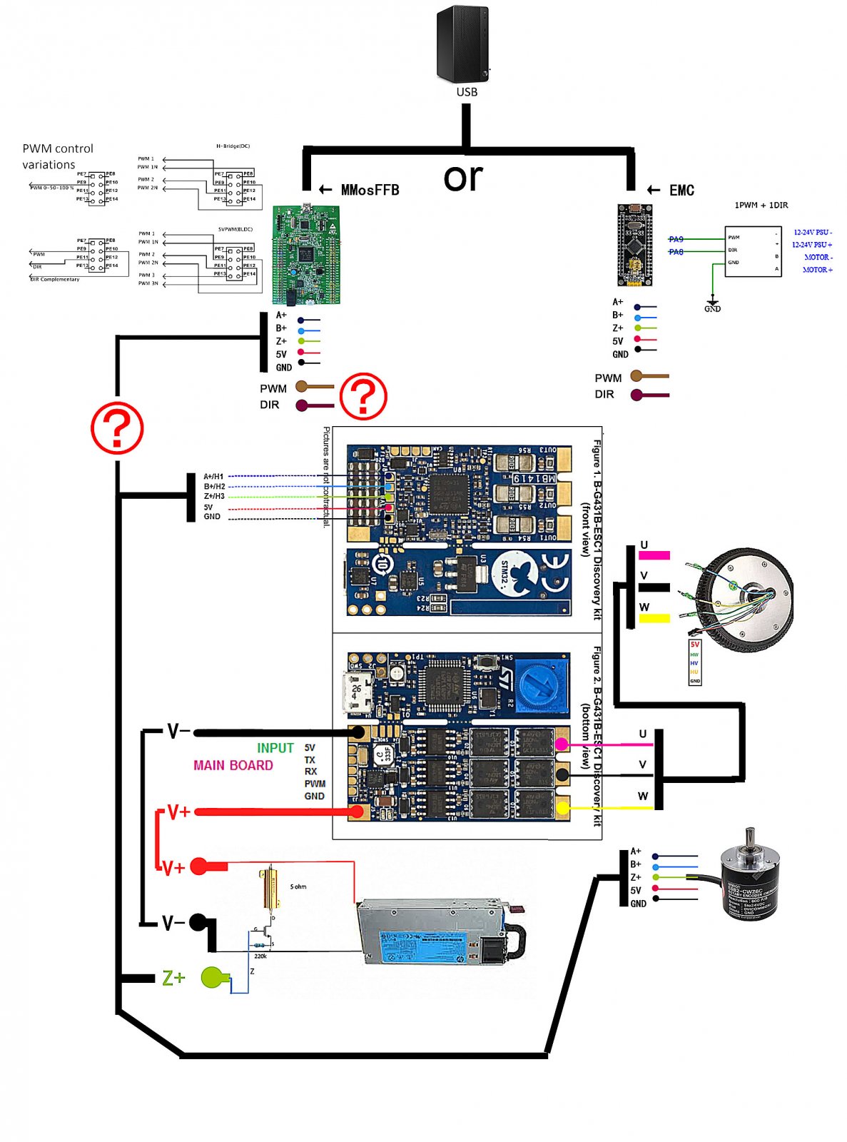

    Try to establish a connection to MMOs or EMC with my limited knowledge

  5. danove_b
    danove_b Active Member
    Nov 11, 2017
    201
    Sweden
    1,686Coins
    +76 / 3 / -0
    The ESC card has only one PWM input, so you must configure MMOS to use the 0-50-100 output. (0 = -100, 50 = 0, 100 = 100). Also the Z input cannot be connected to the encoder when you use it as an output for the braking resistor.

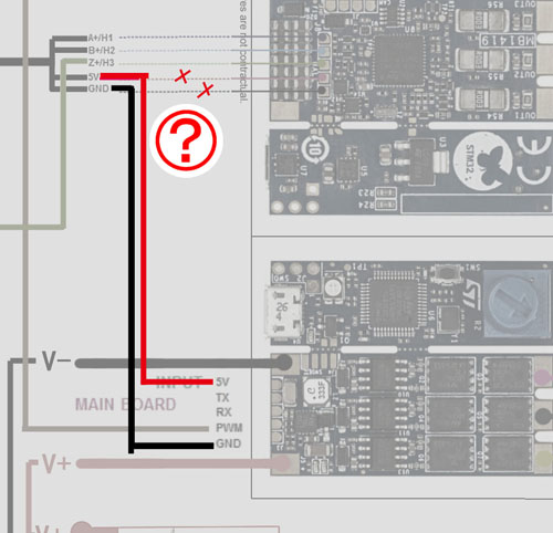

    f
    Thank you very much. I don't know if the current wiring is correct

    Should 5V and GND be connected like this?

  8. danove_b
    Nov 11, 2017
    201
    Sweden
    1,686Coins
    +76 / 3 / -0
    It's the same 5V and GND so you can connect it where it suite you best. About the Z signal, you could still connect the Z signal between the MMOS and the encoder if you want, but if you have geared it down like me you have no use for it actually. The Z from the ESC should only be connected to the braking resistor circuit.

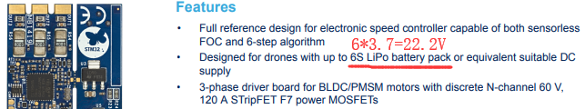

    D, B-G431B-ESC1 driver board using 24V power supply will damage the driver board

    D: Yea. I wasn't aware of that at first, but you don't need more then 12 Volts for the application.

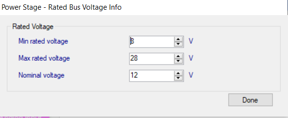

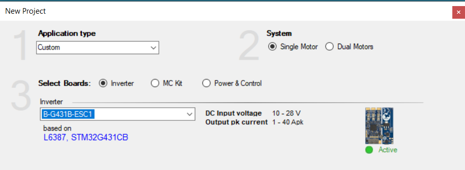

    When using the G431B-ESC in an STM Workbench project, automatically filled in values for supply voltage are 10V-28V and powerstage values are 8V-28V. So there seems to be some headroom.
    "Nominal voltage" is filled in from motor parameters.
