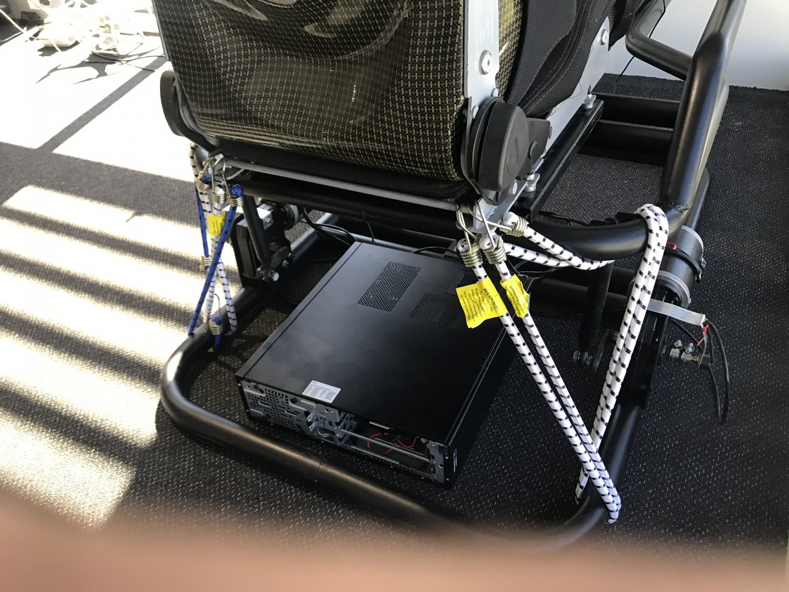

    uurrghh.. just checked all the tracking on the various bits and bobs i need to get this rig running and everything appears to be arriving this week except the cnc couplers (ill use some rubber hose till that shows up) and my really nice silicon covered 12 gauge cable.. either i thought it was going to take me alot longer to build the rig or i wasnt paying attention on ebays estimated delivery. the china post tracking info says its still 4-5 weeks away.. guess im heading down to the shops and paying more for crappier cable..
    just sat my old man on the rig and sent power to one of the motors full tilt off a car battery to see how it coped being fully loaded.. haha wow its quick.. should be pretty violent..
    it scared him a bit.. very excited to get these motomonsters hooked up..
    i purposely designed the mounts so the motors can spin full 360 deg without hitting anything incase of malfunction

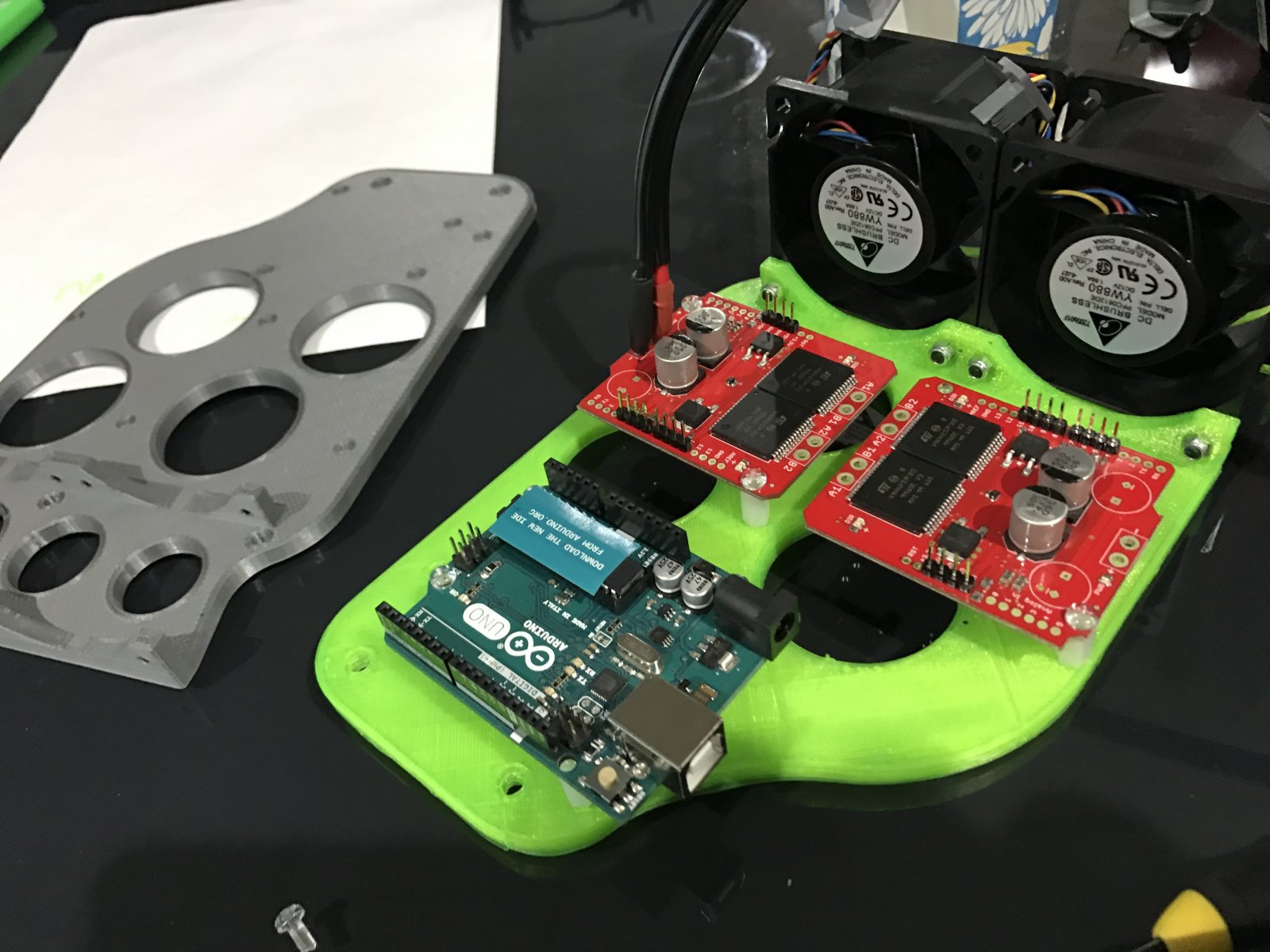

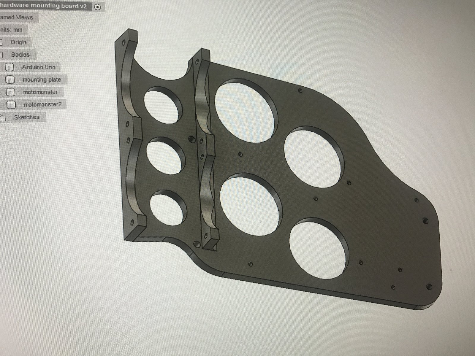

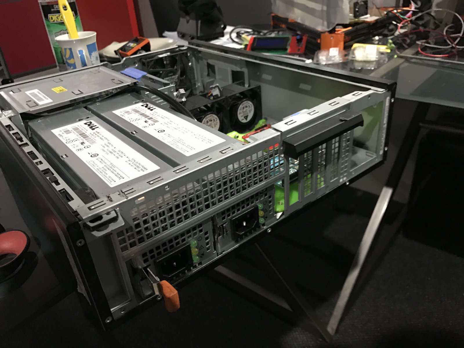

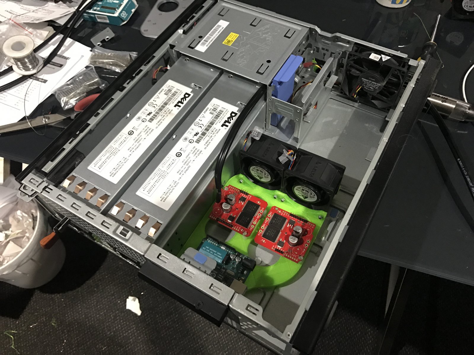

    While I wait for stuff to arrive, I thought I'd make a start on the electronics enclosure.. Decided to upcycle an old computer chassis from work as we've just upgraded a bunch of old machines. The dell power supplys fitted well after I took to the case an angle grinder, hammer and tin snips.
    3d printed a platform to mount the motomonsters, arduino and the fans that came free with my power supplys... I tested the fans out today, they're a bit noisy. Might have to slow them down somehow. They say theyre brushless, 12v and have 4 wires. So with any luck I might be able to send them a PWM signal from the arduino for speed control.. later.. will run them noisy for now
    Heat sinks with integral fans (northbridge style cooler) for the MMs are still ages away like the power cables, so just going to run some I found at the local nerd shop this evening and hope my jet engine fans will keep everything cool.. I'm sure they will.. as they blow around a category 6 cyclone wind, and with the way the case is now it makes a really nice tunnel of wind over all of the electronics
    the fancy shape, and speed holes on the electronics mount isn't there to be fancy, it cuts the print time down by about 40% from my first design which was far more boring
