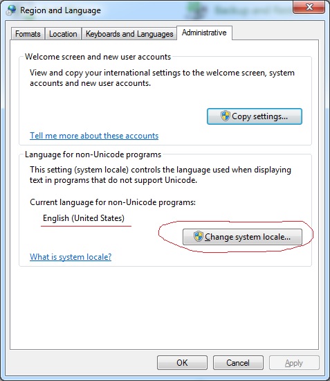

    i succeed with ATS and ETS2 , the both games works now but simvibe don't work anymore, conflict maybe ?
    i only changed the virgule for a decimal point in windows like here :
    ps : i re-patch the game too
  9. yobuddy
    5,411
    50,714Coins
    +5,166 / 19 / -0
    try this maybe,

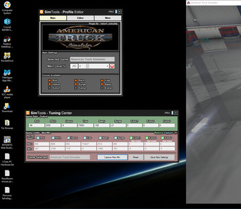

    Hello everyone,
    I have serious problems with the actuators movement in American Truck Simulator after the last update.
    Now as soon as I launch the game and try to start driving the left and right actuators move jerkily and it is almost impossible to drive.
    I noticed that opening the Game Engine Tuning Center the Game Data Output for Roll it is high (4820), while the value of Yaw is even exaggerated (78338).
    I also tried to depatch the plugin, delete it from its path and then reinstall it but unfortunately the problem persists.
    I inserted a situation screen... maybe someone could tell me how to solve!
    21,603
    151,275Coins
    +11,033 / 56 / -2
    Manually add to higher TC values, then capture Max/Min and drive around a bit then save, refine after that.

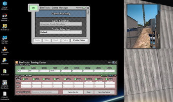

  15. Doctor Kruntz
    Doctor Kruntz Active Member
    Oct 4, 2015
    223
    400Coins
    +84 / 1 / -0
    3DOF, SCN6
    Thx noorbeast... I tried to do as you said but things are even worse!
    The dynamic movements are completely wrong and strong... and I'm afraid to broken the actuators :(
    I enclose an image of the current situation in the Tuning Center and Game Manager, where I was forced to lower the value to 20 to try to avoid too abrupt movements but without success.
    surely I'm making some mistakes but unfortunately I'm really not very practical and I normally use the SimTools default values in all games.
    I hope you can help me to solve!

  18. dhrto
    dhrto New Member Gold Contributor
    Dec 23, 2018
    11
    Netherlands
    - 45Coins
    3DOF, SCN6, Motion platform
    I had the same problem with ETS2 also. On my setup, it seems the game outputs in millidegrees and milli-G's, while the default values of the plugin in the tuning center is based on degrees and G's. Please try these values in the tuning center:
    Roll: max/min = 5000/-5000
    Pitch: max/min = 5000/-5000
    Heave: max/min = 2000/-2000
    Yaw: max/min = 180000/-180000
    Sway: max/min = 2000/-2000
    Surge: max/min = 2000/-2000
    Setup your axis assignments as you like, since that is very much dependent on your rig.
    Hope this helps. Please report back for others to know. Good luck!
