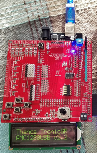

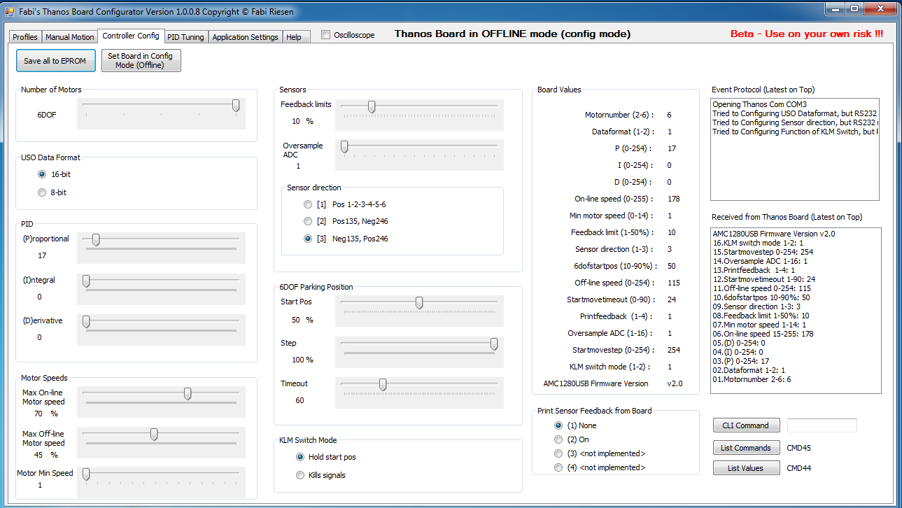

    There is already Autotune and configurator software for the AMC1280USB, and it will be updated to include additional features that were added so far and the new ones that I'm adding now.
    And here is a list of the AMC1280USB features (I won't compare to arduino as they run on different language). The arduino runs on C language, while the AMC1280USB runs on Bascom with raw optimized Assembly snippets for the time critical processes and interrupts.
    The internal loop runtime of the controller is 1000 times per second, and its scaling down or up depending on the sensor input or output components selected. All the settings can be done via the LCD menu system which gets disabled when the motors are in ON-LINE state (can be overridden).

    Hi, I think there is a little bit of confusion here. ARDUINO is JUST SOFTWARE!!!!! Its a BOOTLOADER and IDE to program the ATMEL chips.
    I happen to use a ATMEL chip, the ATmega1280, which is conveniently widely available on some older versions of Arduino Mega boards. I use those as they already have the Atmega1280 chip I need and the FTDI chipset already mounted. I get these boards and I FLASH my own custom BOOTLOADER that is not arduino at all. The Custom Bootloader I use is designed to decrypt the free firmware updates I have available for all existing AMC1280USB owners, old and new. The AMC1280USB firmware is compiled using Bascom and Assembly, does not have any C and DOES NOT use any arduino code or libraries.
    Now the beauty of using those ready ATmega1280 boards is that I can replace them easily if they are damaged, or like in my latest offer, existing AMC1280USB owners can re-use them in newer PCB's for easy upgrade of the AMC1280USB hardware.
    https://www.kickstarter.com/project...erface-for-motion-simulator-pla/posts/1944444
    I hope that clears any confusion. So it not a easy as you think to compare the AMC1280USB to an arduino as they are not the same things at all!.
    Besides the "arduino" drives the sabertooth via serial interface (possible delay here for transmission of data if not wrong), while the AMC1280USB drive the Sabetooth using 12-bit DAC analog voltages (up to 8 of them in latest revision PCB ).
