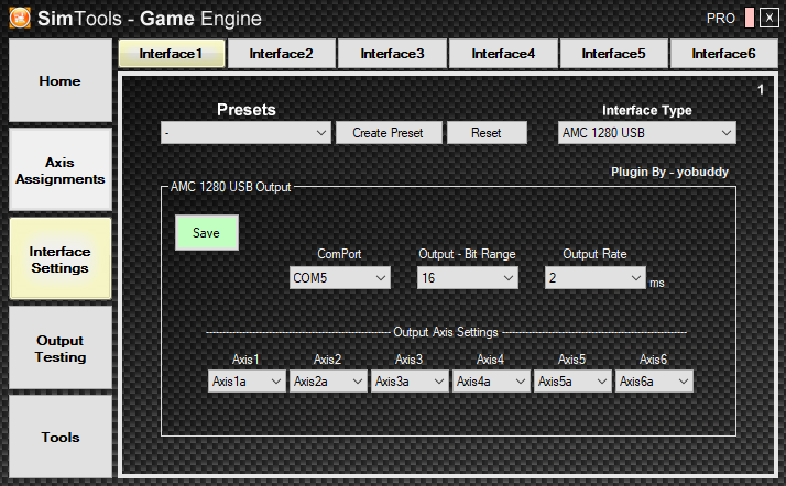

    Sorry for being bugging, but can anyone explain me the following issue. First please have a look at my configuration:
    AMC12080 all settings as suggested for using with Saberthooth, 2DOF selected, two motors/potentiometers connected on input 1 and 2. SimTool settings:
    upload_2018-10-25_22-17-7.png .
    Axis Assignments are EMPTY (a) and (b)
    When I start Output testing one motor is moving (!!) on Axis 4a when choosing Axis Output. How is this possible?
  16. yobuddy
    51,757Coins
    +5,206 / 19 / -0
    Wrong firmware on the AMC?

    hi try used old version amc 2.0- or 2.4 + old simtools 2.2.5
  19. yobuddy
    51,757Coins
    +5,206 / 19 / -0
    I believe you want 3.1 on the AMC to use it with v2.3 of Simtools.
  20. Pit
    3,007
    30,517Coins
    +3,098 / 31 / -0
    Ok, tried old 2.4 firmware but not with old version of SimTools, should give it a try
    ...and that means what? That this does not match?
