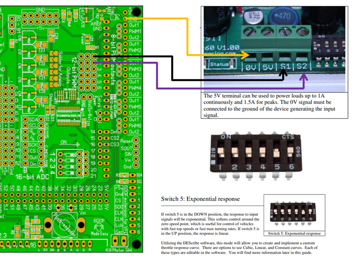

    According to the manual for the Sabertooth 2x60:
    https://www.dimensionengineering.com/datasheets/Sabertooth2x60.pdf
    You need to connect the Ground and S1 and S2, do not tie together the 5V from the Sabertooth to the AMC1280USB 5v...
    Also the DIP switches on the Sabertooth should be as above, as it will make the response smoother around the zero speed of the motor.
    If the output signal from the AMC1280USB is a little lower than 2.5v and the motor doesn't stop, you can adjust that using the:

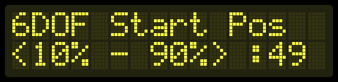

    No! This will put the AMC1280USB in output test mode... do you see the numbers scrolling in the lcd?
    Dip switches on AMC1280USB should be:
    Sw1: On
    Sw2: Off
    Sw3: Off
    Sw4: Off

    On a 2x60 I was going to say all should be on except for #4 but I suppose you should know how to set it for use with your controller. So you like switch 5 off to use exponential response vs. linear? I would think one would want a linear response. And switch 4 being on is using mixed mode. I thought your controller outputs 0-5v signals to S1 and S2 for controlling 2 motors? In mixing mode, "The analog signal fed into S1 controls the forward/back motion of the vehicle, and the analog signal fed into S2 controls the turning motion of the vehicle".

    The switch4 does what it says, mixes the two channels together...
    But the AMC1280USB does not mix the outputs. So no.
    The exponential response is recommended as its complimentary to the pid control and allows small movements around target position.
    See Markus example here:
    http://6dof.my.primusnetz.de/thanos/
