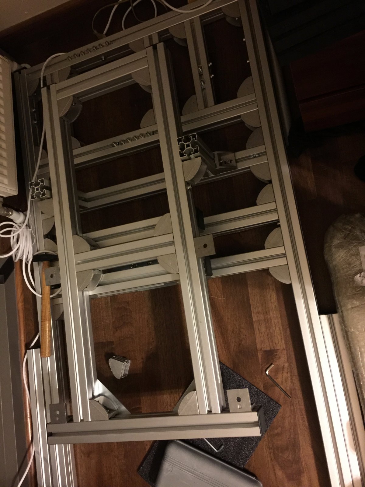

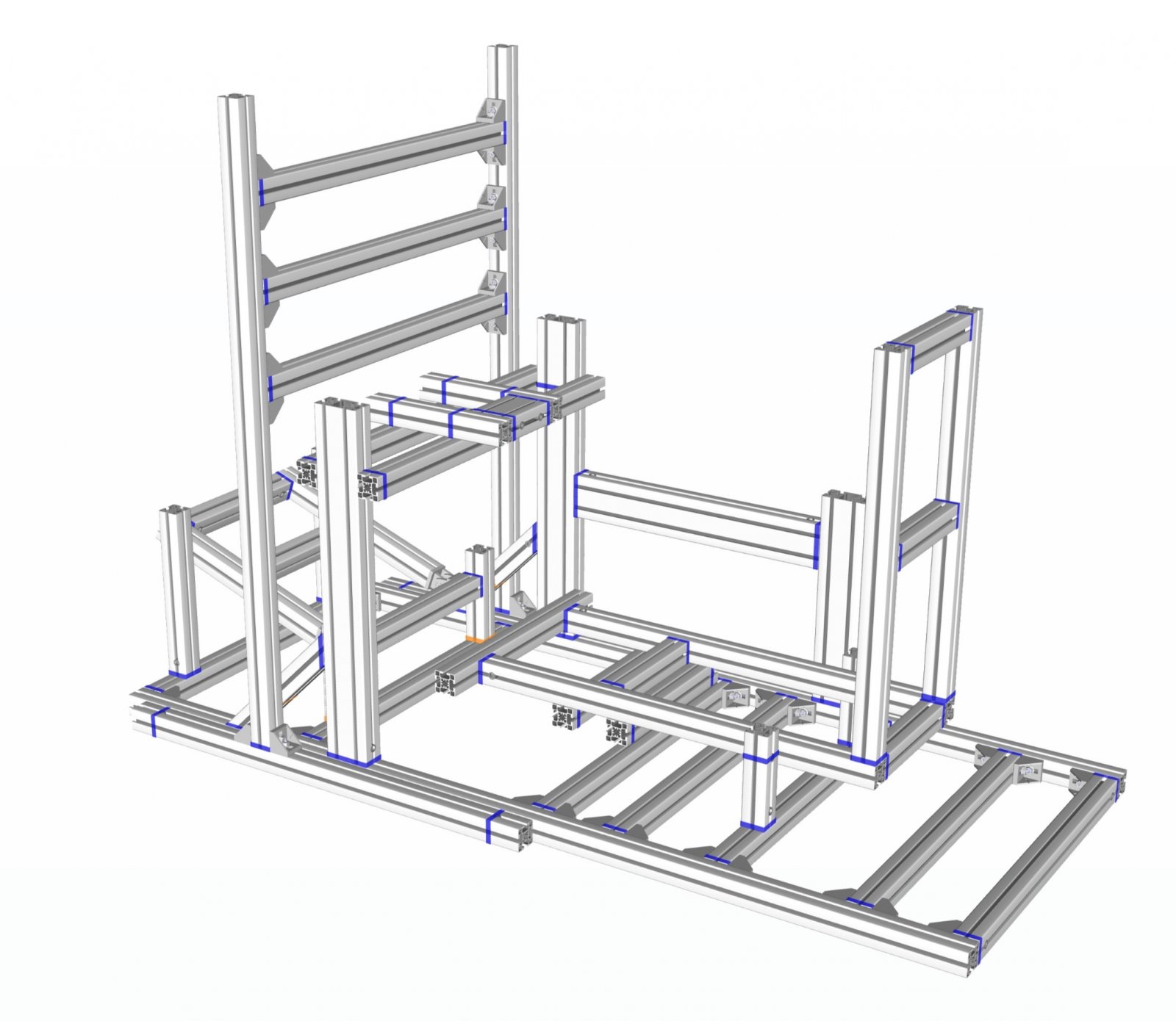

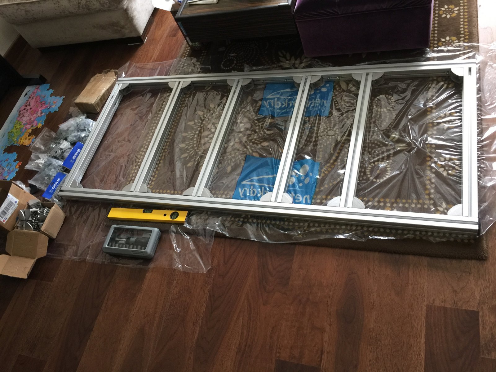

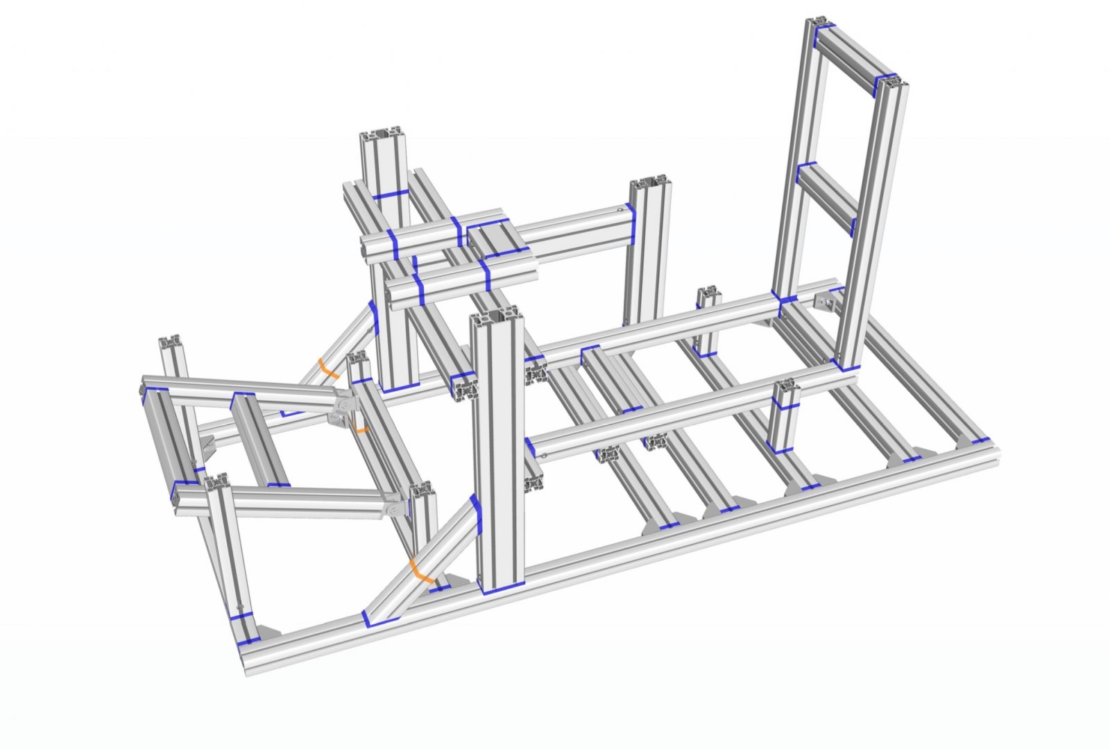

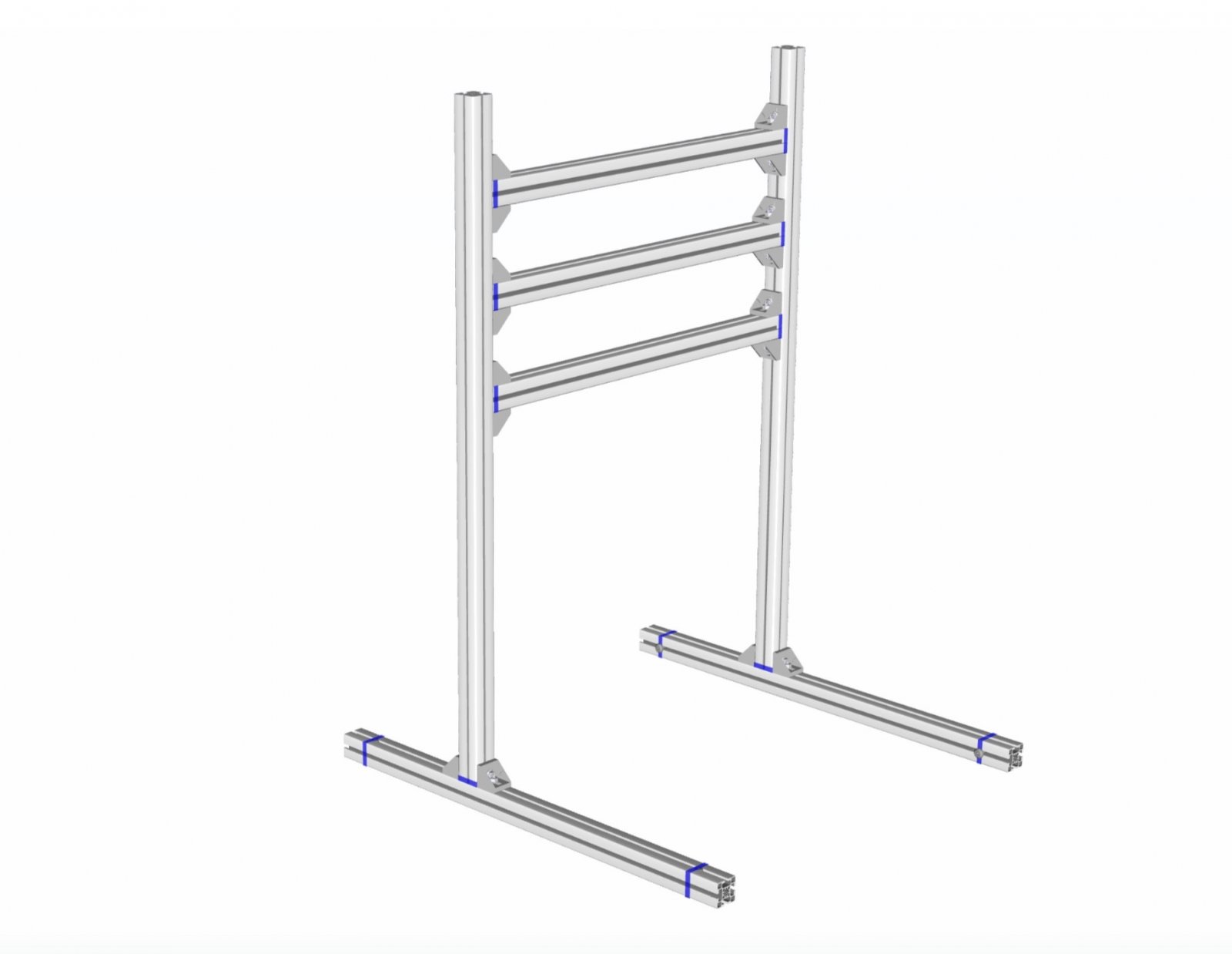

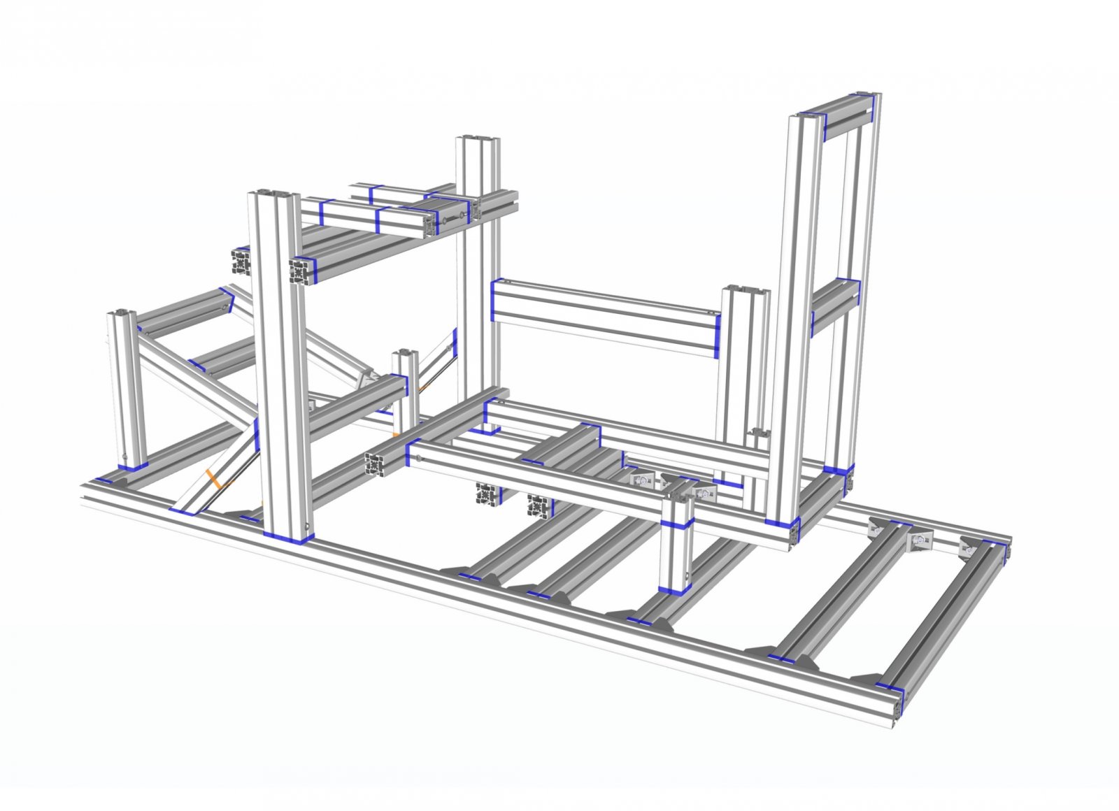

    Starting building my sim racing rig with aluminum 80/20 profile parts, a projector screen, and a DIY 2DOF seat mover (shoulder type). I will keep updating the thread with my progress.
    Main parts:
    Rig with 45mm profile parts
    Rig dimensions:
    Approx. length: 175 cm (exact length depends on pedal position)
    Width without screen: 85 cm
    Approx. screen width: 110 cm
    Overview:
    *Seat fixed for now (u-joint will not be working until I fix the motors / shoulder links in place)
    MayCad file:
    I couldn't find a way to upload this file yet - I will check again.
    (Please send a direct message to me if you need it for now.)

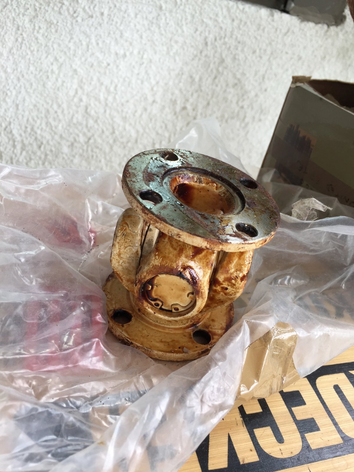

    1x Universal Joint from Ebay

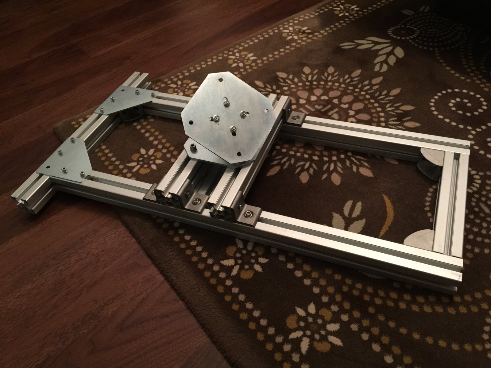

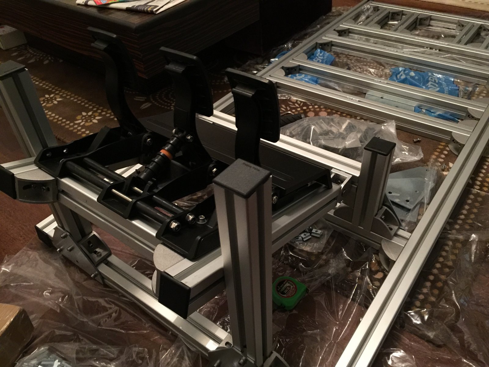

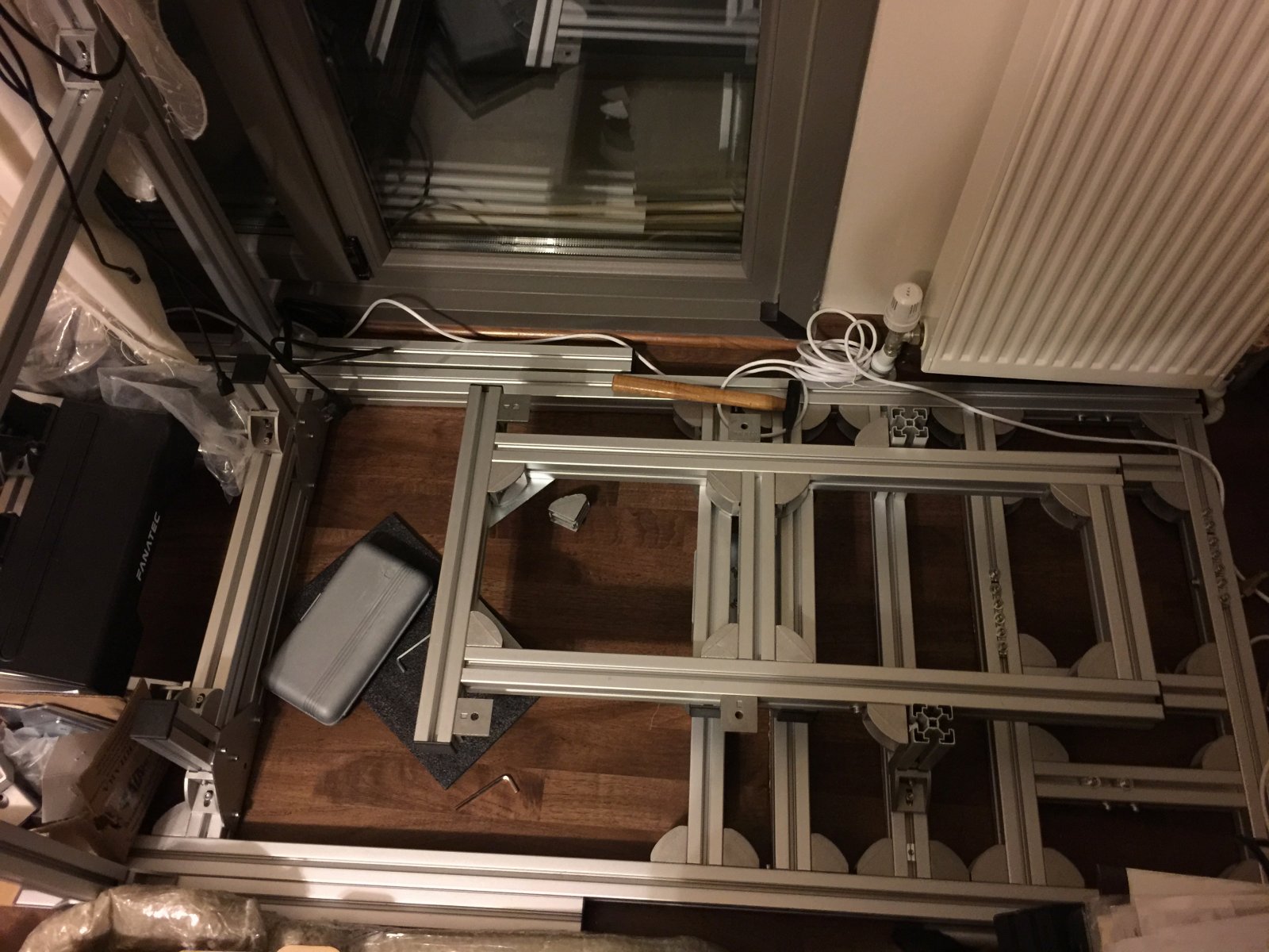

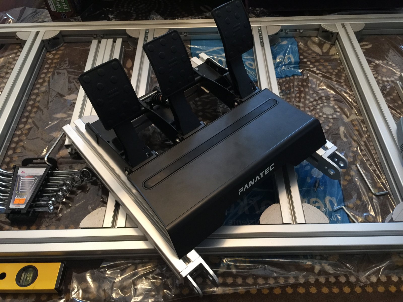

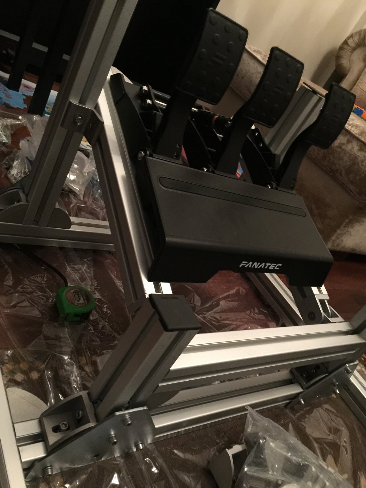

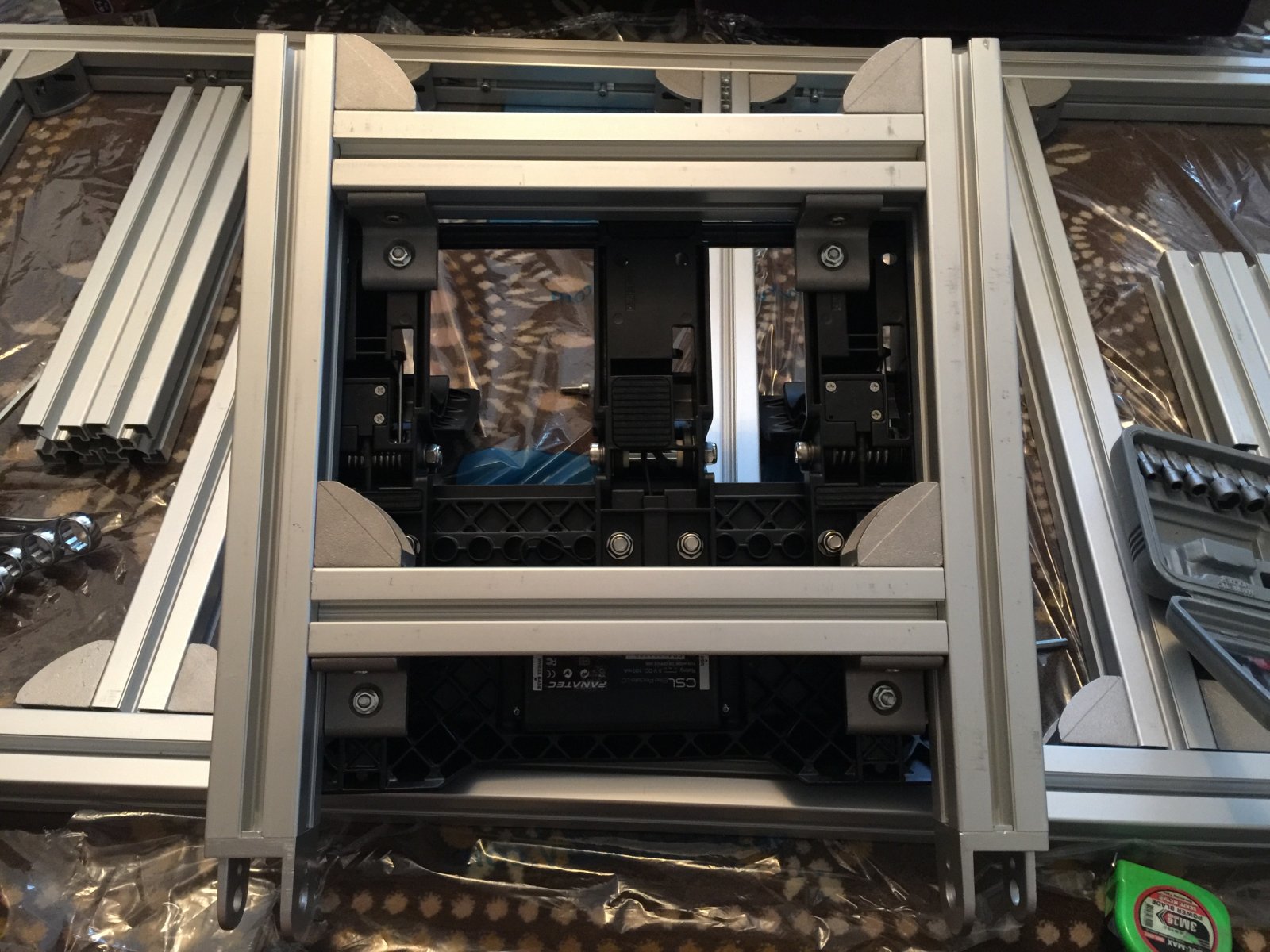

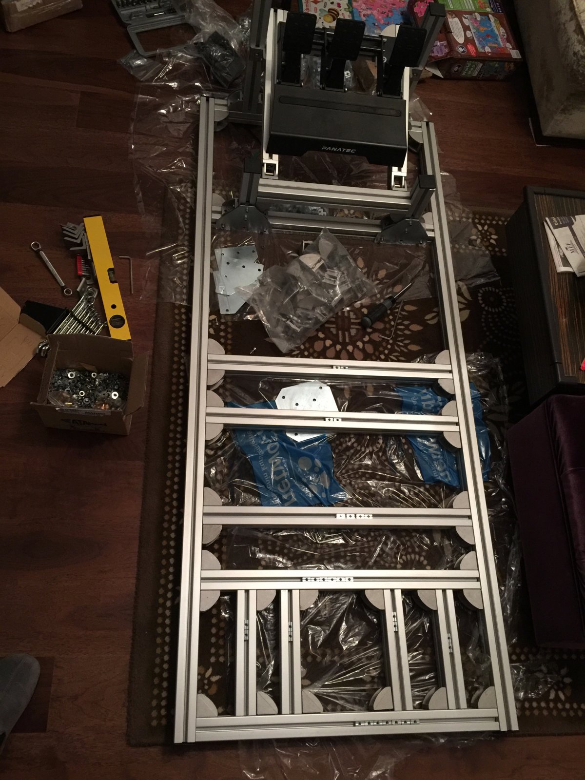

    Some pictures from recent work.
    Floor structure:
    Pedal base:

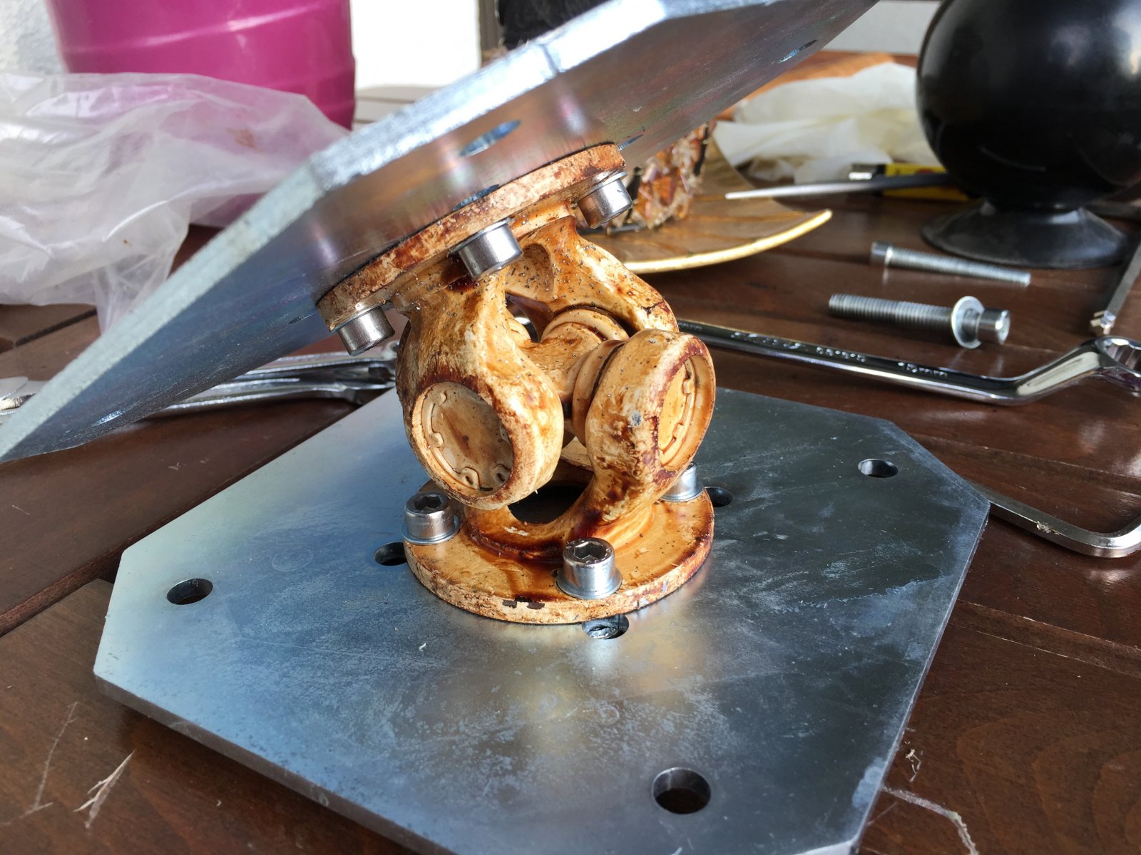

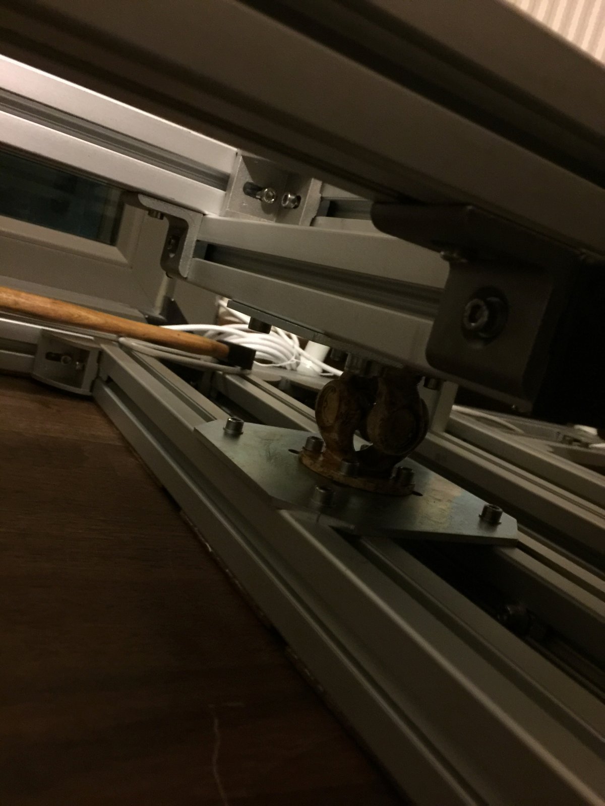

    U-Joint & Seat Structure:

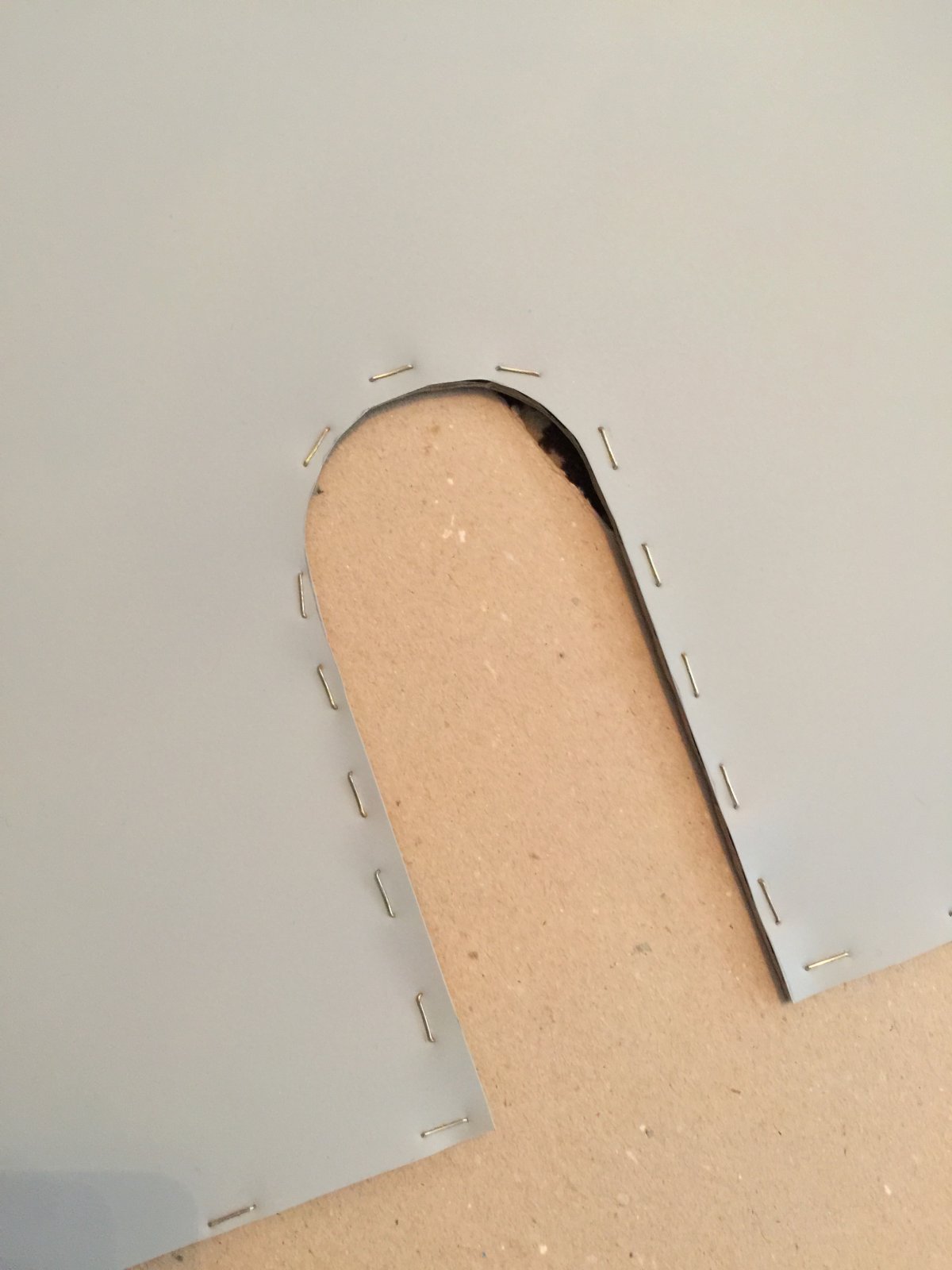

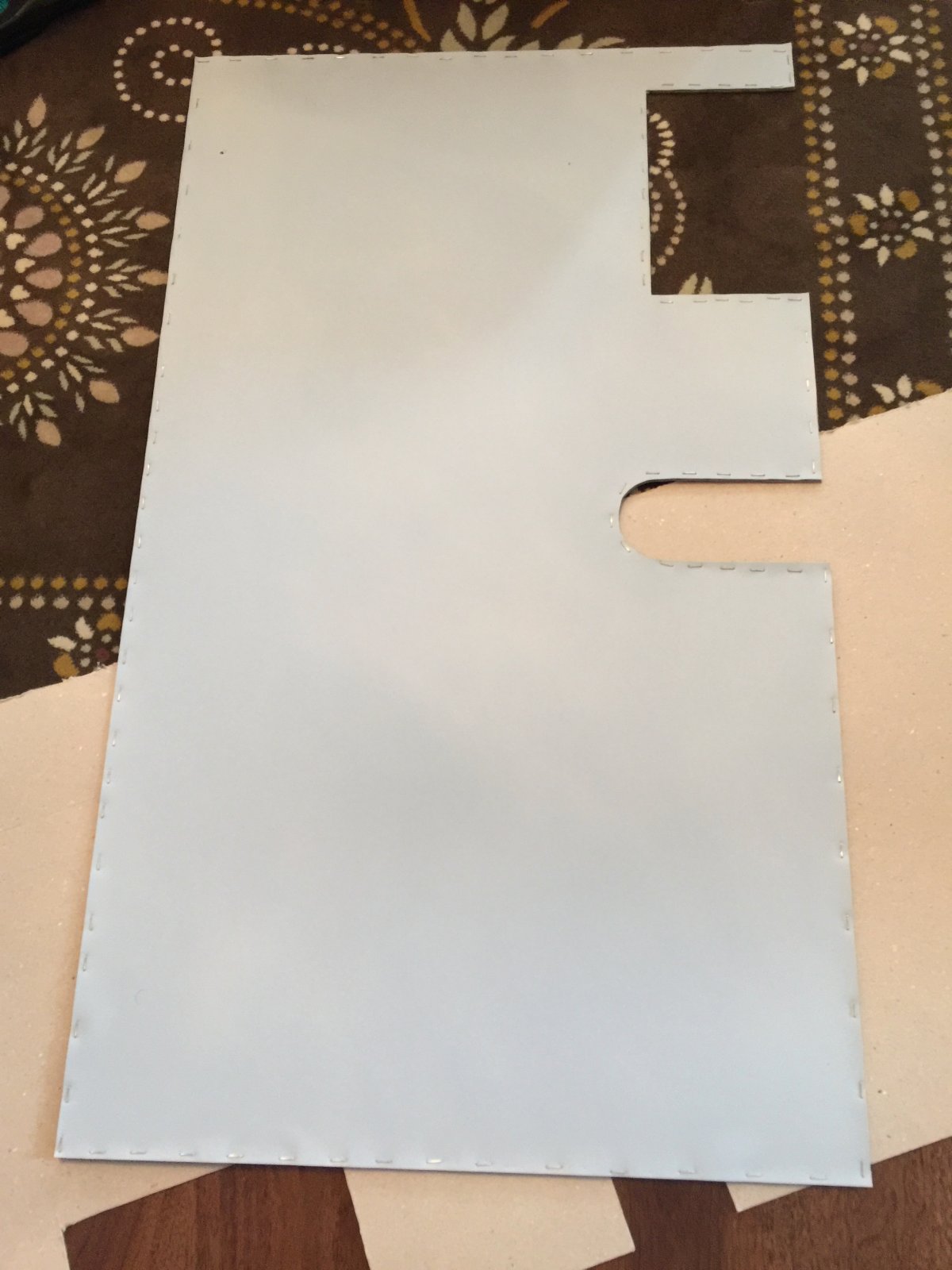

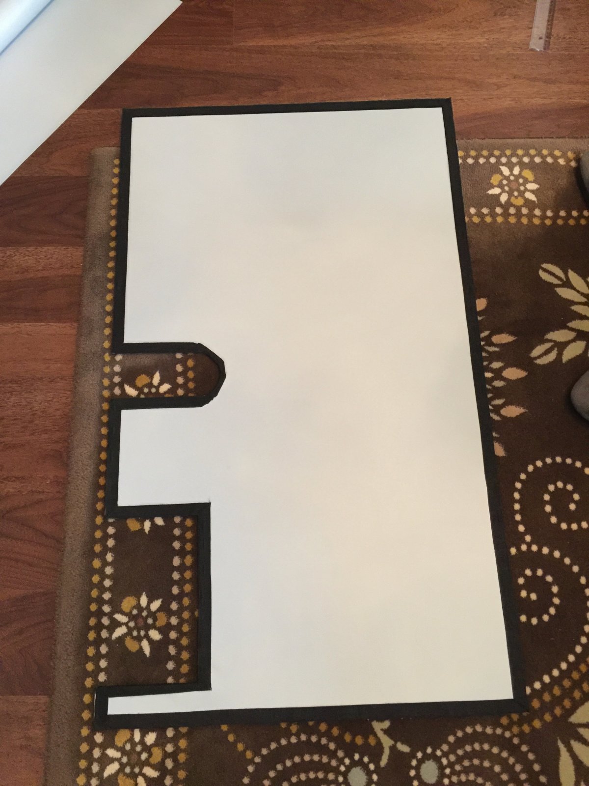

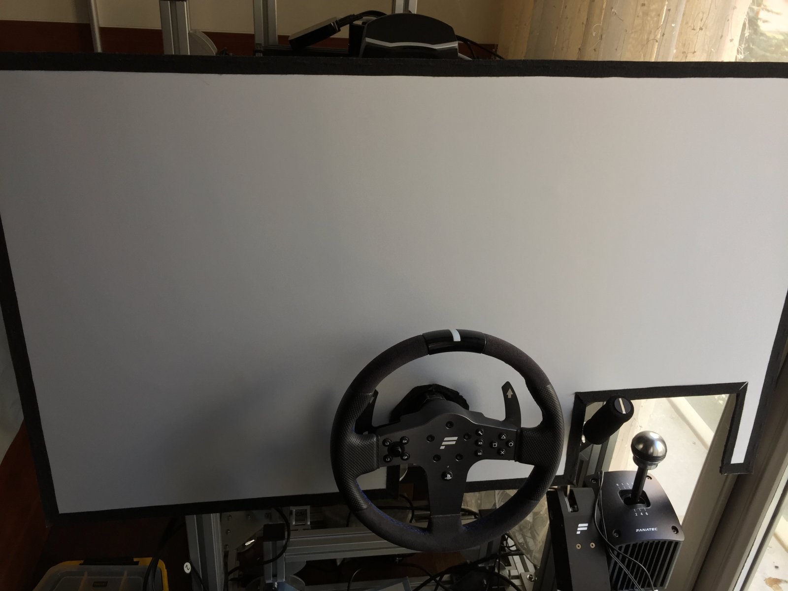

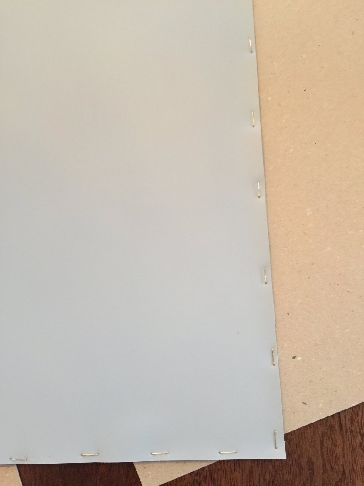

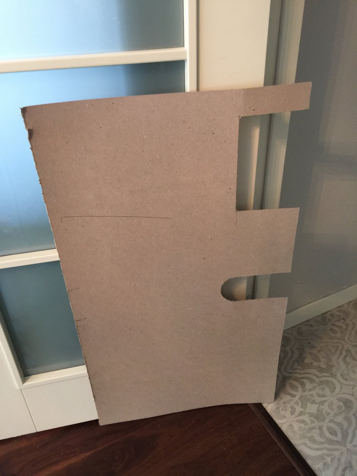

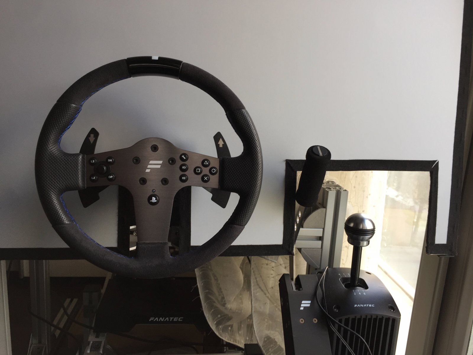

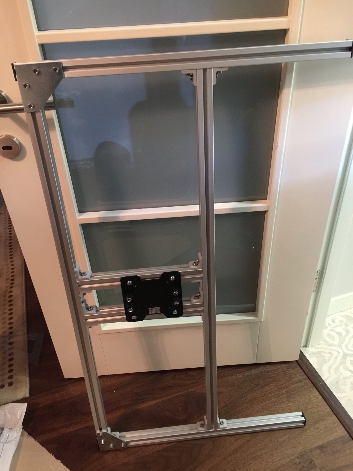

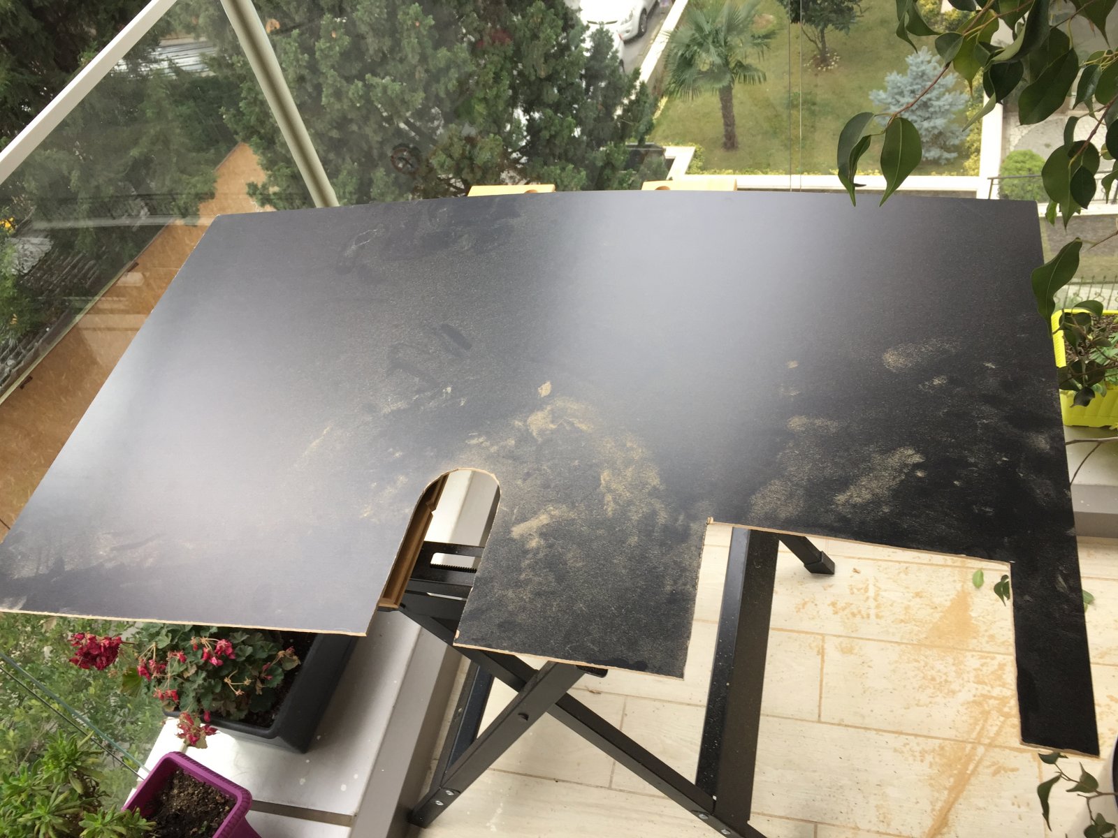

    Cardboard Template for Projector screen:
    3mm mdf board cut according to the template:

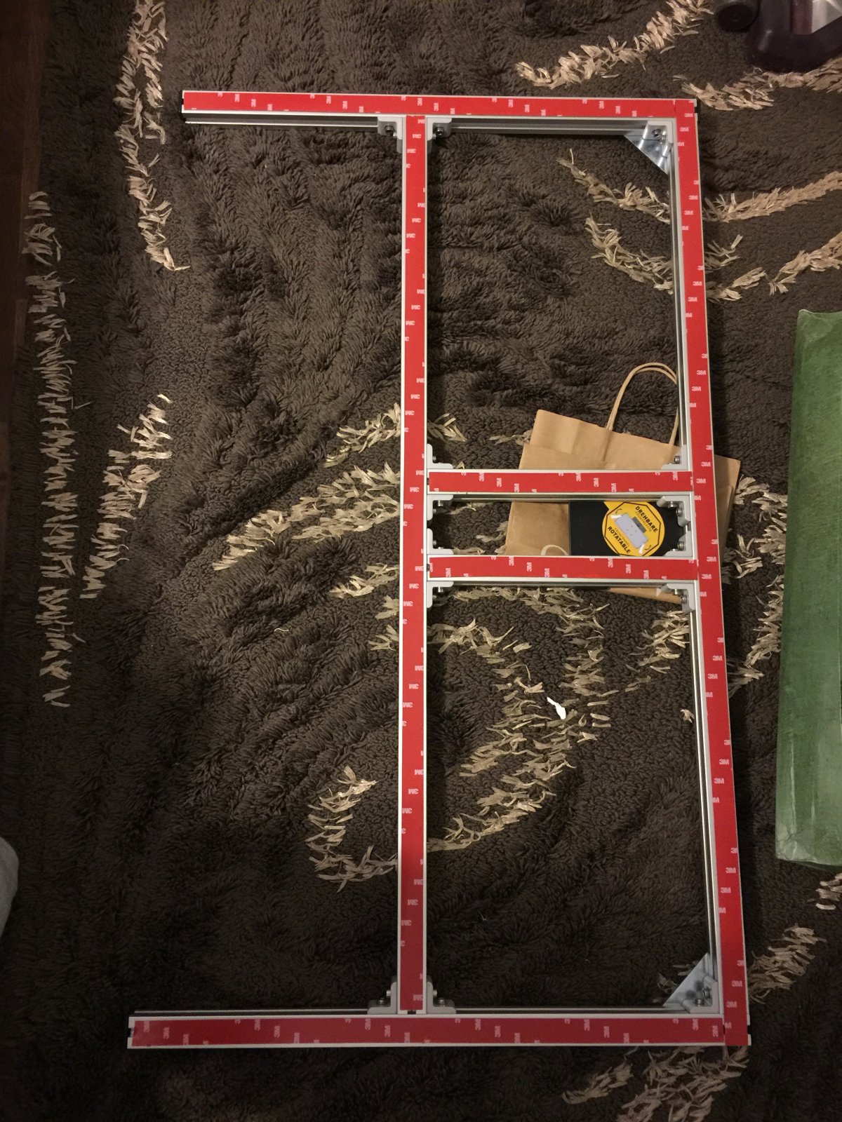

    80/20 backbone:
    Matte gray projector screen stapled on to the mdf board:
    19mm felt tape for the borders:
    Joined on to the backbone using 2 sided acrylic adhesive tape (quite strong):

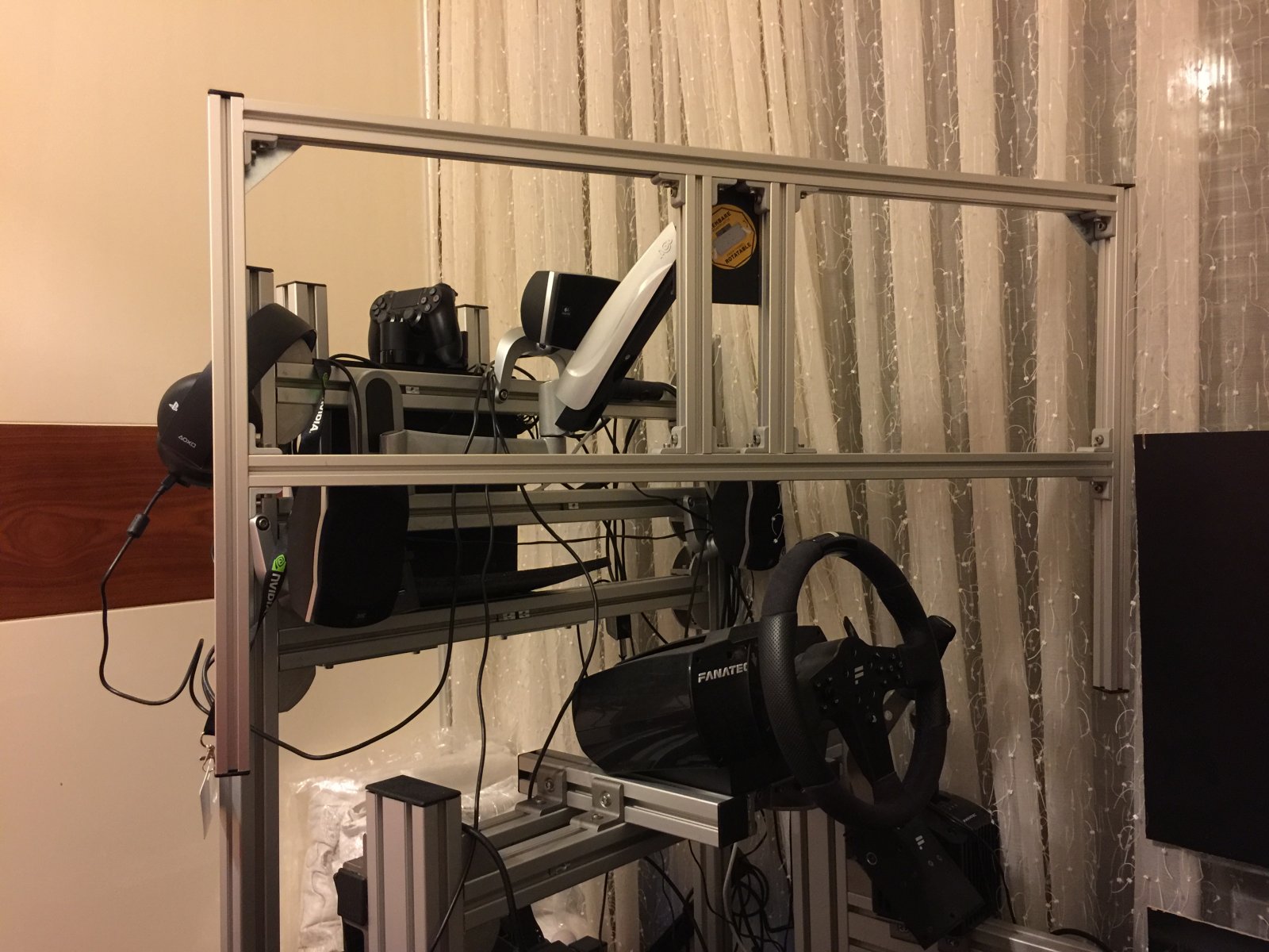

    Couple of pictures with the screen installed:

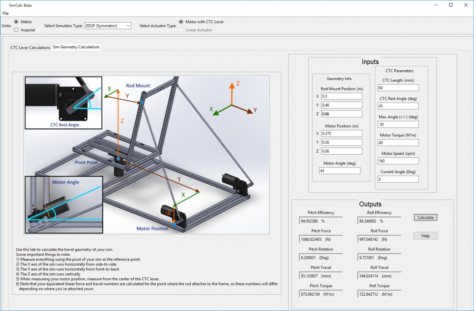

    Working on rod, lever length, motor locations etc.
    Does the following look ok to start with? (for 25:1; 40Nm / 160 rpm motors)
    I'd appreciate any comments.

    Thanks @noorbeast . I have now given it a bit more leverage.
    Not sure how to approach the tradeoff between roll/pitch angle ranges and torques - I think I will go with adjustable parts/placement as much as possible and will do some further trials on the physical setup.

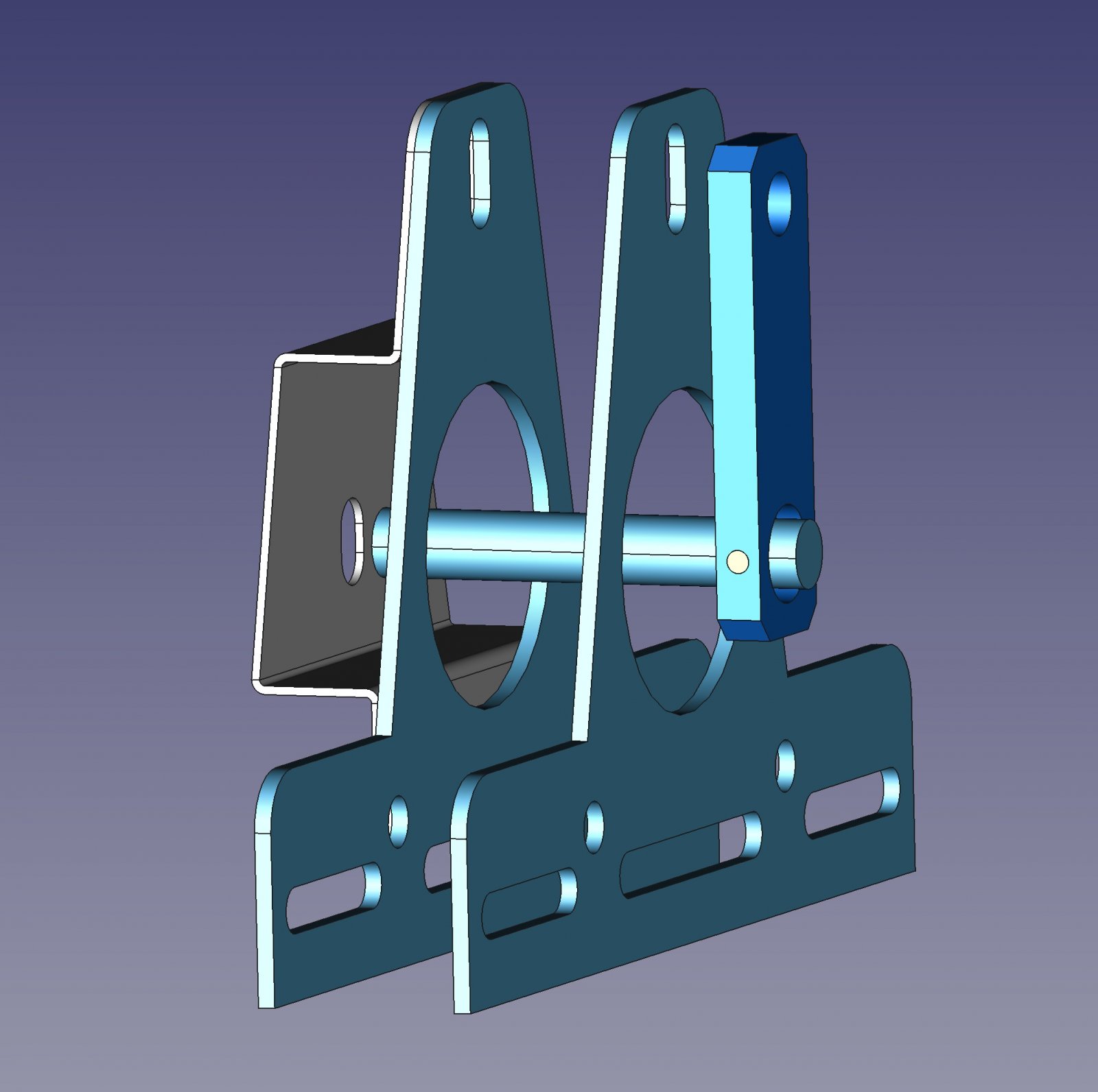

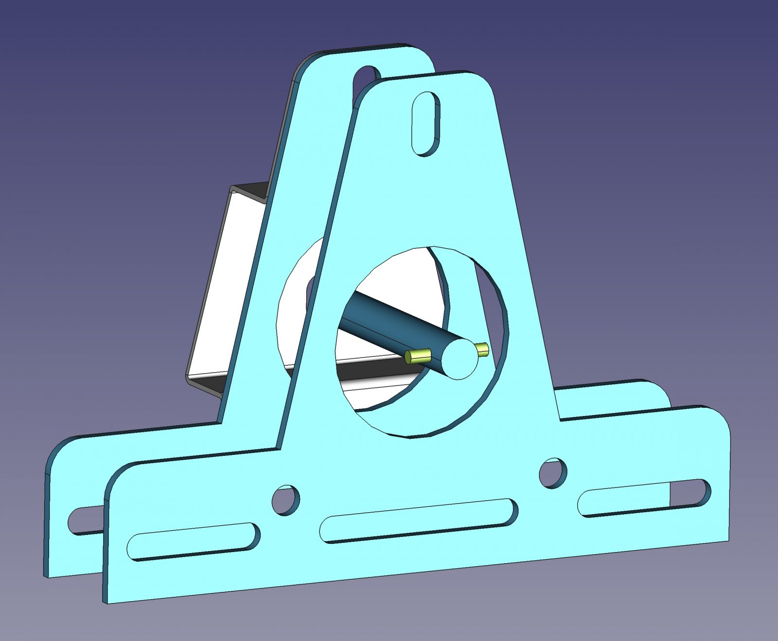

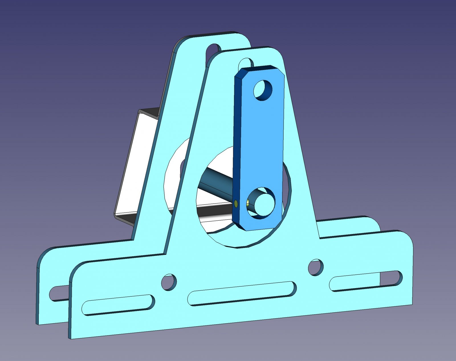

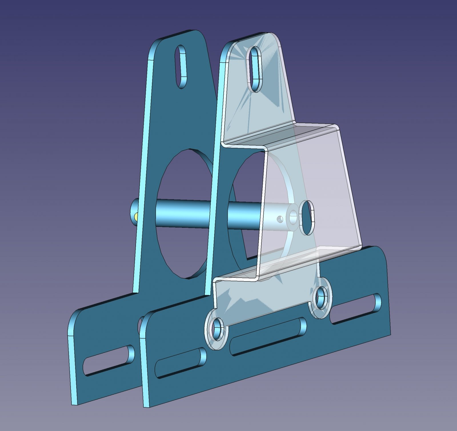

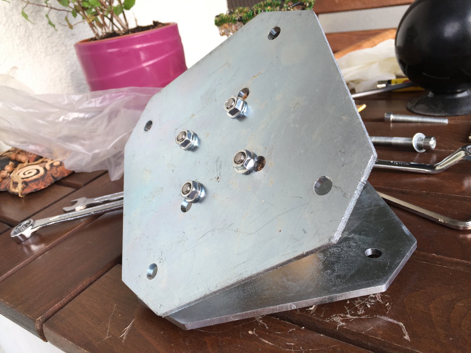

    Working on brackets, rods, levers etc. Inspired by some designs from the site & web.
    I will post the cad files & technical drawings later on.
  9. Redblues59
    Redblues59 New Member
    Feb 18, 2018
    14
    Türkiye
    164Coins
    +9 / 0 / -0

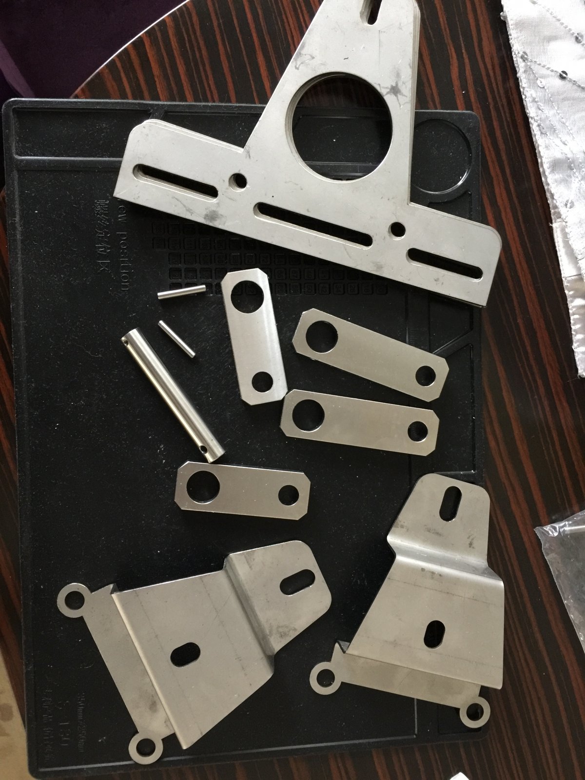

    Here are the cad files and technical drawings for the parts - attached.
    I am getting the parts produced in a local workshop - cost around 120USD.

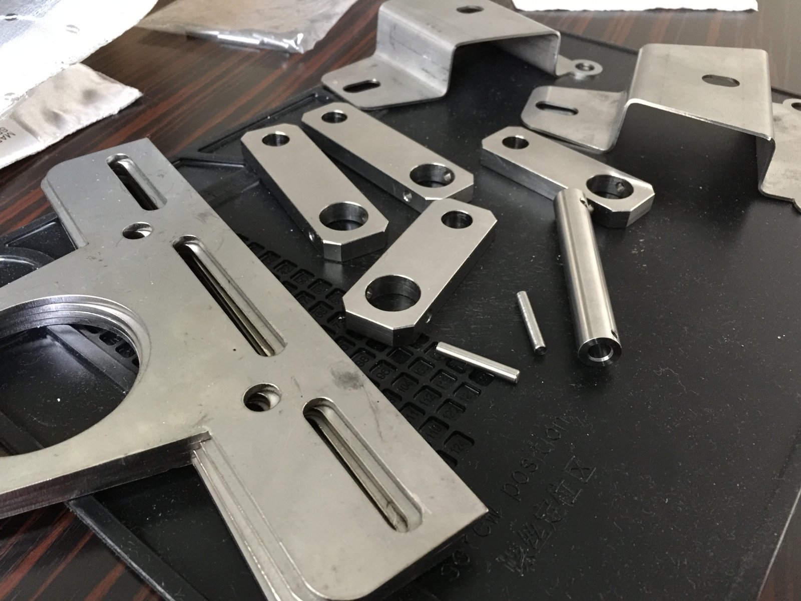

    Parts have arrived.

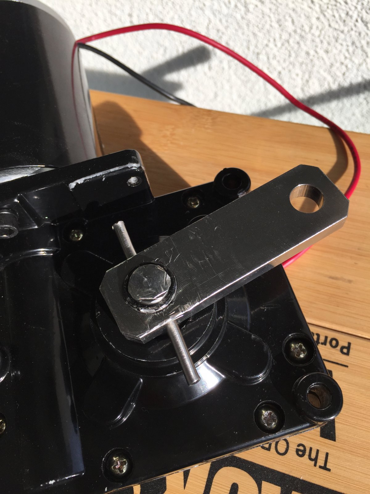

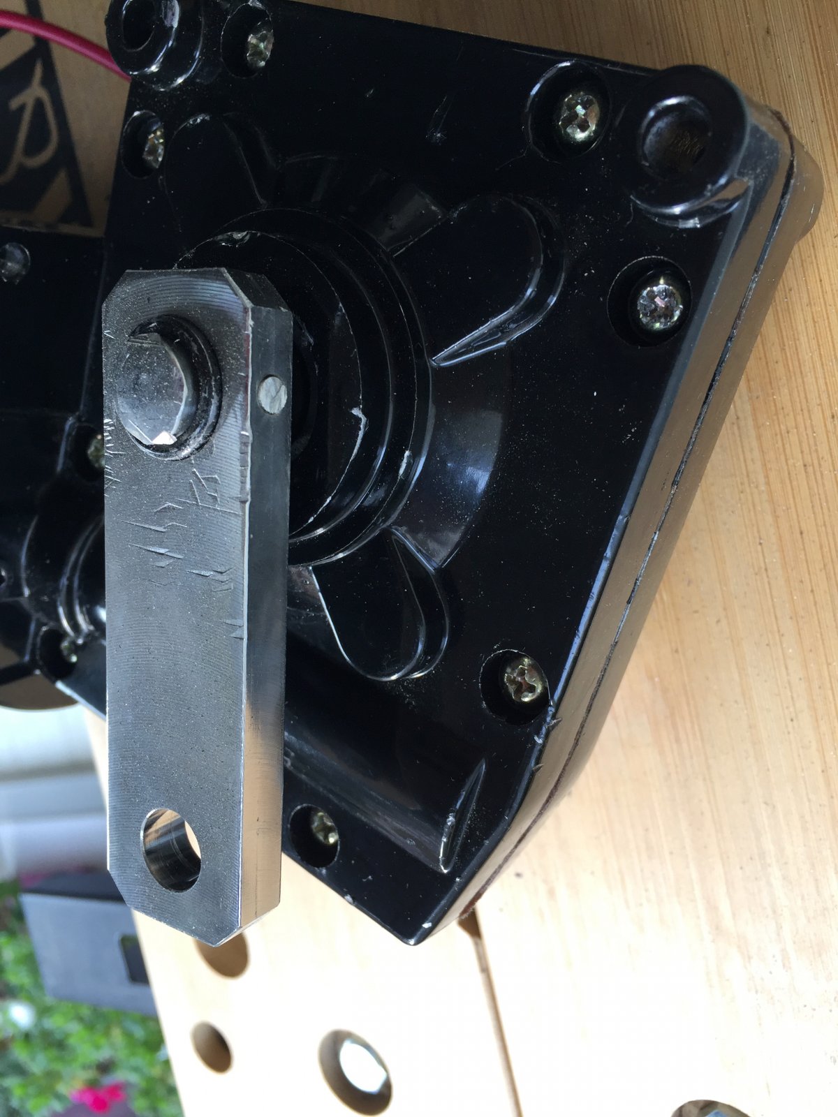

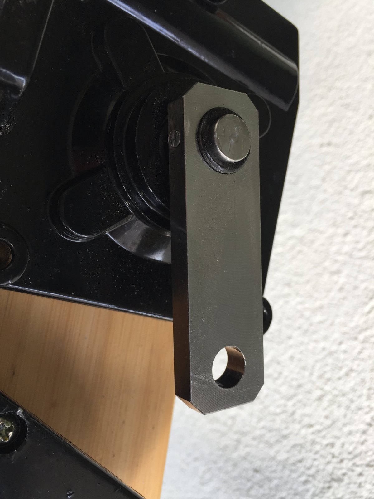

    Changing the shaft direction:
  12. Redblues59
    Feb 18, 2018
    14
    Türkiye
    164Coins
    +9 / 0 / -0
    Well, my intention was to join the solid shaft, lever and motor's hollow shaft with a snug fit 4mm pin as you can see in the previous posts. The result is not as elagant as I want it to be. Here are my lessons learned:
    1) First of all, although I had measured it, I ignored the fact that one of the motors had a slightly smaller inner shaft diameter (around 80 microns). I didn't take this into account in my drawings. Consequently I had to hammer the solid shaft into the hollow shaft heavily and couldn't make pin holes align perfectly. I had to put two pins into the hole from opposite sides.
    2) Although, it was easier to push the solid shaft into the the second motor, still I couldn't align the holes 100%. And the pin couldn't make it through to the other side. I had to use a second pin, again.
    Then, I cut the parts of the pins remaining outside. Still, it looks ok, and functions without additional backlash. However, I won't be able take the lever apart without cutting it through.
    The best approach would be trying out the parts & assembly during the manufacturing process, so that final mods can be done live.

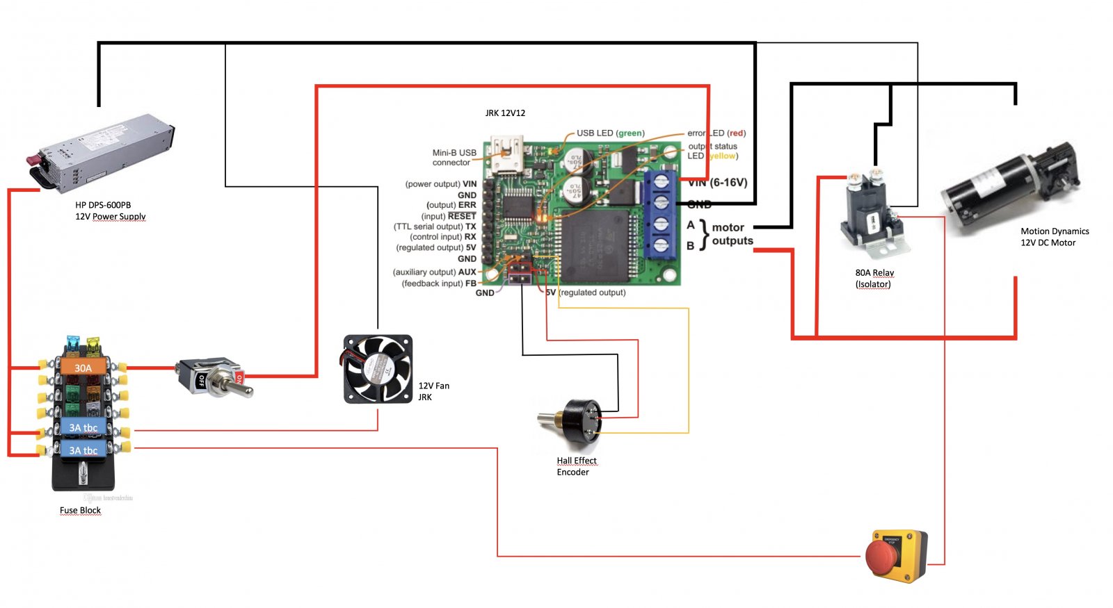

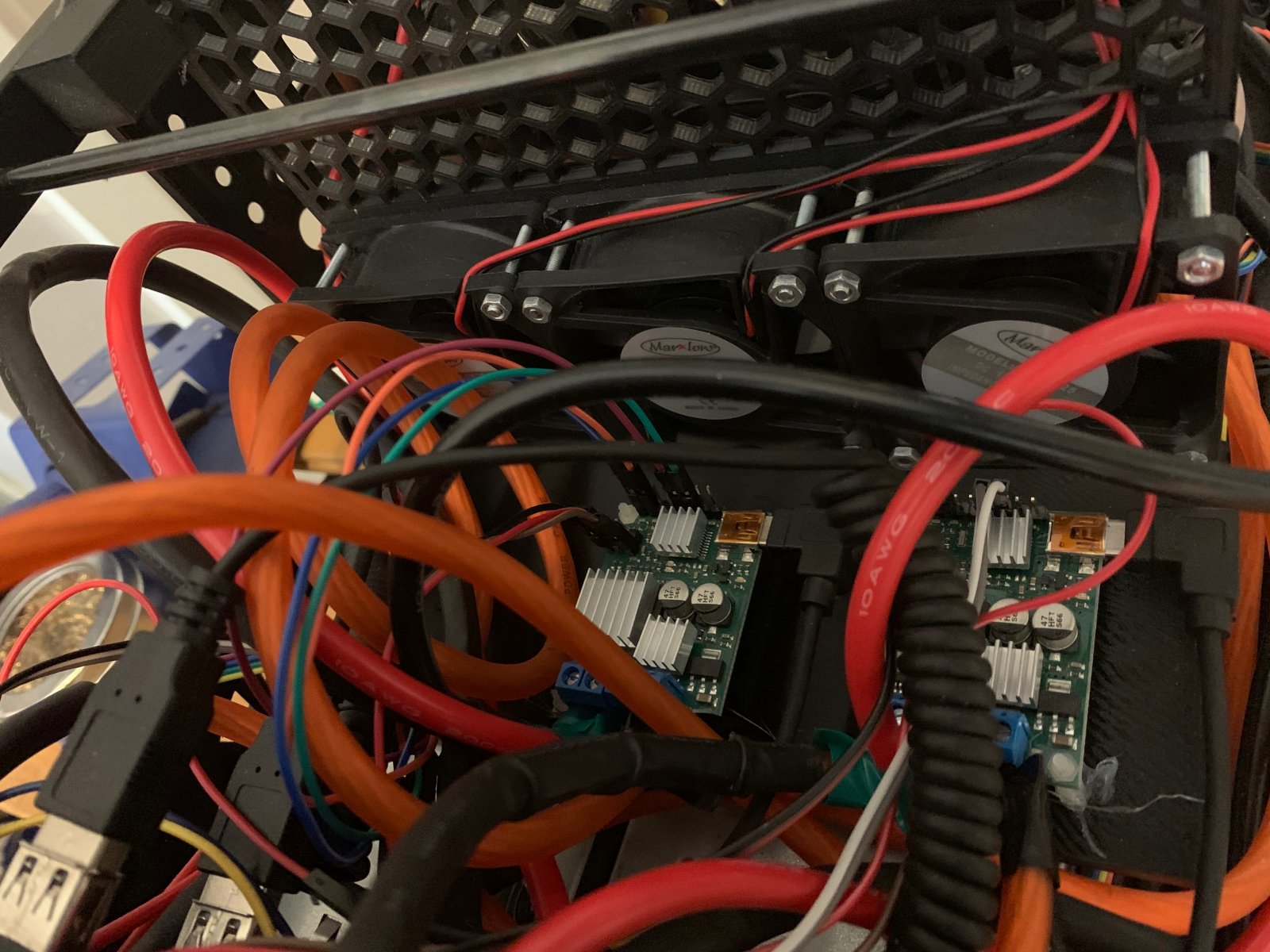

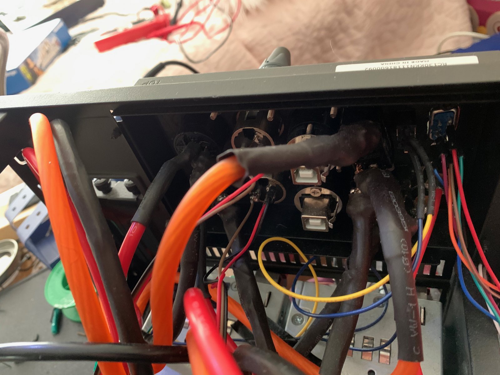

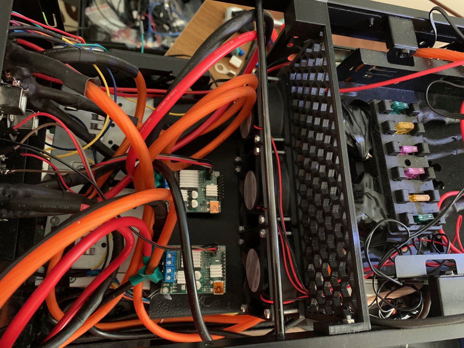

    Hi again... After a long break I am now working on the electric circuit.
    I would like to insert an emergency break (I have checked the FAQ section) and use the emergency break to short circuit the DC motor ends, and brake the motor as quickly as possible.
    I prepared the attached diagram to show what I am planning to do.
    However, I wonder if the JRK has a short circuit protection as joining the motor ends would also mean joining JRK's motor outputs.
    Could anyone please help with this - would this setup work or should I do something else?
    21,592
    151,215Coins
    I would think you want the motor connected to the relay, not the board, and it would make sense to have the fan connected to the power to the board side of the toggle switch circuit, as that way the fan would only run when power is activated to the JRK.
  15. Redblues59
    Feb 18, 2018
    14
    Türkiye
    164Coins
    +9 / 0 / -0
    Finally had some time to complete most of the electronics.
    Decided to use a circuit very similar to this: https://www.xsimulator.net/community/threads/emergency-stop-switch-wiring.5132/#post-50954
    Not neat in terms of cable order / length but working! :)
    Lessons learned: Always use flex silicon cables. And dont't use heavier gauge than required. Some parts are 8AWG - overkill most probably. Seems like 10 AWG would be more than enough on the motor line.
    Motor's cables themselves are 12 AWG (I think) anyway.
