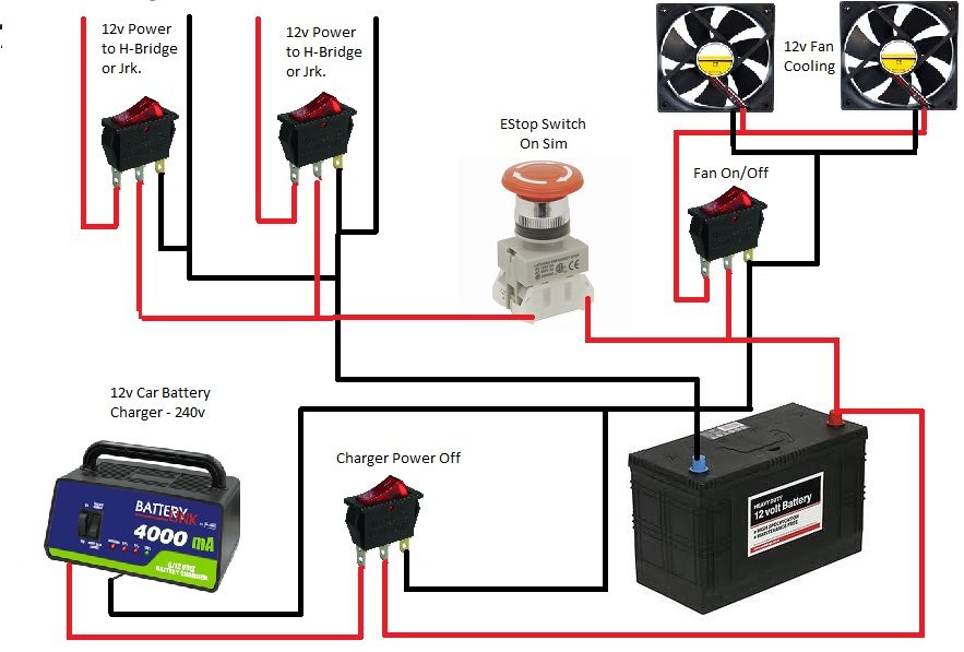

    Hey All,
    Just getting into my first sim (2DOF platform) and had a question on how to wire the stop button properly. Below is a wiring diagram created to show a single DOF. This will be mirrored obviously for the second motor, with the stop button wired to shut off both motors on a single switch. I'm pretty sure that current supply to the controller/motor should not be wired directly to the switch (most of these switches seem to be low amperage) so I need some help understanding.

    Most of the emergency stop buttons are designed to work on 240V AC with current ratings lower than what would be required for the DC circuit. So it would make sense to wire it in on the AC side of the power supply. You would need to be careful in doing this, as the voltages involved can be lethal if you get it wrong.

    I use this one from Jaycar , designed for 240v but quite fine on my DC battery system that will produce more amps than a pc power supply, one side of the switch is normally open and the other is normally closed. So test with a mutimeter to find the right side to use so the circuit is open when the switch is closed as in no power to the jrks.
    http://www.jaycar.com.au/productView.asp?ID=SP0786
    Wired like this.
    Beware earth runing to the switchs is to aid the lights in the switchs, ones without an internal led dont need the earth.
    The above circuit the Estop will kill power to both jrks but not the fans, as I like to leave them on for a little while to aid in the better cooling of the Jrks.

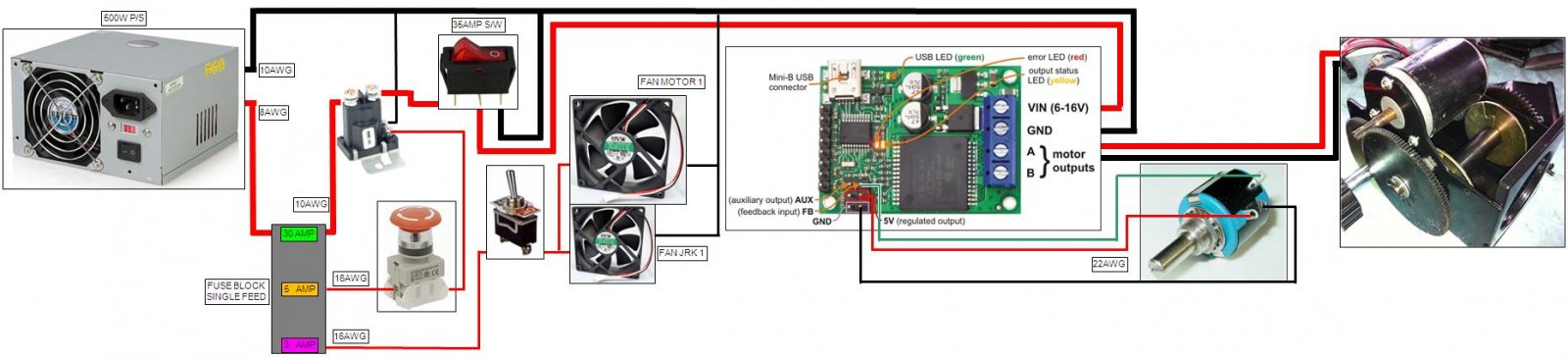

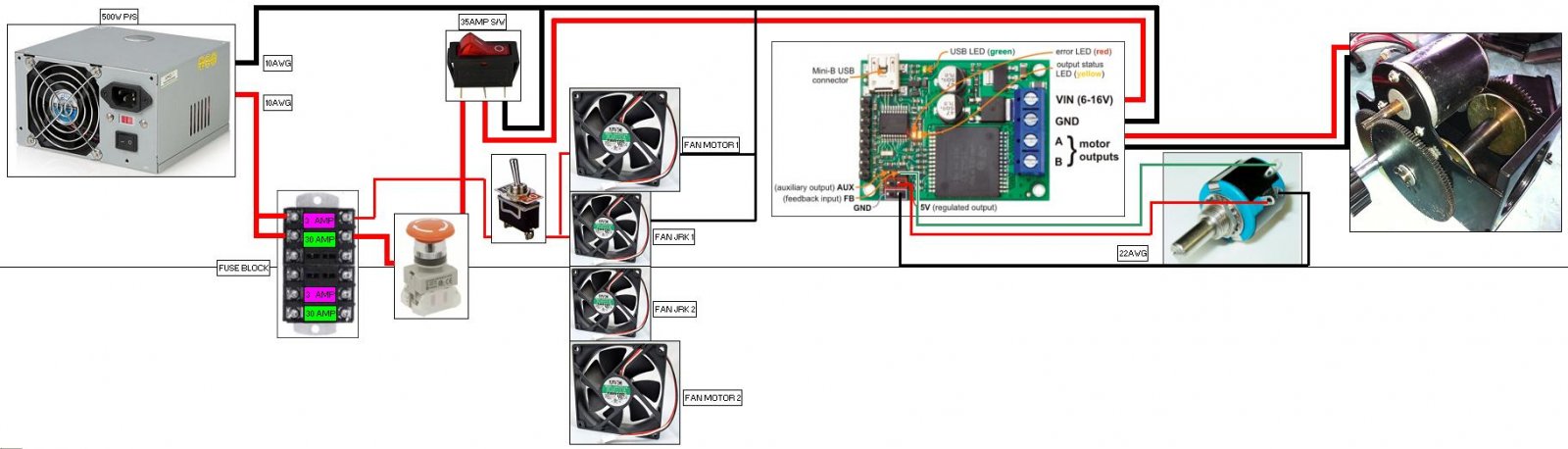

    I think I'll use a relay to turn the sim on and off in the cockpit. Amazon has 80amp continuous duty relays for $15-20 USD. I will run one relay per DOF even though 80 amp per motor is overkill, they seem to be common.
    I've updated my wiring diagram, can you guys take a look please? Here are acouple of things I like about this idea.
    1. No AC Voltage in the cockpit
    2. No High-Amp DC Voltage in the cockpit (Since the Stop Switch is 12v but low amp)
    3. Longer life of the Stop Switch (Figure with the cost of the 2 relays you could just plan to replace the switch as needed. Probablly not a huge issue as eaorobbie mentioned)
    4. Since the switch is now on a low-amp circiut (only for turning the relay on and off) I don't need to run 10AWG gauge wire all the way to the cockpit and back. This keeps the feed wire to the motor controller as short as possible, which is a good thing!

    To me overkill never had an issue, but to play safe yes looks good mate.
