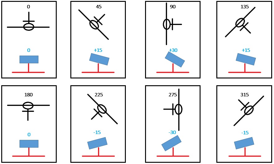

    @RiftFlyer, I'd like to test both of your plugins. It may not be for a little while as I've been away for a number of months and need to sort out some functional issues with my rig which has been sitting around.
    So if I understand correctly the initial plugin which is linked to your first post uses roll rate not roll position. As you accelerate around the X-axis in a right roll the platform rolls right correspondingly to how hard the roll was/is initiated. Stop the roll in some position, say aircraft banked right 45 degrees, and the platform will level back to horizontal. @noorbeast I know really liked this setup in other sims.
    For the second plugin, please see image below and let me know if this is how you've got it set up. You removed the link for this one correct? Could you email it to me if I PM you my email contact? Thanks!

    @boosted-lt1 the descriptions you've given for both versions are correct. I'll post the second version again when I get a chance. Adrian was to test it but I haven't heard back from him. I should find some time over the next few days to dig out the laptop and attach the second plugin here.

    ps those pics above from boosted explain well how it should work
    looking forward to test ping it

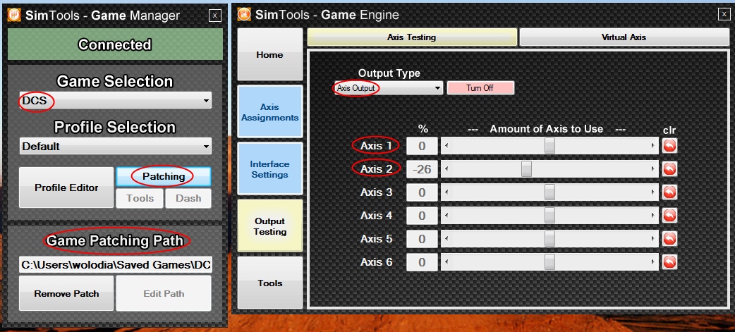

    Hi!
    Thanks for the plugin!
    I wanted to run the game with the plugin in table model 2DOF on the basis of RC servos.
    But servos do not work.
    In LFS work without problems.
    Tell me, please, what's the problem?

  15. Alex36
    Alex36 New Member
    Sep 29, 2016
    13
    rus
    279Coins

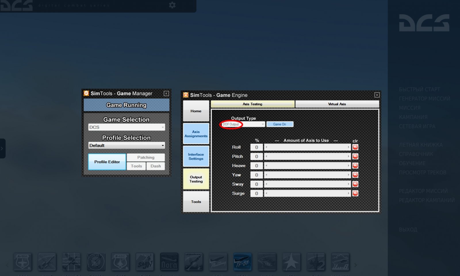

    RC servos only move when you move the sliders "Axis1", "Axis2".
    When you start the game "Axis output" changed to "DOF output".
    RC servos do not work :(

  17. noorbeast
    22,208
    154,711Coins
    +11,212 / 57 / -2
    Have you patched to the game install folder?
  18. misoswan
    misoswan Active Member
    Jun 27, 2014
    292
    1,038Coins
    +78 / 1 / -0
    3DOF, Arduino, JRK
    maybe you need setup first in tuning centre axis when you not setup in tuning centre (in game afte not work)
  19. Alex36
    Alex36 New Member
    Sep 29, 2016
    13
    rus
    279Coins
    Да, конечно, вот: Yes, of course, here:
  20. Alex36
    Alex36 New Member
    Sep 29, 2016
    13
    rus
    279Coins
    Tried it, when the game starts, immediately switch to the "DOF output"
