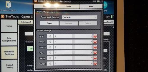

    Before I used 4 motomonsters and all I received broken. This is fifth unit. Maybe again someting wrong with this china`s MM.
    Below movie from virtual axis. All settings like before:

    KONIU problems are interesting.
    I notice in the virtual axis test does not look 100% right.
    In the upper left corner the Axis Selection box is changing from A axis to B axis and back and forth. Mine does not do that.
    I see roll motion at the top(green area)
    And axis output jumping at the bottom half (blue area)
    most noted at 32 seconds of the video and 36 seconds and several more times after.
    I know we have things dumbed down a lot, so the movements are small but it does not look right to me.
    @KONIU Are you running the latest version of Simtools. And please describe your computer. Also do you have a game called NoLimits2?

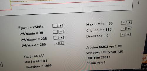

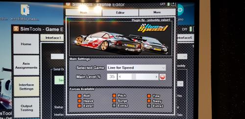

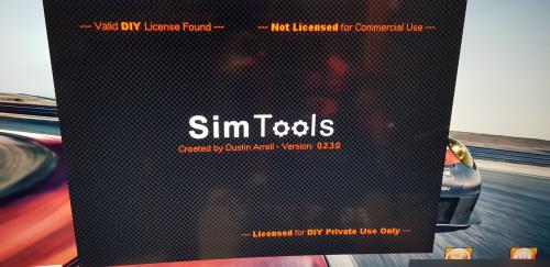

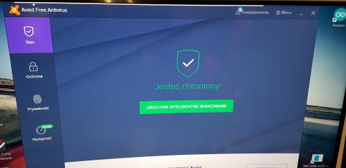

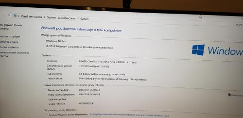

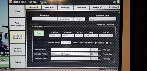

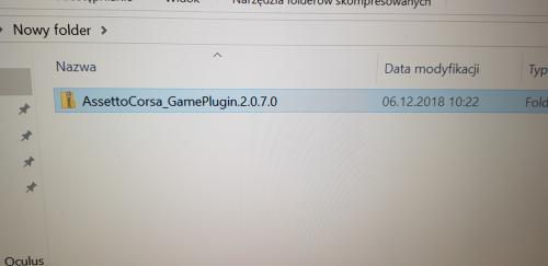

    Below comp. spec.:
    I`m using antivir software:
    Simtool version:
    SMC3 and Vindows Util. version:
    Assetto Corsa Patch version:

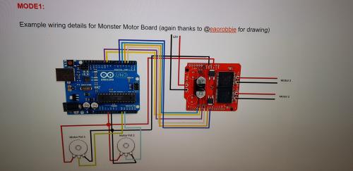

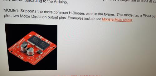

    SMC3 code - MODE 1 - Motomonster like on the picture:
    Wiring like this:

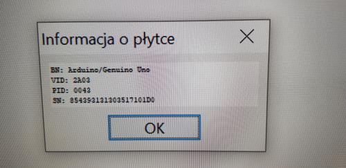

    Arduino Board - Oryginal:
    Arduino to computer conected via usb cable and extension cable - connected do SS USB Port - maybe this is problem???
    Today I wil use other computer and Live for speed.

    Thank you for all the details. Your computer has plenty of speed.
    The only things I saw were PWMrev looks to be a little high. I would set it to 100.
    I would set deadzone to 5
    Your Max Limits look really low. This might be do to your potentiometer value.
    I believe the arduino calls for 5000 ohm. And it must be a Linear Taper. Not Audio Taper.
    I run my Max limits closer to 200 - 250.
    I would recommend getting a Sabertooth 2x32.
    They are considered a standard by the Diy sim builders.
    Contact the company for a place to order one.
    https://www.dimensionengineering.com/
    There is a dealer on Ebay that ships to Poland but it is not cheap.
    https://www.ebay.ie/itm/Sabertooth-Dual-32A-Motor-Driver-/332370324326
    The shipping and taxes are close to $60 usd
    I am running out of good guesses.

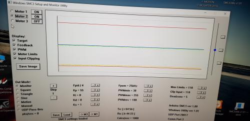

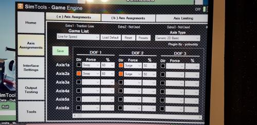

    Realy thanks for yours help. I learned much with your advices. I will be looking Sabertooth 2x32. But in maximum next two weeks I back to work and I will be away from home for a few months , so project will be suspent. But I will be have time for ordering and shipping sabertooth.
    Today I checked motors on other computer - very strong notebook. To test I used Live for Speed. Below recording from screen. Generaly when playing LFS motors running quite good. Still are wild but motors going on correct sides. So I tested LFS on main computer - movies from this below. Was no so bad. Braking and rolling quite nice. Only road effect is to strong. Motor`s levers shaking all the time. It`s some way to decrasing road effect?
    And how change lever start point. When SMC3 is opened levers positing are good, but after open game or outpot testing levers back, and keep this point as zero for move. I saw somebody using [A<128>] but in my case changing this value not working.
    I using this potentiometer:
    WX050 WX112 10K Ohm 5W Single Turn Potentiometer Variable Resistor
    Wx112(050) single turn wire wound potentiometer. Features: 5W rated power,Application: wire wound potentiometer, adjust timer, speed, temperature.
    Product name : wire wound potentiometer
    Terminal number : 3; rated power : 5W;
    Shaft diameter : 6 mm
    Color : Black; Weight : 44G;
    Model : wx112(050); Type : single turn; technology : wire wound
    I have very good potentiometers from ships crane controler but 5K. I heard Arduino working only on 10K - maybe this is not true.
    SMC3 Utill. settings - both motors:
    Simtool
    Recording from Notebook:
    Recording from Main Computer:
    Recording from game - this in not the same run as above:

    Acc. to this I think I must increase clip limit (because now I have the same like max limit) to create this band where code will be try break motors. Tomorow I will check this.
    Maybe you have some idea how in Simtool set start motors position. Like I sad before I have big problem with backin motors from oryginal position after swith on in simtool - chair loosing horizontal position.

    I see you are using surge and sway as your DOF's...
    I would of thought you would use roll and pitch....
    You stated one thing that sounds like a problem.
    You stated that the levers do not return to horizontal after playing the game.
    They should always return to horizontal when not playing a game.
    The horizontal position is controlled by the pot.
    The arduino should keep this horizontal (or level) all the times.
    There is an exception to this and that is if the lever is moved beyond the Max Limit it will remove power to that motor. This is a safety feature to prevent damage to the motors and pushrods.
    You would have to manually move the lever closer to horizontal by hand and reset the power to the arduino.

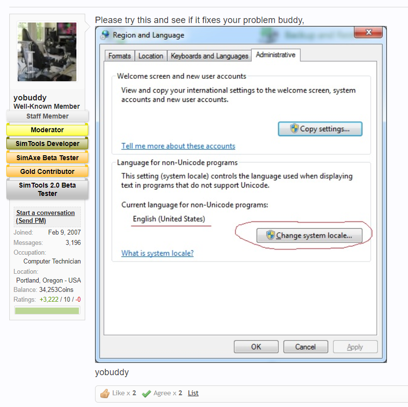

    In this forum I found a solution with my problem with the change of the lever position after starting the game.
    After change from my oryginal language to English lever no longer changing start position.
    But what is amazing motors stop shaking and started working normal. So propably before change, motors all the time wonted back to position and fight with wrong position. But I think problem with this language it`s some Simtool failure. It`s looks like only English is accepted.
    Presently I'm looking the best Sim Tool setting for me - sometimes, during game, levers doing some crazy move behind set limits, but generally working good and future looks promising. Work is in progress.

    I remember reading about a problem where English used Commas to separate groups of numbers (Eg $ 1.000 ) versus French used a Decimal point ($1.000) and that caused problems.. Changing location in Windows solved the problem...
