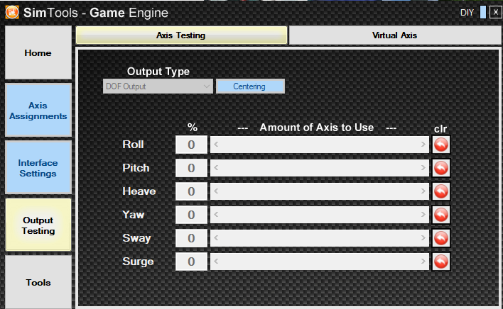

  20. JZargo
    JZargo New Member
    Jul 22, 2012
    13
    business owner
    morciano di romagna
    83Coins
    3DOF, Arduino
    Same here guys, and I also use Vr.. Game Engine start blinking and i look this
