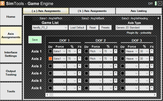

    @Brett Horton - You can use Heave to achieve what you describe. If you put small values in the Tuning centre but dial down the % in the Axis for heave you can get the subtle feeling of the aircraft "settling down" after a climb / dive. The bonus also, is you get a nice "thunk" when you land and taxi.
    Mix in surge as well.. While you don't feel it much in flight it makes all the difference on take off in the F/A-18 :) As an example, in FS2, my pitch and roll are 95% and my other axis average out to around 25%. I know the rule of thumb is all axis = 100% but in a flight sim where you are typically not going full pitch or roll (for day to day flying) you can get away with it.

    Set this plugin up last night and Extra 1 and Extra 2 appear to be labelled incorrectly. Extra1 is actually "AngVelBank" and Extra2 is "AngVelPitch".
    I tested "per axis" and when in a climb/dive I get no movement from Extra1, but do when rolling.
    Has anyone else had a similar issue? It's not a big deal, just reverse them in the Axis.
    Pitch actually works OK for me (no snapping back) so I've used that in favour of the AngVel values.

    value1 updated Aerofly FS 2 Plugin with a new update entry:
    Bank/Pitch velocity mix-up fix
    Read the rest of this update entry...
