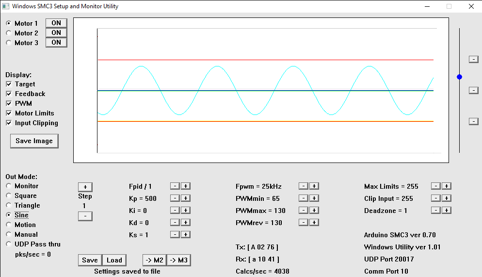

    I've made a lot of changes in SMC3 and mechanically to get smooth, consistent motion that wasn't happening before today. It runs Sine really well now.

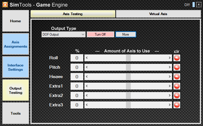

    "Short story - I am able to get movement through the SMC3 Utility Tool BUT when trying to assign and then axis test in SimTools, I don't get any response or movement.
    To make it clear, all I am trying to do is go through AXIS TESTING in SimTools, i am not even interested in introducing a game environment yet. I have not set min/max values or anything like that in the game engine.
    HELP PLEASE - Where am I going wrong? What have I not set up? What have I set up wrong?"

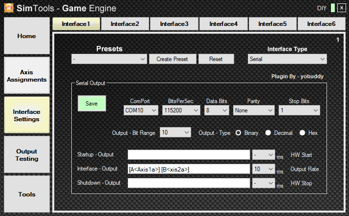

    In BitPerSec try - 500000.
    The Default Profile needs configuration in Interface Settings, as that Profile is what Output Testing uses.
    If there is only TL then Interface Output should be Axis1a only.
    See here for TL setup tips: https://www.xsimulator.net/community/faq/traction-loss-in-simtools.175/

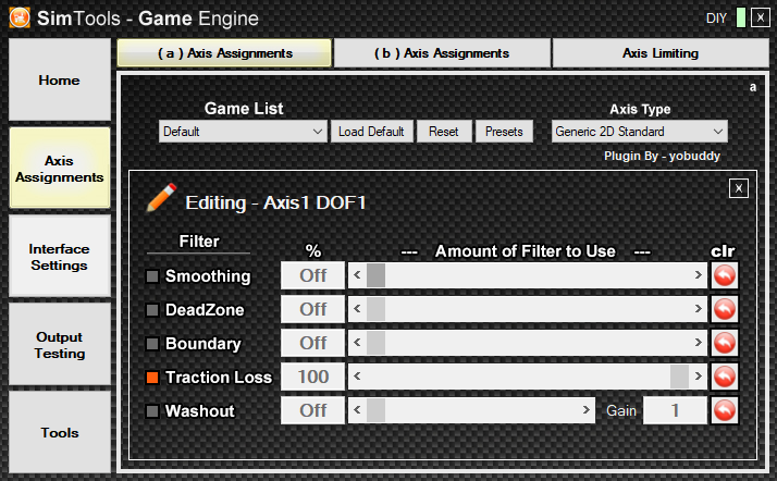

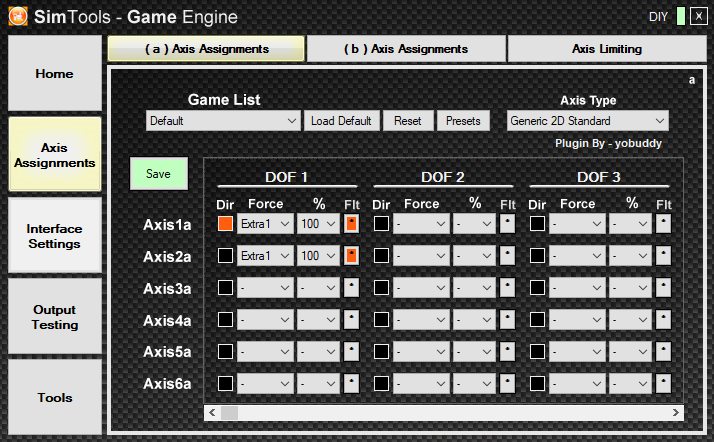

    No luck, no change. Here are the latest settings.

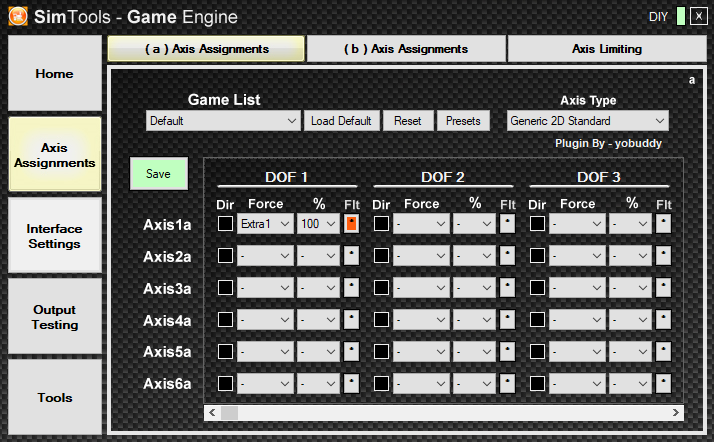

    Your Interface Output should only have [A<Axis1a>]
    Don't use filters until everything else is working and has been fully dialed in, think of filters as the very last motion profile tuning tweak.

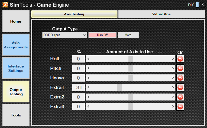

    Great! That was what I needed. I now have Testing and Virtual Data, I mapped the input from the games. Now, I just have to see how to make it move.
