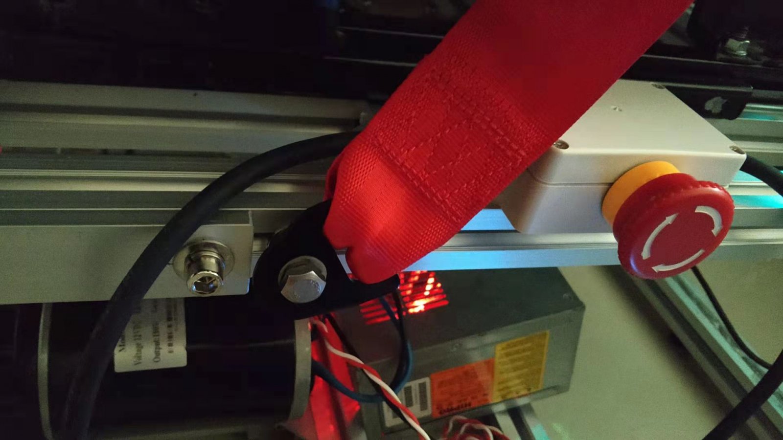

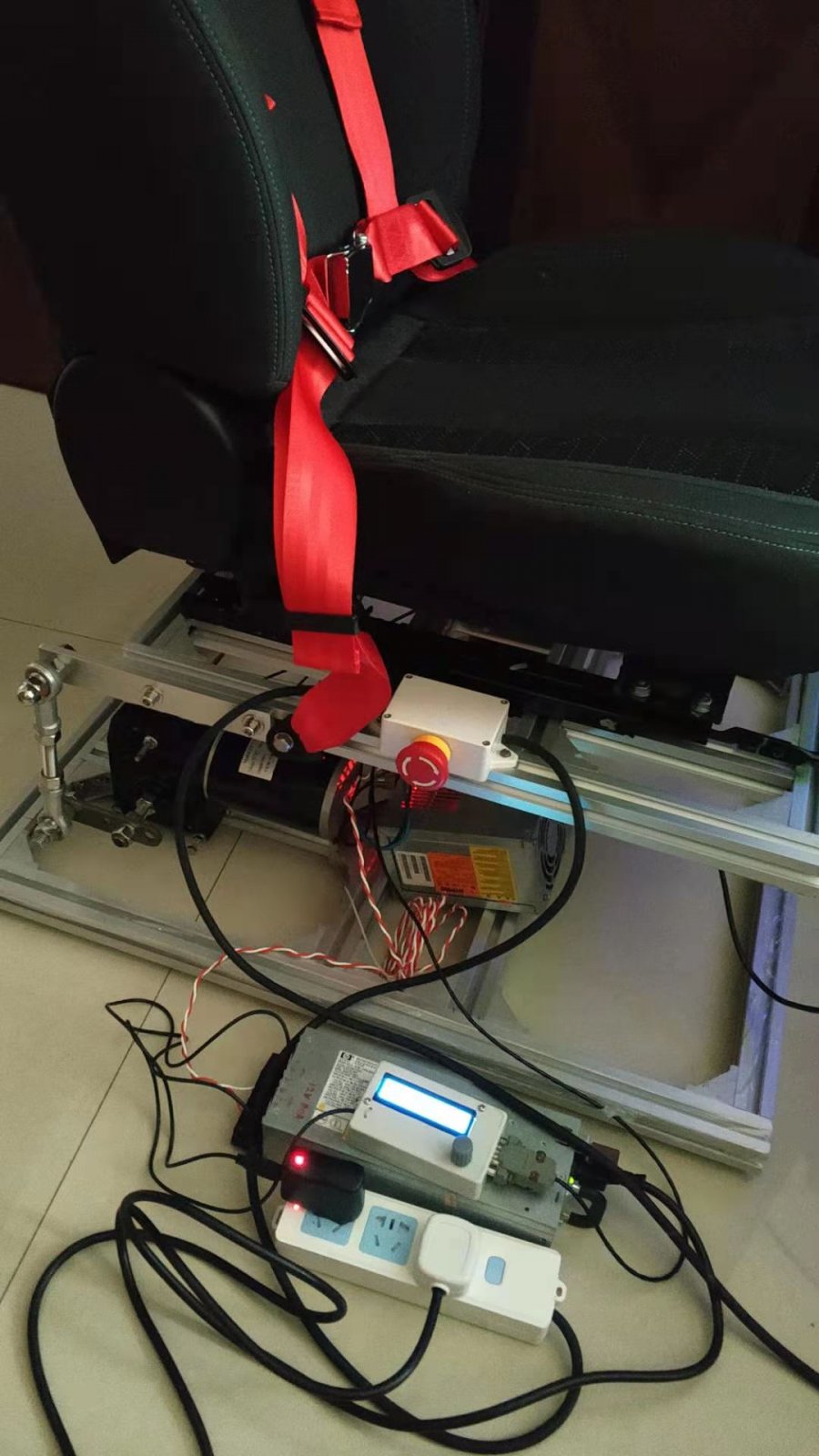

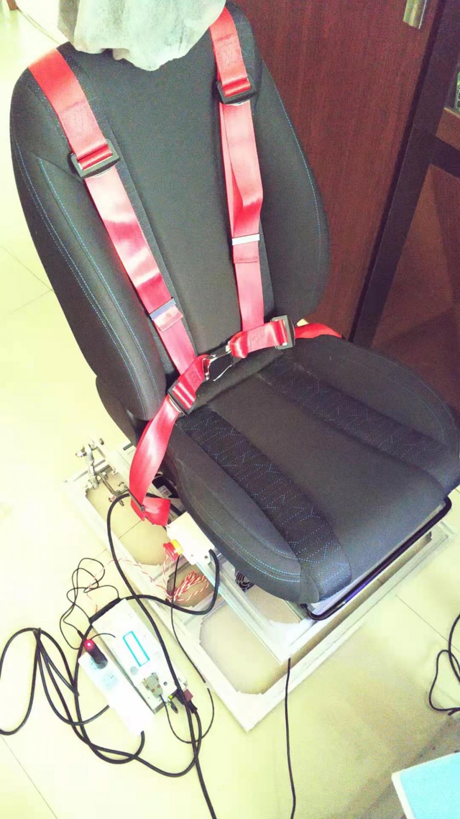

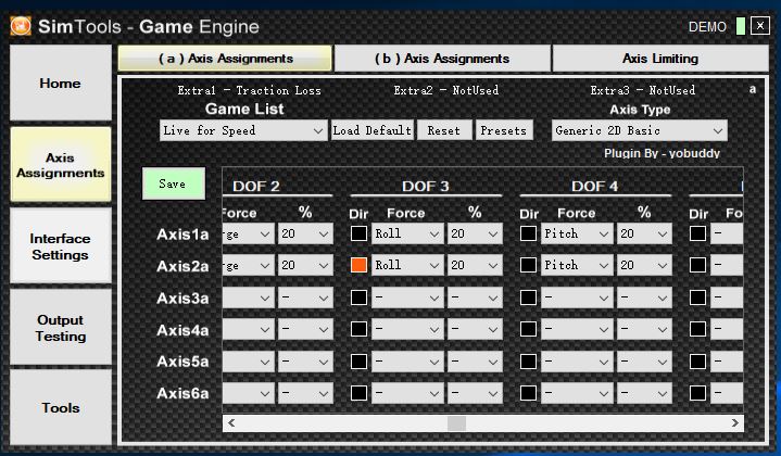

    Safety first, install the four point safety belt and emergency switch before I dare to start the test.
    Finally began to test in the game, with the handle in the seat test a few laps LFS, feel good.

    At present, I feel that the setting is OK. Adjust it later.

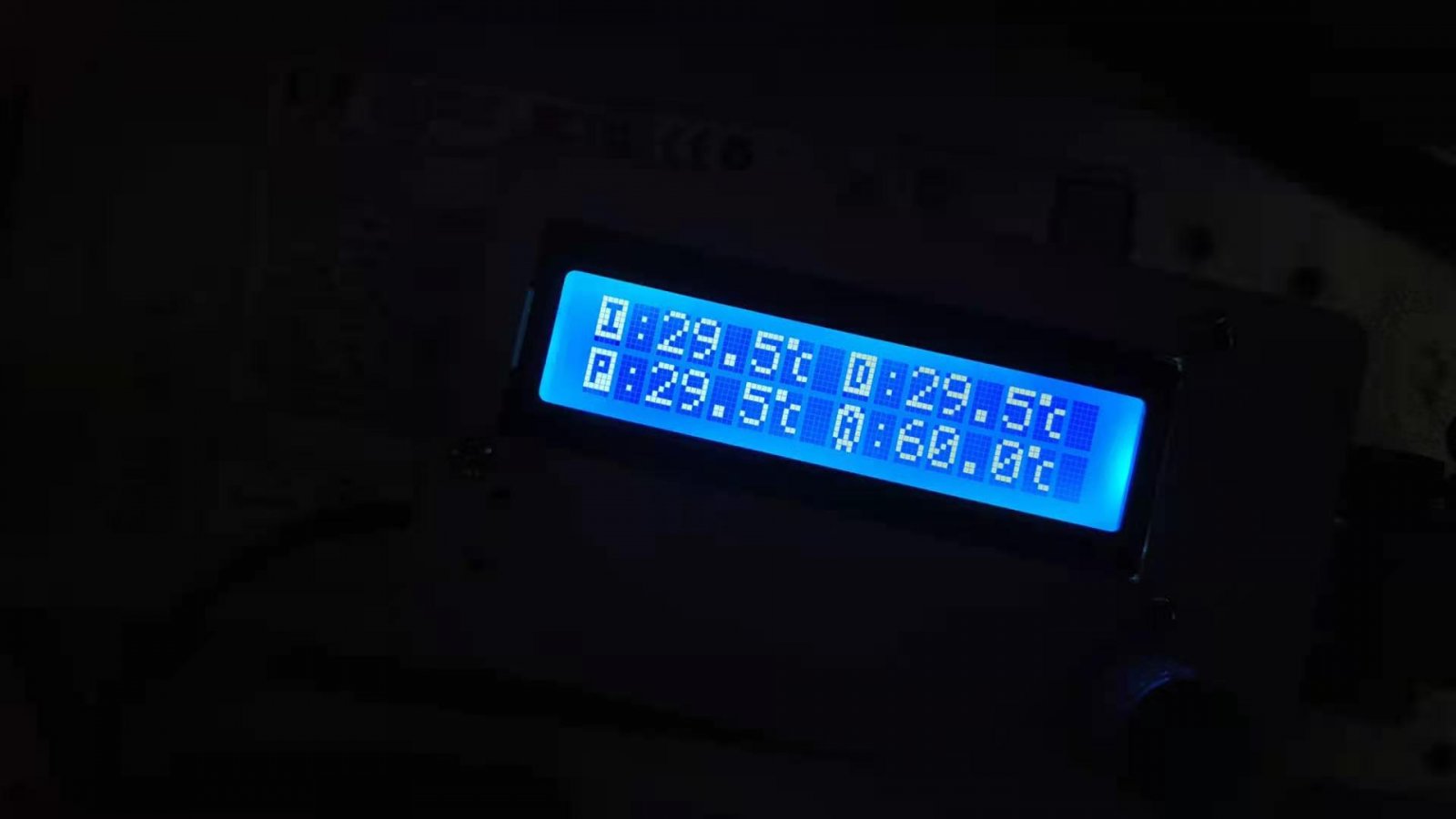

    LFS has been running for more than 20 minutes, the temperature of MM is kept at 30 ℃, and the motor and power supply are cool.

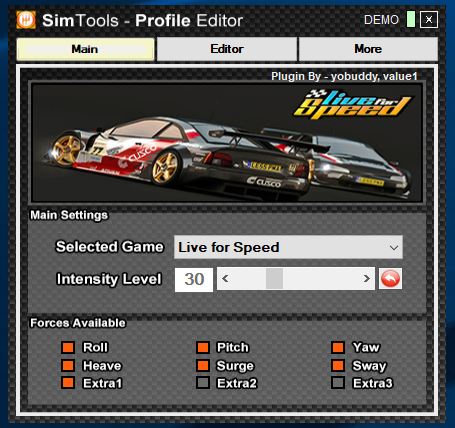

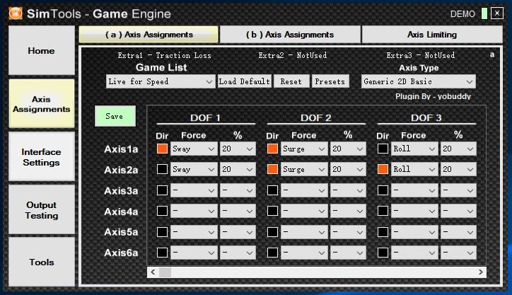

    That is likely because you need to first refine your motion profile, as suggested.
    Running such a low Intensity Level actually results in global smoothing, what you should do is dial each axis in individually first.
