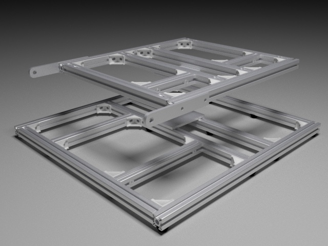

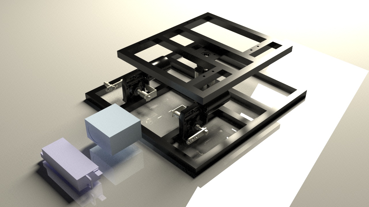

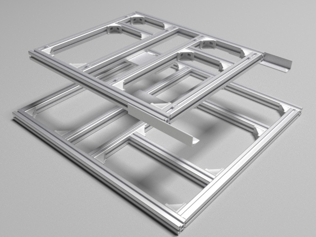

    This design has been on the drawing for a long time.
  2. TL1000S
    TL1000S New Member
    Mar 23, 2016
    25
    China
    39Coins
    +18 / 0 / -0

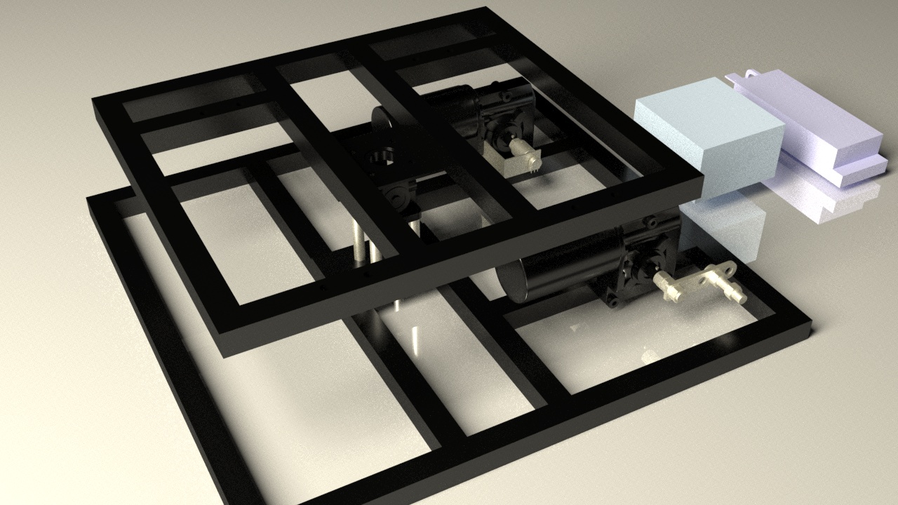

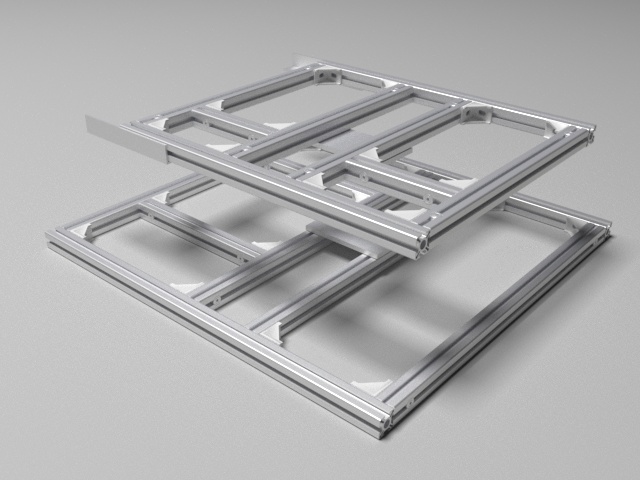

    Aluminum profile design

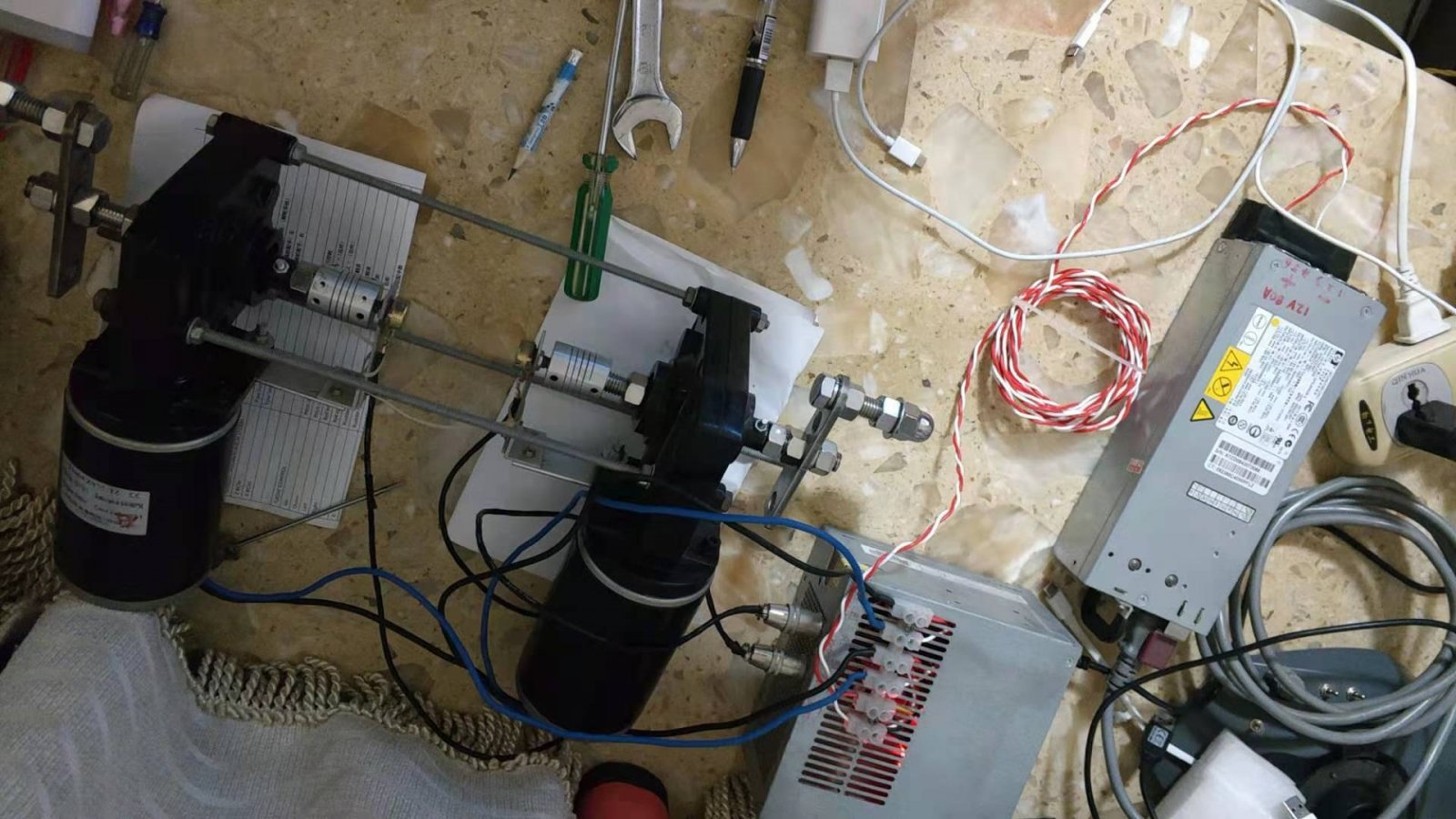

    The bracket parts didn't arrive. Test the motor. Everything is normal.

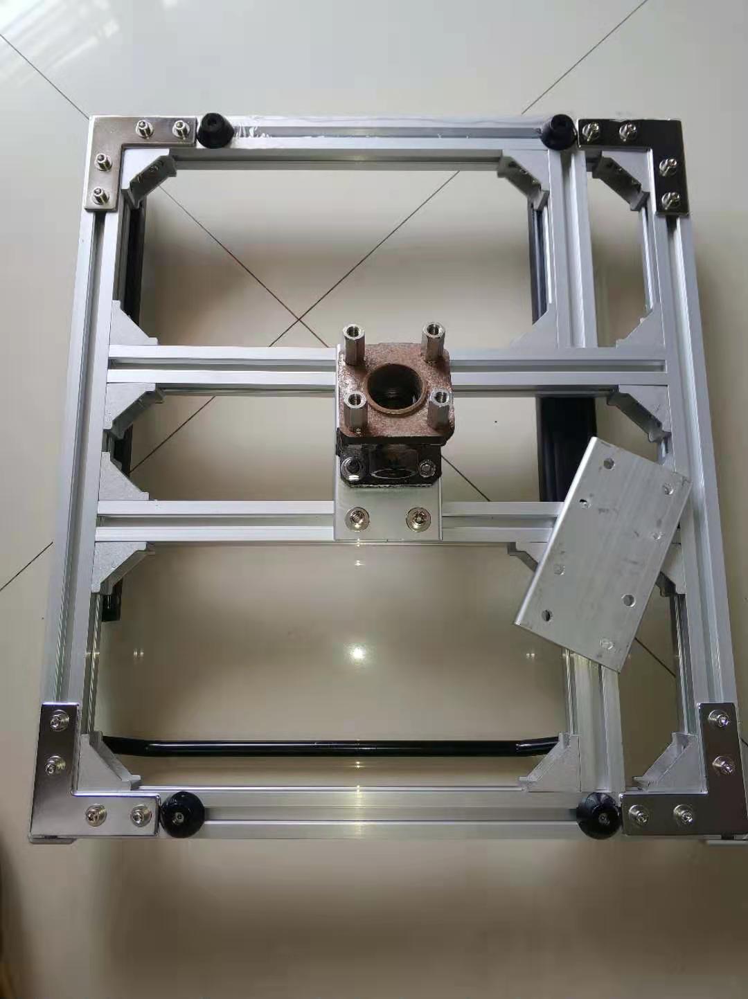

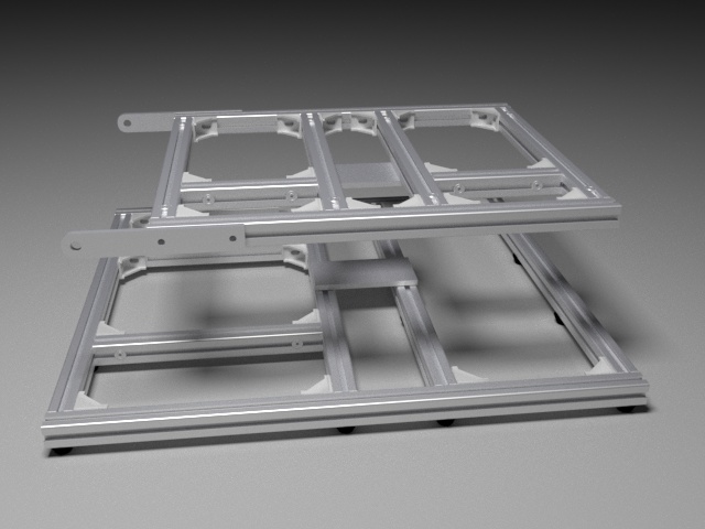

  4. TL1000S
    TL1000S New Member
    Mar 23, 2016
    25
    China
    39Coins
    +18 / 0 / -0

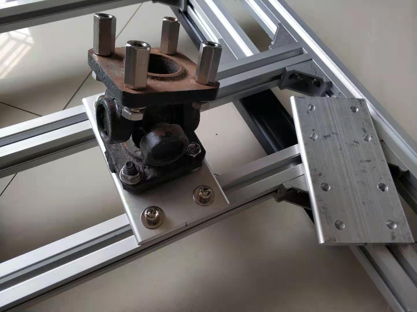

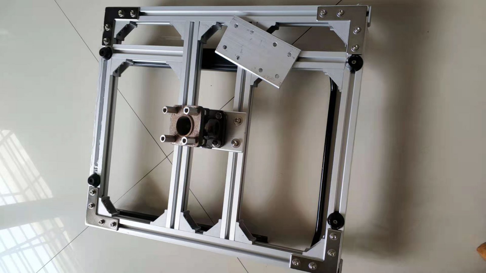

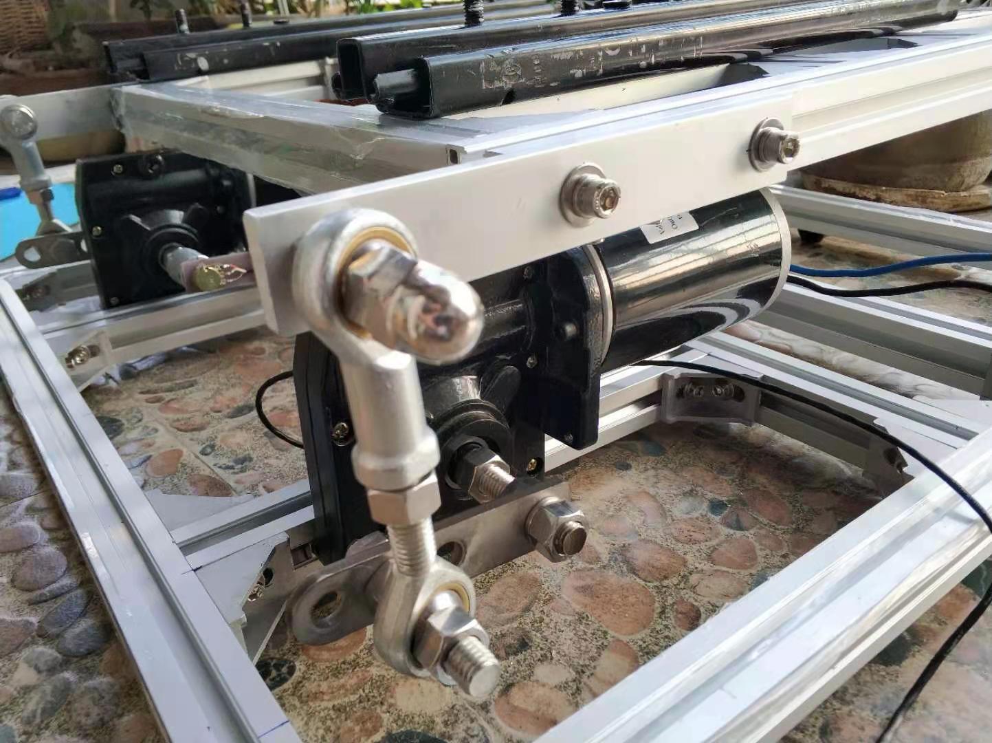

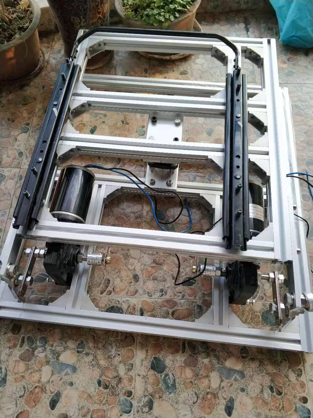

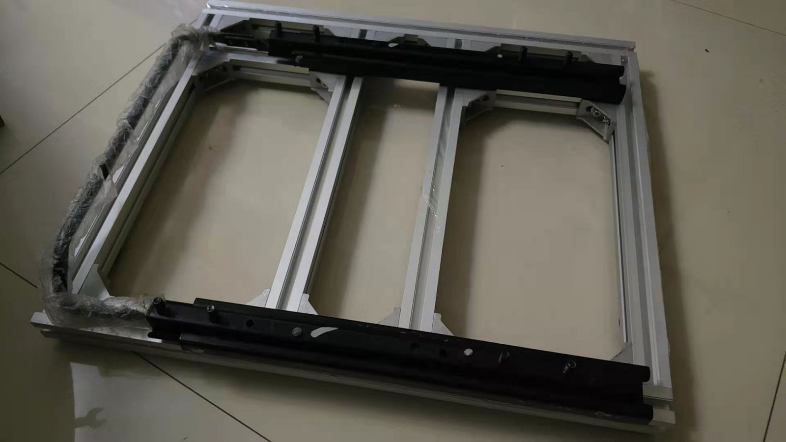

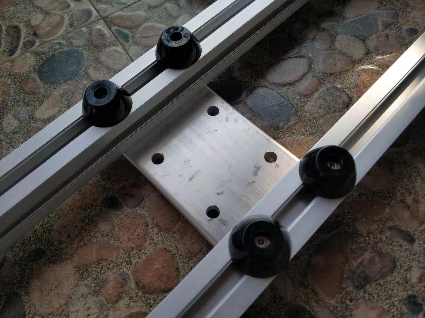

    Due to the limited space for seats, the bracket must be designed to be compact. At the same time, there is no welding condition, and in order to facilitate the adjustment, the final choice of aluminum profiles.

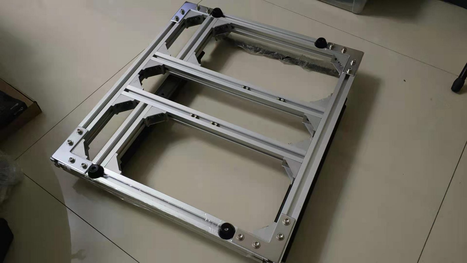

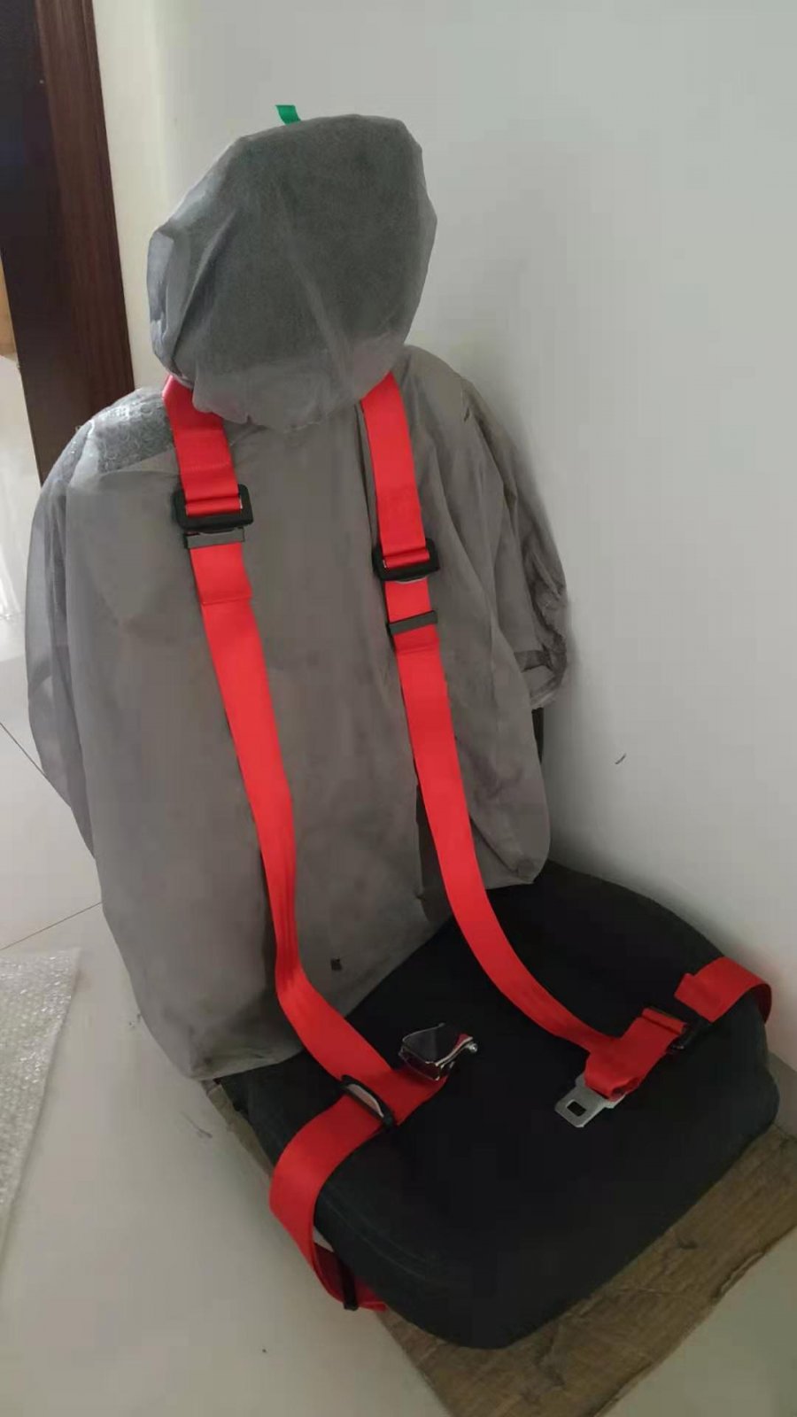

  5. TL1000S
    TL1000S New Member
    Mar 23, 2016
    25
    China
    39Coins
    +18 / 0 / -0

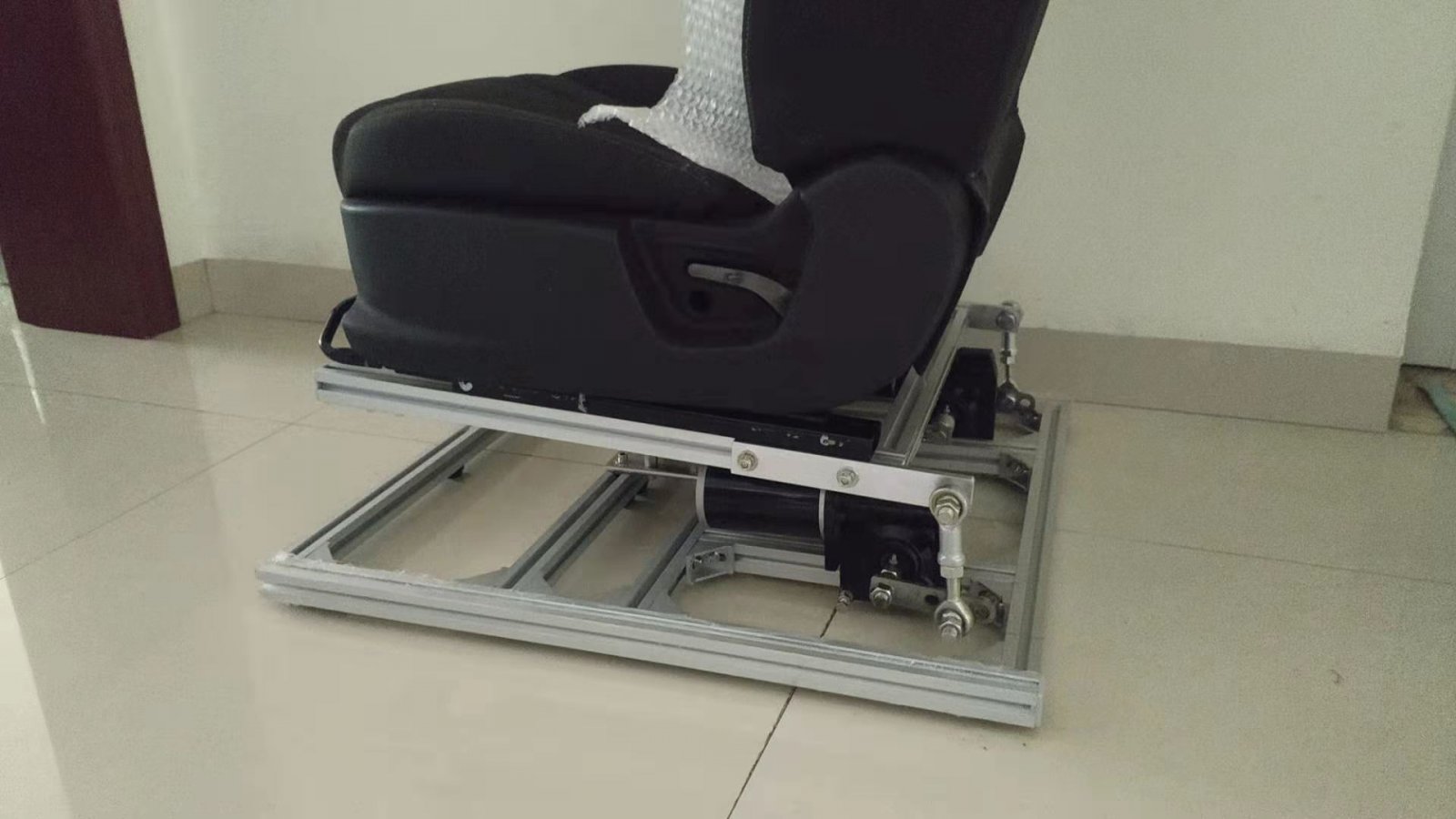

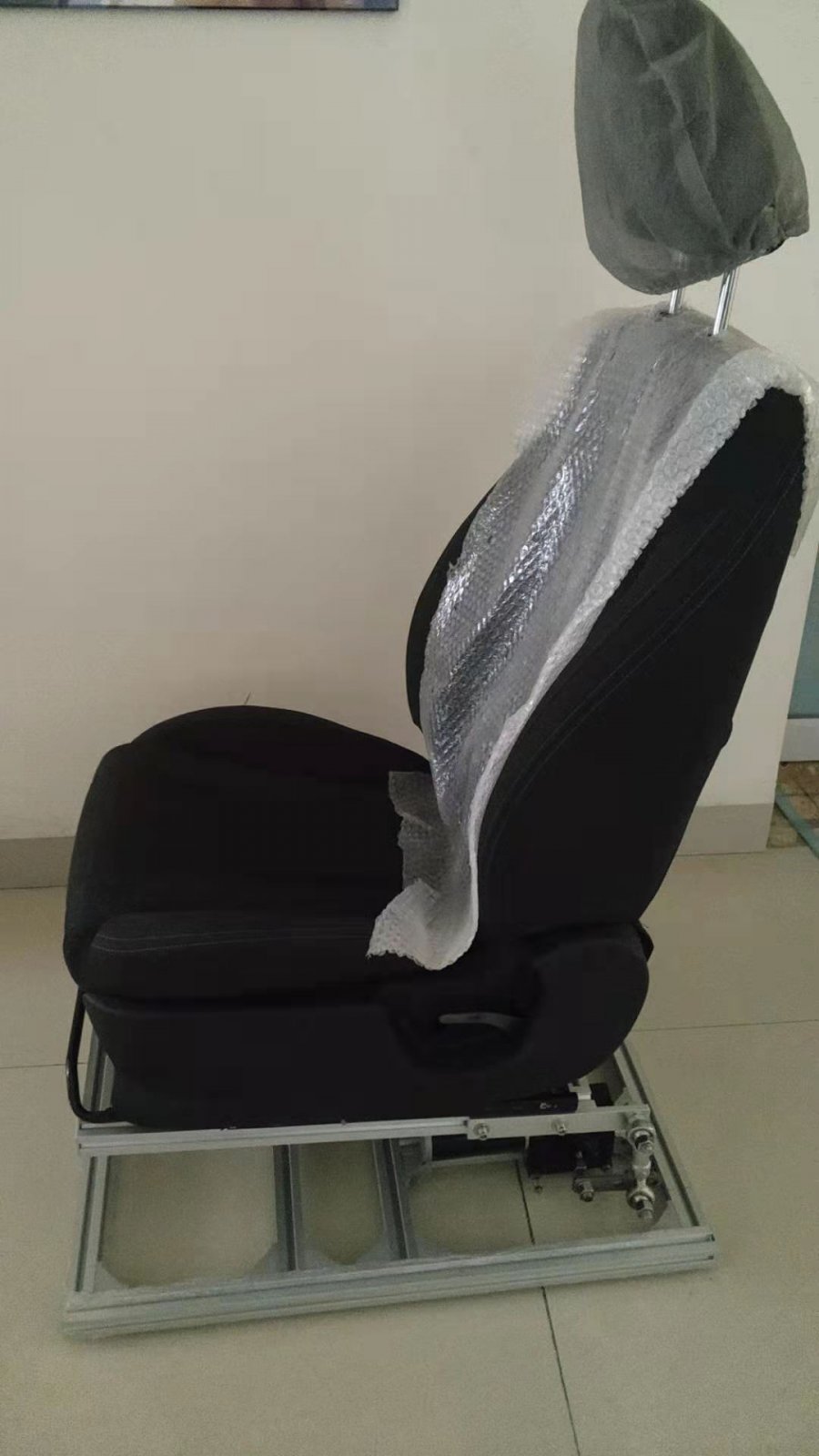

    Order aluminum profiles today. This seat and seat belt have been here for a long time.

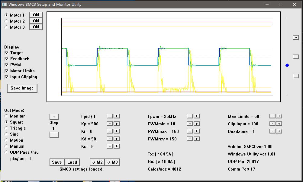

  6. TL1000S
    TL1000S New Member
    Mar 23, 2016
    25
    China
    39Coins
    +18 / 0 / -0

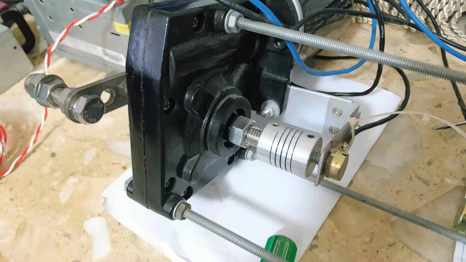

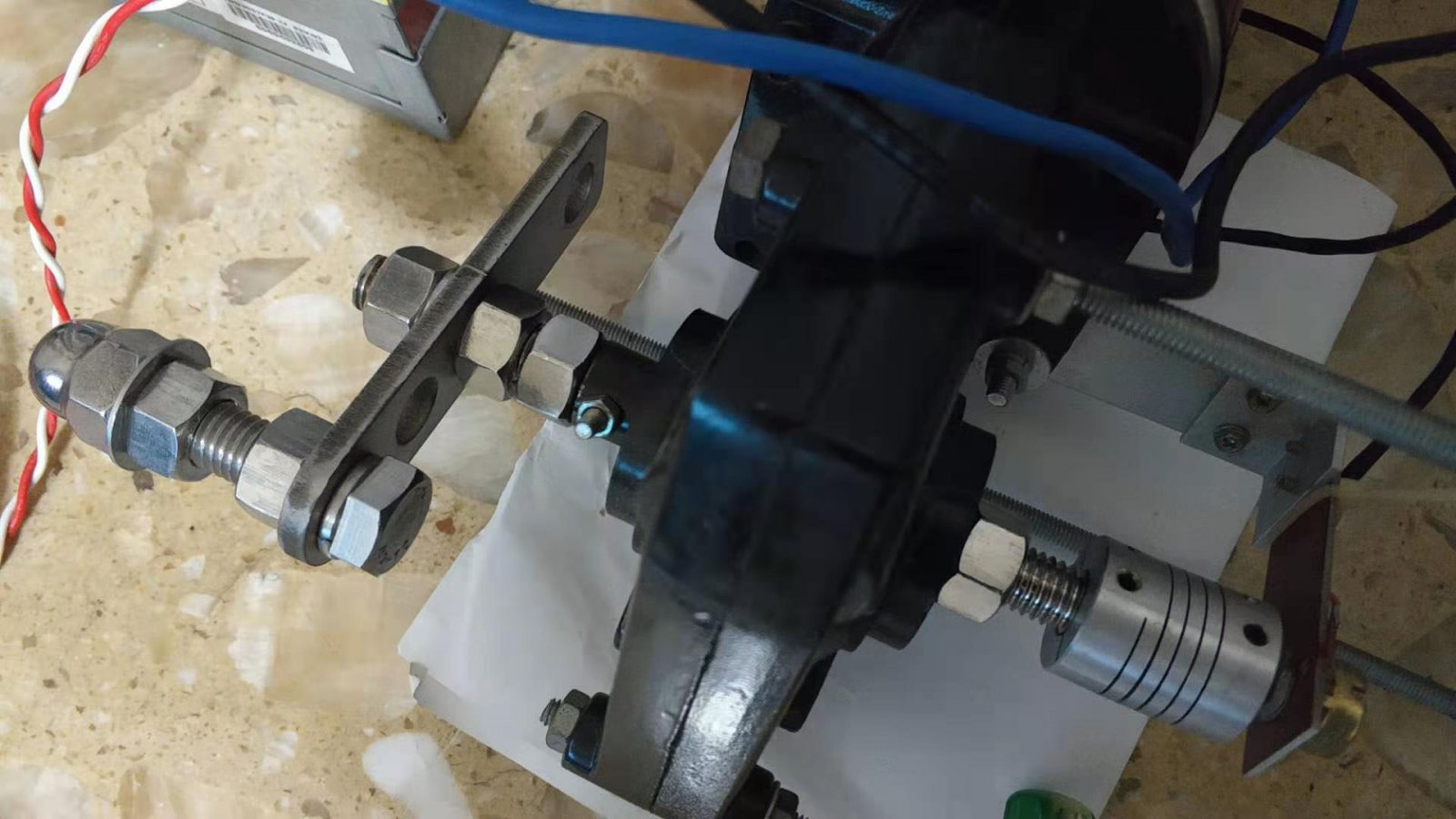

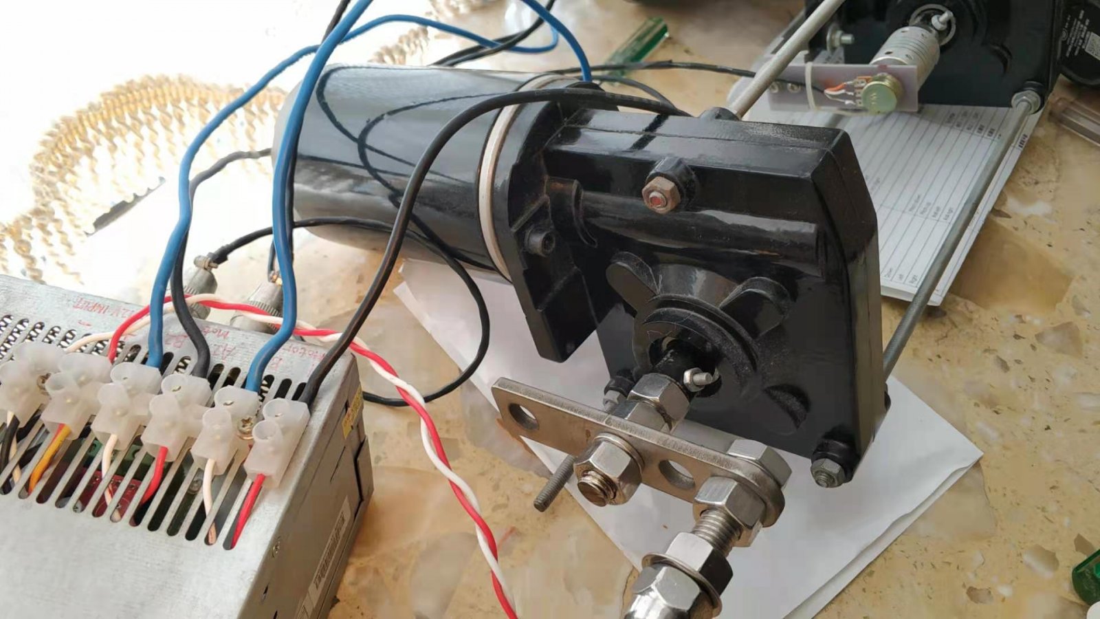

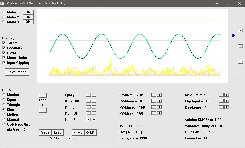

    Motor no load test and software setting.Aluminum profile on the road, worry!
    21,724
    152,057Coins
    +11,063 / 56 / -2

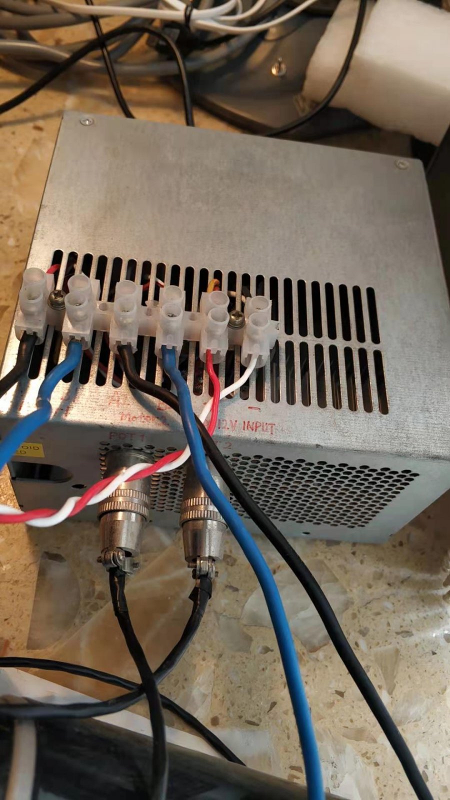

  8. TL1000S
    TL1000S New Member
    Mar 23, 2016
    25
    China
    39Coins
    +18 / 0 / -0

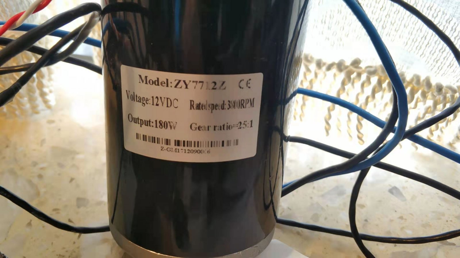

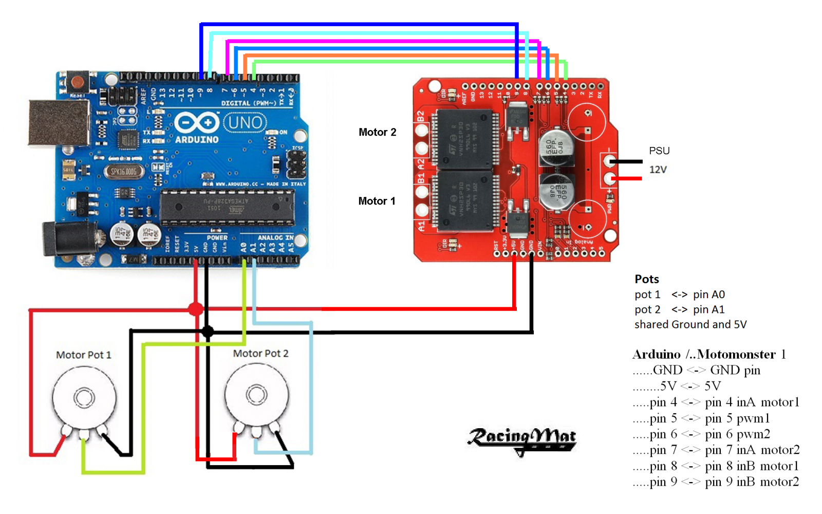

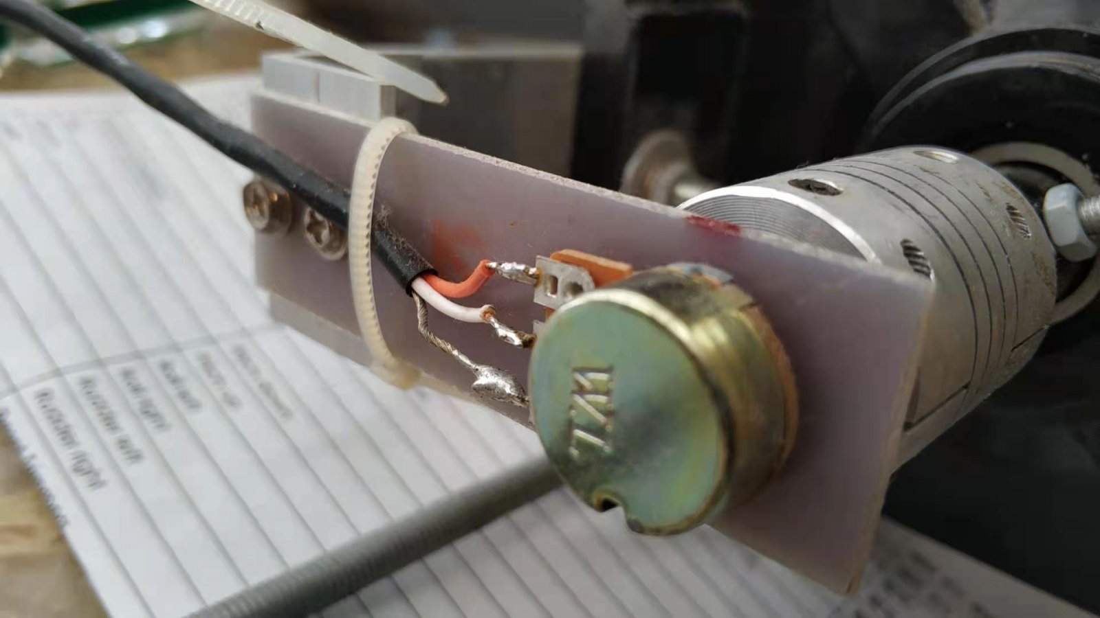

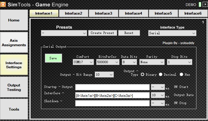

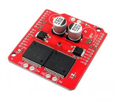

    Thanks for noorbeast's attention and advice.
    Using circuit and driver:
    arduino nano
    Monster Moto Shield VNH2SP30 stepper motor driver module

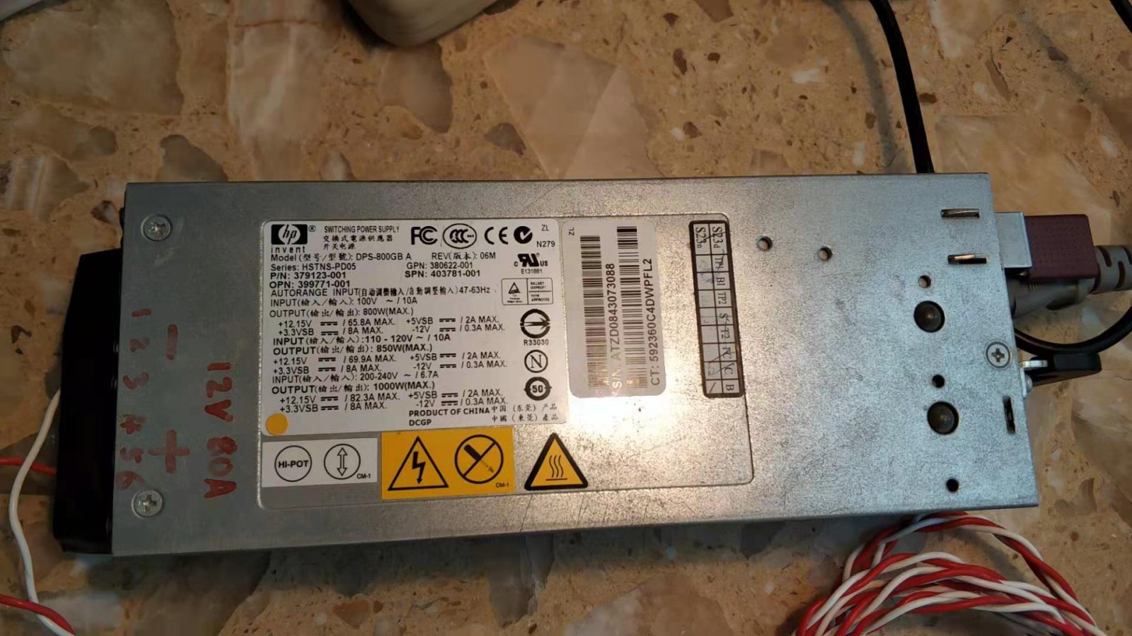

    12V 80A power
    12VDC 180W 3800RPM Motor ,Gear ratio=25:1
    10K potentiometer

    +18 / 0 / -0

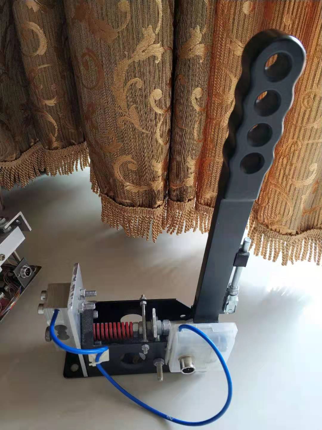

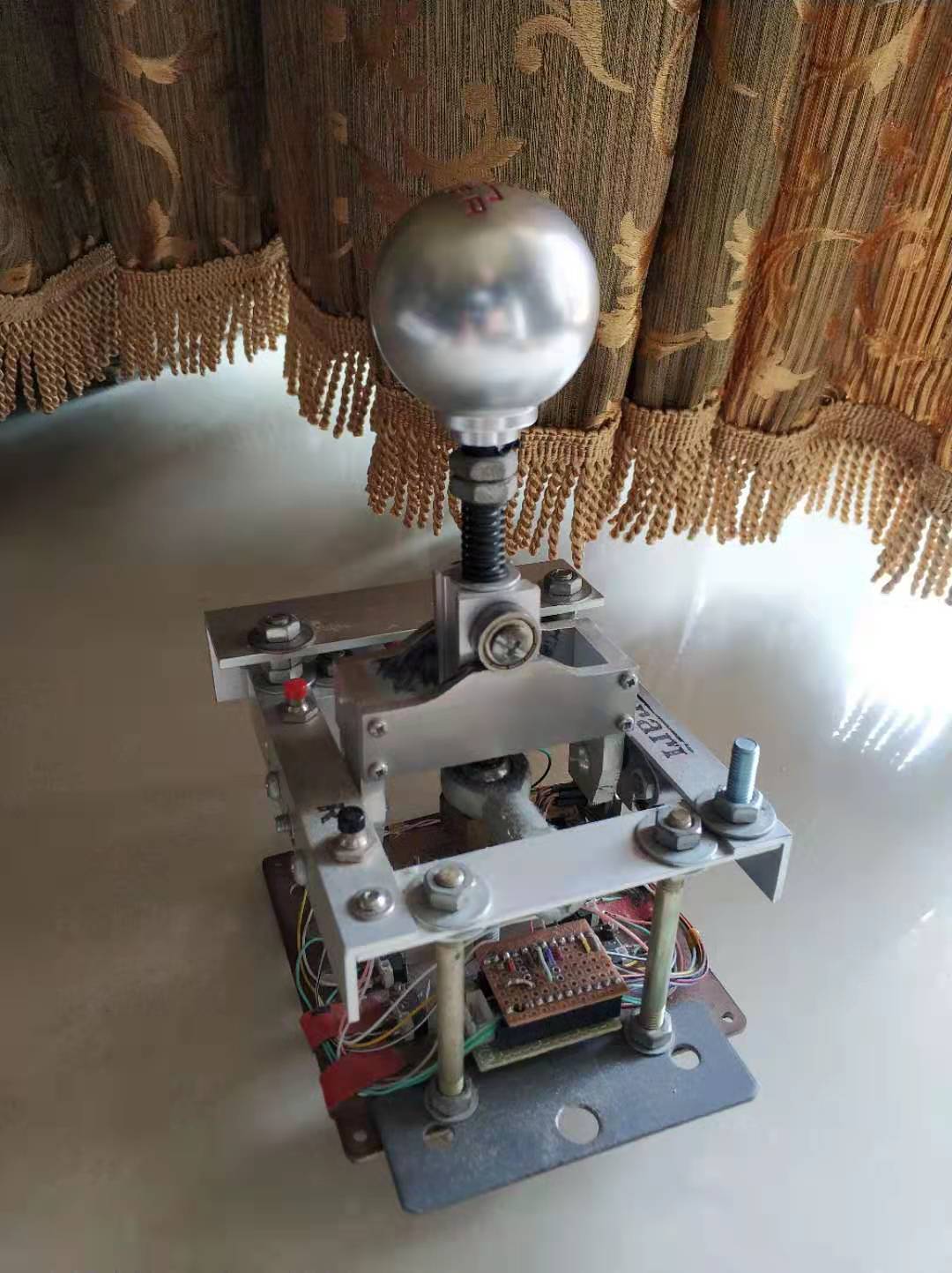

    The ordered aluminum profile may be delivered in the evening!Little excitement!
    Handbrake made a few years ago.

    A little bit of progress.

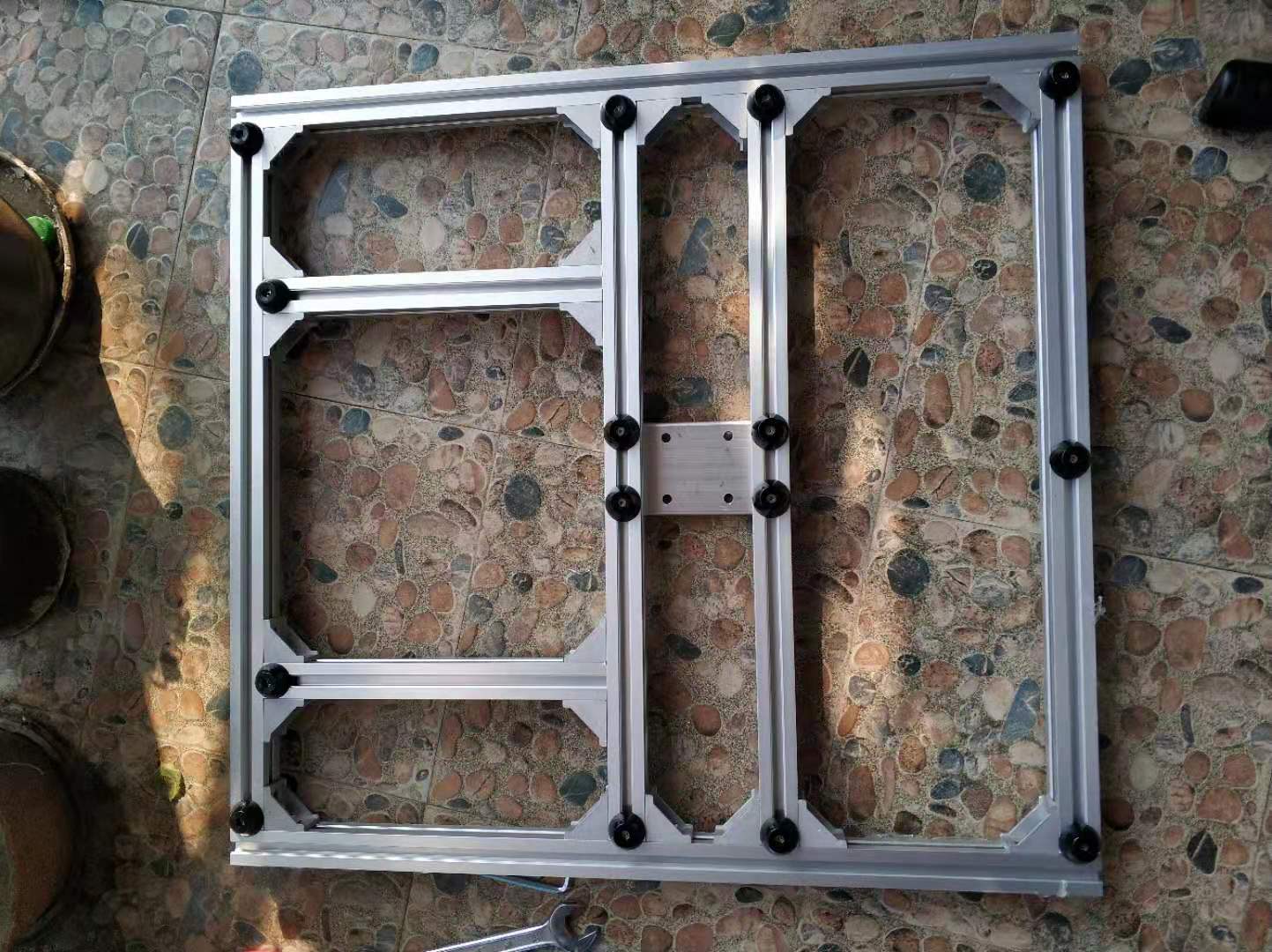

    3030 aluminum profile. After many years, I finally began to assembly work happily.
    The key parts are reinforced.

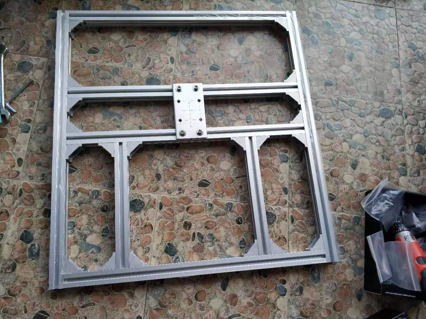

    The assembly work will continue tomorrow.
  15. TL1000S
    TL1000S New Member
    Mar 23, 2016
    25
    China
    39Coins
    +18 / 0 / -0

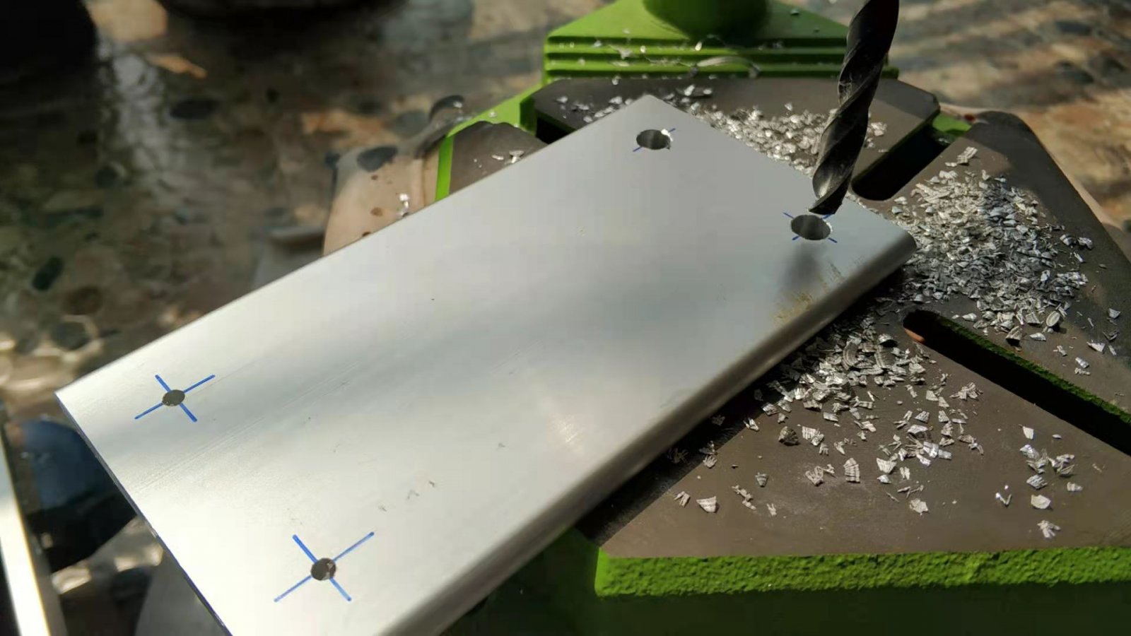

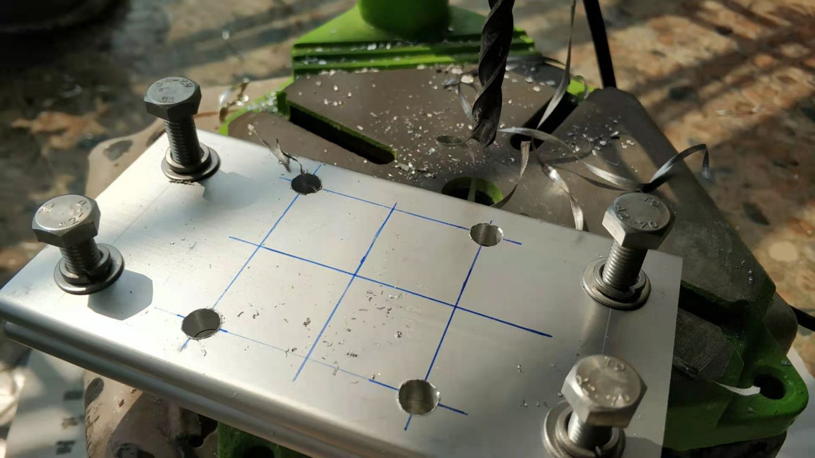

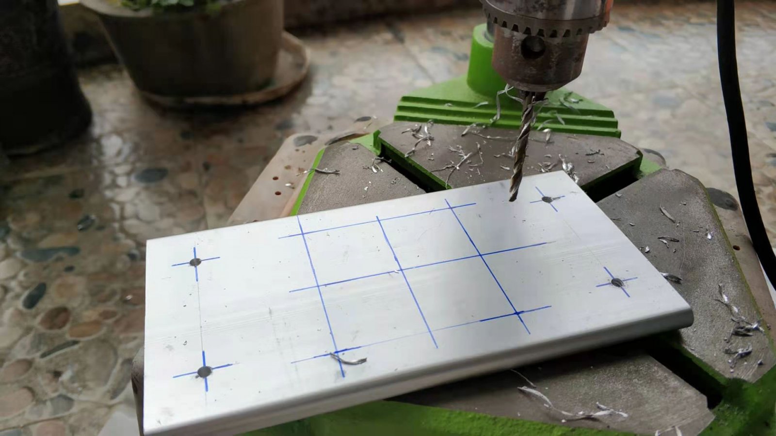

    Processing aluminum.

  16. TL1000S
    TL1000S New Member
    Mar 23, 2016
    25
    China
    39Coins
    +18 / 0 / -0

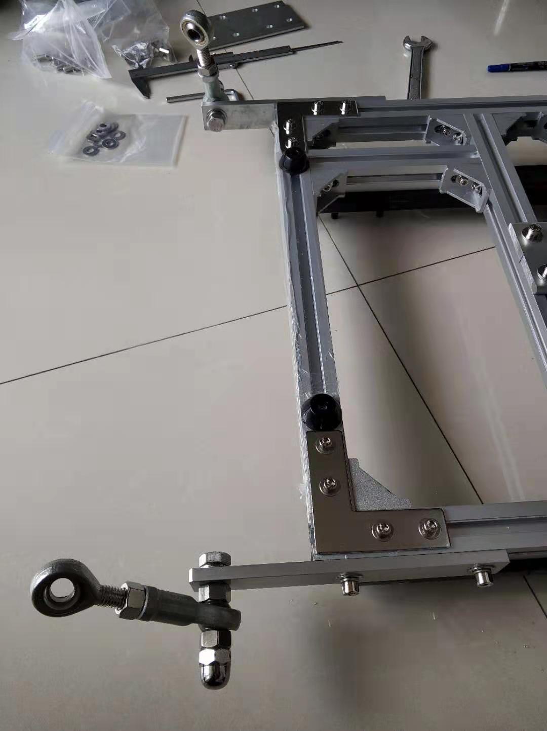

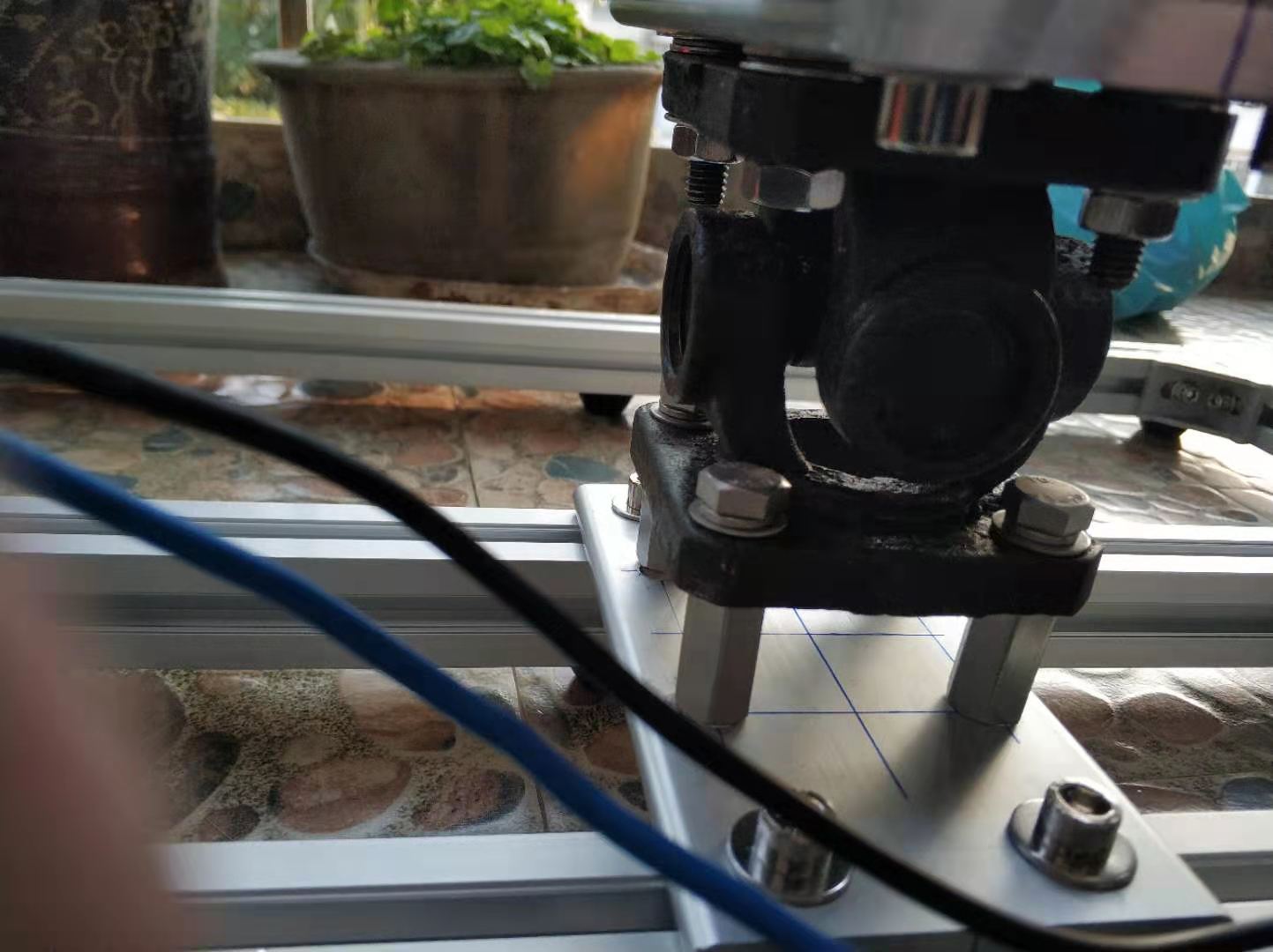

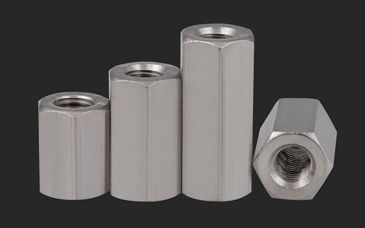

    Continue assembly. The height is not enough,need to buy accessories to improve the height.

  17. TL1000S
    TL1000S New Member
    Mar 23, 2016
    25
    China
    39Coins
    +18 / 0 / -0
    Buy some of these long ones,have to wait again!
      File size:
      27.7 KB
      Views:
      209
  18. TL1000S
    TL1000S New Member
    Mar 23, 2016
    25
    China
    39Coins
    +18 / 0 / -0
    The accessories haven't arrived yet. I can't help but put them together to see the overall effect.
    When it's completely installed, power on and test the machine. Keep waiting!

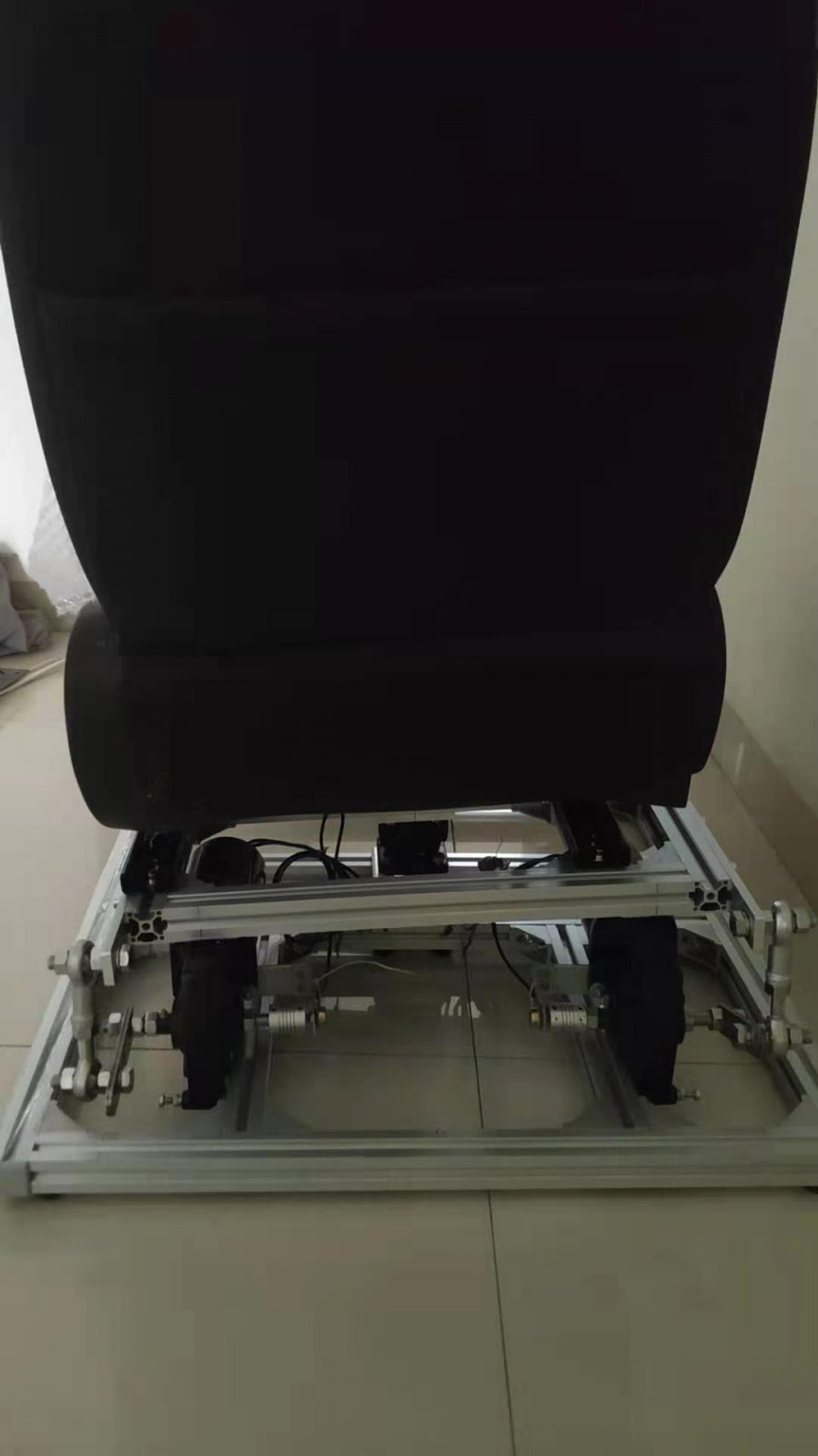

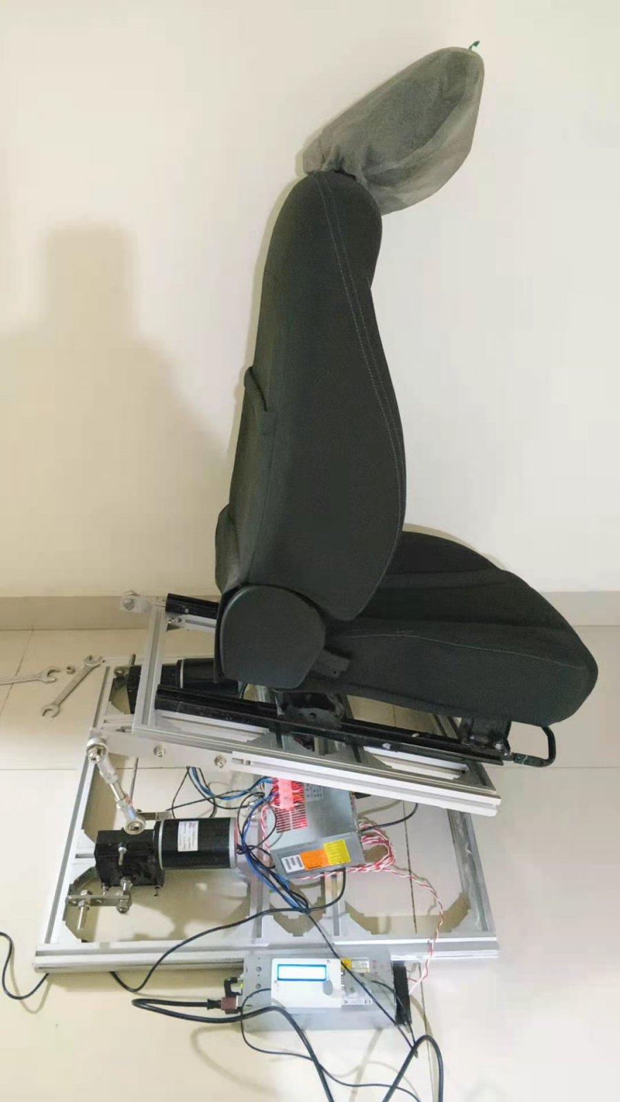

  19. TL1000S
    TL1000S New Member
    Mar 23, 2016
    25
    China
    39Coins
    +18 / 0 / -0

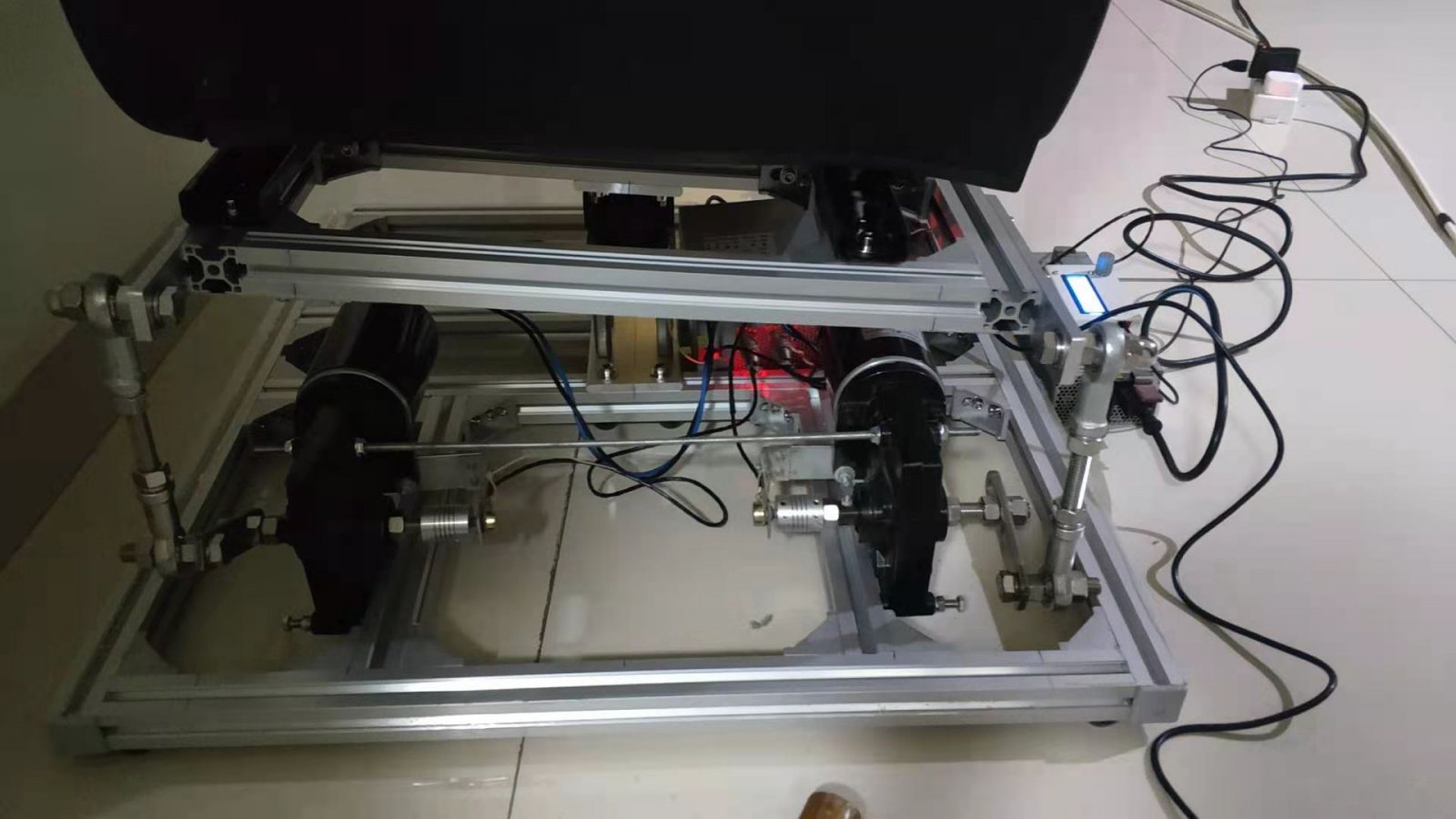

    Power on test. The motor shakes a little. There's nothing else wrong. There's no time for the game test.

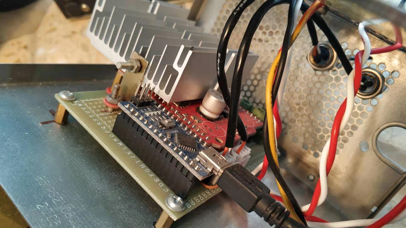

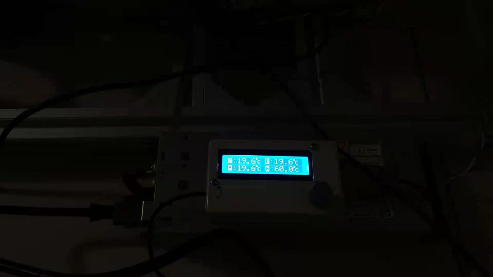

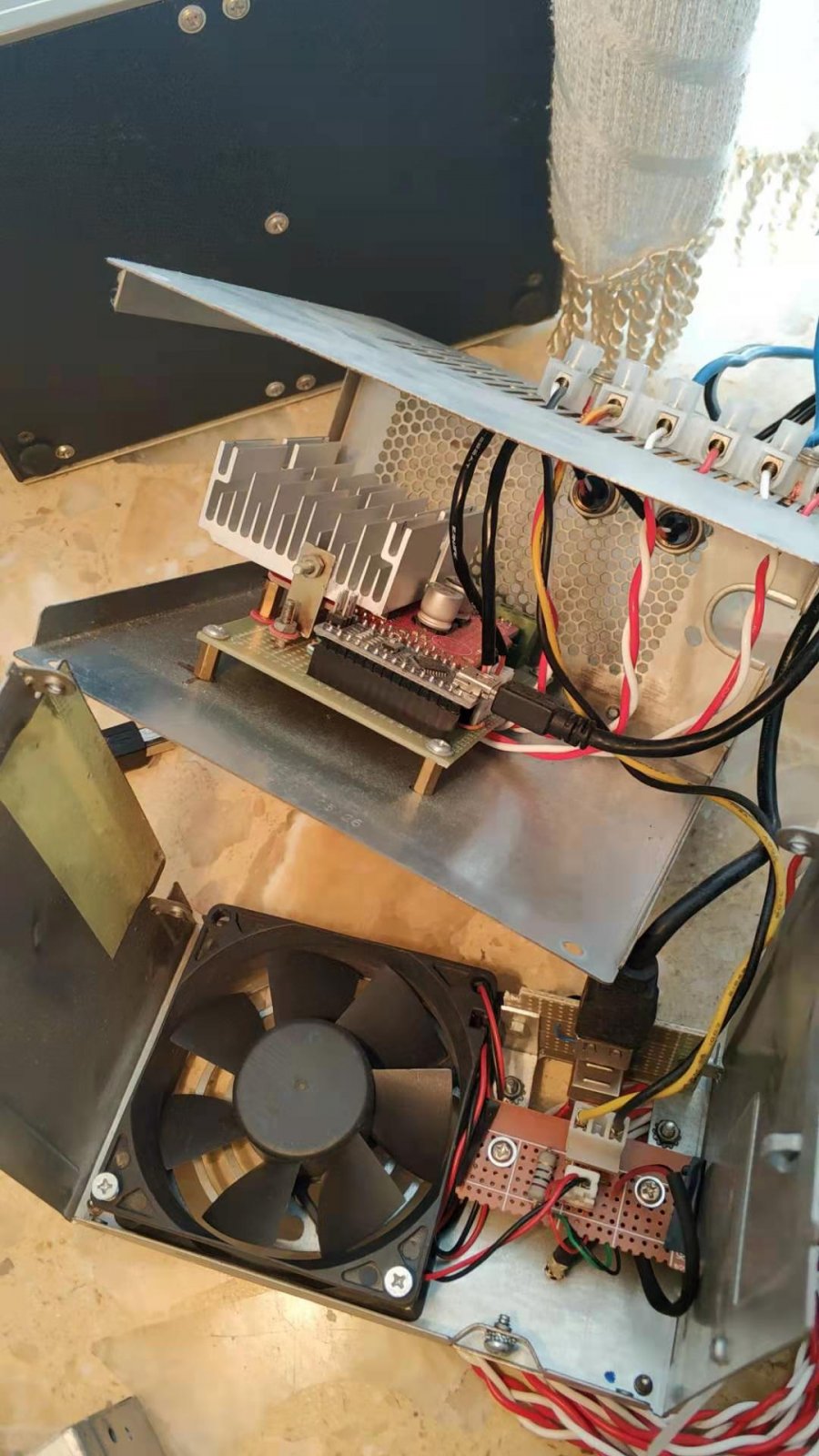

  20. TL1000S
    TL1000S New Member
    Mar 23, 2016
    25
    China
    39Coins
    +18 / 0 / -0

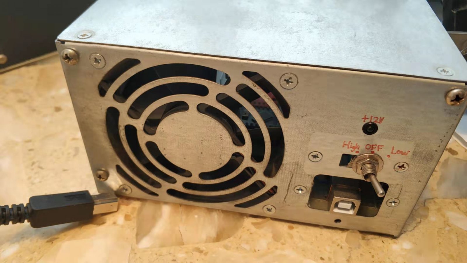

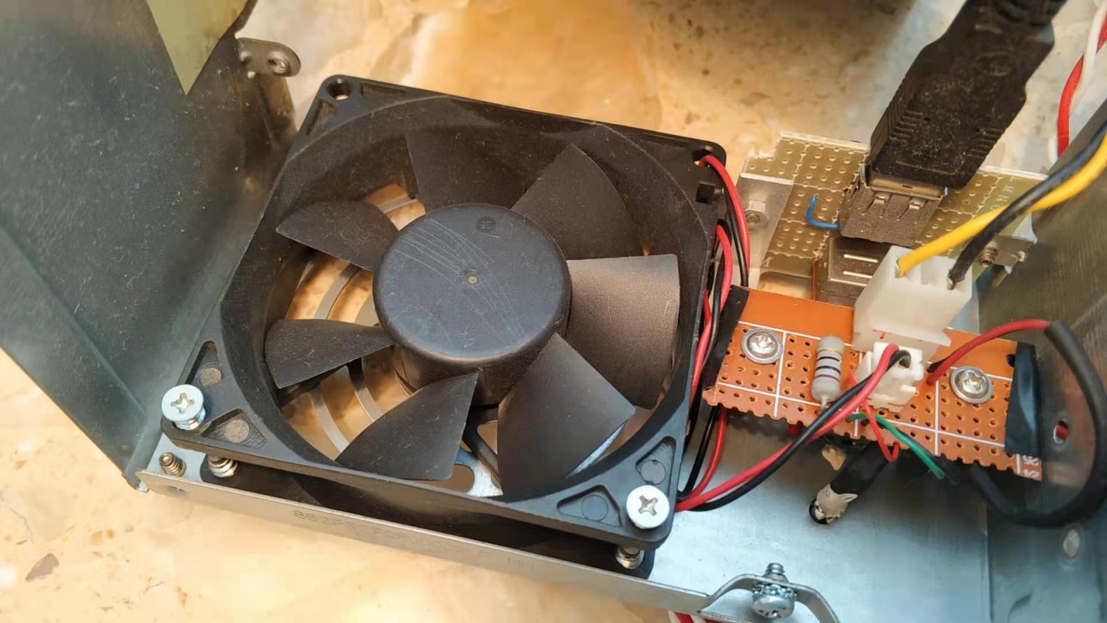

    A simple temperature monitoring and alarm device is made for fear of overheating and burning of the monster motor driver module. It specially monitors the temperature of mm and motor, and alarms when it exceeds the set value.
