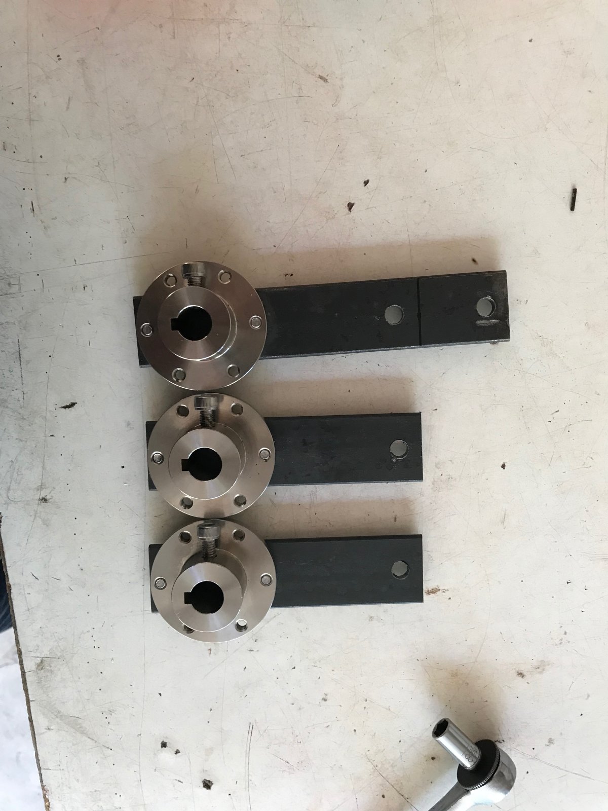

    I noticed you used some flange couplers for your output shaft to lever adaptation. I wanted to leave a link here for anyone following this project in the future. I was able to find something very similar at
    https://www.rainbowprecisionproducts.com/h-18mm-p-2401.html for only $10 a piece plus shipping. I got all 6 for about $80 and they arrived in 5 days. (USA)

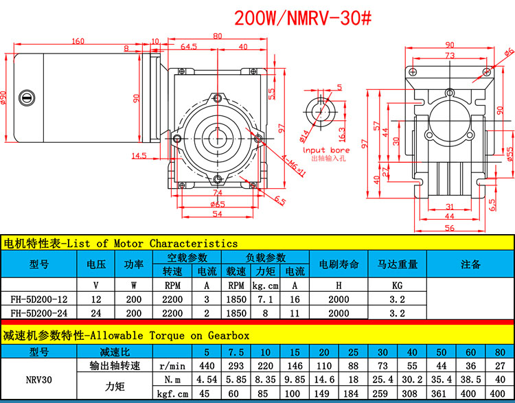

    Game not moving the sim:
    I have min/max values in the tuning center, so the rig should move some at least. I'm less worried about actually tuning it once it moves, but instead that it doesn't move at all.
    Motor torque:
    I've cut the levers shorter, from 5", to the 3 5/16" that I mentioned earlier, all seems good with that.
    My issue however is that it still won't move me, and I don't even have the seat on right now, which will weigh an extra 40 pounds. I did the math, and my motors should be able to move 400 pounds with the current lever arm length (25.4Nm motors), however it won't move me, even though I weigh 260 pounds, and so combined with the frame it would be lifting like 310ish pounds, far less than the 400 maximum.
    First, I was also having a issue where if I moved the axis slider too quickly in SimTools, the motors would all freeze, and an occur would occur on the 2x32 board. I solved this by going into describe and limiting the max amps to 10, and max volts to 24, as these are 200w motors. It should be noted that before this, I was able to lift myself very slowly via SimTools, however it would have trouble if I tried to use the heave slider.
    The strange thing is I was able to, using the SMC3 Utility, have a single motor lift 5 extremely heavy toolboxes, which in all weighed 143.2 pounds, plus it was also moving the frame. The motor wasn't moving slowly or anything either. This, along with the math, leads me to believe that SimTools simply isn't using the full power of the motors.
    Here's my math btw:
    CTC = 0.086 m --> (8.6 cm)
    Motor torque = 25.4Nm
    Max weight = torque/CTC (N)
    Max weight = 25.4/0.086 (N)
    Max weight = ~295N
    295N = ~30kg
    30kg/motor * 6 motors = 180kg
    180kg = 397 lbs
    As you can see, the math and SMC3 both point towards the motors being more than capable at this CTC length, so I'm hoping that one of you can help me with figuring out what the issue is with SimTools.
    Also, as I forgot to mention earlier, the gearbox produces 25.4Nm of torque at 72RPM.

    Disregarding mechanical loss, to know what Newtons it will take to move something it will be Mass (kg) x Acceleration (m/s) = F (N). So to move 100kg at 0.3 m/s needs 30 N. It takes 9.8N per kg to counteract gravity. Keep in mind there is significant mechanical loss in things like the gearbox, depending on the ratio you may want to allow between 10% to 50% loss for worm gears and the greater the gear ratio the higher the % loss is: http://www.meadinfo.org/2008/11/gear-efficiency-spur-helical-bevel-worm.html
    You also can't assume that the mass is evenly distributed, at times only some of the motors have the majority of the load.

    Hi
    One watt is one NM with a speed of one meter a second.
    Motor is 200watt with a speed of 72rpm
    72/60=1.2x2xpi=7.54meter a second
    200w/7.54 m=26.5Nm without loss
    i-30 wormgearbox is somewhere about 70% efficient

    Where did you source your motors?
    I have a very similar motor, but instead it is a 300w(output at gearbox) rated at 18rpm with a 100:1 ratio.
    Depending on your ctc arm length you may not need such a high output rpm. You may consider changing out gearboxes for a better output torque with slower rpm.

    Thank you guys, this helps a lot. I'm pretty sure I'm going to need more powerful motors.
    I got them from China via AliExpress. They were the ones SilentChill recommended I get... Here's the link: https://www.aliexpress.com/item/328...&terminal_id=946e480d49ff4a97a9fa588b83dfad9d.

    Hmm seems strange, I was using 12v 125w motors at 100rpm with 100mm levers and it lifted me and my platform fine.
    Yours are 24v 200w and only 72rpm I cant understand why they are not powerful enough ??
    Sorry if I've given you the wrong advice but I would of been certain they would of been easily powerful enough :(

    These motors are very similar to the motors I bought off Ebay. (Mine was listed at 300w though) One of the things that isn't shown on the aliexpress description is that 9A is the required current for no load running. According to the Ebay seller I talked with the motor requires up to 30A to run at full load. You may check in on the power supply, I went with a 720w to do my testing for the motor to ensure it wasn't current limited.
    For comparison I know my '300w' motor run at 24v can lift 75lb with some strain at 110mm ctc and a 100:1 gearbox ratio. Mine was rated at 200kgcm or ~ 40lbs@110mm based on the Ebay listing, but lifted 50lbs easily enough. Assuming you ran a 110mm ctc lever and we simplify by saying the gearbox losses are the same then each of your existing motors would strain to lift (40/100)*75= 30lbs each. That gearbox ratio might be a bit low for your needs.
    Lastly I wanted to bring your attention to the rpm output. Using an online rotary to linear speed calculator; an output speed of 75rpm at 100mm ctc will give 785.4mm/s. From what I've read you want to be somewhere around 200-300mm/s. Given this information you have plenty of leeway to trade some speed for torque using a higher ratio.
