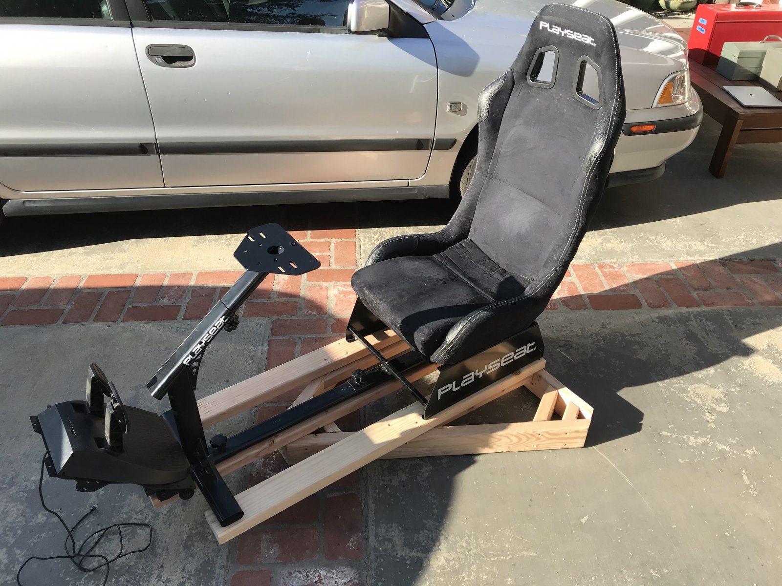

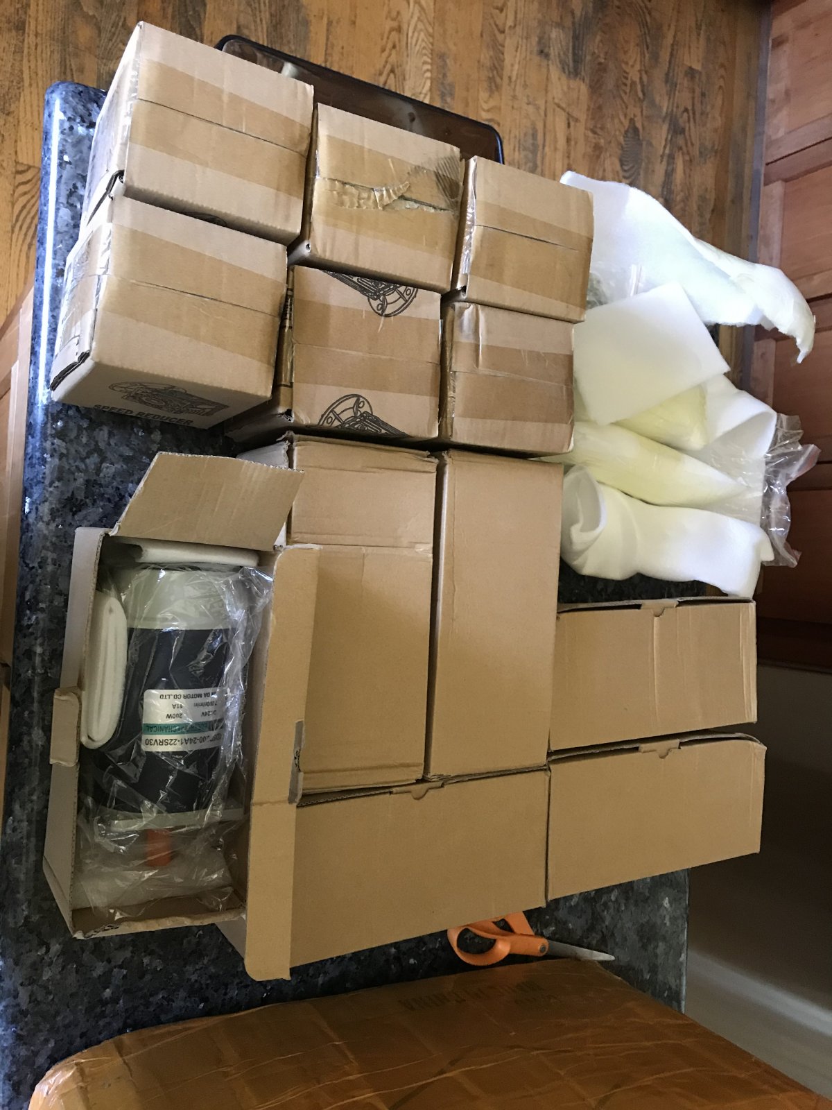

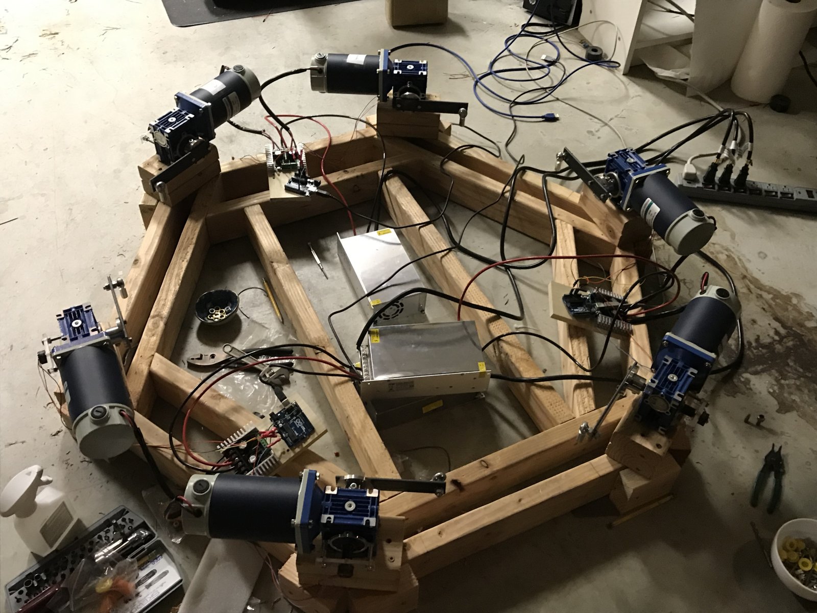

    Hello! I've been working on this for a little while now, with much help from SilentChill, and from kind people on the discord.
    Here's a list of the parts which I've purchased so far:
    Motors - $1272.38
    Motor Controller - $386.97
    Arduinos - $56.37
    PSUs - $145.29
    Wood - $30.00
    Glue & Screws - $28.43
    Potentiometers - $117.92
    Cables/Wiring - $79.15
    Rod End (R) - $31.26
    Rod End (L) - $31.26
    18" Connecting Rod - $105.84
    Wires - $35.00
    Carriage bolt (5x5) - $30.00
    Bolts and nuts - $24.00
    VGA Cable - $8.71
    total: $2382.58

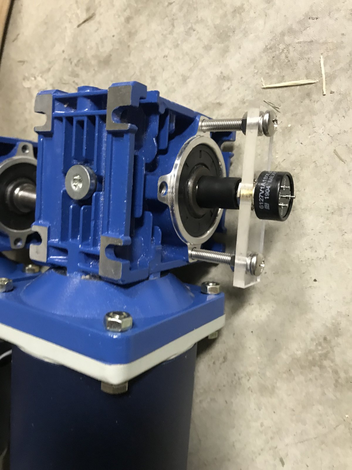

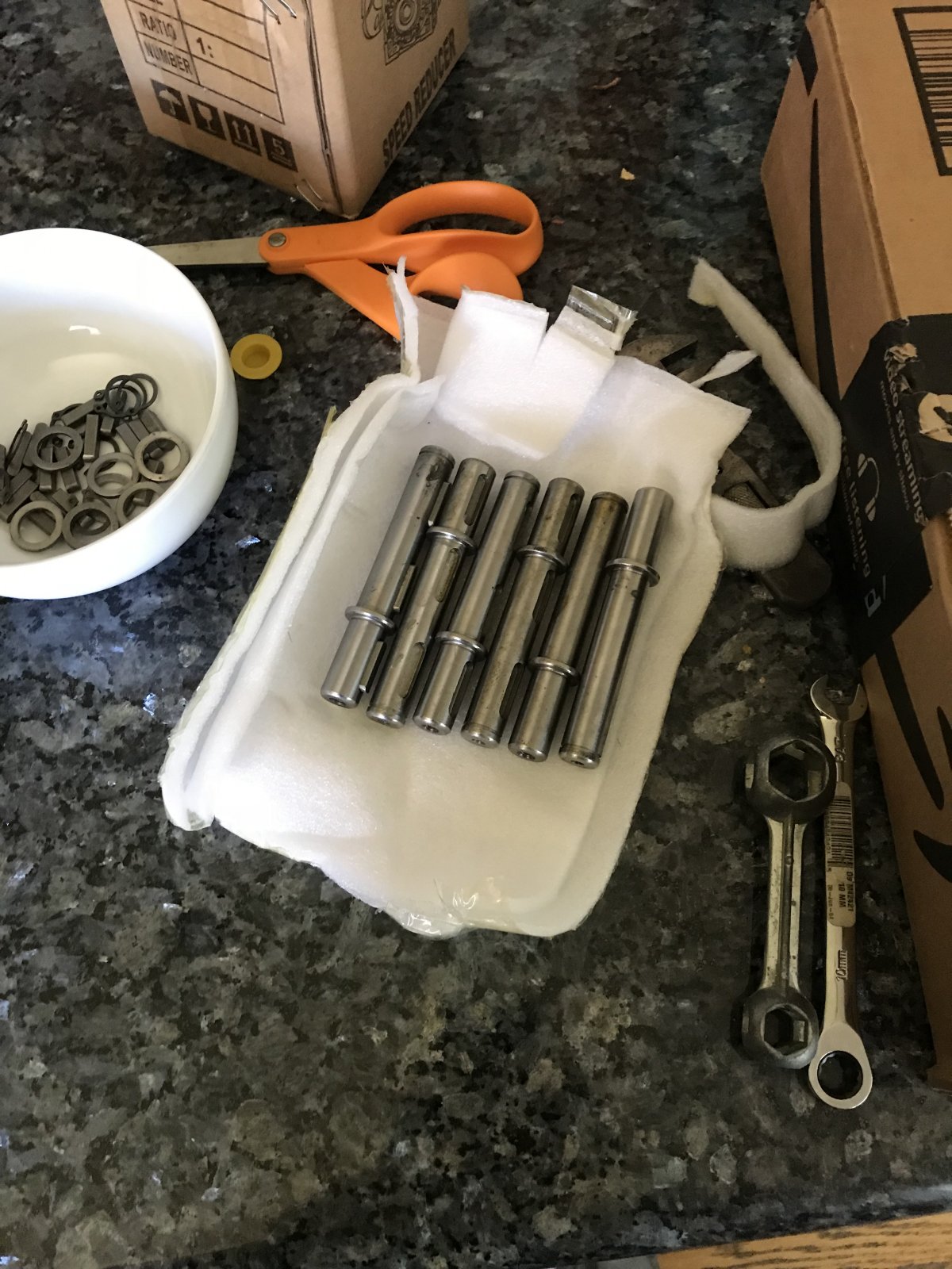

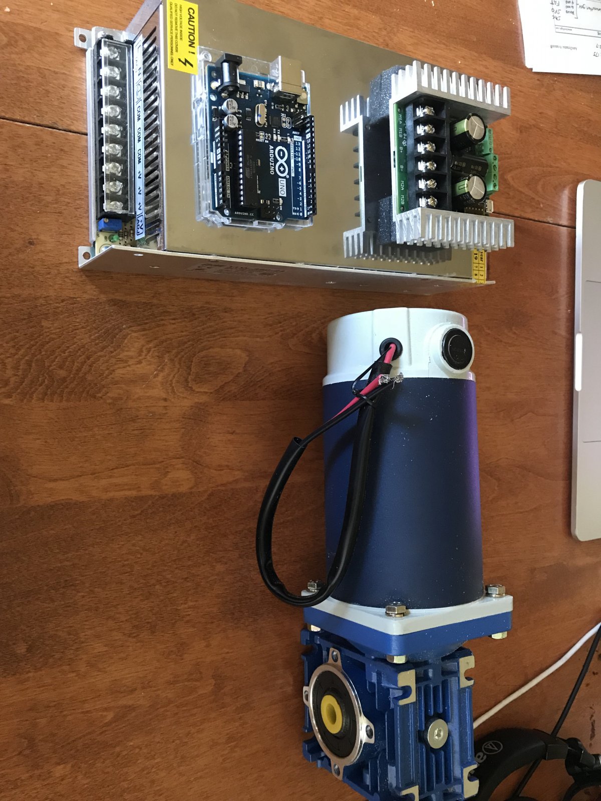

    Motors and gearboxes:
    Motor shafts:
    Sabertooth 2x32, PSU, and Arduino Uno

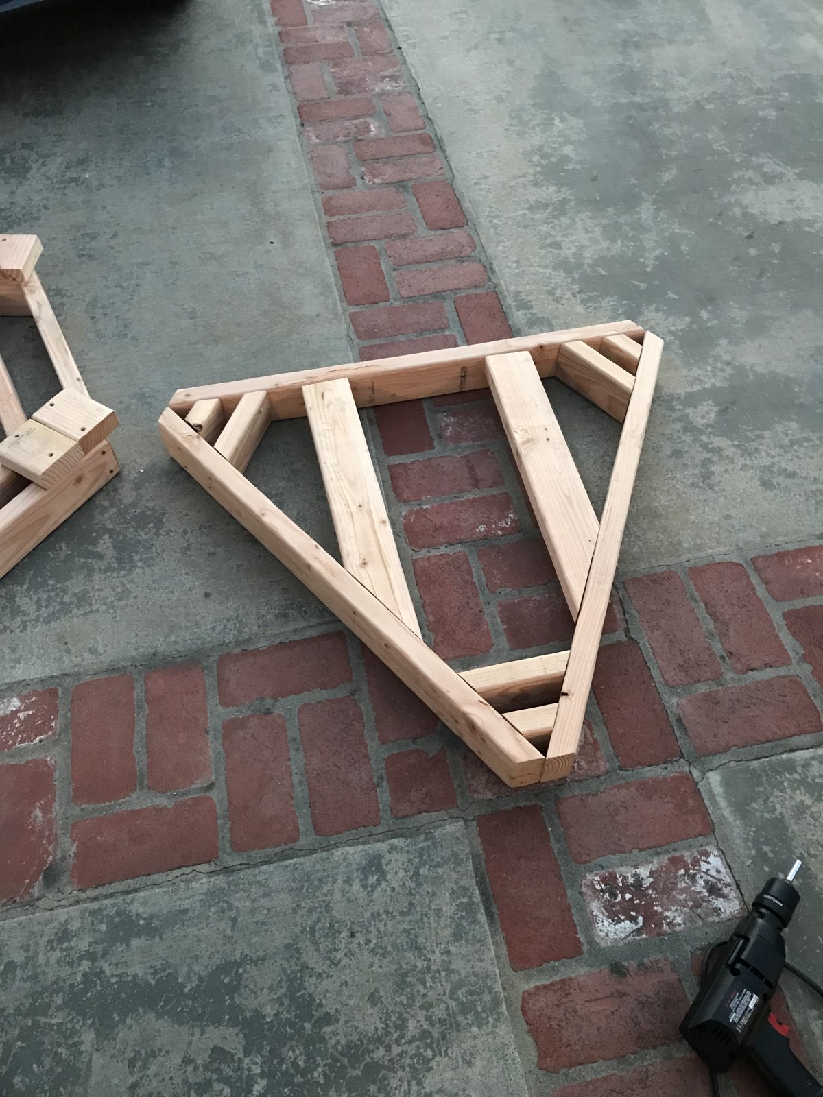

    Wooden base:

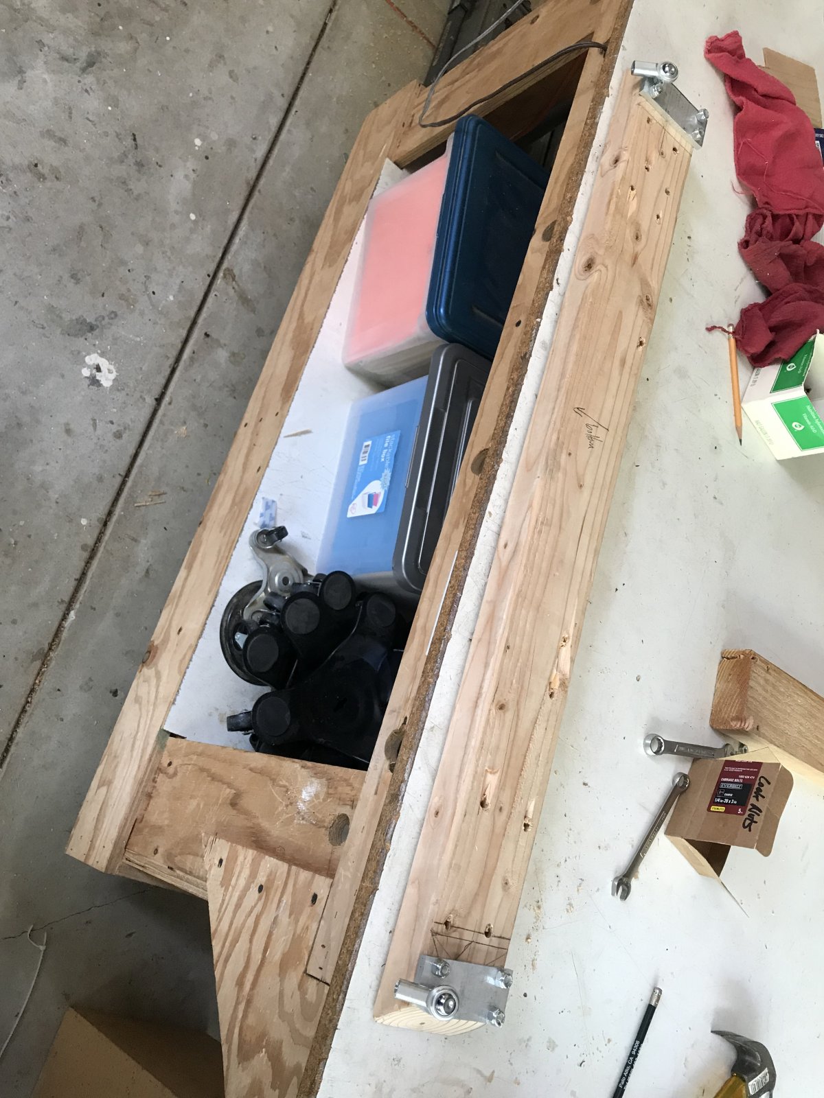

    Wooden cradle:

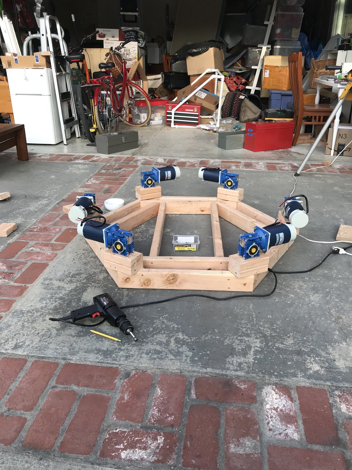

    Cradle with the seat attached:
    Base with the motors in place:
    Now that I've gotten the parts that I need, and that I've assembled the bulk of the structure, I've begun working on the electronics portion of the project. I was very happy yesterday when I got my motors to move for the first time.
    I've found someone very close to my location (not from this forum, a friend of a family friend) who has a garage filled with tools that have made everything a lot easier. Thanks to him, I've was able to create the pot mounts today using some fiberglass, tubing, and electrical tape. Given it takes almost no force to turn them, it should work fine.
    That's about where I am right now. My plan right now is to work getting the motors and the pots all wired up to the Sabertooths, Arduinos, and PSUs, so that I can hopefully start testing everything with SimTools.

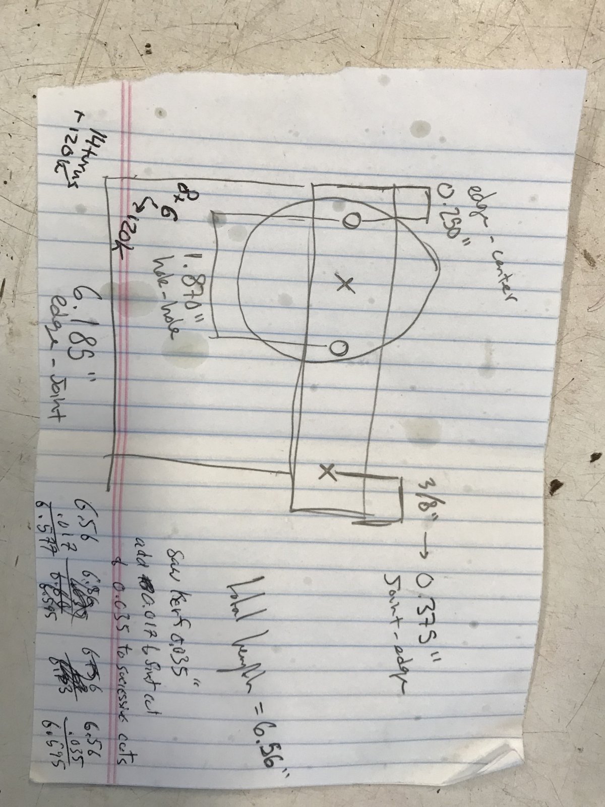

    After that, I need to reinforce the parts of the cradle where I'm attaching the ball joints. I'm planning on using some 1/2" aluminum plate, putting in threads for 4 bolts, and a thread for the ball joint itself, and bolting one of these onto each of the joint locations to reinforce them.
    I also need to somehow attach the levers to the motor shaft. I'm planning on cutting down and milling an aluminum shaft, so that I can run bolts into the small recesses in the motor shaft to attach it, and then bolting the crank itself onto the aluminum shaft.
    Apologies if any of this is incoherent--it's about 1am right now, and I just wanted to get this posted tonight (this morning?). All advice and opinions would be appreciated. Feedback is how I improve.

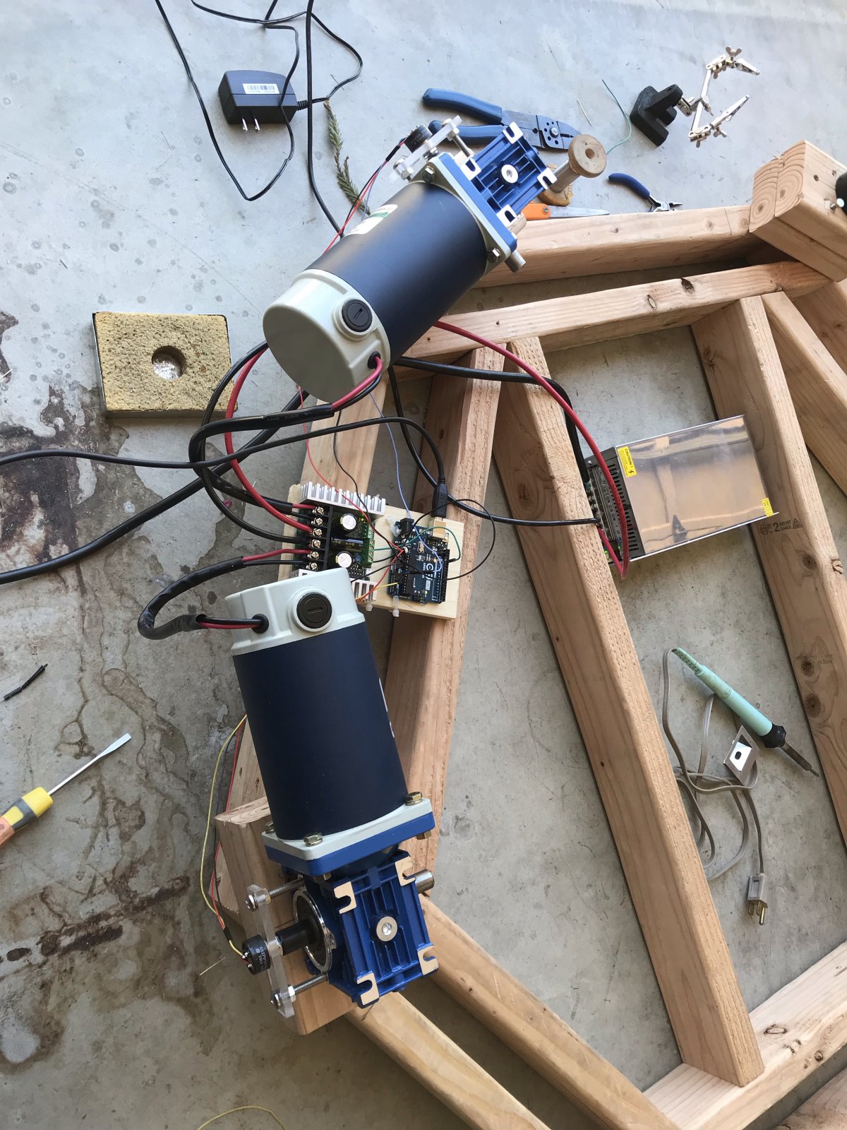

    I've wired up a pair of motors on my rig in the garage now (I'd previously only tested the motors inside on my Windows 10 PC), however I have an issue I'm hoping someone here could give me a hand with.
    Wiring:
    I don't want to move my Windows 10 PC to the garage, as I frequently use it inside for other things, and so right now I have a Linux box in the garage, and I'm using it with Wine so that I can run the .exe files I need to.
    Unfortunately, I now seem to be unable to upload BlazingH's SMC3 Arduino code to my Arduino Uno. I'm having a dependency issue, despite having run the installer from Dimension Engineering for the Sabertooth/Arduino dependencies. I think the problem may be that their file is a .exe, and because I'm running it through Wine, it didn't work correctly. I really don't know though.
    Error:
    Any help in this regard would be greatly appreciated, as I'm not sure how to fix it, and would really like to avoid moving my Windows PC to the garage.
    Thanks!

    Thanks for the suggestion. I did this, and it appears to have worked, however I then effectively ran into the second part of your reply. Sadly, Wine does not play well with the serial ports, and so I was having a difficult time connecting to the Arduino. I've just given up and moved my computer out into the garage, which is working fine for now, however I've encountered a new problem.
    It seems like the potentiometers are bouncing back and forth between min and max in their range (they're hall pots), and it's making the motor effectively just shake as it tries to instantly change direction. Here's a video of the issue, as well as of the SMC3 Utils output screen.
    I'm just not sure what to do here. I thought the limits I set in the software would stop the motor from running to the edge of the pot, but I guess I was wrong. Also, I'm pretty confused as to why the motor would move in the opposite direction once it passes that threshold on the stop. Perhaps someone could give me a quick rundown on how the SMC3 Utils software works, because I couldn't figure this out from it's page.

    "Too large a Ki can cause the position to overshoot and oscillate."
    "PWMmin This is the minimum duty cycle that is used to drive the motors to their target position. For example if the motors are already close to target they will not need to be driven as hard as if they are a long way from target (or they may overshoot and oscillate)."
    "PWMrev This is the PWM duty cycle that is used to drive the motors in reverse (hard brake) if they enter the limit zone ... Setting this to a similar value as PWMmax would make sense."
    OK. I think I know what to do now. I'm not sure how I missed these portions of the post, but thanks for getting me to take another look. I think I had PWMrev set to zero, which is causing the motors to overshoot their limit, causing this oscilation issue with the pot. I also think that the motors are being driven reverse to what they should be, because they always move AWAY from the blue target line, versus moving towards it as I believe it should.
    I'll get back with an update once I hopefully fix this. Thanks again!

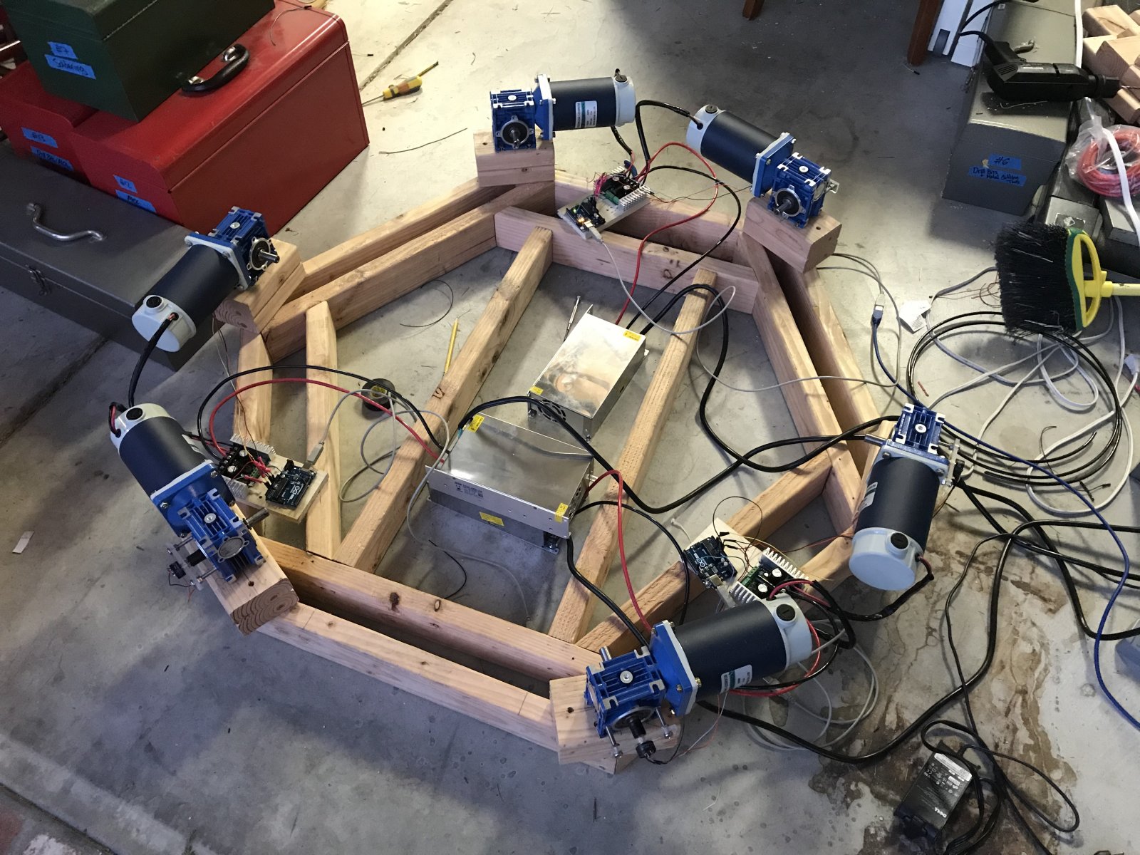

    Success! All the motors are now wires up, and everything seems to be working with SMC3. Thanks to Historiker who helped me out a lot.
    Here's a pic now that everything is wired:

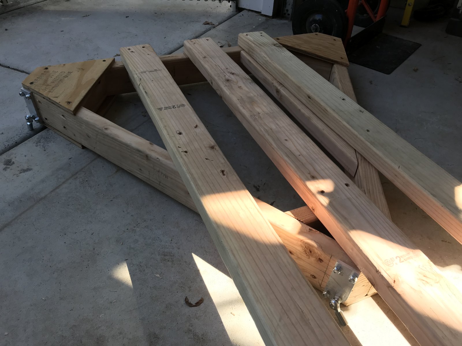

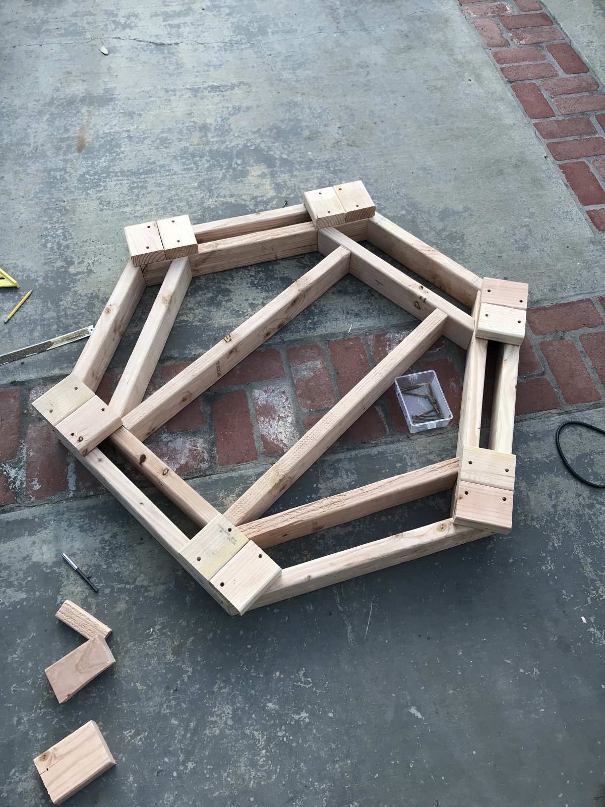

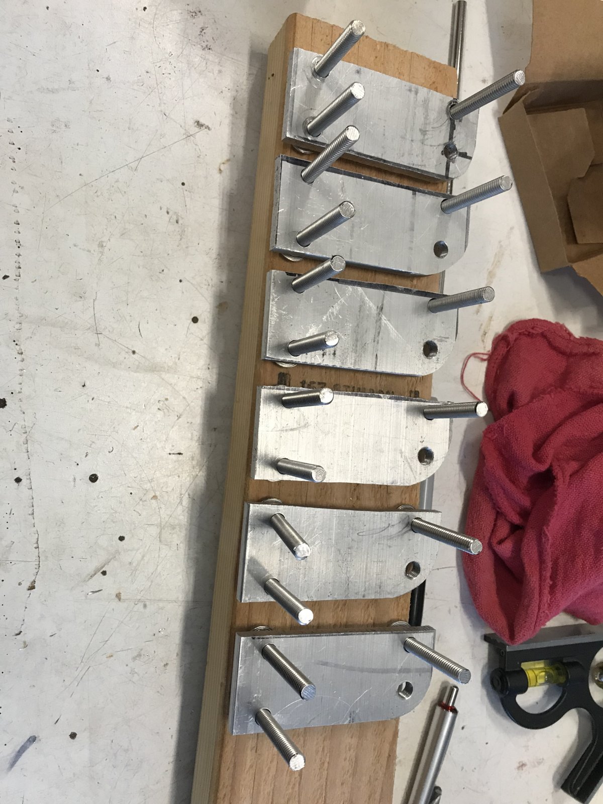

    Got around to milling the aluminium reinforcements and mounting them to the cradle yesterday. I also swapped out the small 2x4 sections that attached each side of the cradle for plywood, as the 2x4s were being blocked by the heads of the bolts anyway, and the plywood should be sturdier anyway. Here are some pictures:

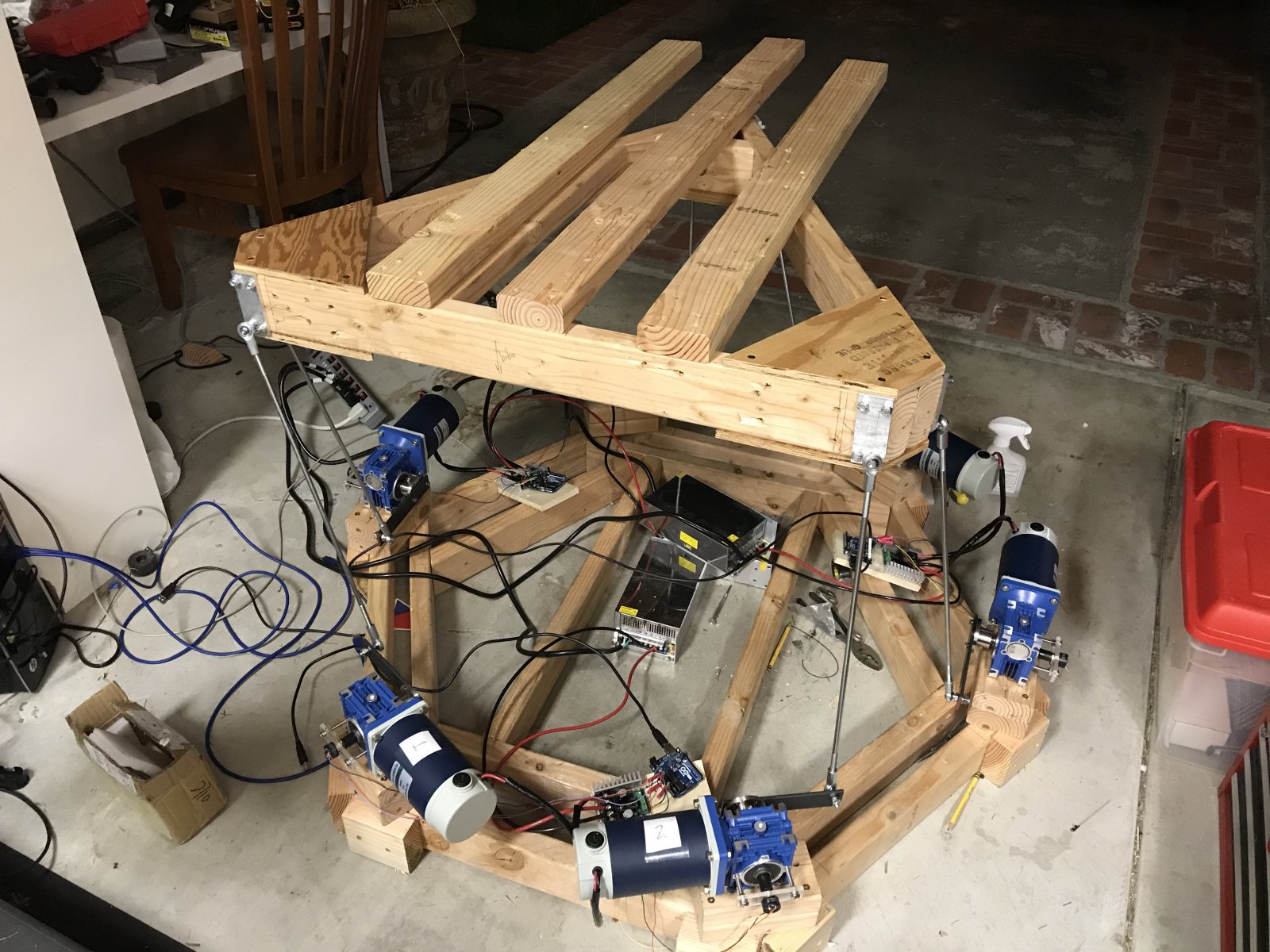

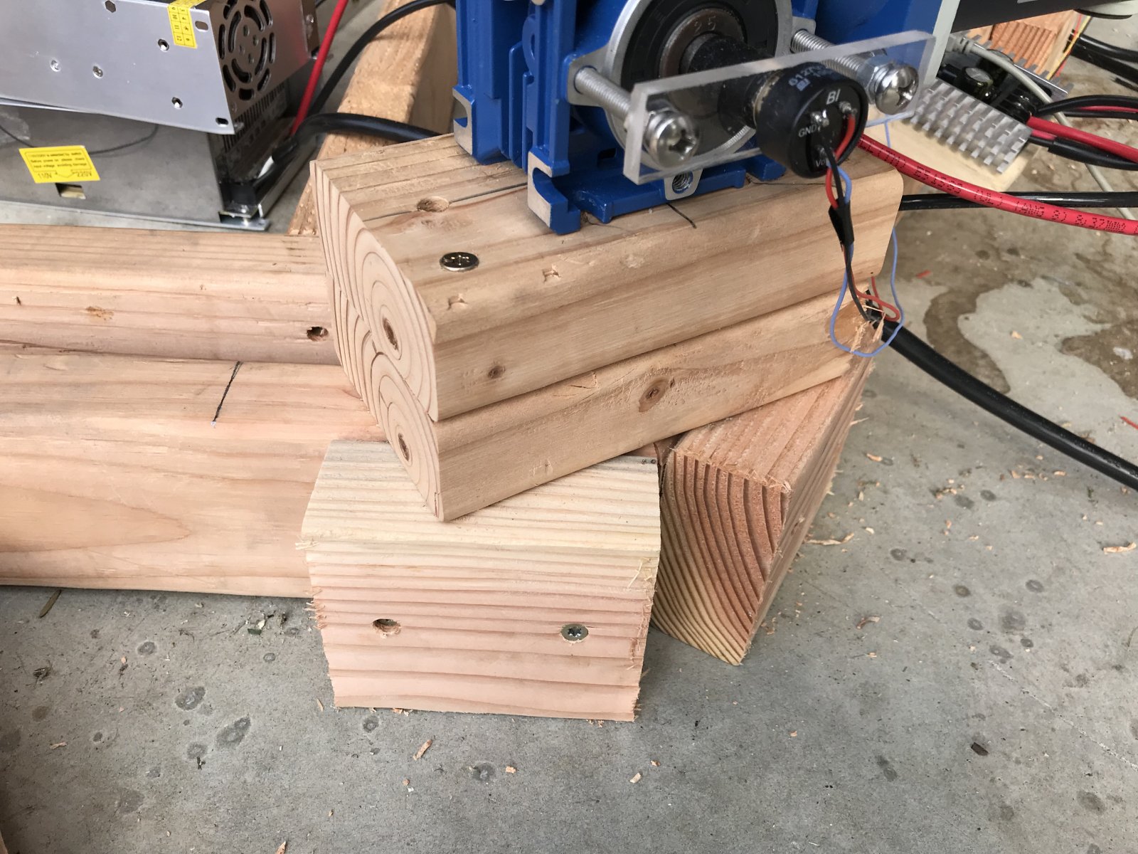

    It's assembled! Here's the pic:
    I'm somewhat concerned about the strength of the connecting rods, but we'll see what happens.
    Before I assembled everything, I finally reinforced the motor mounts with an extra block of wood below each one to make it a bit more rigid, as well as I attached the cranks to the motors (obviously). Here's some pictures of that stuff:
