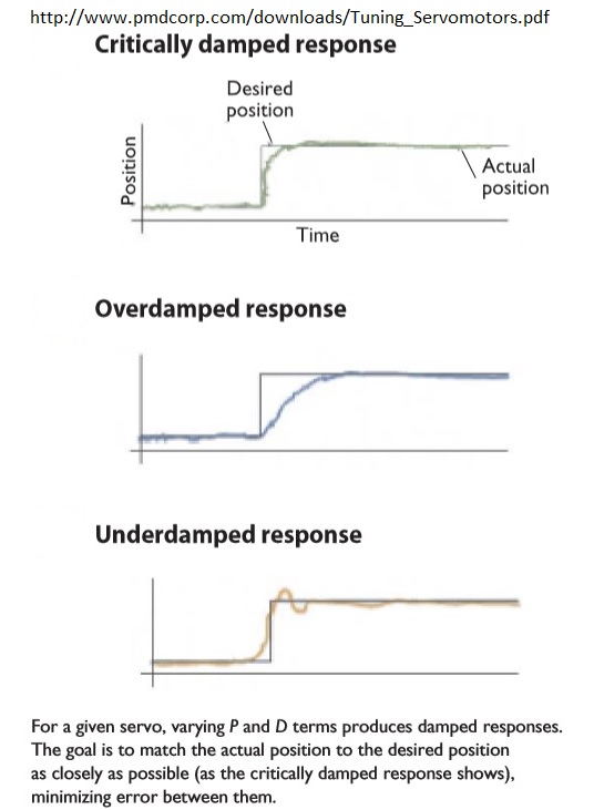

    As for settings, each motor is different and they react differently to the PID settings.
    My advice is to start off slow and then slowly increase the PID until you get a good balance.
    If you use the JRK tool and move the motors you should see a nice arc coming to a stop. This picture shows it
    The first picture is what you want. If it is looking like the second picture then add more P, if it is looking like the last picture then add more D or lower the P.

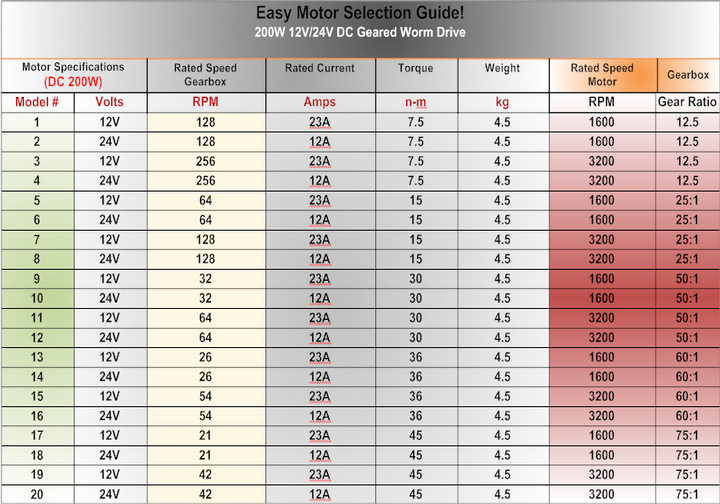

    I post now the datasheet from motiondynamcs.com.au of their 200W 12/24 DC Geared Worm Drive.
    For the motors 12V is indicated "rated current" 23A . Rated current mean continuous current and not peak/stall current? correct? In this case this datasheet is wrong as "rated current" for motors 12v 200w should be 16,6A and probably 23A is not rated current but stall/peak current. Or maybe I'm still not understanding something

    My ebay supplyer always very helpful and quick in responses writes me this:
    "The datasheet is correct, The current is 23A if the load is applied continuously, so this is continuous Amps"

    I email the datasheet to Pololu and Derril (tech support) answer me.
    Here his answer:
    "With a continuous current that is nearly double the continuous current
    rating of the jrk 12v12, those motors are definitely too large for the
    jrk to handle. You might consider looking at the RoboClaw motor
    controllers. I suggest looking at the RoboClaw 2X60 for the motors you
    are considering:
    https://www.pololu.com/category/124/roboclaw-motor-controllers
    https://www.pololu.com/product/1499
    If you find a motor closer to the jrk's ratings, like the 14A motor you
    used before, you can use the methods in that xsimulator.net post to
    overcome some current spikes, but the problems you will almost certainly
    run into with that 23A motor will likely be much harder to overcome

    Thank you guys...I've just find another datasheet of my motors in wich is specify that current nominal is 23A an current peak is 40A. Too much for jrk12v12. I Think that the right way can only be n. 2 saberthoot 2x32 for my 4 motors.
