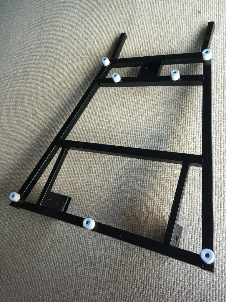

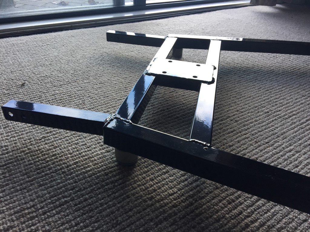

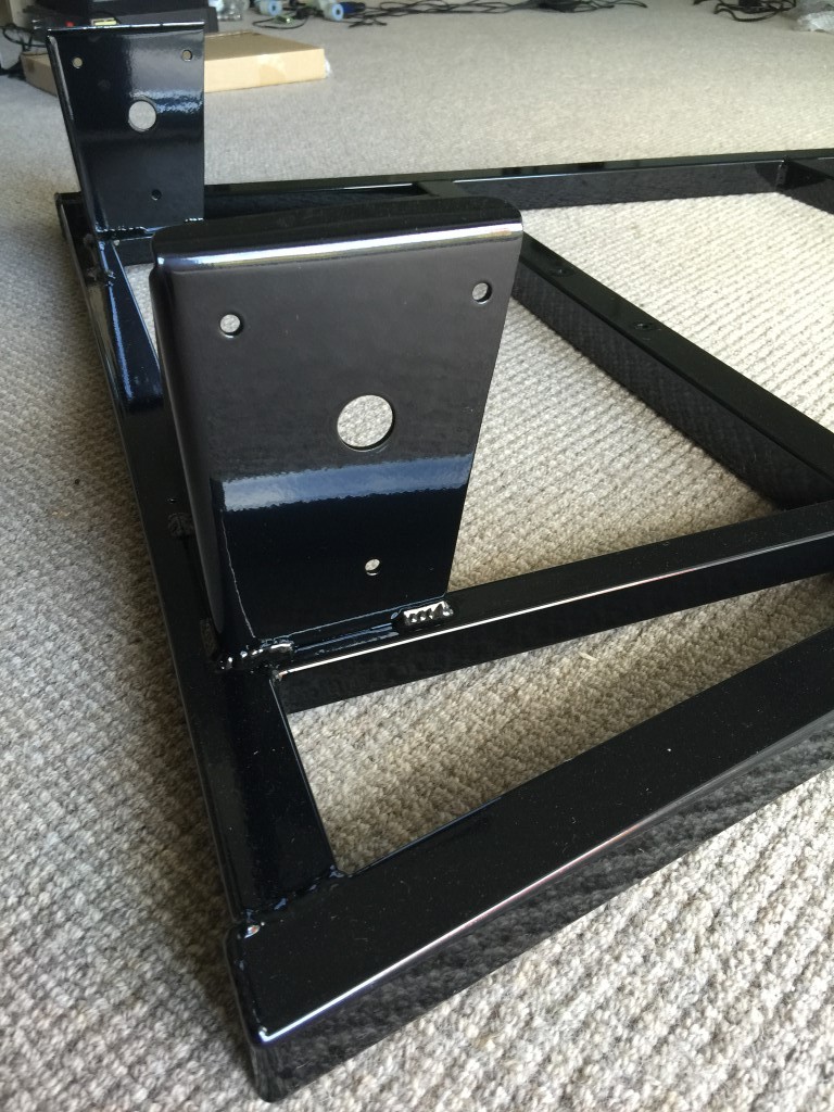

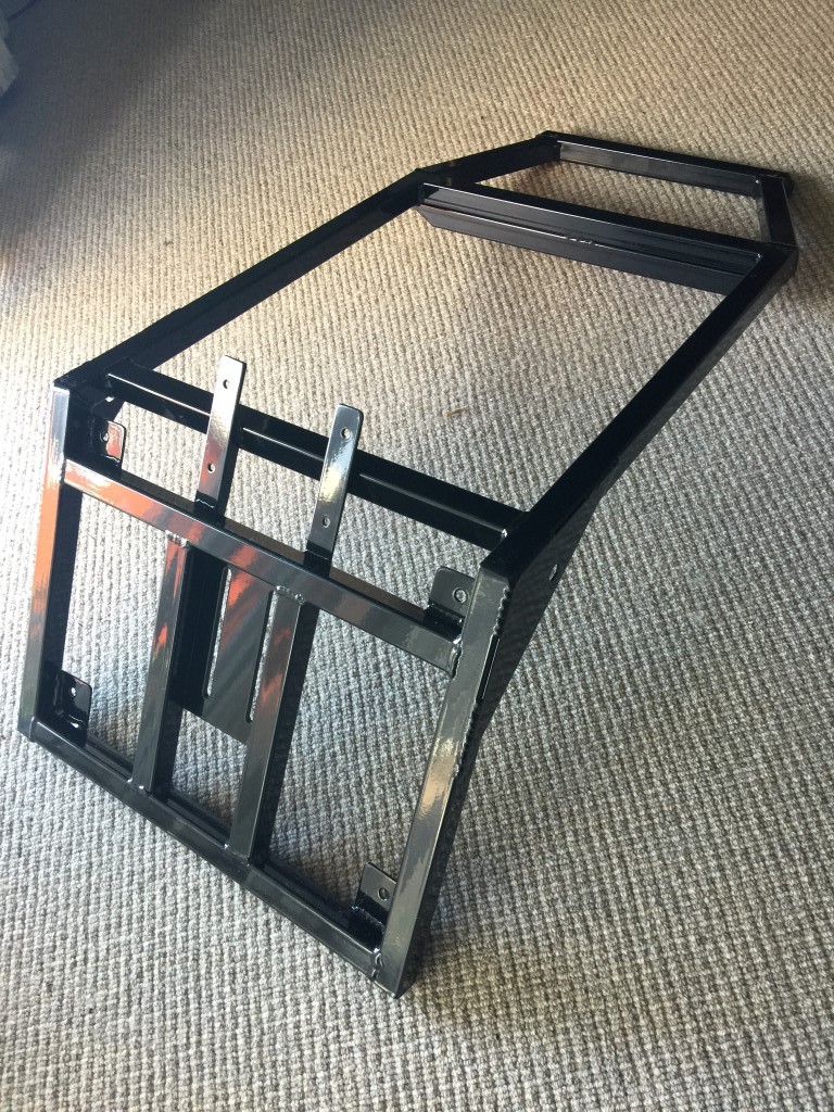

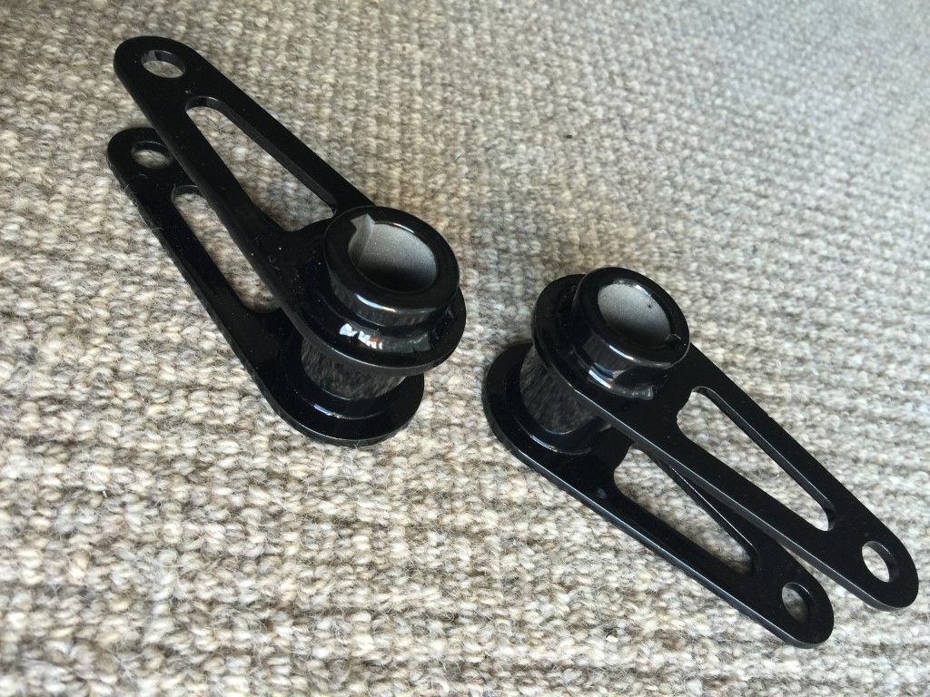

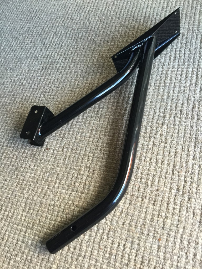

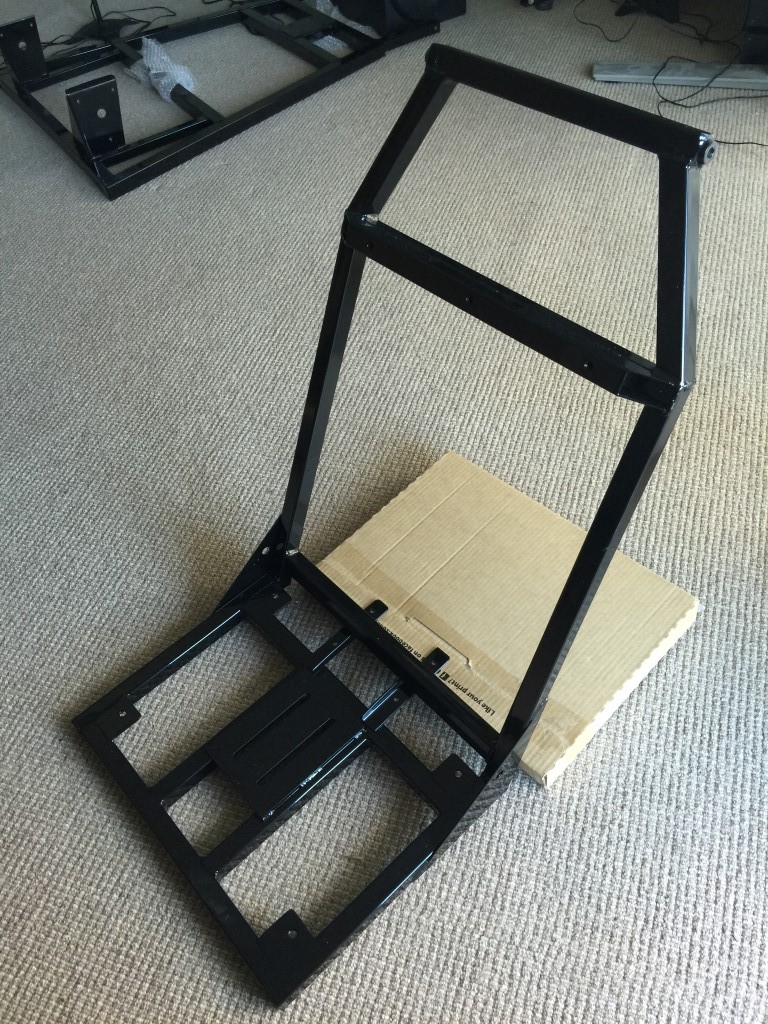

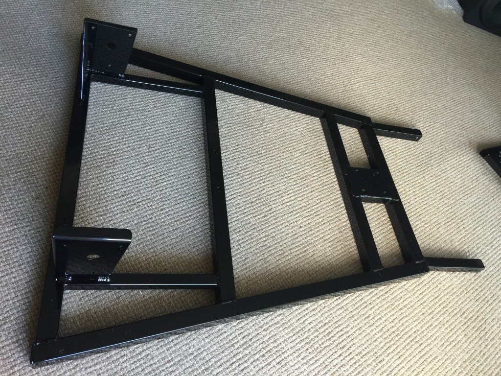

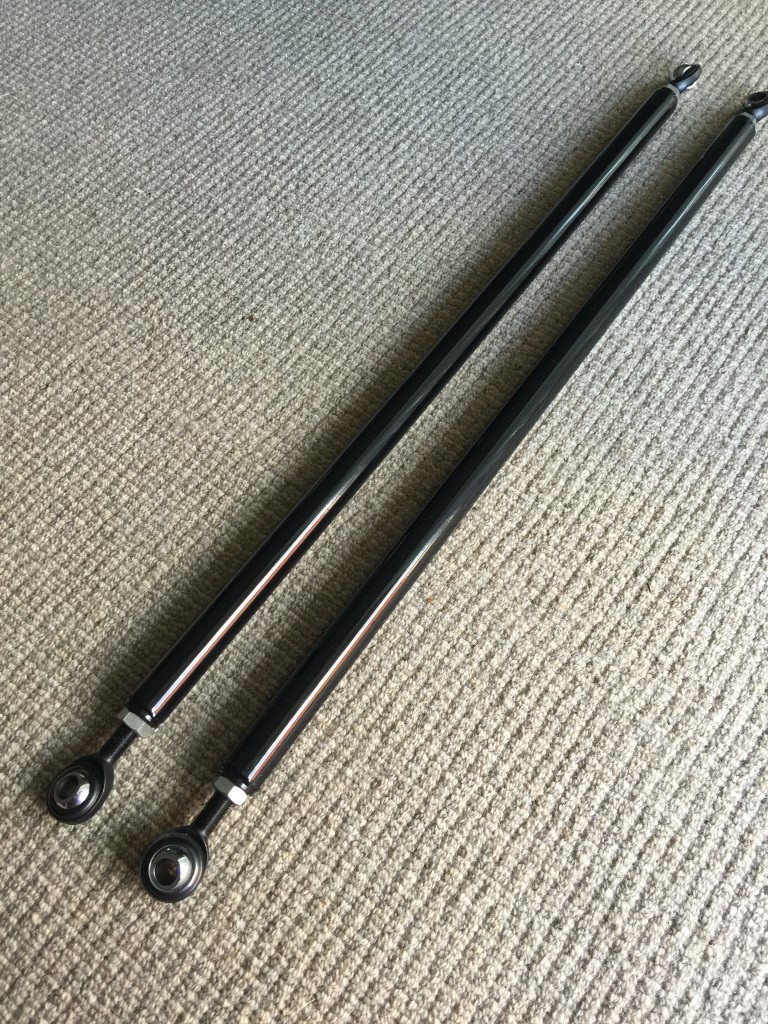

    Sorry I have been really slack at updating my build thread.
    Since my last update I have added a new DSD shifter to my rig.
    I also moved house the a couple of weeks ago so I used to as a good excuse to powder coat all the new parts of my rig.
    I went for a gloss black and it looks so shiny now. It looks even better in person.
    The powder coating wasn't very expensive and the results look amazing. I think I will be getting a lot more of my parts powder coated in the future.
    Seat frame
    DSD Shifter mount
    Connecting rods
    Lever arms
    Main frame
    Motor mounts

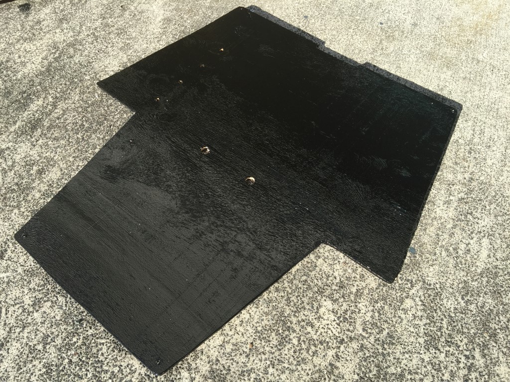

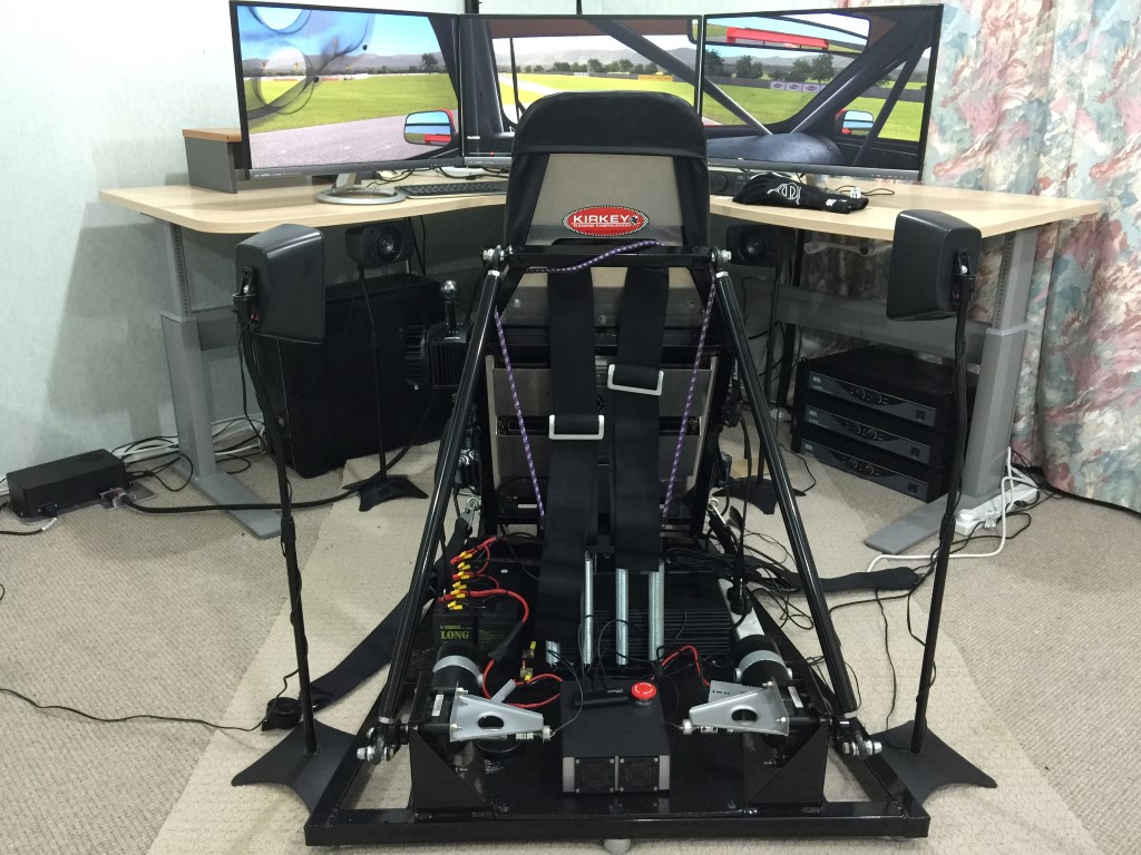

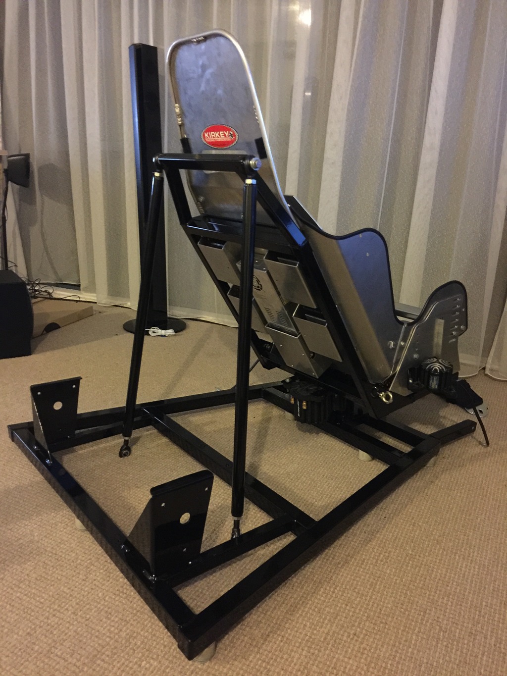

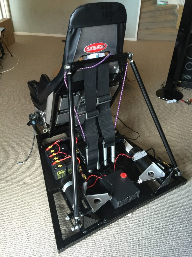

    Now on to the reassembly.
    Rubber isolation feet back on.
    So shiny

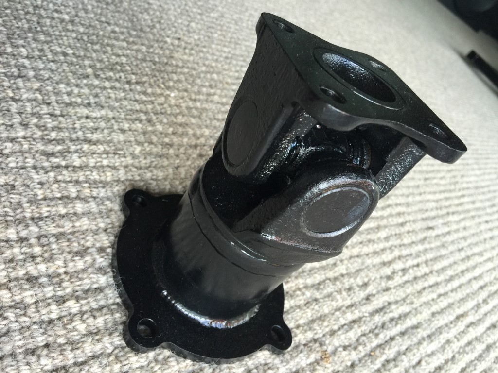

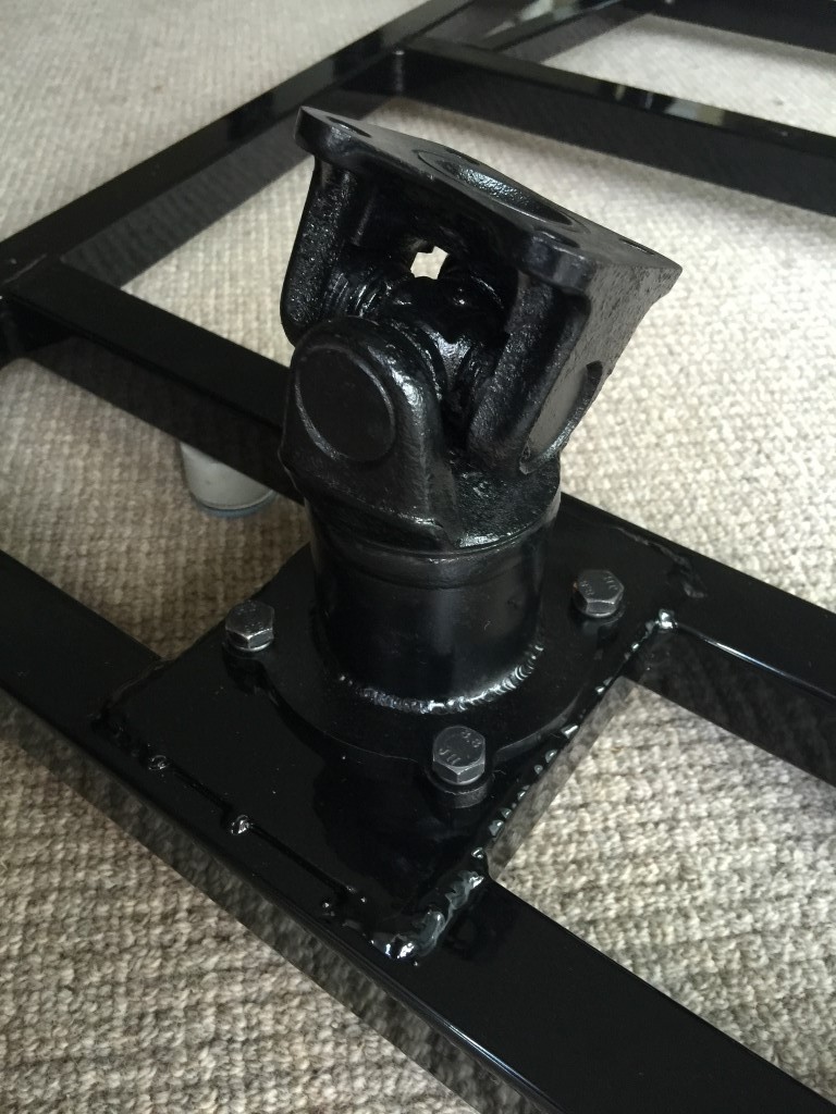

    The universal was painted instead of powder coated.
    Universal back on
    Seat and frame reattached.
    Plywood electronics board painted.
    Motors and electronics reconnected
    Back half of the simulator fully reassembled

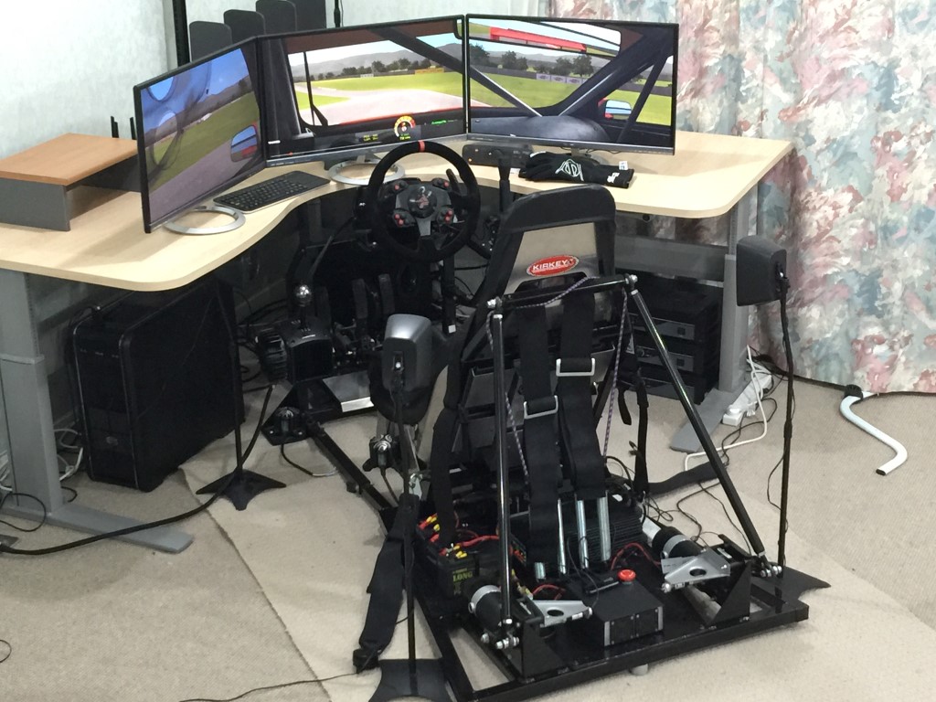

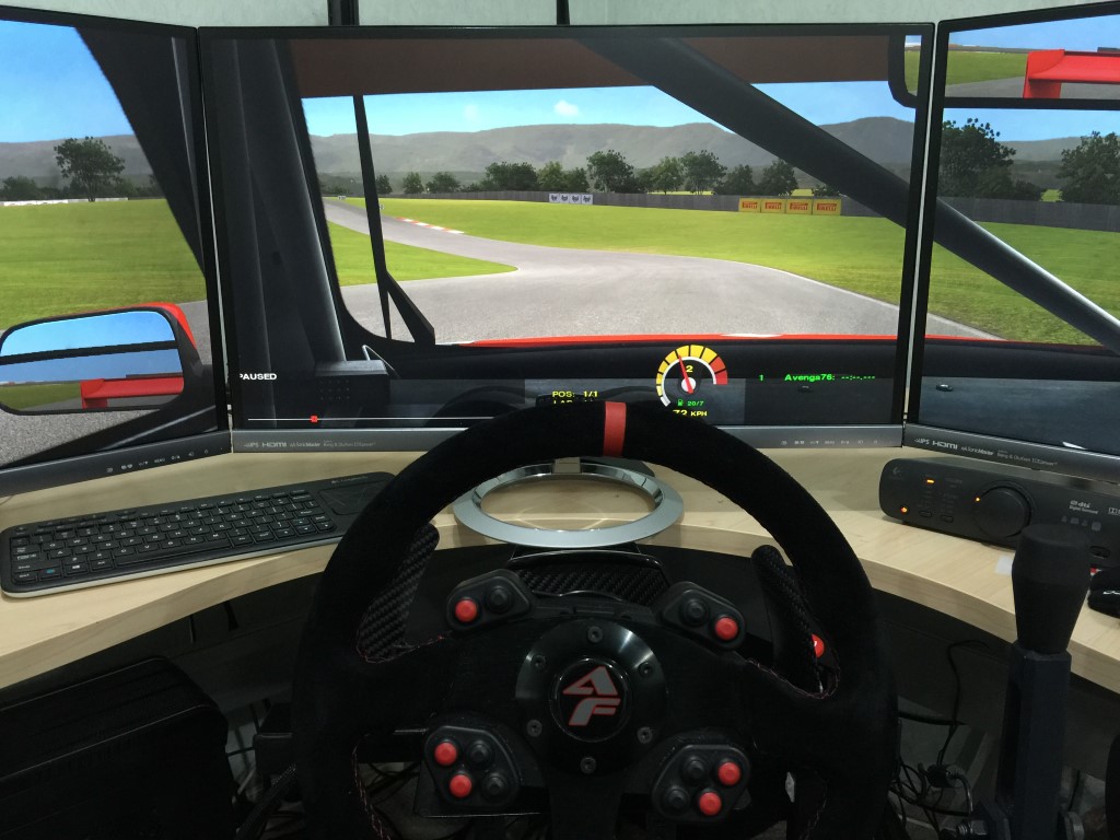

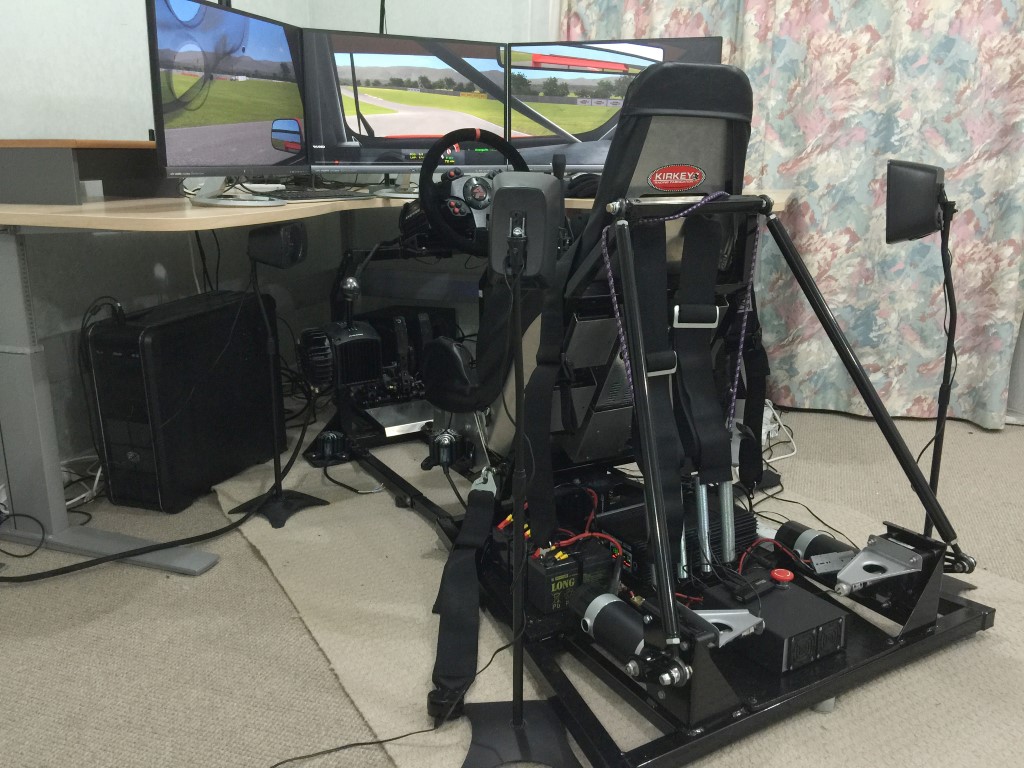

    I got a new desk so I could move my monitors closer and have them at a 45 degrees angle.
    My new house is much bigger so it means I have room to leave my rig permanently set up.
    Everything all set up and running
    • Like Like x 7

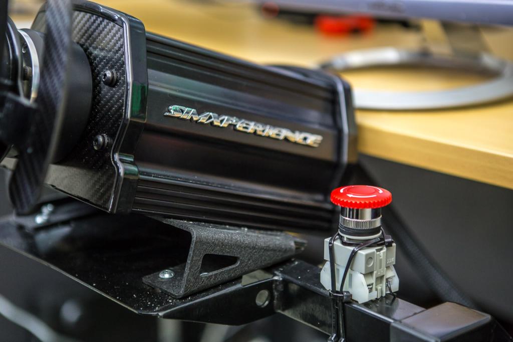

  11. RacingMat
    2,233
    21,082Coins
    @Avenga76
    yes, your paint is gorgeous!
    and your gaming room is desirable :)
    I'm just wondering how you can press the Emergency button?

    Thanks. @Nick Moxley is correct. I have another kill switch mounted next to my steering wheel as well a the one on the back. This means I always have one in easy reach.
    I find the one at the back really good if I have visitors over trying my rig. I can stand behind my rig and quickly tap the rear kill switch with my foot if they do anything crazy like flip the car (that has happened :))

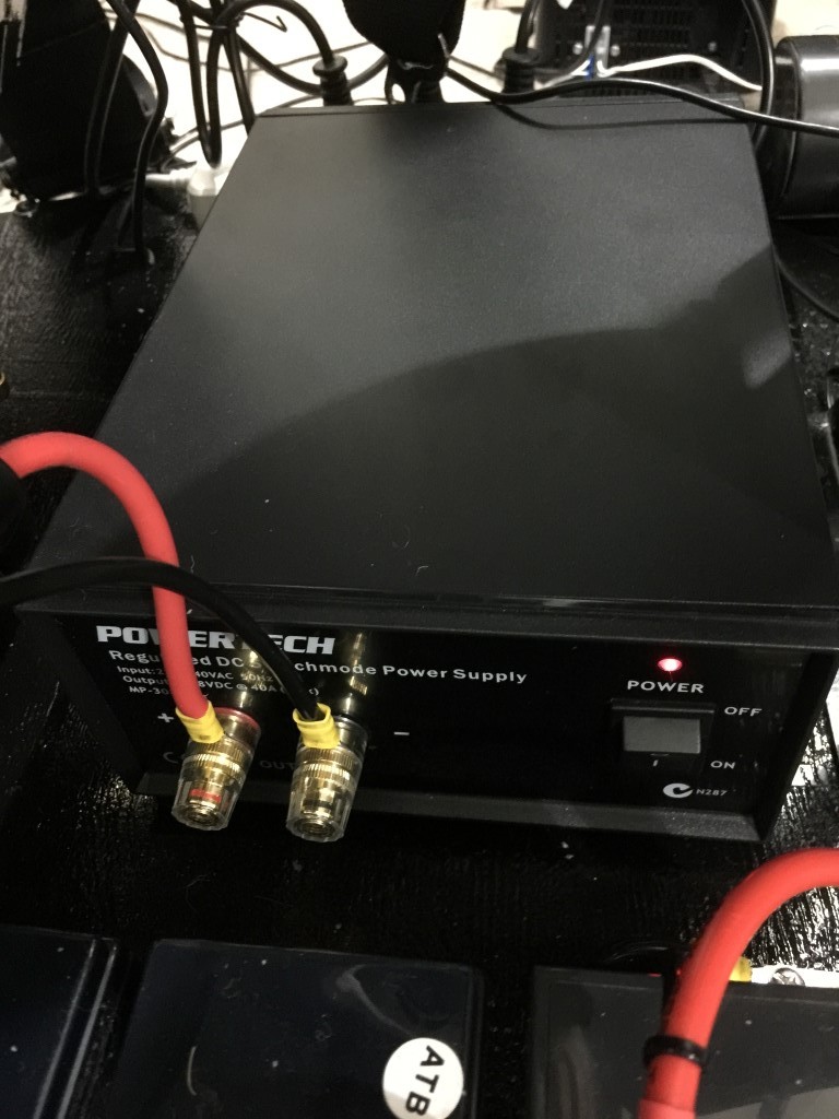

    Another quick update.
    I ditched my old smart battery charger. It was a little too smart for it's on good. It would do silly things like try to boost to voltage up to 14.7V to quickly recharge the batteries and it would error out if the batteries dropped below 12.5v.
    Just swapped it for a straight 13.8V 40A power supply. Seems to be running much better.
