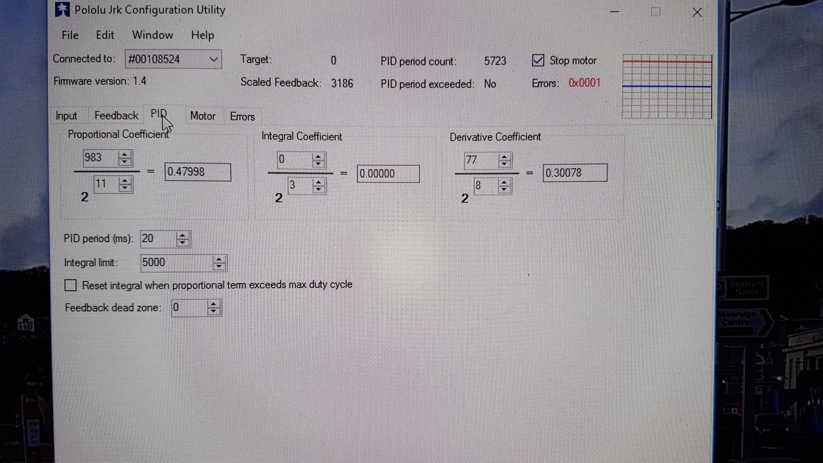

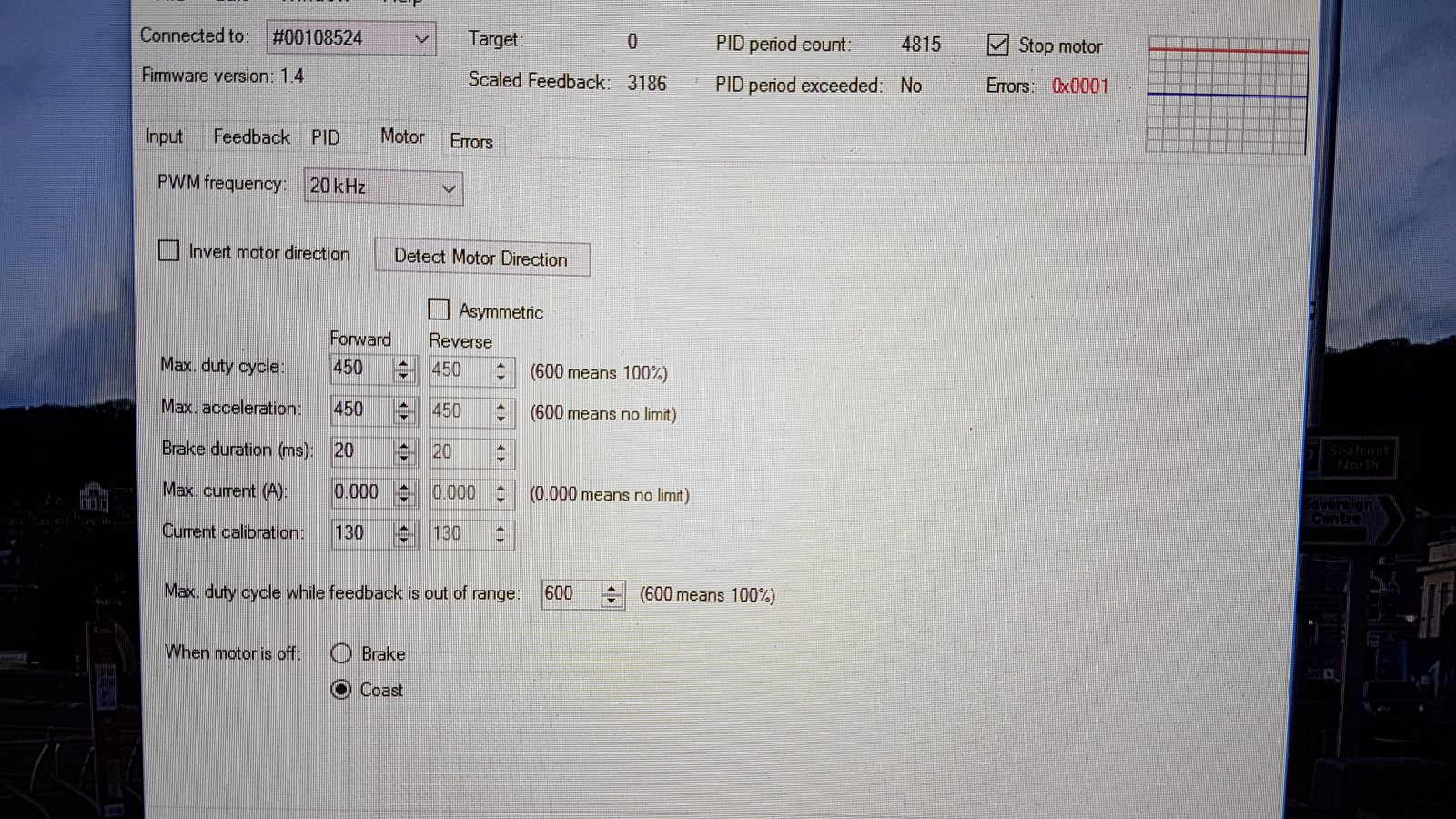

    Daguru could you please post your settings in pololu configuration?

    @gigi
    These are lower than i used to run, since v2 of simtools ive been able to lower the setting and still maintain the speed and feel of the rig 20170328_162633.jpg 20170328_162651.jpg

    Hi Daguru thanks the post of your setting. I want see the thread with your project
