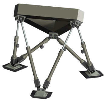

    we can fancy a simulator like this
    a classical seat-mover Pitch + Roll
    + on top of Surge table
    + Traction Loss platform
    + with heave actuator
    + belt tensionner
    But a 6DOF stewart platform requires specific calculus...
    How Simtools can drive a stewart platform easily? because we are struggling with @vulbas ...
    @yobuddy @value1 @eaorobbie : Is it possible at the moment by using only the filters and parameters in the Axis Assignements?
    or does this requires a specific plugin? or an additionnal companion app?
    It would be good to make the calculus on PC rather than on an external electronic board!
    Thanks!
