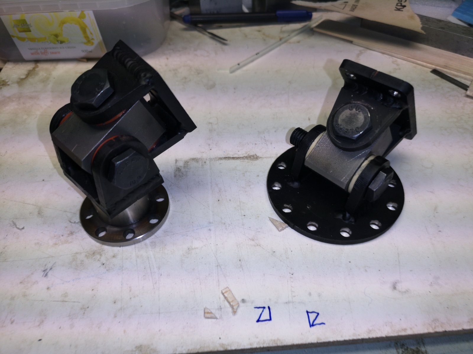

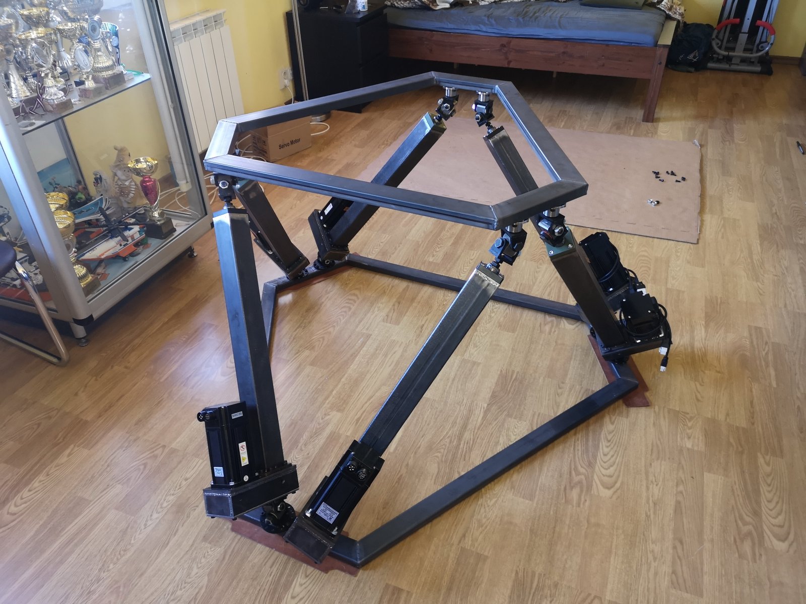

    Hello. Made a platform. I haven’t started yet. I make an electric automation cabinet with drivers. If anyone has any comments, write, do not be shy. Since I am new to this business, any comments are also useful information for me.
  3. SeatTime
    2,573
    Full steel actuators... they won't break in a hurry :). Old tech, but still a very nicely built Stewart Platform :thumbs. Look forward to seeing it in action.

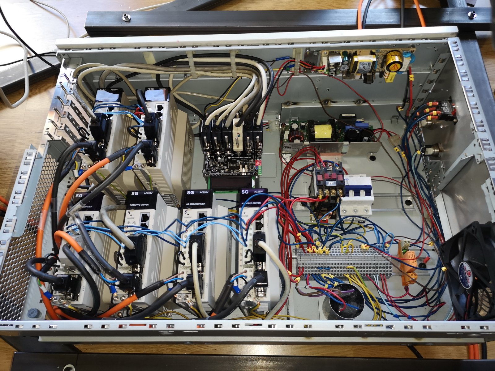

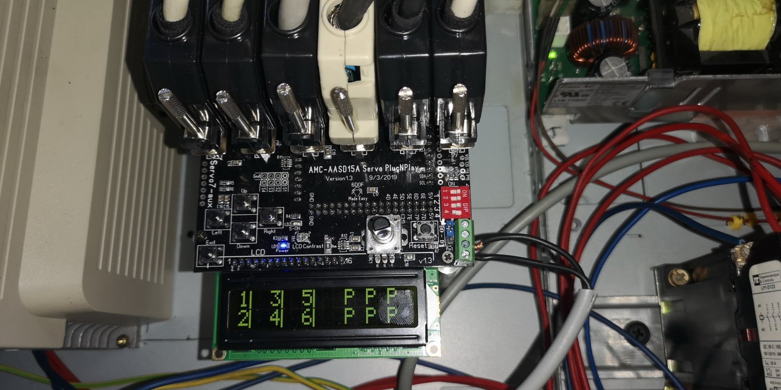

    Hello. He made a cabinet with drivers, which still needs to be supplemented.

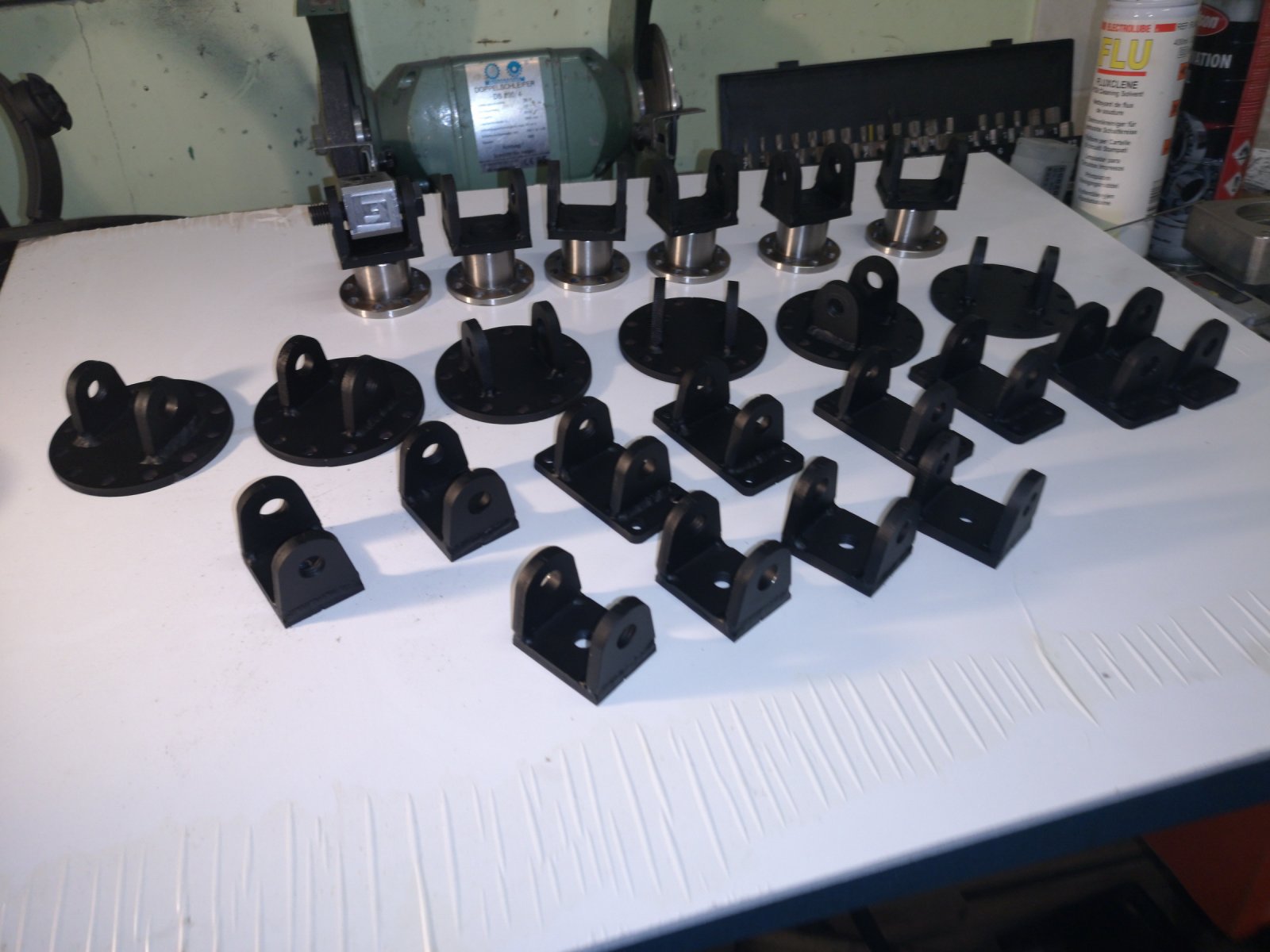

    Thanks for the answer. Do not break !!! Everything is done with a large margin of safety. The following I want to make completely stainless steel.

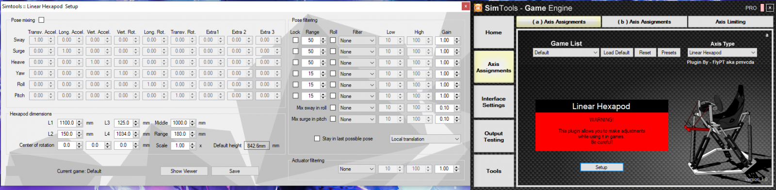

    Hello. Good start. So far with a stroke limit of 150mm. We need to work on the settings.

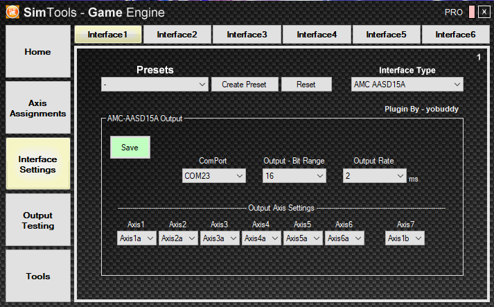

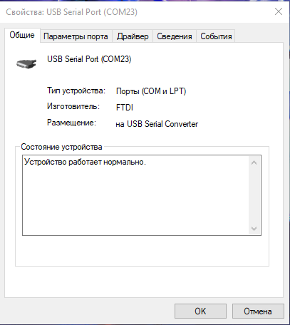

    Tell me please. Reinstalled Windows 10 Home, there was a problem. AASD15 does not communicate with the computer, while the COM port is active. The driver is installed correctly. The plugin is loaded into SimTools. In SimTools, the settings are correct. What is the problem? Help!
  8. Gadget999
    1,959
    11,983Coins
    +484 / 10 / -0
    try closing and reopening simtools
    does it work if you reboot computer ?

    Thanks. Rebooted, still does not work.

    Hello/ Previously, Windows 10LTSC was installed, everything worked. on 10Home stopped. SimTools reinstalled, did not help.

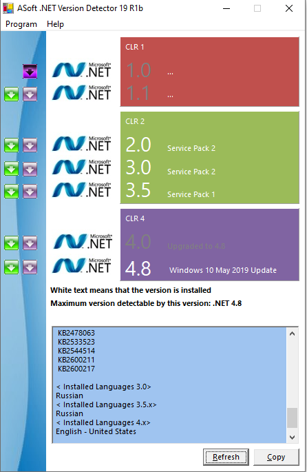

    Is .NET installed.
    Have you tried temporarily disabling any anti-virus and firewall, then do a clean install of SimTools.

    AMC-Thanos . Controller ok.

    Disabled Windows and Anti-Virus protection. Then reinstalled SimTools. Does not work.
