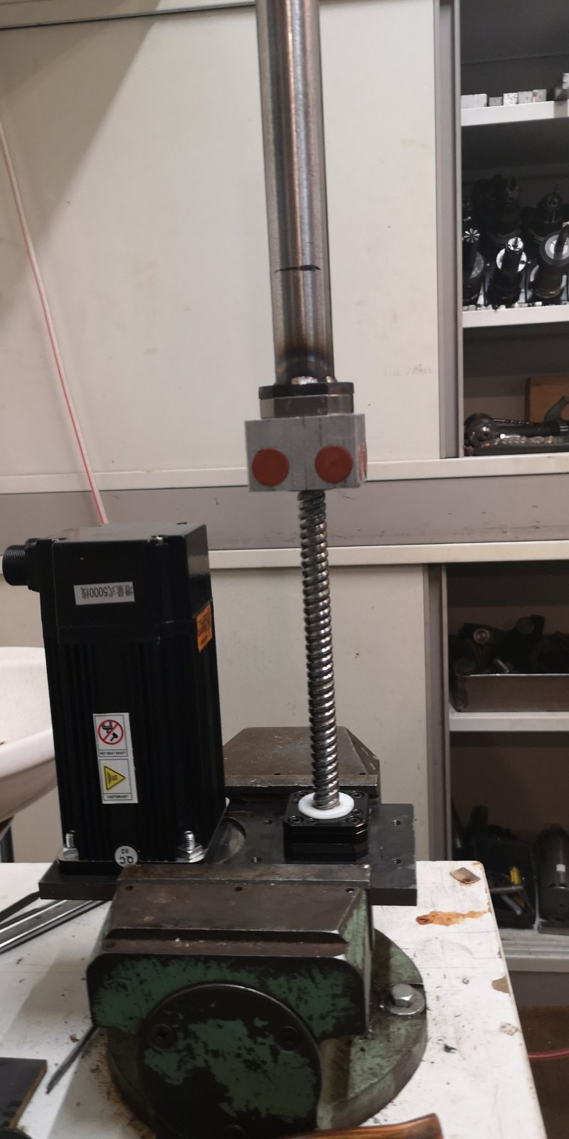

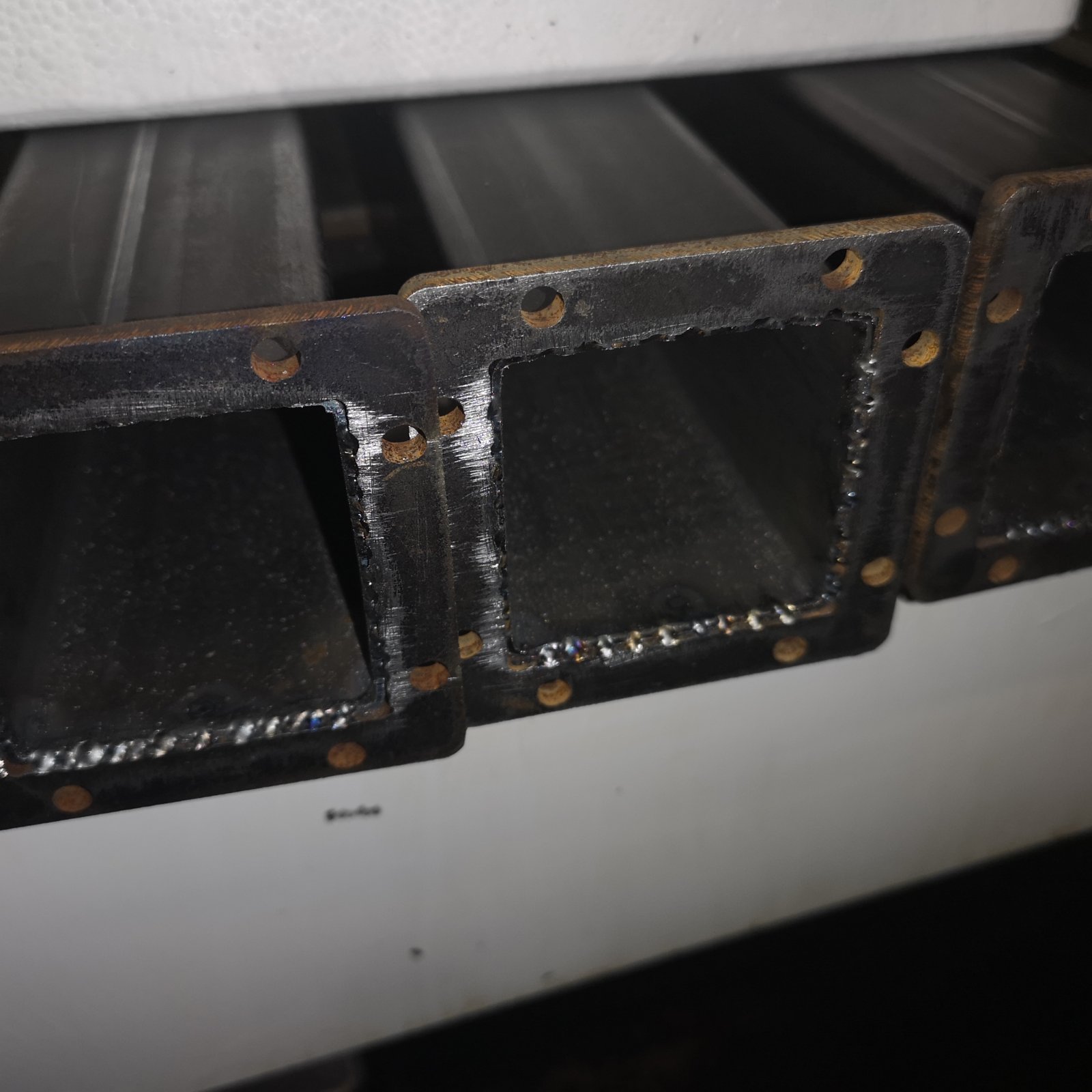

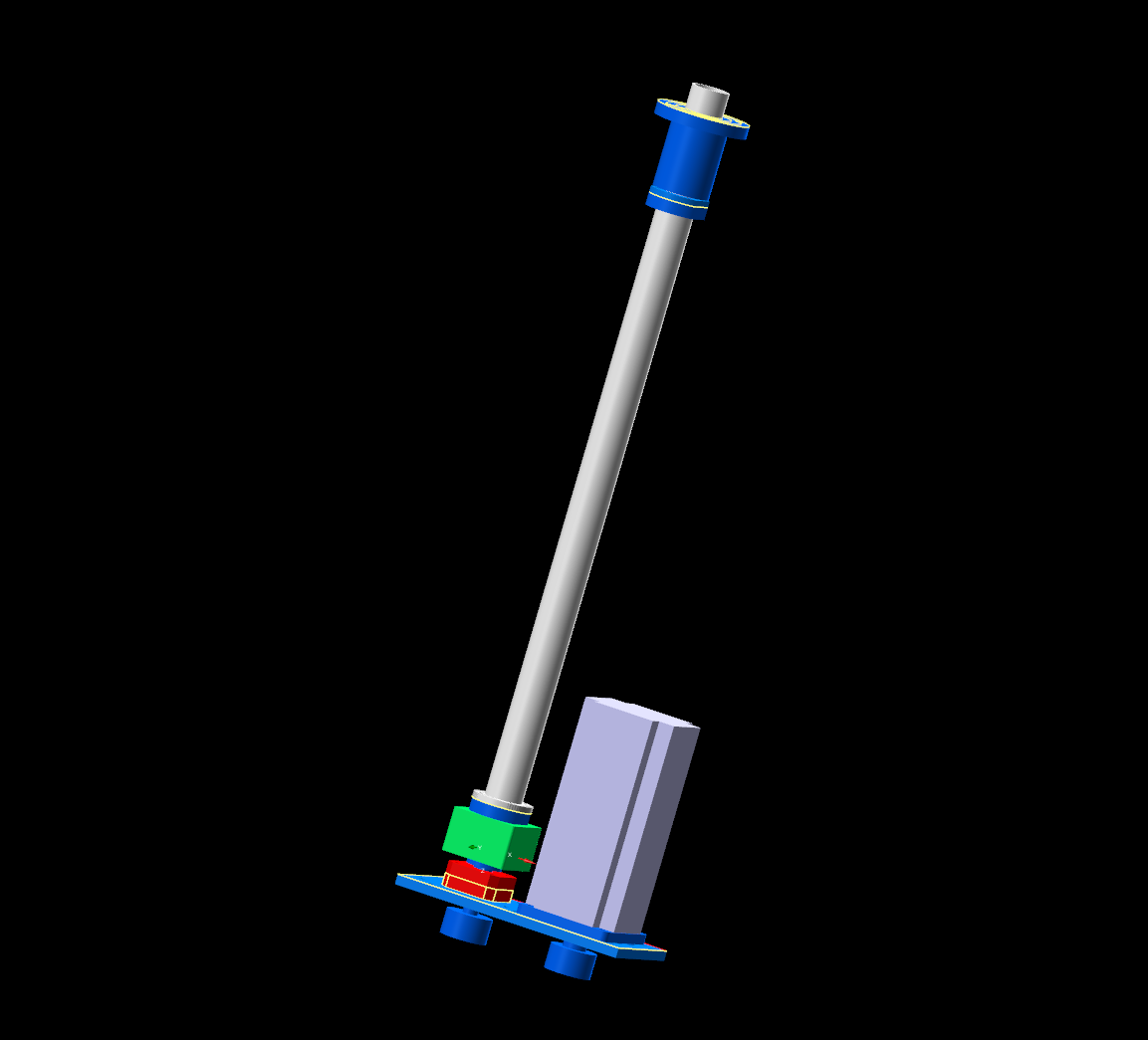

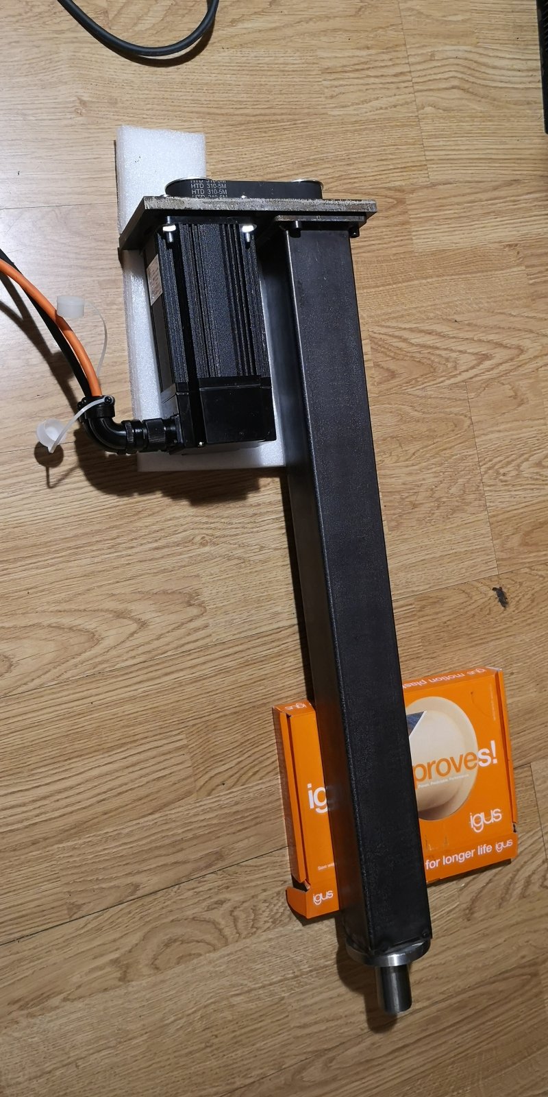

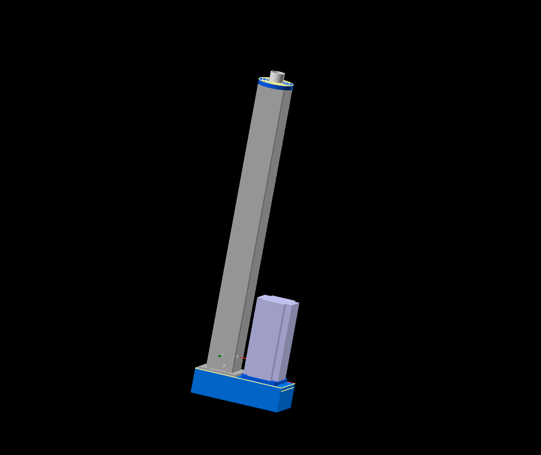

    Good day to all. I apologize for my English, I write through a translator. I decided to build a variable servo drive myself. 450mm stroke, 500mm / s speed. In China, good quality, very high cost, 1700 euros. I did a project and did something, see the photo. It is still in this form. Further there will be more photos and comments, followed by production.
    Безымянный.png Безымянный2.png IMG_20191027_124147.jpg IMG_20191013_144531.jpg

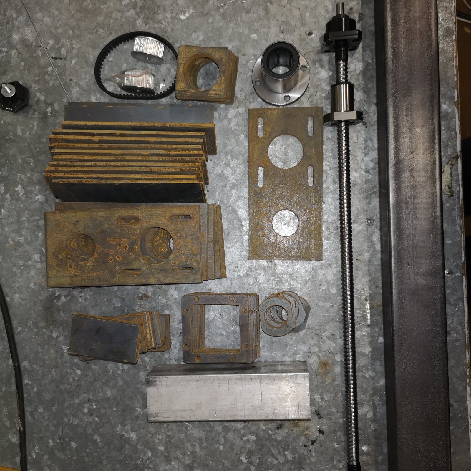

    Almost all the details are ready. Everything is done exactly, I made at home on CNC. Remained welding work. I think I’ll do it in a couple of days. IMG_20191116_130633.jpg

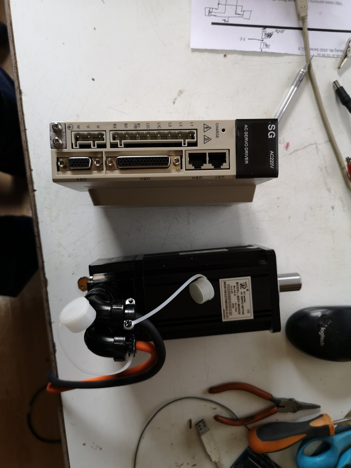

    Hello everyone. My project is nearing completion. There were various technical details. For control I decided to take the controller from "Tanos" AMC-AASD15A. Works great. IMG_20191224_194044.jpg IMG_20191225_201221.jpg

  9. SoftKitty
    SoftKitty Member
    Feb 8, 2019
    69
    Engine engineer
    Nantong, Jiangsu, China
    - 140Coins
    +61 / 1 / -0
    AC motor, 6DOF
    That's very smooth movement!
    One question:
    The green cubic part on the first picture, it slides against the inside wall of the tunnel, how did you manage to reduce the friction?( I see you put several red dot mats on its surface, what are they? they can help?)
    Thanks.

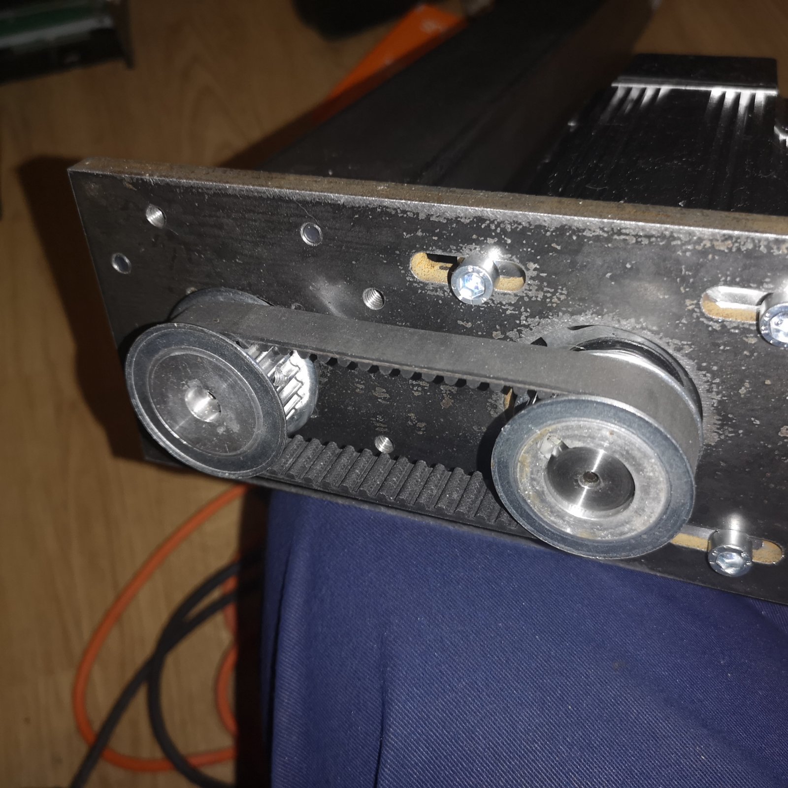

  10. dureiken
    dureiken Active Member
    Sep 28, 2016
    251
    1,248Coins
    +170 / 2 / -0
    Hi. Wonderful project.
    Could we have more informations ? Size ? Design ? How did you fix pulley to shafts ?
    What inner and outer diameters for your shaft ?
    Which bearing ?

  11. Ivan Zaharov
    Ivan Zaharov Member Gold Contributor
    Jul 6, 2019
    54
    Industrial repair CNC
    Latvija
    239Coins
    +55 / 0 / -0
    2DOF, AC motor, Arduino, Motion platform, 6DOF

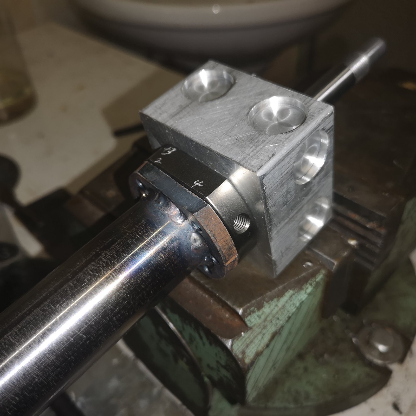

    Only round plastic inserts rub on the inner wall. They are made of special anti-friction plastic. The gap is 0.05-0.1mm between the plastic and the wall. Now there are new ideas, I will do it differently.

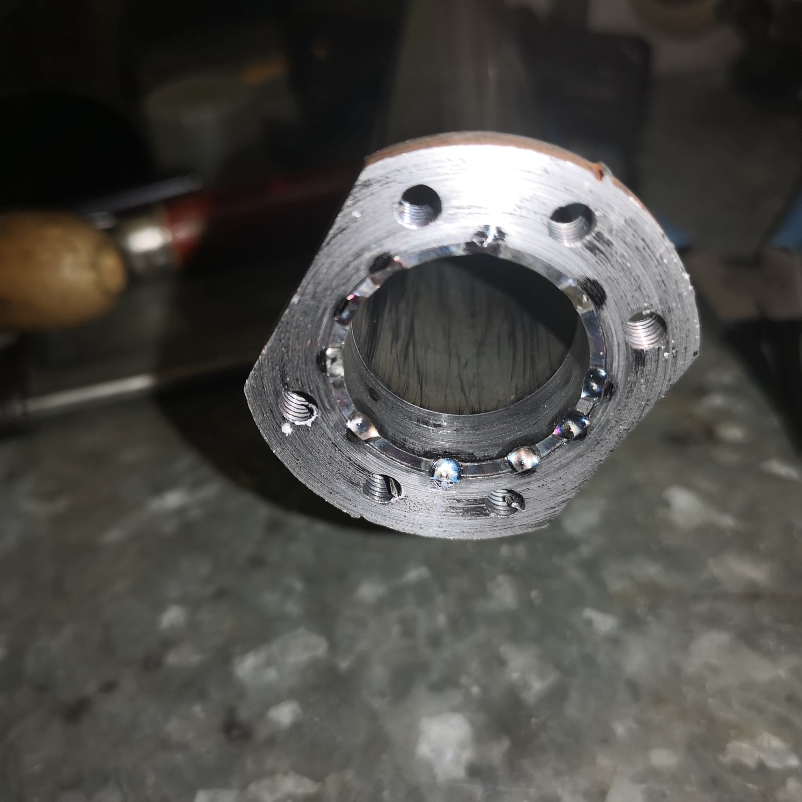

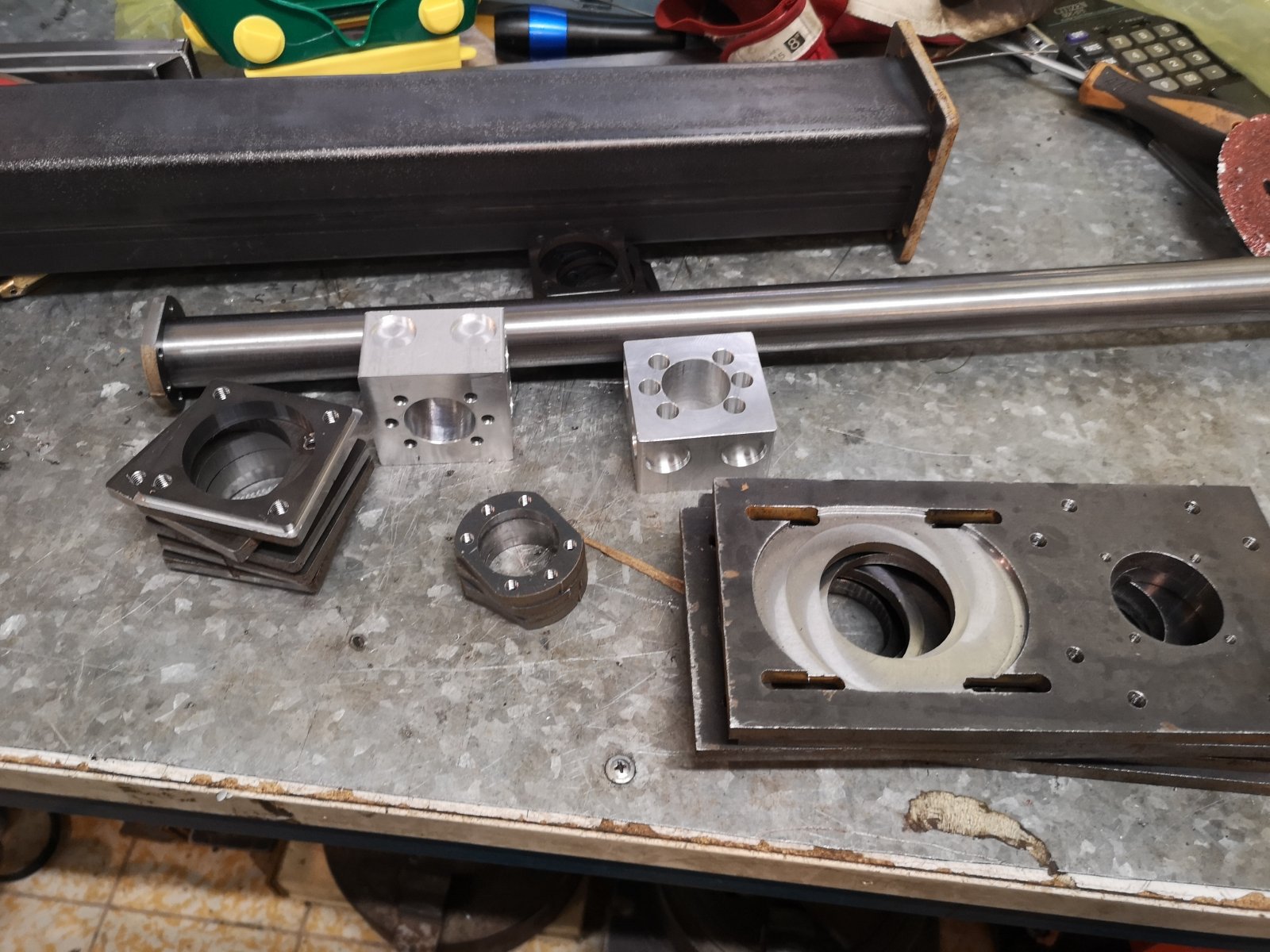

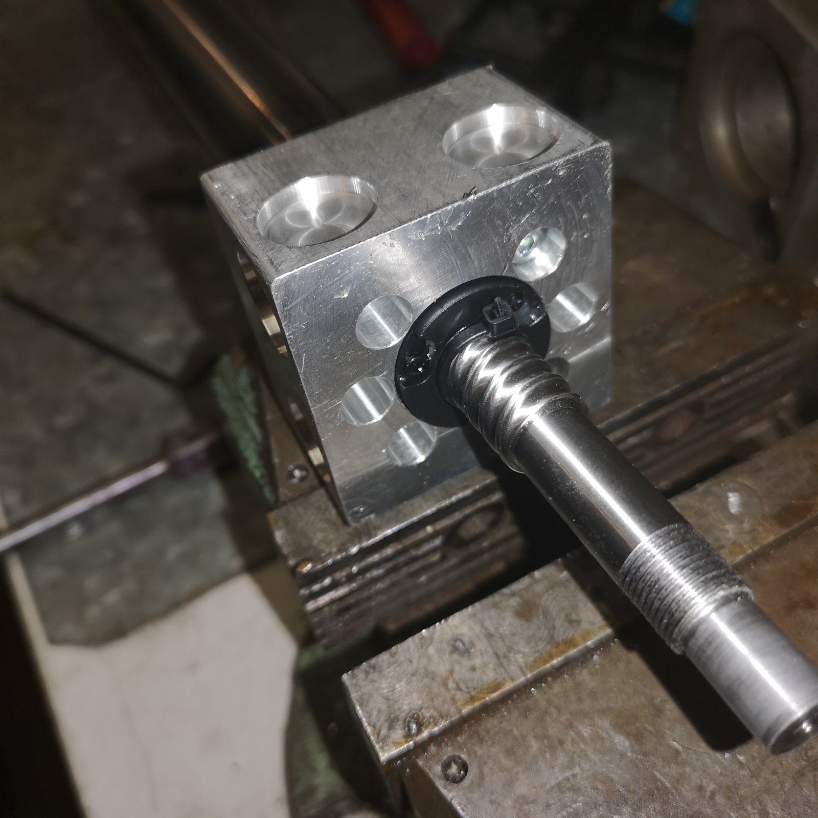

    IMG_20191230_212643.jpg IMG_20191230_212828.jpg IMG_20191230_212835.jpg IMG_20191230_212905.jpg
  13. Ivan Zaharov
    Jul 6, 2019
    54
    Latvija
    239Coins
    +55 / 0 / -0
    Case 60x60x2mm steel. Pipe steel chrome-molybdenum, diameter 30mm, wall 2mm. Actual stroke of 480mm. The total length of the entire structure is 700mm. SFS1610 ball screw pair. Linear bearing on the pipe LMK30UU (but decided to make a plastic bearing, larger contact area). Speed max. 500mm / sec .Pulley to shaft, tight fit with interference plus screws. I apologize for my English through a translator, I myself only in Russian

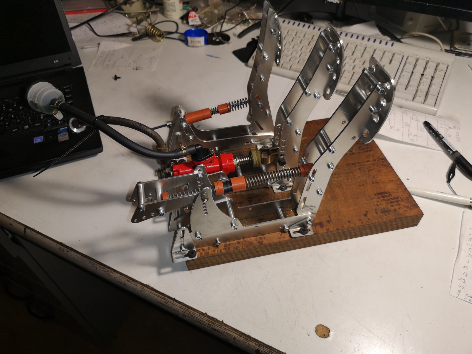

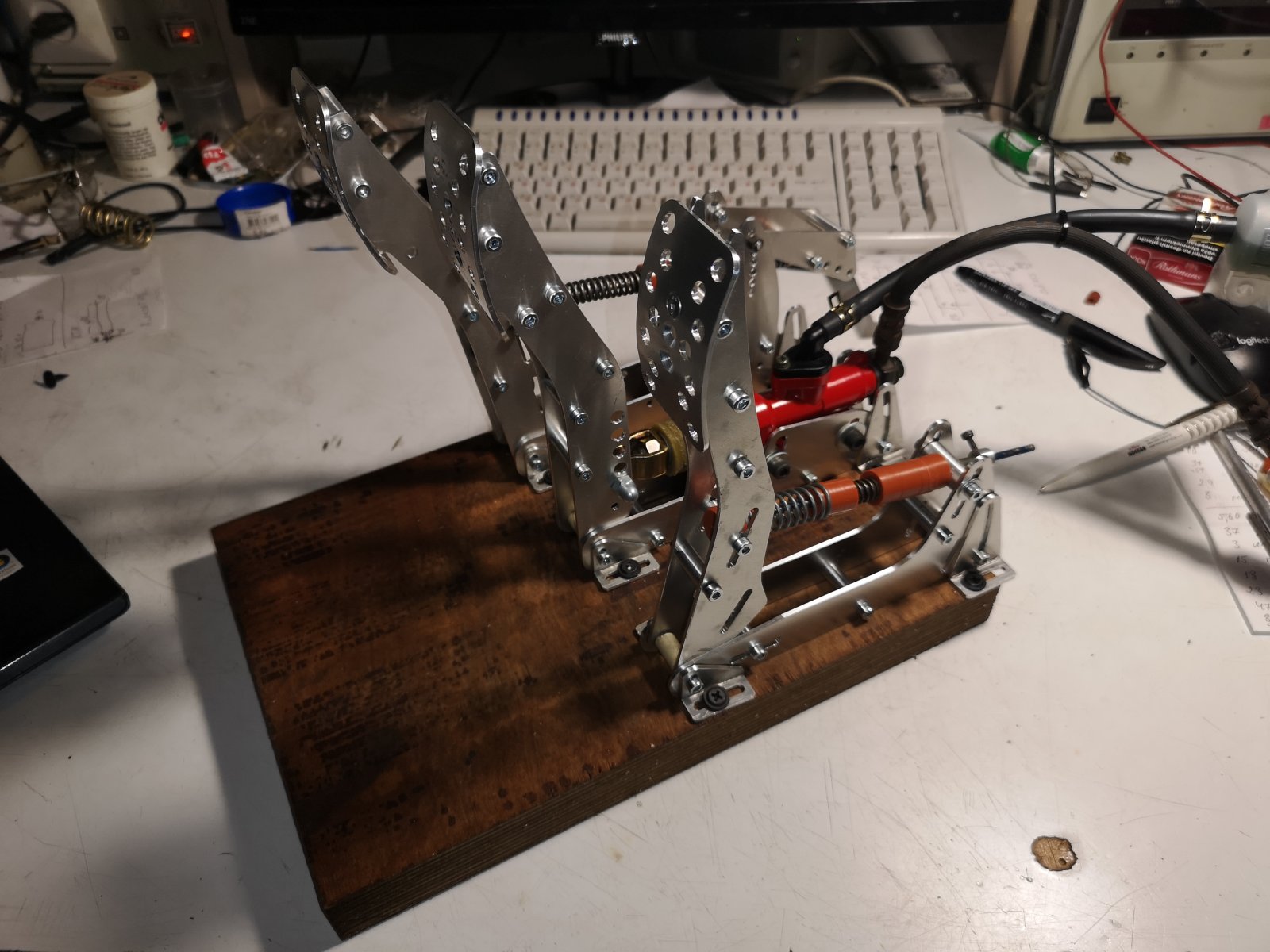

    Already almost completed the manufacture of pedals on the simulator.

  15. ferslash
    ferslash Active Member
    Feb 8, 2011
    495
    4,798Coins
    +181 / 2 / -0
    you build them (the pedals) from scratch ??
    fer
  16. Ivan Zaharov
    Jul 6, 2019
    54
    Latvija
    239Coins
    +55 / 0 / -0
    Hi. Yes, from scratch. He designed the pedals himself and made them.

  18. SoftKitty
    SoftKitty Member
    Feb 8, 2019
    69
    Engine engineer
    - 140Coins
    +61 / 1 / -0
    AC motor, 6DOF
    wow, that's beautifully made!
    I see there is a master cylinder behind the brake padel,
    Are you using pressure sensor to measure brake force?
    any details on the other end of the brake fluid line?
  19. SoftKitty
    SoftKitty Member
    Feb 8, 2019
    69
    Engine engineer
    - 140Coins
    +61 / 1 / -0
    AC motor, 6DOF

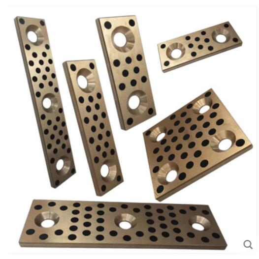

    That's great clearance accuracy, looking forward to seeing your new idea.
    By the way I'm trying this kind of graphite inserted plate.
    it's normally used on mould.
  20. Ivan Zaharov
    Jul 6, 2019
    54
    Latvija
    239Coins
    +55 / 0 / -0
    It only works on burnished hard steel or cast iron. Mostly friction on ground cast iron.
