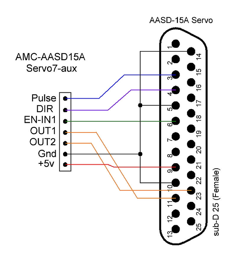

    Hi Ivan,
    Yes, according to the manual, it looks its going to be compatible. I can see in the new manual you linked the torque settings. Actually many of the parameters are similar with the ones in the AASD-15A servos, just a little different numbering.
    I'll try to find time to make wiring schematic and list of parameters sometime soon. unless you are willing to get your hands on the AASD-15A manual, and find the same parameters for the SG-AS... (kinda busy with some firmware upgrades right now).

    I will read the manual, I’ll figure it out. There are no problems connecting. All you need is a pinout for ARDUINO and Shematic diagam AASD-15A.

    The manuals are here:
    https://github.com/tronicgr/AMC-AASD15A-Firmware/tree/master/Manual-and-Datasheets
    And you can compare against the Dorna servos Pinout that shows some more info for the functions of the pins on the DB25:
    https://github.com/tronicgr/AMC-AASD15A-Firmware/tree/master/DornaM1_interface
    But I think you also need this perhaps:

    Hi Tanos. With the connection, everything is clear. When can you send me a controller ?. I need to test my actuators in the near future.

    Ha Tanos. I have two questions for you. When using your device, do I need to set (Switch limit on actuators)? What angles of actuators do you recommend making a 6dof platform.? Actuator stroke I have 480mm.

    You can use as much angles the universal link you have on the actuators allow.
    There is discussion on Dircord for the dimensions and building 6DOF platforms, join here: https://discord.gg/bx4PxYR
    See here an example of what others build:

    Hi Thanos. Everything works, thank you. Now I will assemble the 6DOF platform.
