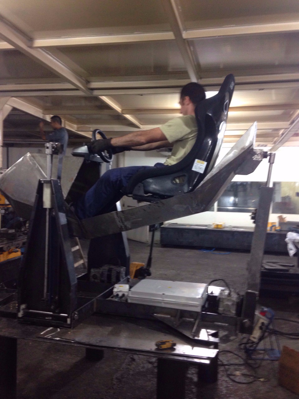

    4DOF
    Hello
    I finished my simulator 4 dof simulador. I installed an Arduino UNO and need help with SIMTOOL setting.
    Also I am looking for a Van or a Car software Simulator where I where it might be possible to add images or modify the appearance of cars advertisings.
    Greetings!

    Hi @Joel Pospisil ...
    Wow Nice design you have ... :thumbs
    first this post is about your simulator and it should be in the
    DIY Motion Simulator Building Q&A / FAQ section ...
    And for better assisting you please answer these questions ...
    How the AC motors are connected to the Arduino ?
    What is the software F/W loaded to the Arduino ?
    For more information about SimTools settings and Games please read the FAQ section .

    Hi @Joel Pospisil!
    what a beast you have built!! :eek:
    we want more pics!!! and specs!
    about Simtools please read the quick start step by step guide (link in my signature): this should help

    We are using a H Bridge by our design. It is working fine.
    The AC motors consume max 20 Amp.

    Great @Joel Pospisil ...
    20A is a good round figure for 4 motors total consumption ...
    But, What H-bridge for AC ? Aren't you using VFD's ?

    The SimTools Axis Assignment settings are completely configurable, in other words you can assign any axis/force to individual actuators, and SimTools can even have and mix on the fly multiple assignments of forces/axis to each individual actuator.

    This is unsymmetrical, unlike the Stewart platforms though.
    Say, if I have fly yaw movement only input given at a moment of time, how can the rig do yaw only without pitching?
    SimTool needs to calculate exactly how much rear actuators movement vs front actuators’ movement so that it will do the yaw and keep to level. I don’t think the native SimTool SW will work.
    Had some one already made a plug-in for 4x 4DOF case?

    As I said SimTools can mix axis assignments on the fly, so it will automatically calculate the yaw input from the game and just execute that, but in circumstances of both yaw and pitch inputs it will mix movement for both at the same time, when multiple axis/forces are assigned to actuators.
    Have a play with the most basic example on the 2dof Virtual Simulator: https://www.xsimulator.net/community/faq/testing-simtools-without-a-simulator.171/
    And use surge, sway, heave, roll and pitch, follow the tips to refine a motion profile: https://www.xsimulator.net/community/faq/steps-to-create-a-motion-profile.228/

    I and many others use to run simtools with 6DOF stewart platform rigs without any special math plug-ins for quite some time. You just need to build your rig to suit - Ie. equal length actuators, lower the roll center etc. You can make any shaped rig work with a bit of thought.

    I understand that works for Stewart 6DoF or toplogic-Stewart n drivers for nDoF cases.
    After thought over again, but for this 4 drivers 4DoF case, I could not figure out how is mathematically possible.
    If I fly my plane with yaw in 10 degrees, how could such configuration lead to yaw 10 degree without heaving or pitching?
    I think I am going to give up this idea. Thanks anyhow.

    Looks like its a 3dof + 1 for yaw or TL to me (top photo). The 4th motor would rotate the other three actuators.

    From the design in the example video - not all DOF movements would be physically possible. But it was a compromise that they were happy to go with for the type of vehicles that they were going to simulate.
