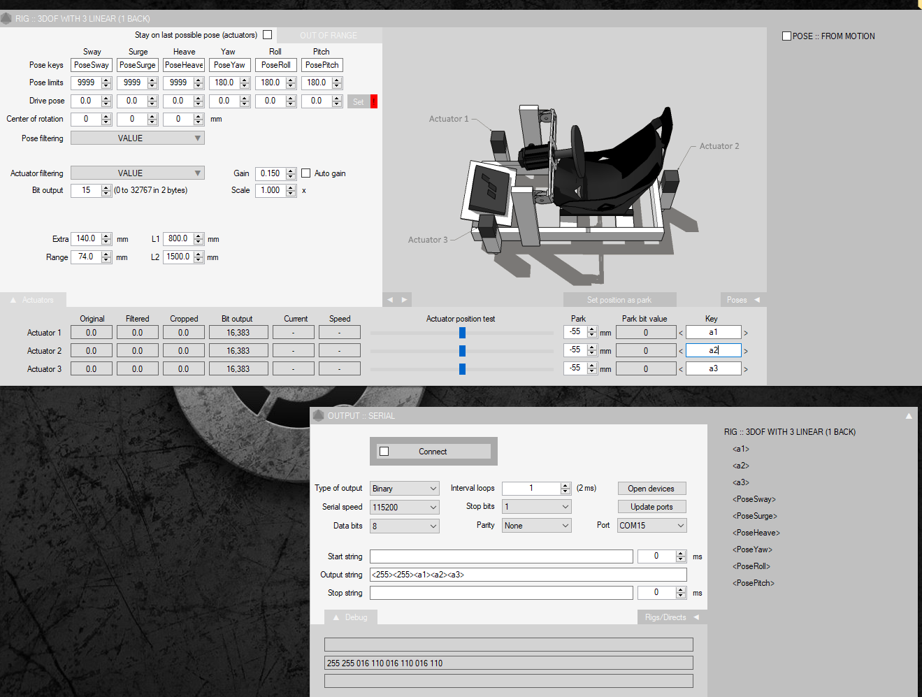

    Ok so i redid the wiring. In the SFX software everything is running as it should. Everything is identical.
    On the Mega motor 2 still fails and ive tested different wires and checked that its not the servo controller itself. It doesnt just run randomly anymore but Ive also put the pins from motor 2 to 4 and i have the same issue.
    Connected Leo and checked again, no issues. Reconnected Mega. Only motor 1 works right. restarted and it just runs the motors randomly until i reset. If i restart my comp again it does the same om first Mover connect. Cant really imagine it being anything but the Mega at this point.
    Here's my settings.

    Ok I see the problem now: You're using only 3 actuator values in the serial output string, you need 4 values here. You don't have to use the 4th output, but you need to put a value there because the code expects always 4 values. You can put a constant zero like this: "<255><255><a1><a2><a3><0><0>" (you need 2 zeros because its 2 bytes)

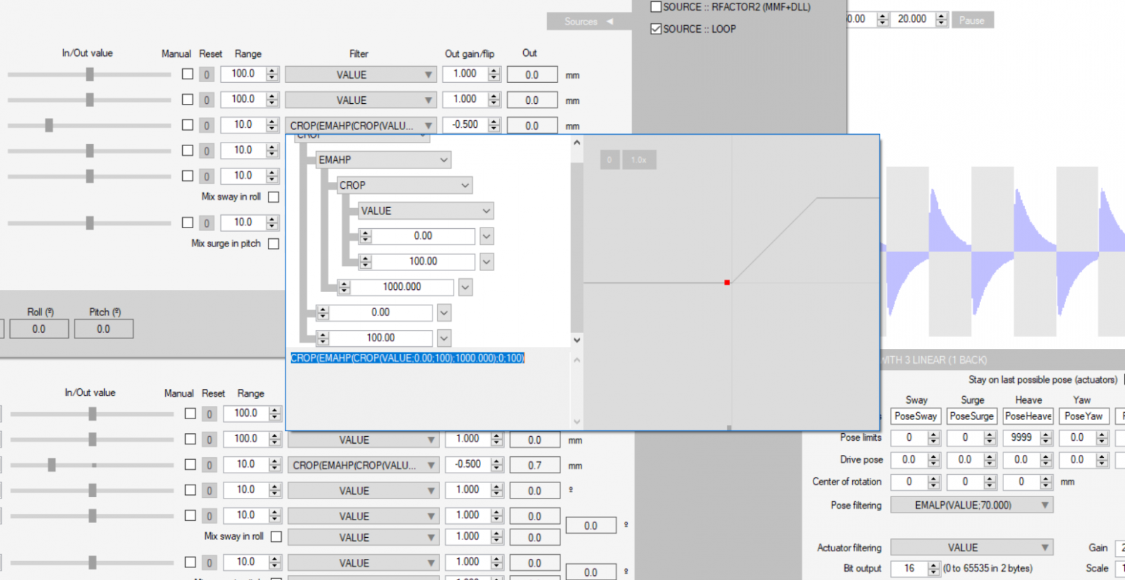

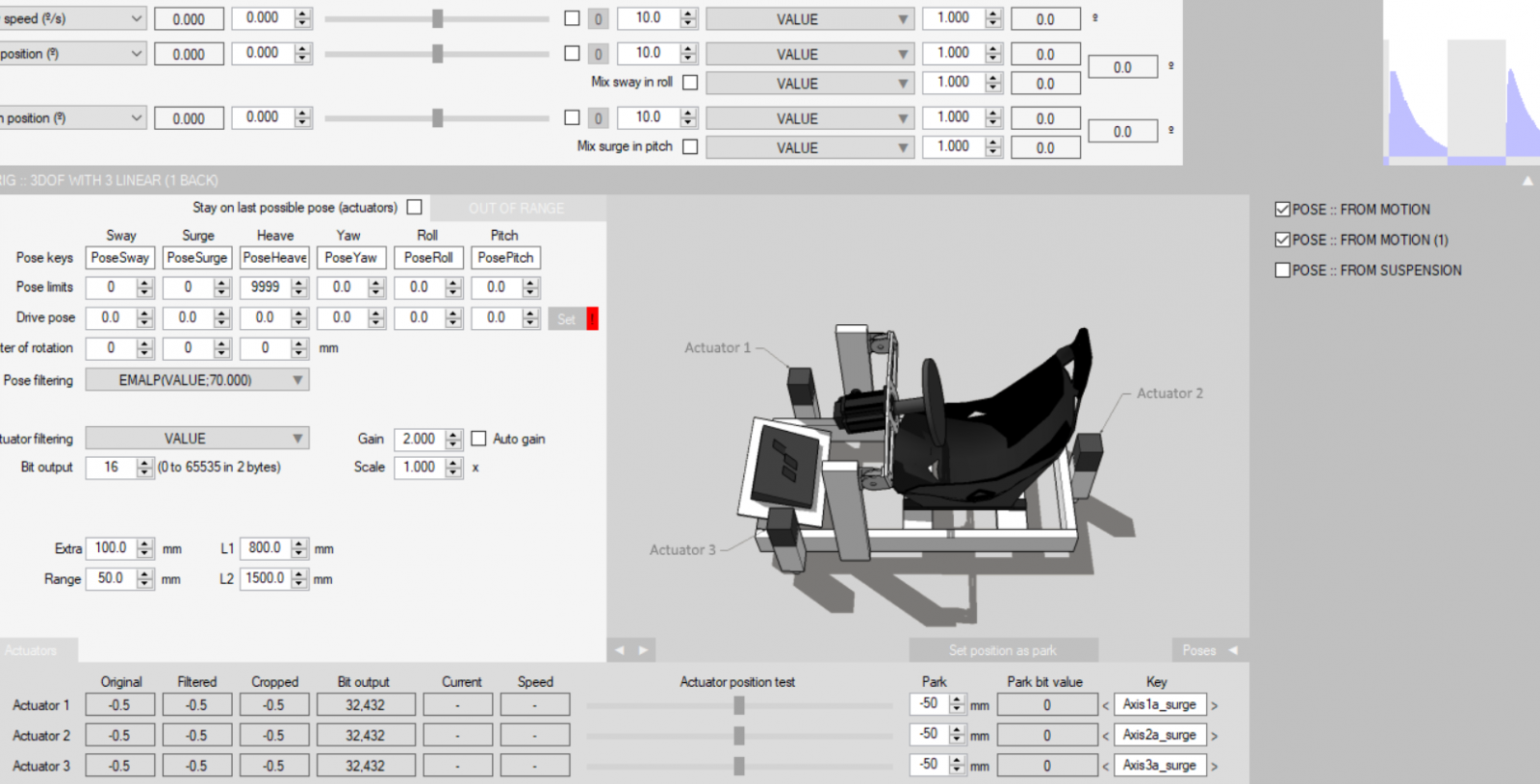

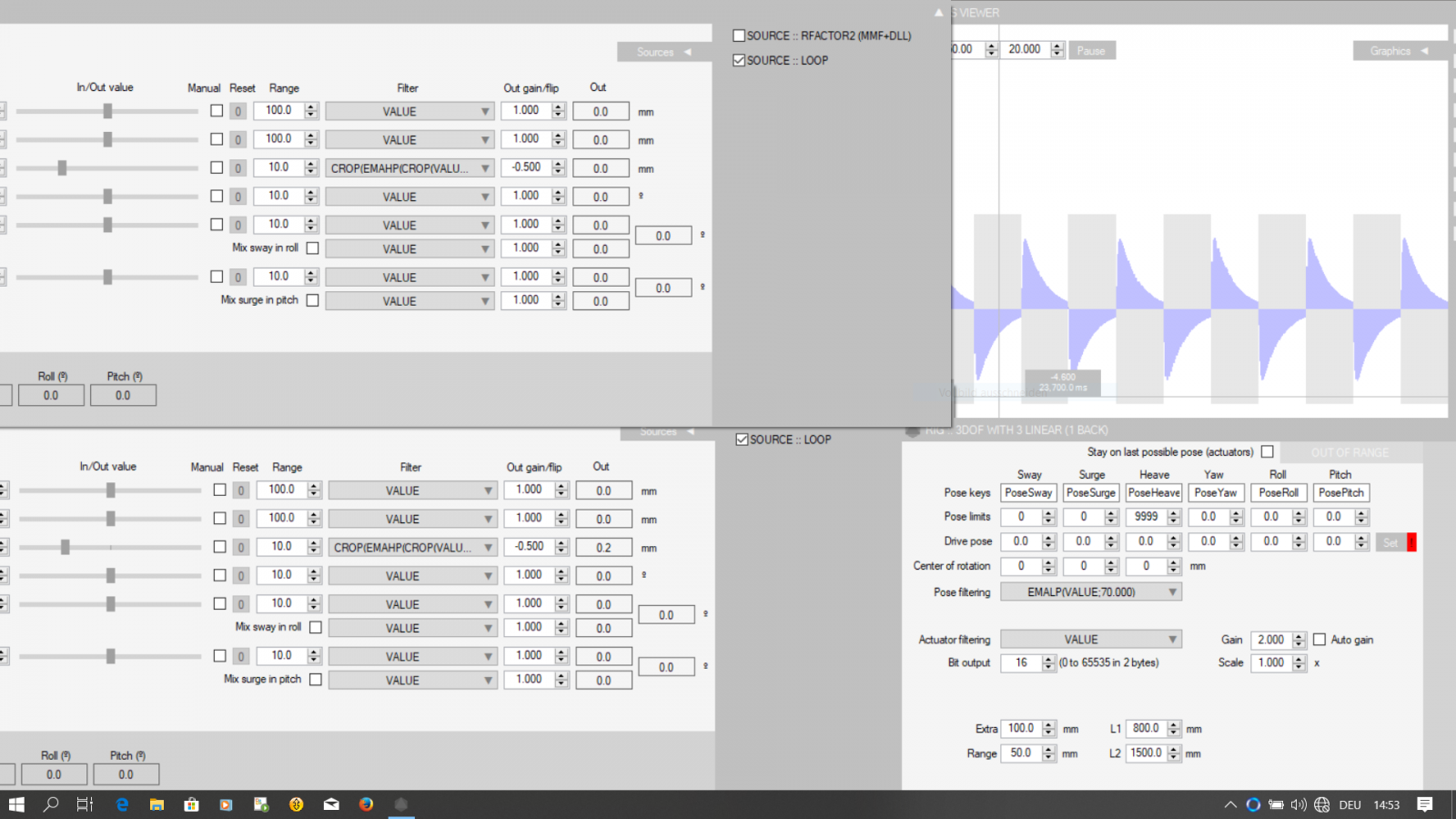

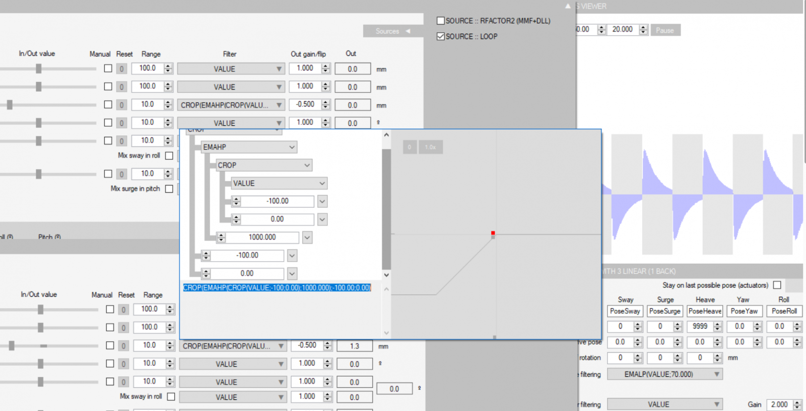

    I have tested your program it works fine.
    In combination with FLYPT (thanks for that great software), creating two independent mover for each direction forward,backward with filtering (crop/HP/crop/LP) and combine it in the Rig.
    Thus I could get proper solution suppressing the second jerk, if mapping longitudinal acceleration to position. (surge movement) flypt1.PNG 77784 77785
