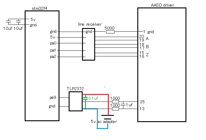

  13. sedesa tatasa
    sedesa tatasa Member
    Jun 16, 2018
    62
    509Coins
    +15 / 0 / -0
    Noise from the servo driver destroys stm32.
    You can protect it with this.
  14. JonBakhol
    JonBakhol Active Member
    Mar 16, 2018
    107
    Netherlands harderwijk
    443Coins
    +46 / 1 / -0
    @sedesa tatasa Thanks for coming back to me.
    Do you have a kind of version/type/model of line receiver I should use?
    TIA
    Bakhol

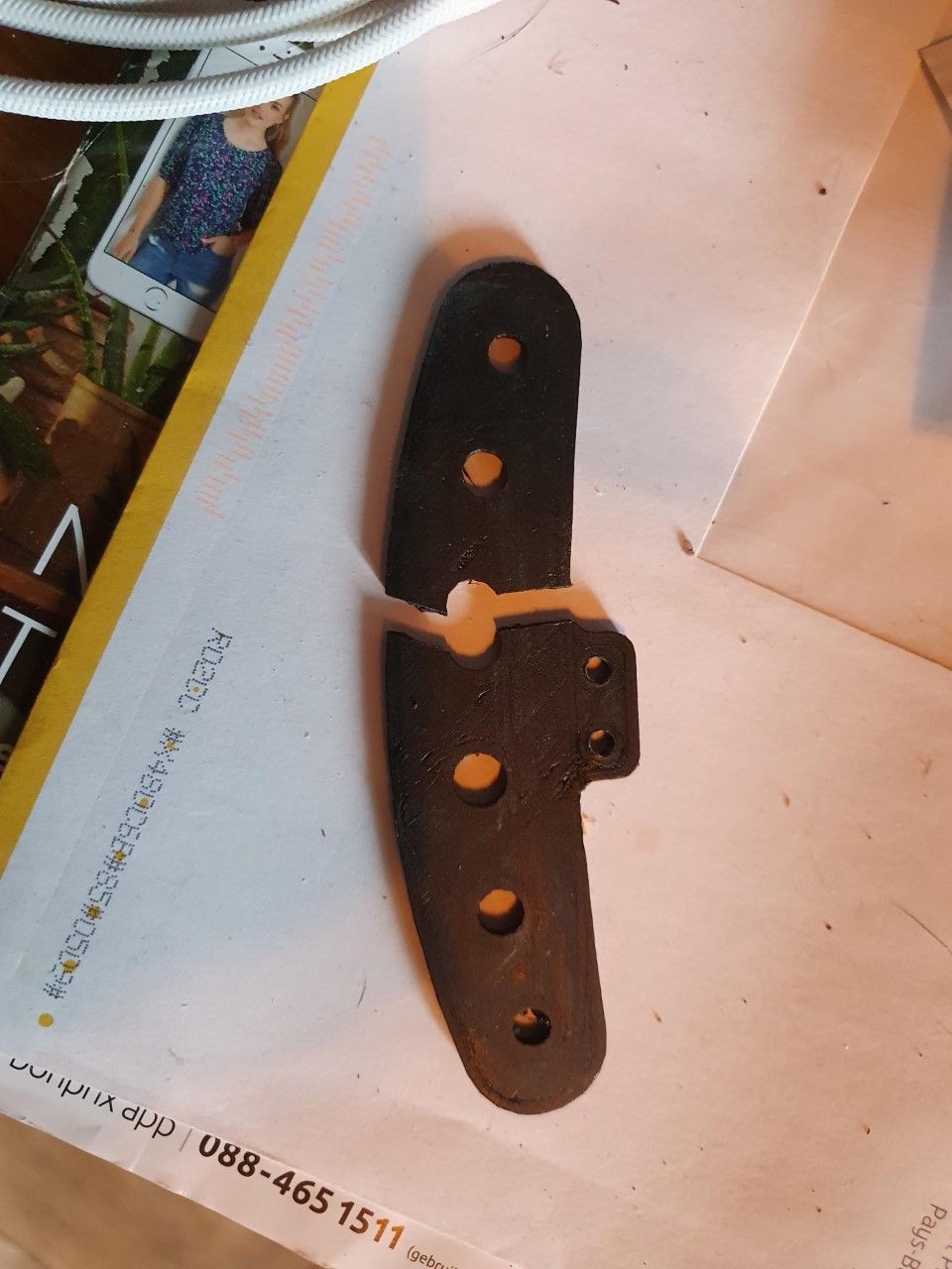

    @Milt
    Sorry to bother you also on this channel :)
    I followed all the steps you mentioned, and all is working fine.
    At least better than the first time I tried (broken flipper instead of finger :)) Broken flipper.jpg

  19. ggurov
    ggurov New Member Gold Contributor
    Dec 10, 2020
    48Coins
    so this is the next thing i'm trying (SN75ALS199N instead, so i could get it sooner, still quad differential line receiver though).
    should there be optical isolation on line receiver output ? or is that sufficiently protected that it won't be necessary ?
    Can i put 4n25 on the direction line control ?
    for voltage, i'm planning on using http://www.icstation.com/voltage-co...wer-module-digital-analog-signal-p-12498.html for PWM DAC , cause the chip mentioned above is ungodly expensive as a shield, and a pain to try to solder.
    i've got a 60st-M01930 with AASD-15A, running of 110V and a HiLetgo STM32F407VET6 () board. Things work okay if the motor isn't enabled, motor power connector unplugged or e-stop is pressed. mmos calibrates fine, sees the index, directions work fine.
    as soon as i enable the motor, USB starts glitching, and disconnecting/reconnecting very fast. when it sees the device, it gets the right wheel angle, but it's not smooth, and has dropouts where the data coming over USB pauses for half a second, and then recovers. this behavior goes away when the motor is disabled (e-stop), with the encoder still working fine and much smoother.
    it's not that particular STM32F board being weird, because the Discovery board disconnects hopelessly and disappears from usb list as soon as drive is enabled with the same setup. acts like it's supposed to with motor disabled.
    force feedback, bumpstops, wheelcheck work fine while it's connected, but with dropouts where i'm seeing data not coming in. also, eventually even the HiLetgo board disappears from the device list until i hit the reset button on the board.
    usb cable has 2 ferrite rings, plugged straight into the computer - no hub. both 2.0 and 3.0 usb show the same craziness. other devices on the same internal usb hub start to act up, so keyboard stop working when the dropouts happen. the cable from the drive to the board is shielded and fairly long, computer and drive are both on the same 110v phase.
    i tried both sides of the A/B/Z (+/-)
    is there just a whole bunch of isolation missing and these chinesium servo drivers are noisy as hell ?
