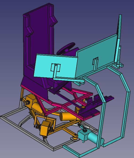

    Hello everyone.
    Let me describe my project:
    car simulator
    4DOF
    Mechanically welded frame
    4 motors 24v/700W/3000rpm + 60:1 reducer
    2 Sabertooth 2x60
    1 Arduino Uno
    3 screens
    Here is a picture of the study

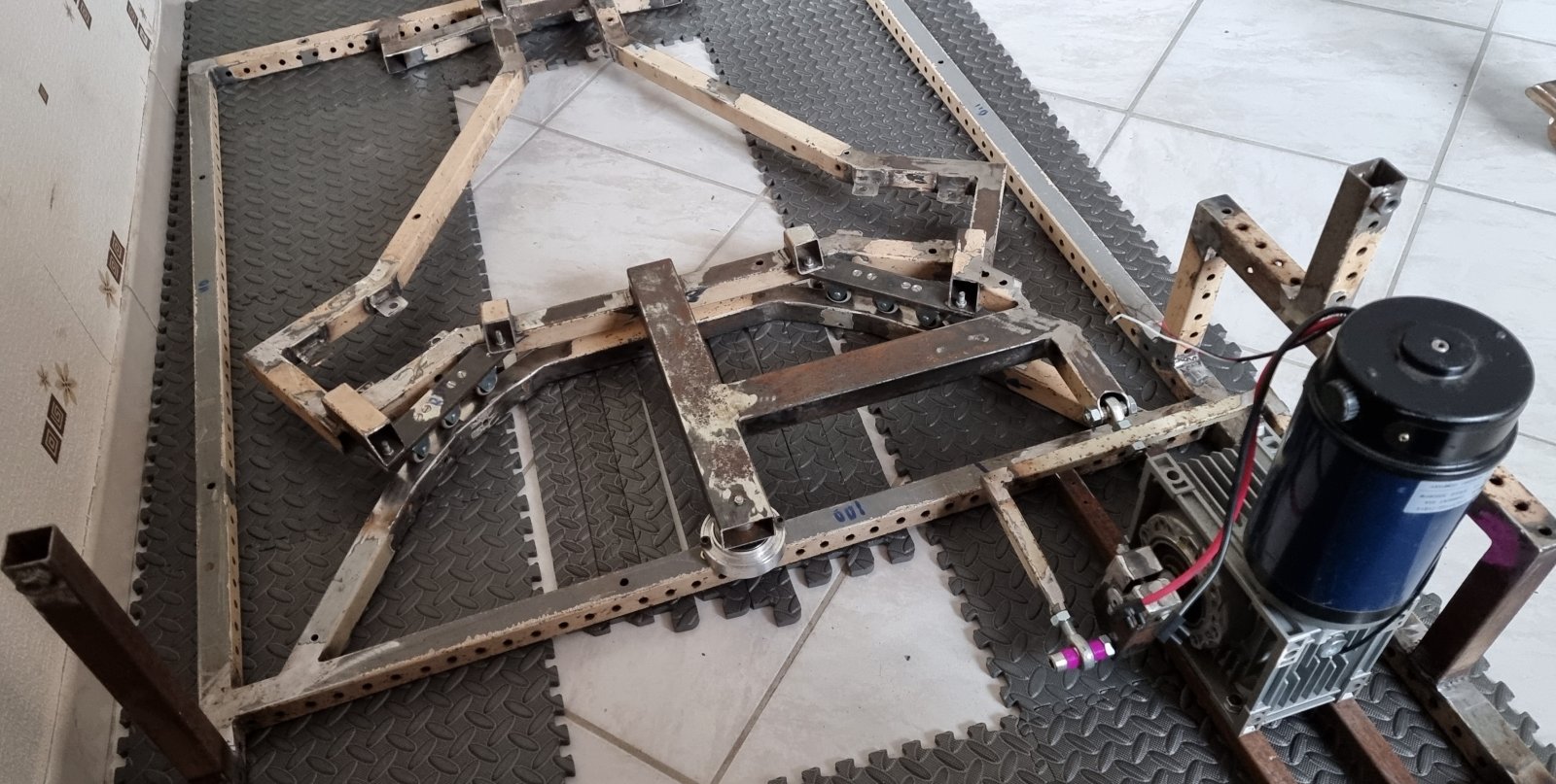

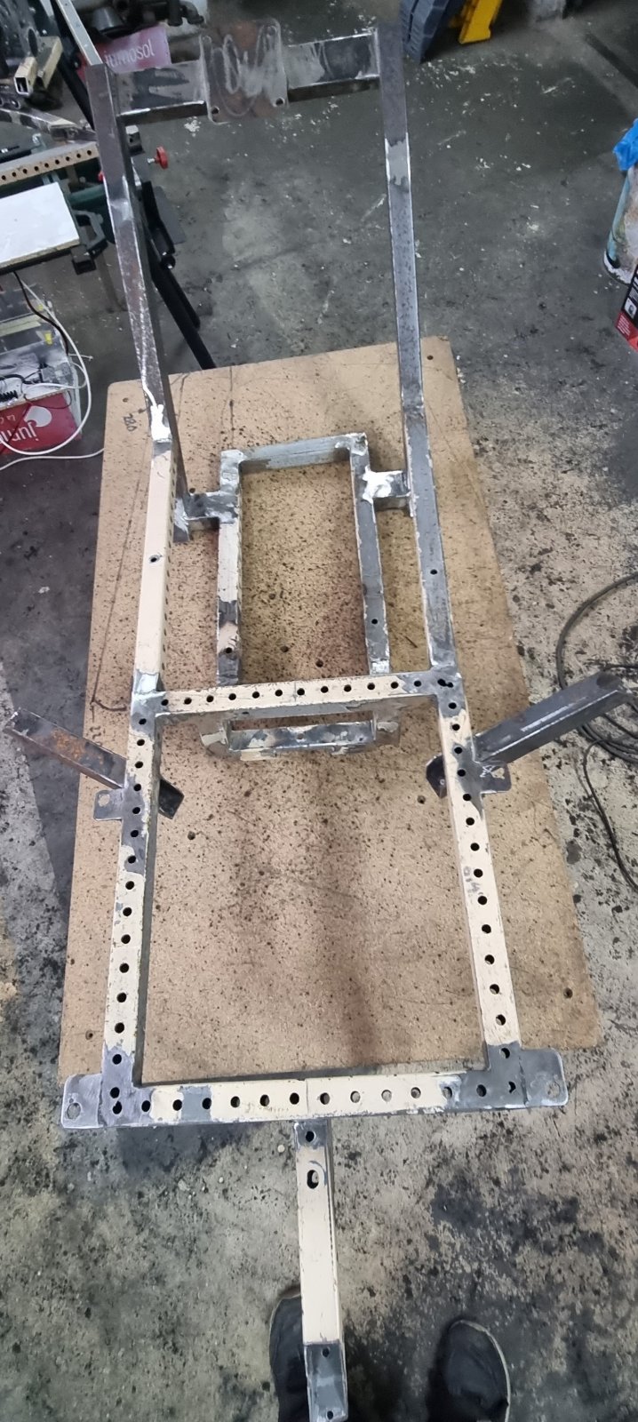

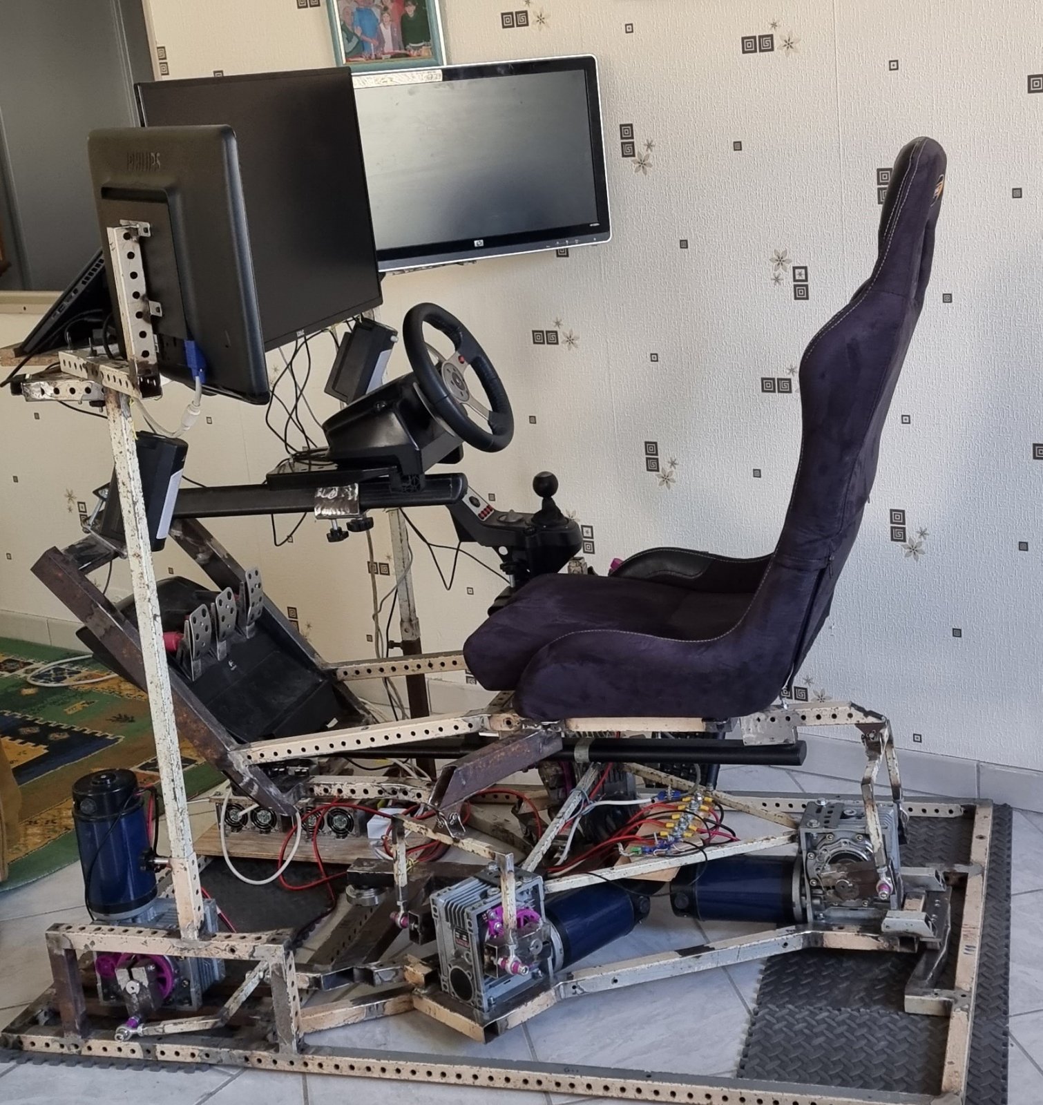

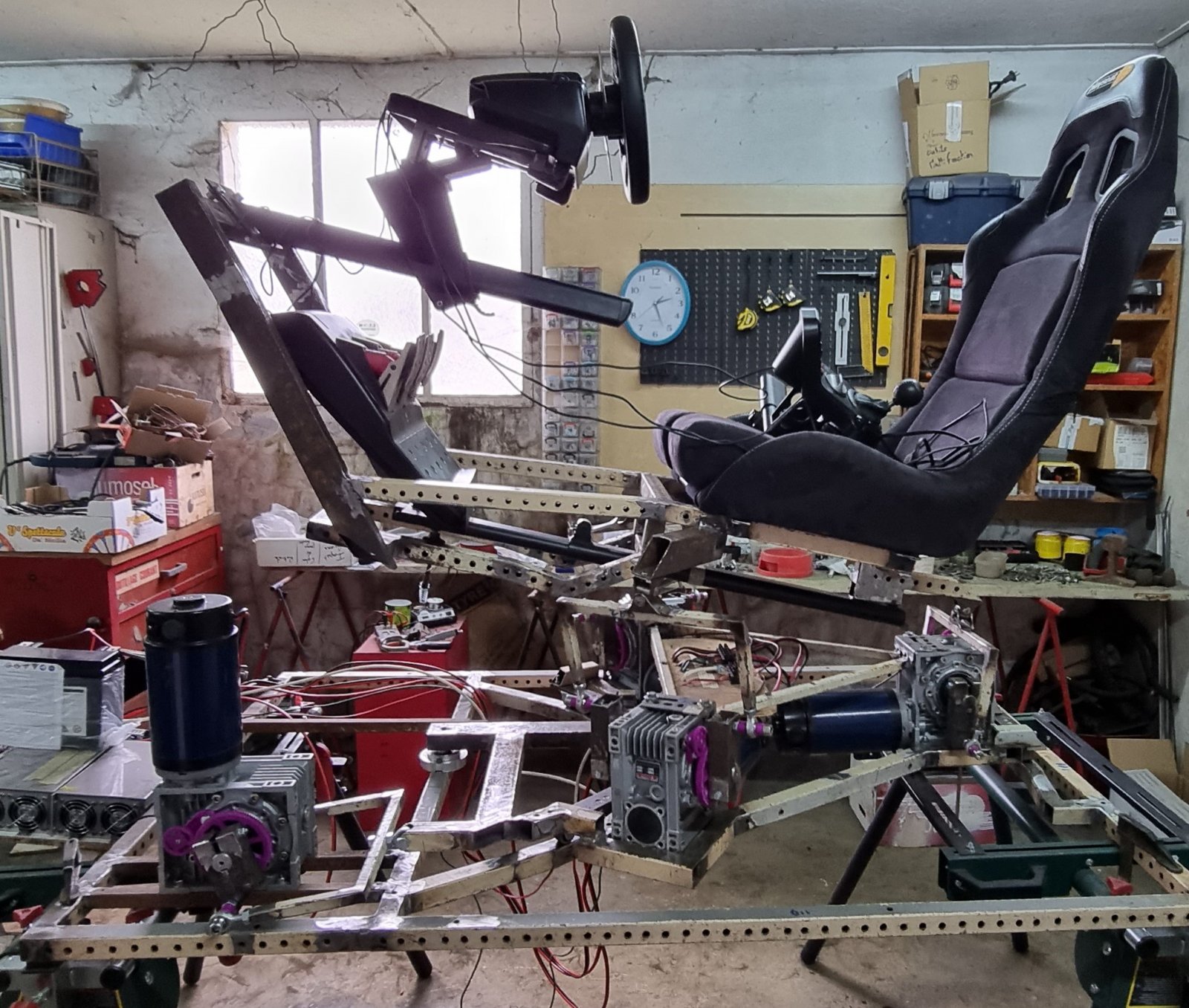

    Here are some photos of the build:
    The lower part (chassis placed on the ground + "YAW" chassis with its engine)
    Then the chassis supporting the seat player
    Finally the simulator without the screens
    And to finish with the screens
    For the moment I am satisfied with the functional and when I have solved the ergonomic problems, I will move on to the finishes.

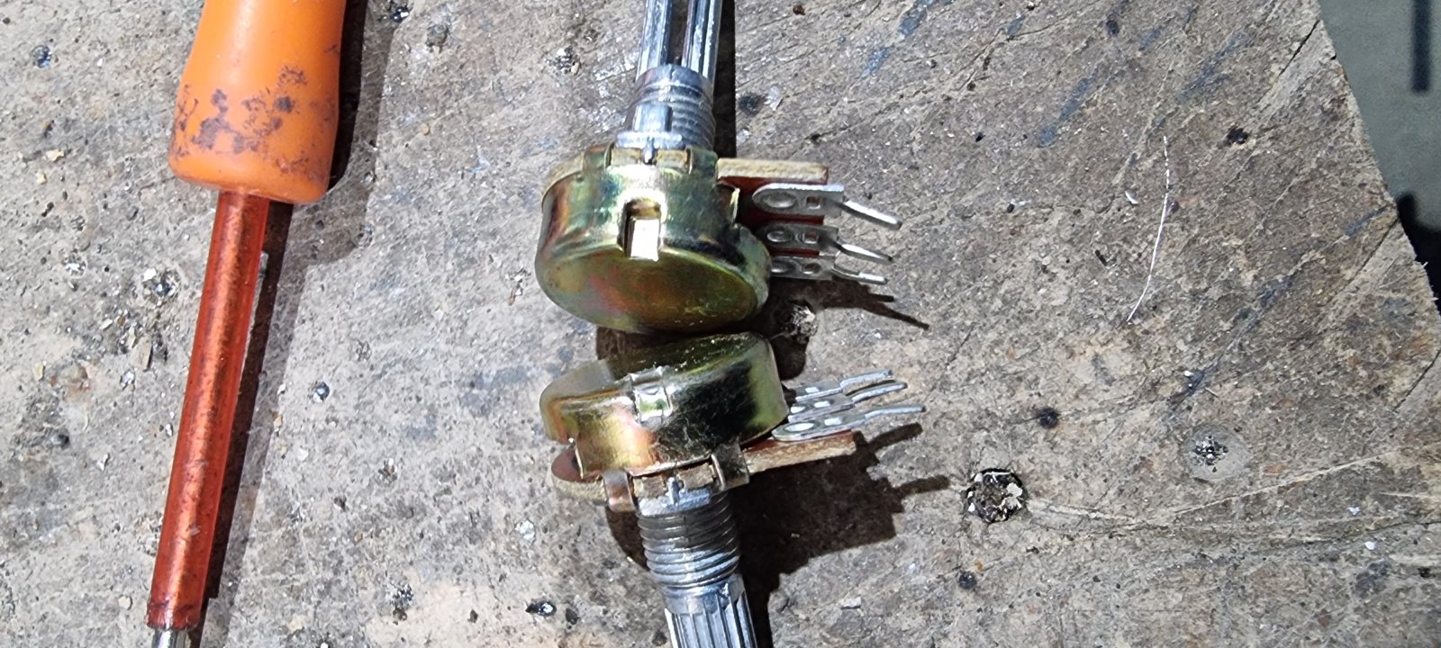

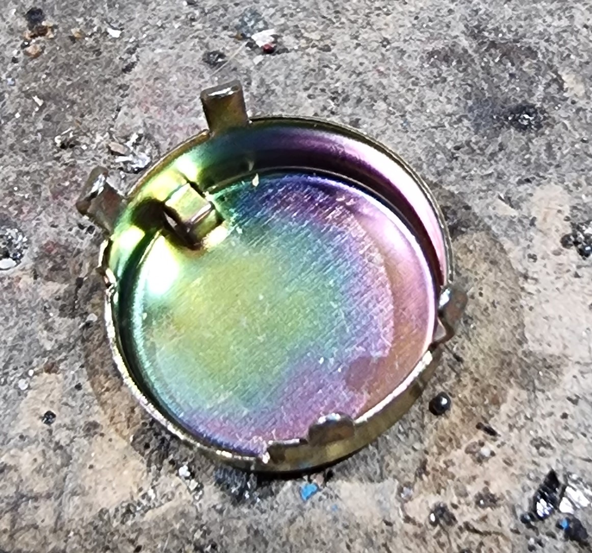

    4DOF
    I tinkered with potentiometers to make them operational over 320°
    I deserted the lid and hammered the stopper
    Then reassemble and reseat the lid
    Now the potentiometer can make full turns

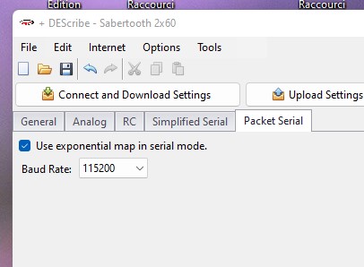

  9. CHAVERNOZ
    CHAVERNOZ New Member
    Nov 23, 2022
    16
    22Coins
    4DOF
    I used describe to make sure I was on 115200 bauds

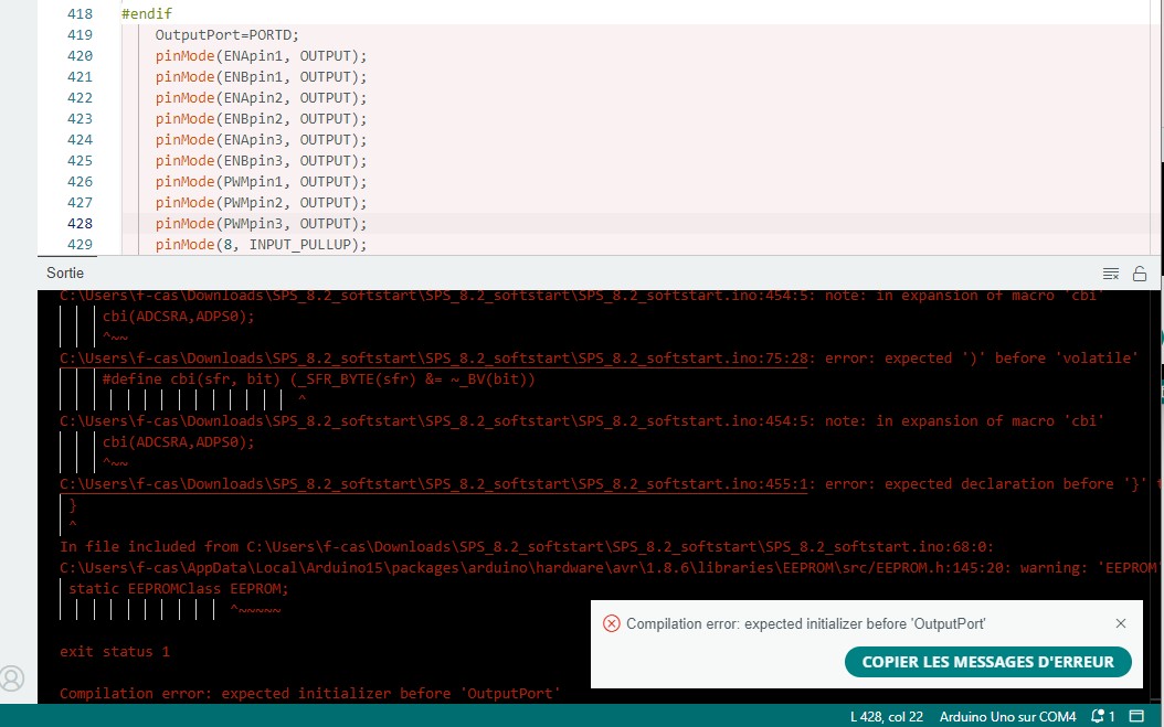

  12. CHAVERNOZ
    Nov 23, 2022
    16
    22Coins
    4DOF
    And I got an error message:
    Is my configuration wrong, or am I uploading the wrong files?
    I have a "chinese" arduino UNO R3, and Arduino IDE 2.0.4

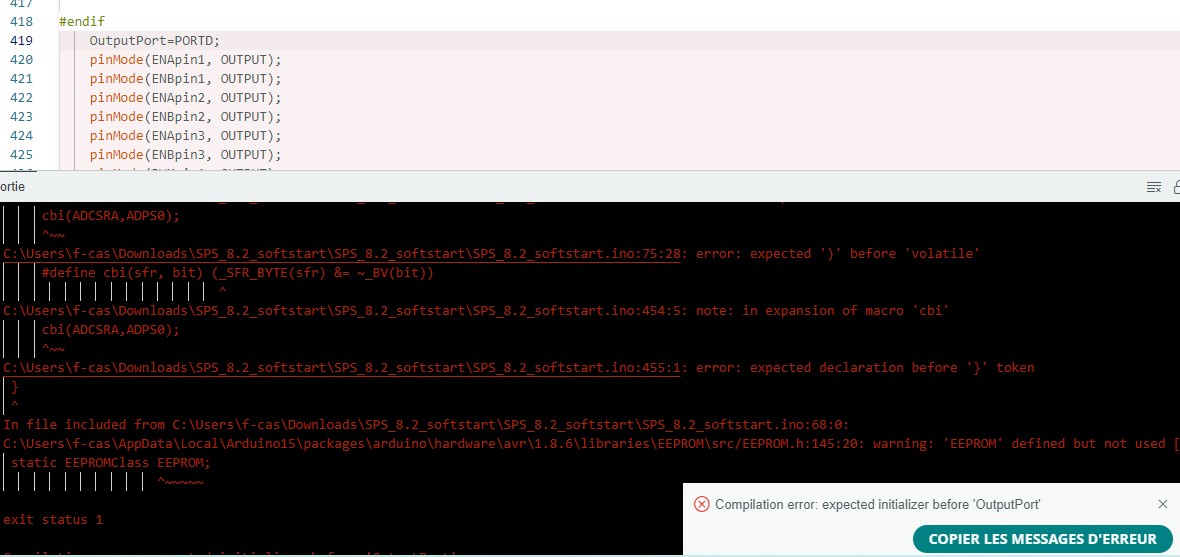

  13. CHAVERNOZ
    Nov 23, 2022
    16
    22Coins
    4DOF
    I tried to compile with Arduino IDE 1-18: same problem =
    Compilation error line 419 of sketch [SPS with softstart] => " OutputPort=PORTD; "
    error => " expected initializer before 'OutputPort' "
    Any ideas ?

  16. noorbeast
    20,668
    145,876Coins
    +10,805 / 52 / -2
    Mode 2 should not be necessary.
    With Sabertooth 2x60s the self-configuring baud rate will automatically change the baud rate of a new 2x60 from its 9600 default setting to 115200 baud, so there should be no need to use Describe.
    Is the Arduino IDE properly configured for the Arduino being use?
    My guess would be switch to a genuine Uno or Mega, not a clone.

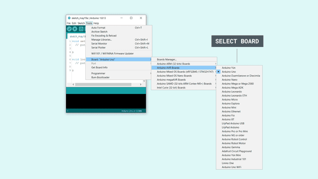

  18. noorbeast
    20,668
    145,876Coins
    +10,805 / 52 / -2
    You need to select the right core & board. This is done by navigating to Tools > Board > Arduino AVR Boards > Board. Make sure you select the board that you are using. If you cannot find your board, you can add it from Tools > Board > Boards Manager.

    I have instaled an original arduino uno R3, and configure arduino IDE.
    If i ask for card info, it give me BN, VID, PID, and SN.
    So i presume my config is good.
    When i want to transfert "SPS with sofstart " (or SPS 8.2 softstart), I get an arror message :
    " Compilation error: expected initializer before 'OutputPort' "
    in line 419, after #endif [​IMG] :(
