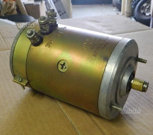

    Now a new question.
    24 VDC
    500 W
    rpm around 4500
    I haven't bought them yet. I will drive it with Jrk 18v27 (continuos output current 27 A with peak of 75 A) and I will search for gearbox too.
    Do you think could be ok? According to your experiance is it possible that it has the negative connected inside to the motor body as well as for the wiper motors?

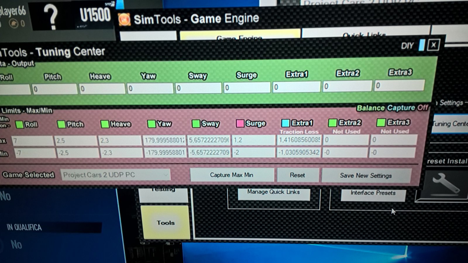

  15. Enrico
    Enrico Member
    Feb 5, 2018
    123
    417Coins
    +28 / 0 / -0
    4DOF
    ...found it
    In tuning center, surge values were both to 0!!!:confused::confused::roll:roll

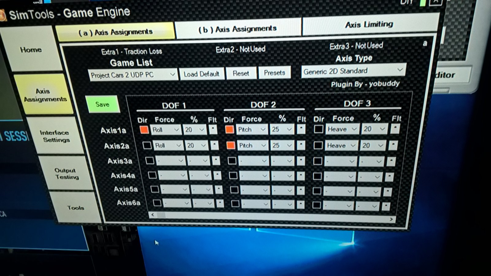

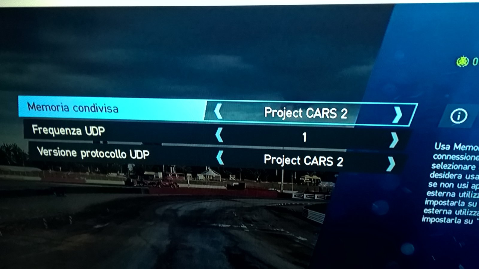

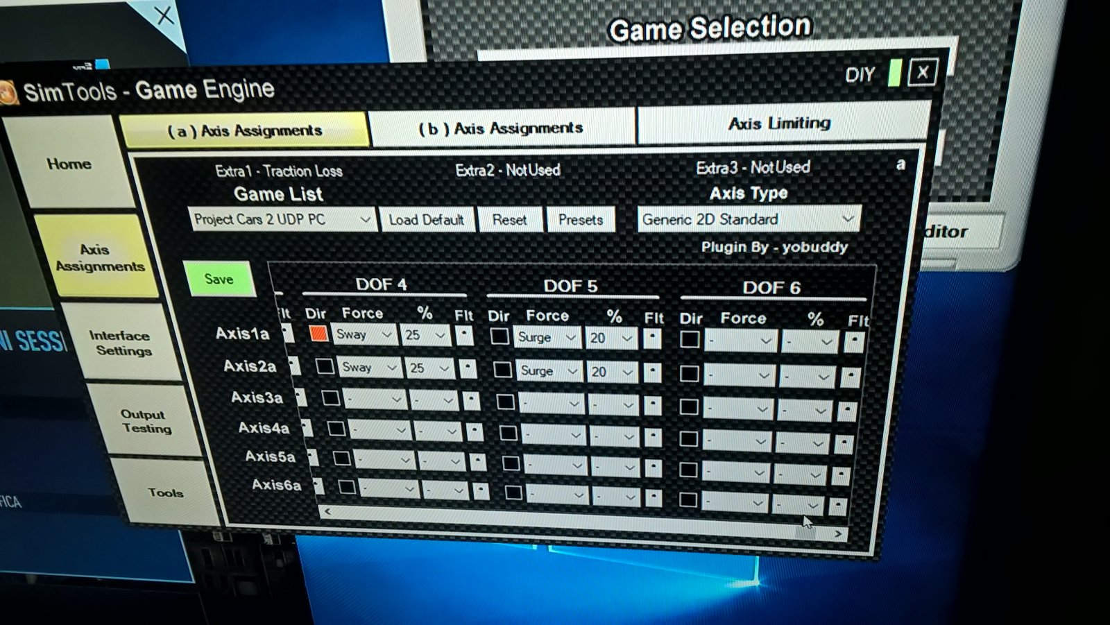

  16. Enrico
    Enrico Member
    Feb 5, 2018
    123
    417Coins
    +28 / 0 / -0
    4DOF
    .... no, didn't solved.
    I have setted up the values in tuning center, and game engine and started to play.
    After few minutes changing cars and circuits without problems they appear again.
    Here the video and pictures of the settings
    WP_20190224_18_18_56_Pro.jpg WP_20190224_18_19_35_Pro.jpg WP_20190224_18_19_45_Pro.jpg WP_20190224_18_20_05_Pro.jpg
