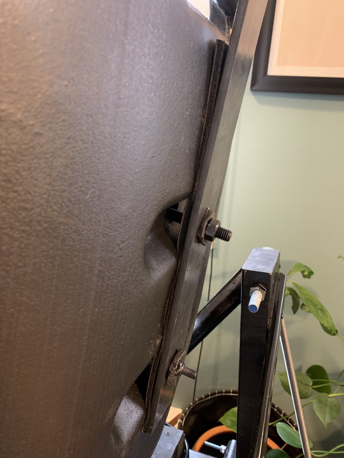

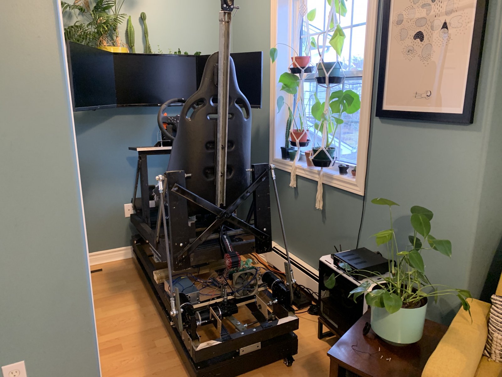

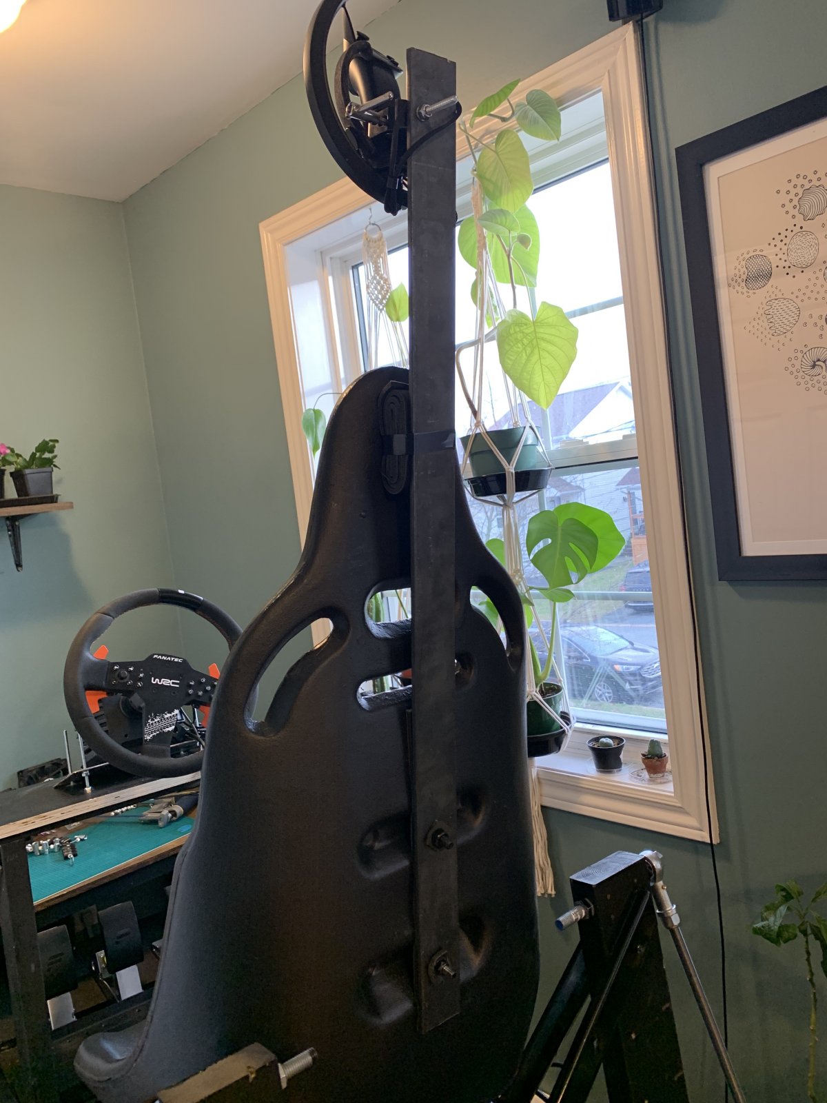

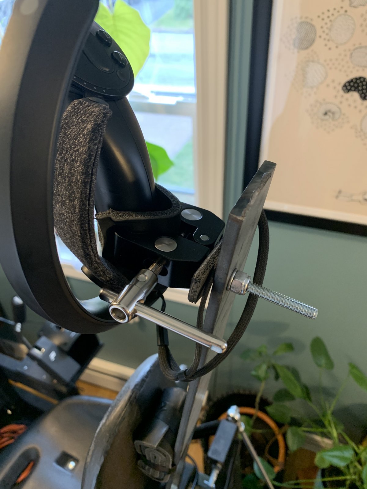

    I am no adding motion compensation to my platform using this software: https://ovrmc.dschadu.de/
    and I built a stablizer for my valve index controller which is what this tracking software uses to determine where your body should be. Which is why you attach it to your platform, so that you won't pop outside of the car when sliding sideways in Dirt Rally :)
    One of the things I am trying to do is iminimise the vibrations. I cut up a yoga mat and used that between the bar and my seat and between some of the nuts as a sort of rubber washer.
    In hindsight I shouldn't have used a flat bar for this, a square tube, or even angle iron would have been better because up at the top the bar can get a good wiggle going, which is why I had to put a stack of yoga mat between the bar and the headrest, to try and mitigate this movement.
    I just recieved a new mig welder from my inlaws! So I will be soon rebuilding this all in metal (when ever I can source some cheap metal), and at that time I might improve the stability of this. I could weld a little fin down the flat side to give it more stability.

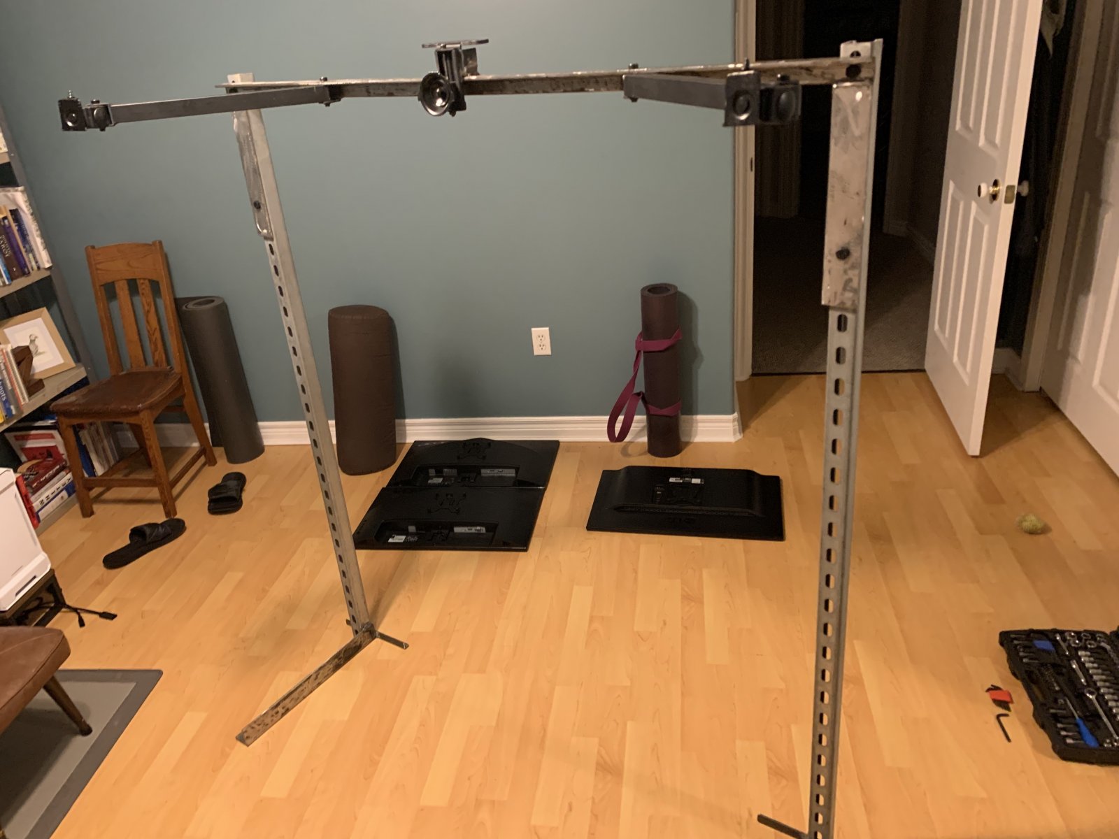

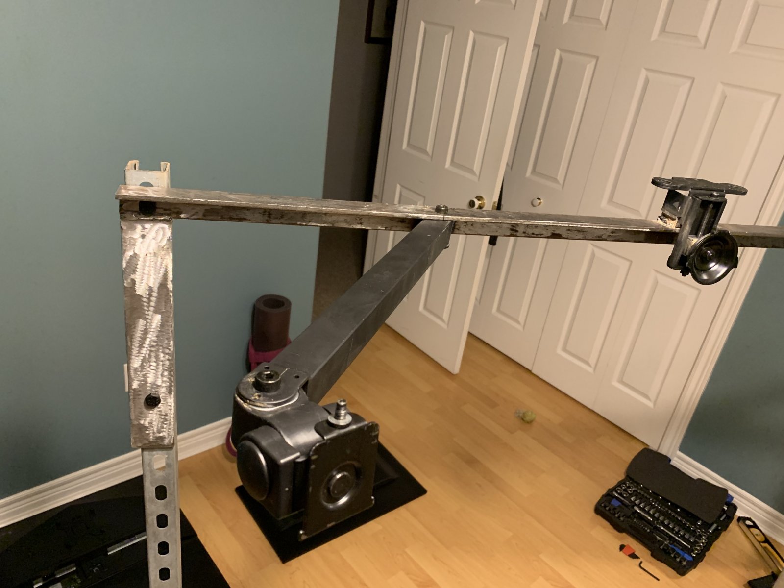

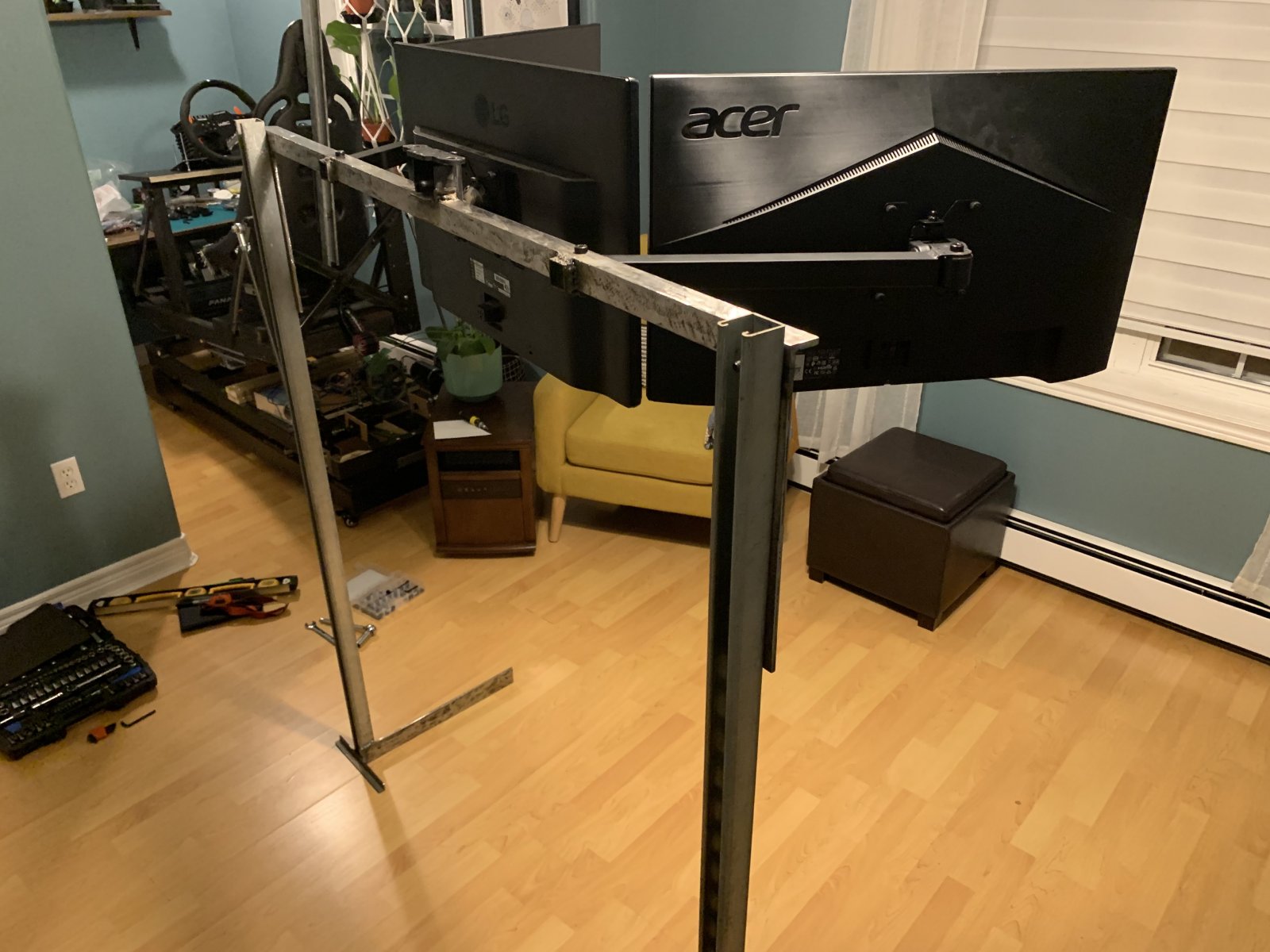

    Well, I am ready for some welding! I got a new flux core welder during Christmas and I am going to begin rebuilding the platform in steel. But first to practice my welding skills I built a freestanding triple screen monitor stand because one of the problems I had with my motion platform was that my screens were so far from me sitting on my desk that it really didn't feel very immersive. Now with this stand I can pull the screens right over my direct drive so I feel more like I am in a cockpit. I harvested some of the brackets from my existing monitor stand (which ment I needed to get this right or I wouldn't have any monitors for work the next day haha)
    I built the whole thing on steel uprights that have spaced holes that I am using for height adjustment. My horizontal bar that has the monitors attached can be moved up and down to what ever height I need. The thing is sold like a tank and it works great.

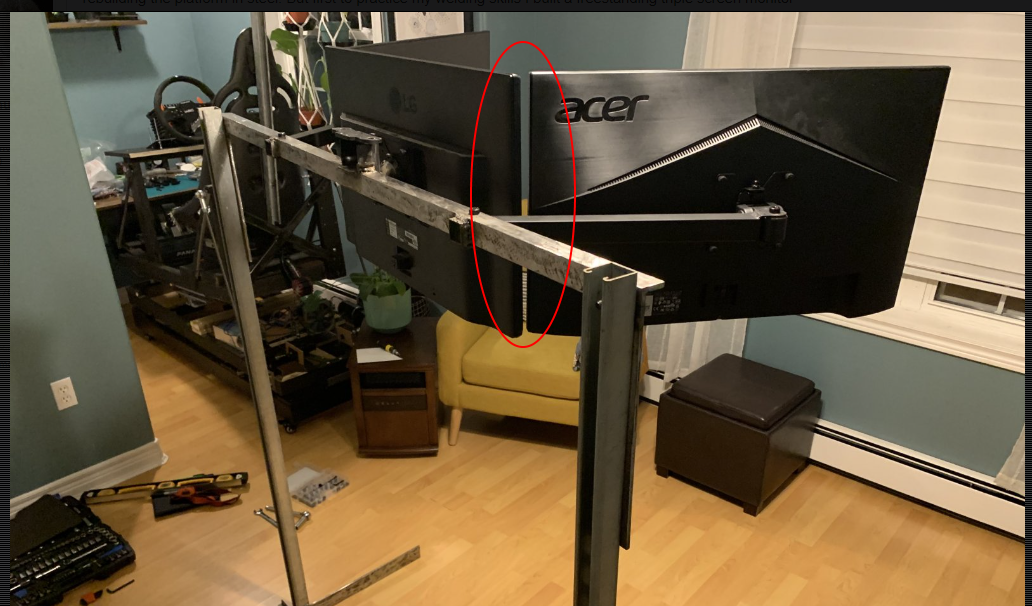

    This is the gap I was looking at on yours. See how it is wide at the top, narrow at the bottom, and the right monitor is slightly above the center one. Maybe it goes away once you rest it against the middle monitor. Mine does not. I have to clamp them to get everything to come together or it will just open back up.

    Ah i see @Richard Ortengren , I am using vesa mounts from an old monitor stand, and they have the ability to rotate, so I can rotate it to make them parallel to the center monitor. If you dont have those mounts you can probably find them on amazon without having to buy a full monitor stand.

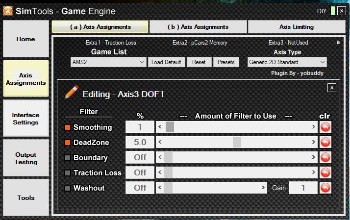

    Hey all, I uploaded another quick video of my rigs motion while playing some AMS2. Please ignore how horrible of a driver I am and the fact that I have the beginner cheverons on the road to tell me what to do haha.
    I am hoping to get any thoughts on how the motion looks in comparison to whats happening on the screen.
    I have been having some trouble in VR with feeling a little woozy and I think maybe I have an axis backwards or something.

    I would suggest that with VR and motion less is more, speed and precision of motion is way more important than large axis movements.
    So use lower axis allocation, particularly for surge, try 20, and perhaps smaller Tuning Center values. Do one axis at a time, see the FAQ tuning tips: https://www.xsimulator.net/community/faq/steps-to-create-a-motion-profile.228/

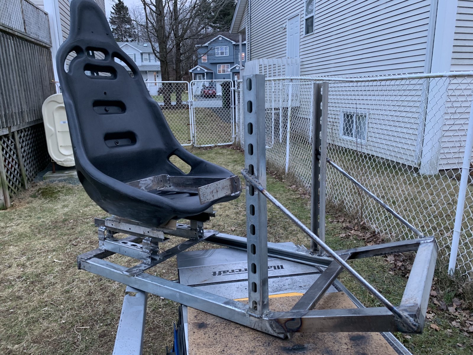

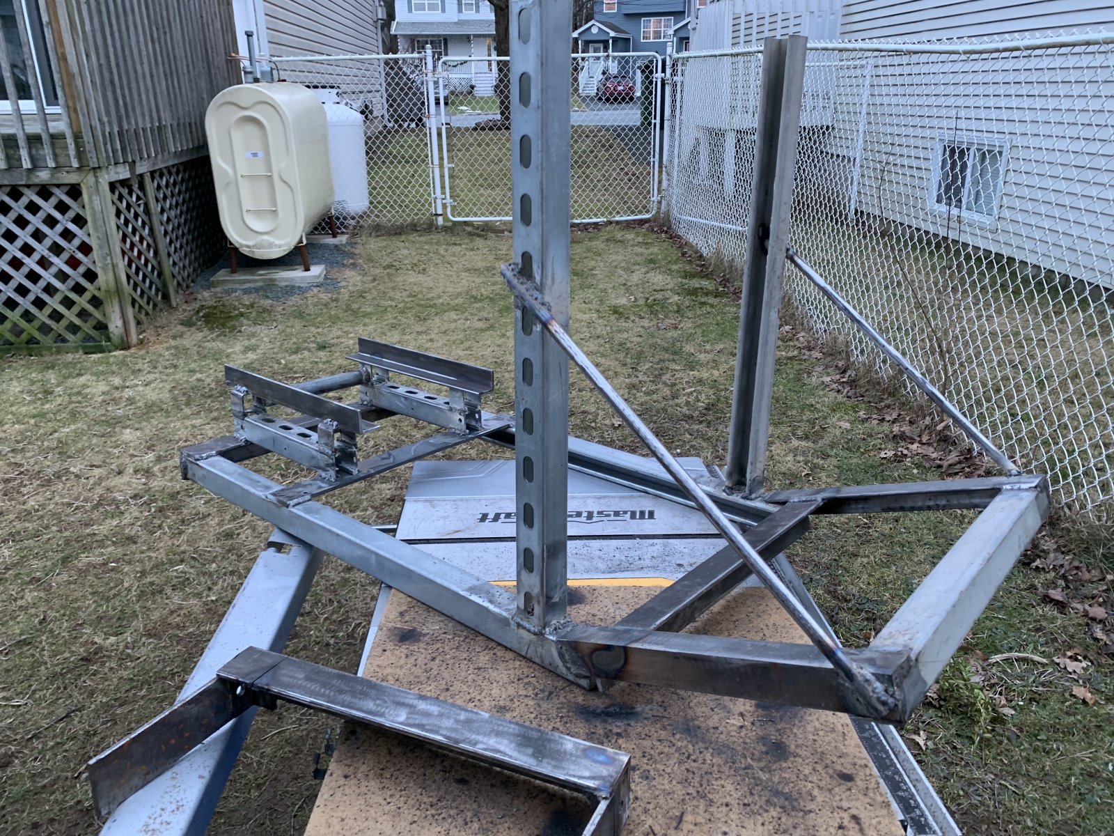

    I made a lot of progress on my steal build of the cockpit this weekend. I already have the bottom and middle platforms started but I spent the entire day yesterday cutting and welding the pieces together for the upper cockpit.
    Having a welder makes life so much easier :)
    I am making the seat adjustable so it can slide forward and back. And I also am making the wheel height adjustable up and down and also forward and back. So the only thing in a fixed position will be the pedals, but the other adjustments points should make that ok.
    I am going to hopfully figure out the shifter and handbrake mounting this week.
