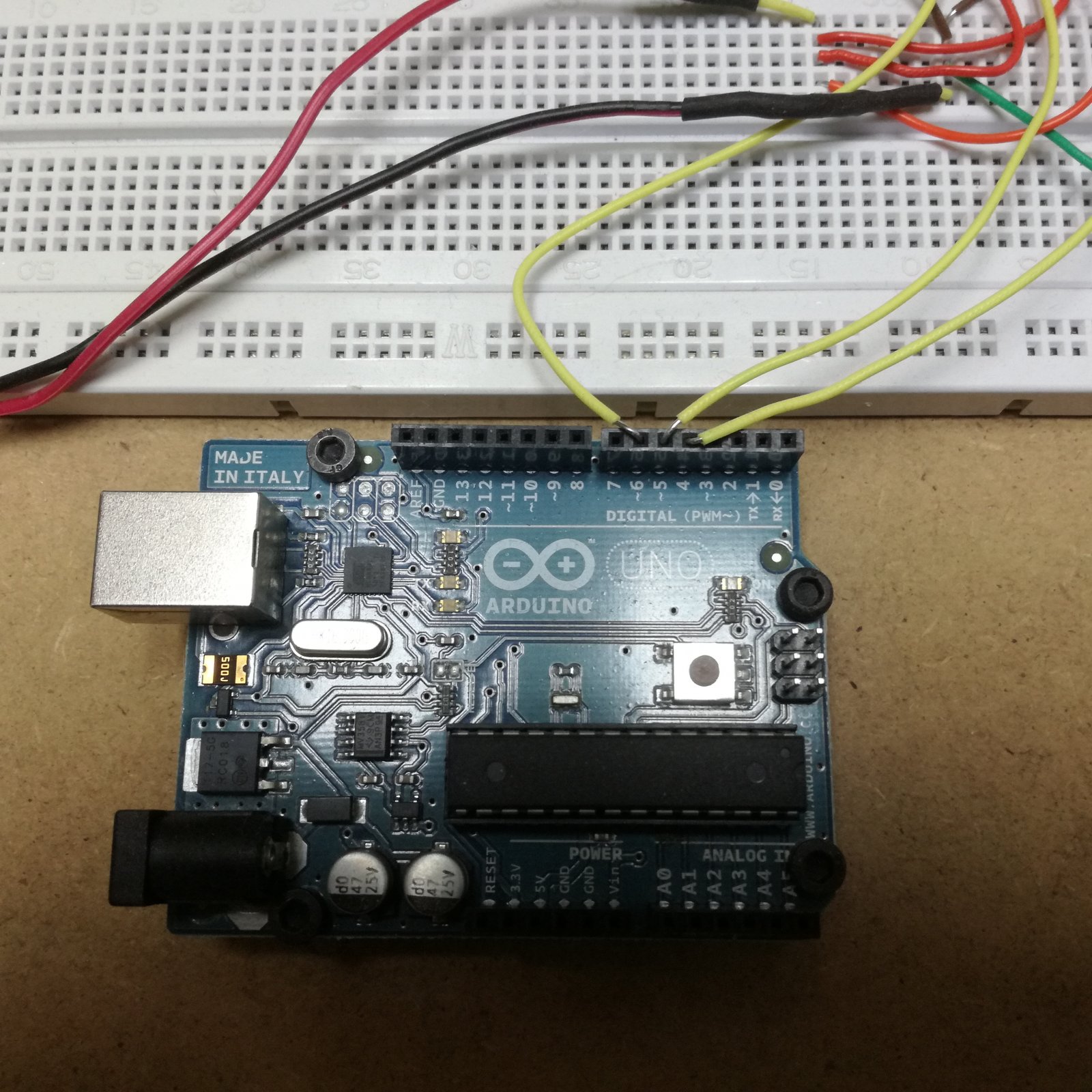

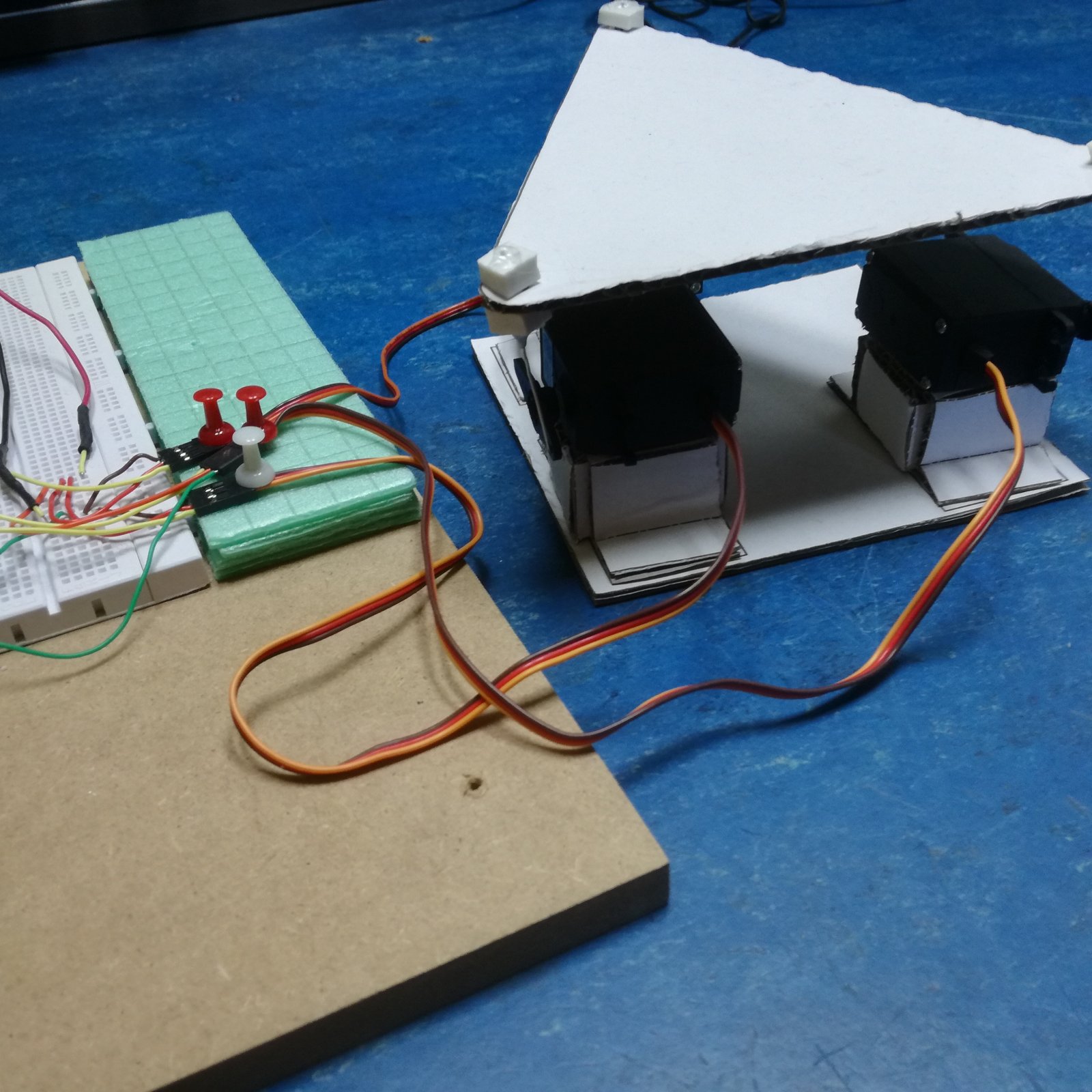

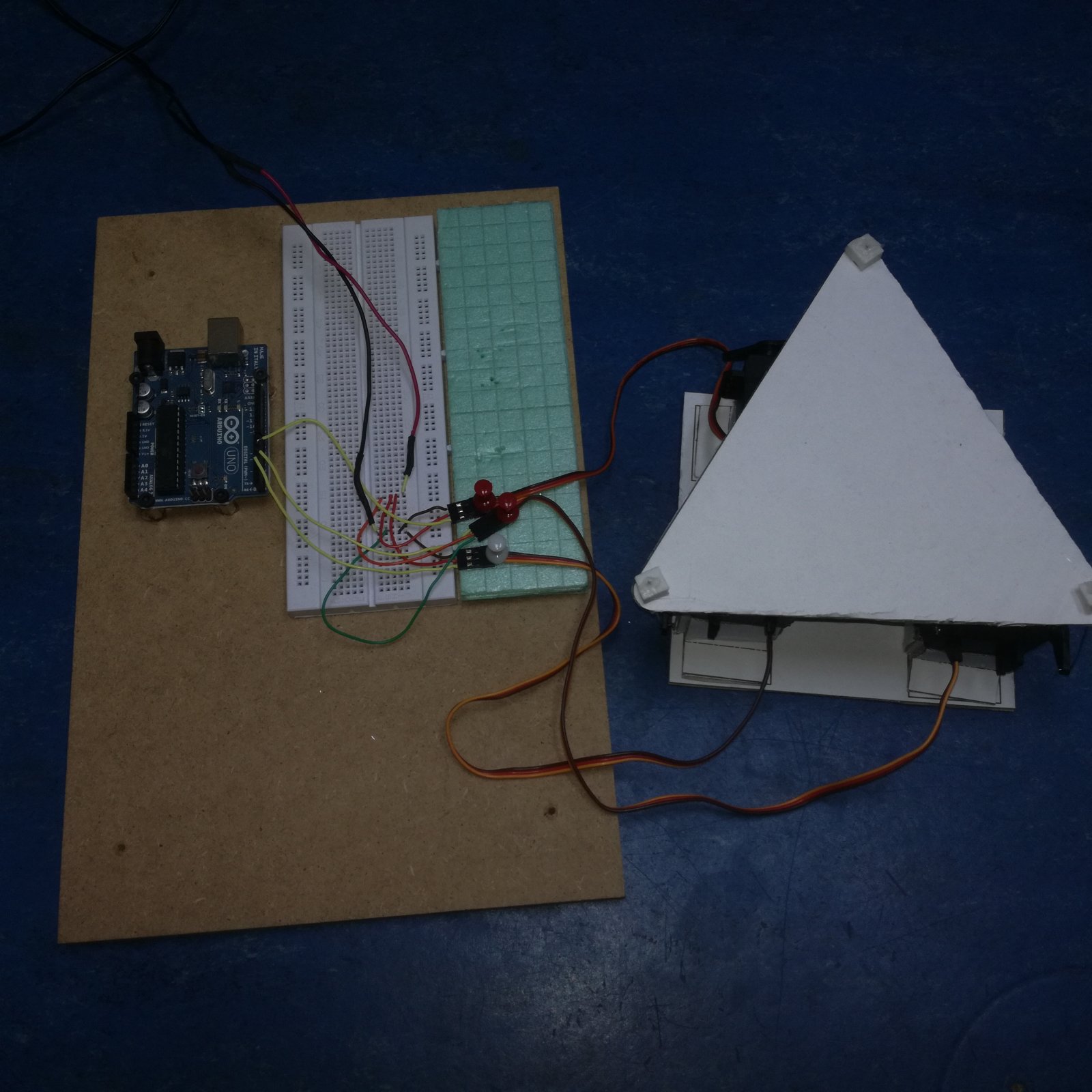

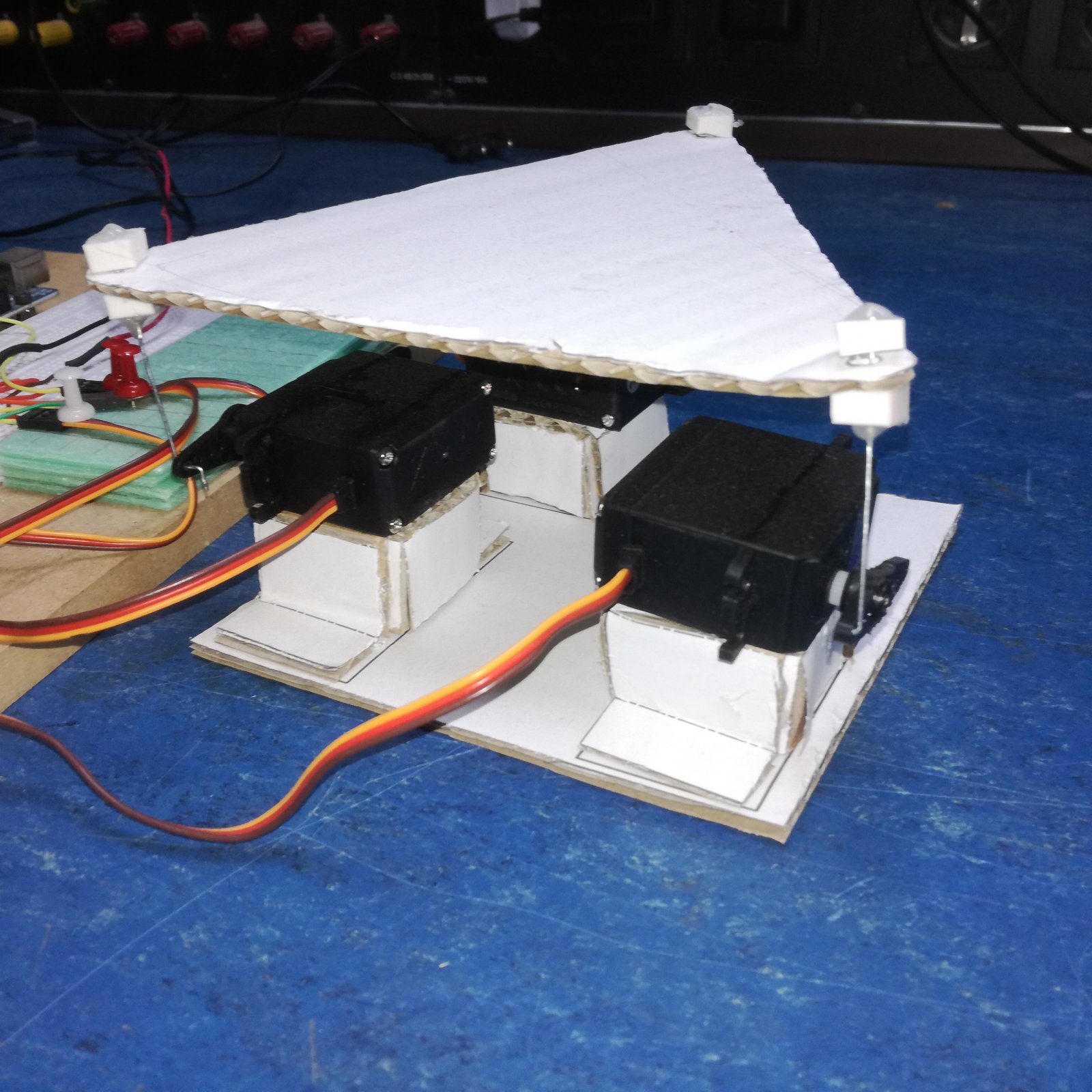

    This weekend I started again and build a 3 DOF model with the stuff I found at home.
    I used some cardboard, double.sided tape, eraser, paper clips, an old power adapter (5V) from a mobile phone, 3x standard RC Servo and a Arduino Uno.
    I made a cutting template which can printed out and glued it directly to the cardboard. In this way it was easy to cut it out.
    I used the code from eaorobbie (see link below) and added a third axis (RC_Sim_Model.ino).
    https://www.xsimulator.net/community/marketplace/rc-model-code-for-arduino-uno-2dof-expandable.89/
    For the case you want to build this model I added some data's to this thread:
    You find the settings for the interface and the axis assignments in the attachments. There is also a drawing of the control rod in scale 1:1 which is made from the paper clips. I think the 3D PDF will also help you to build this easy platform.
