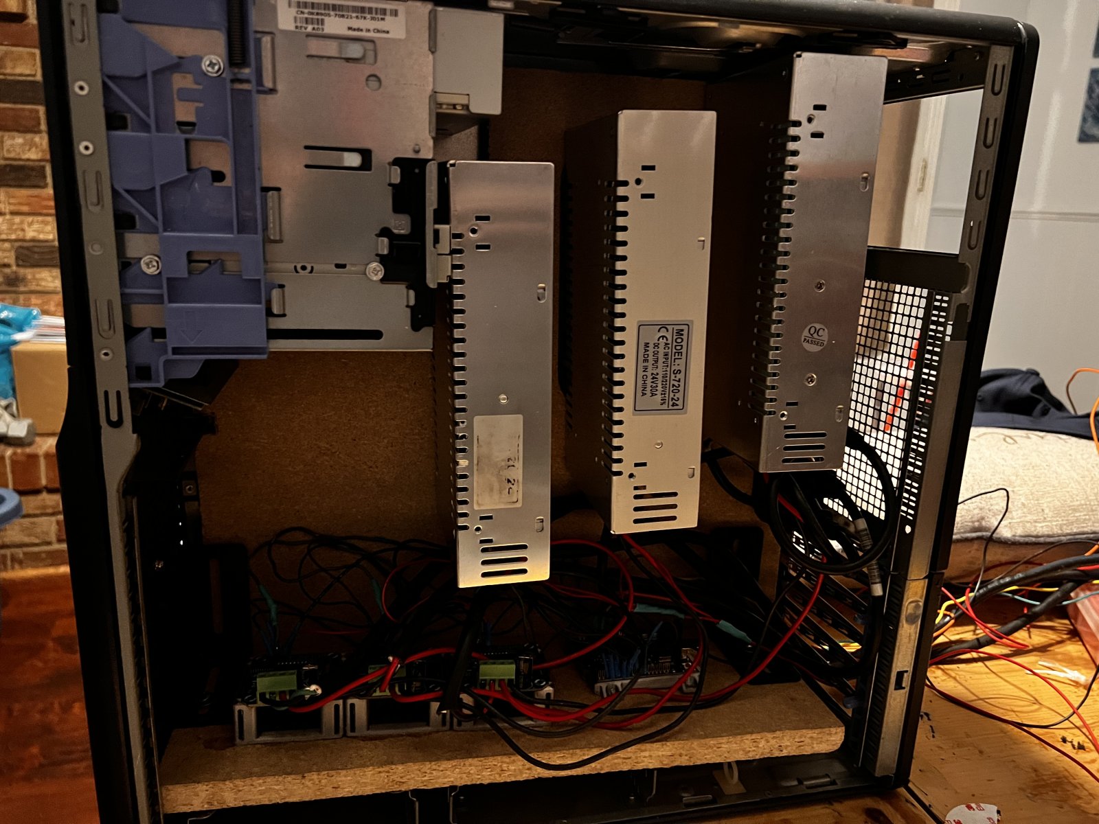

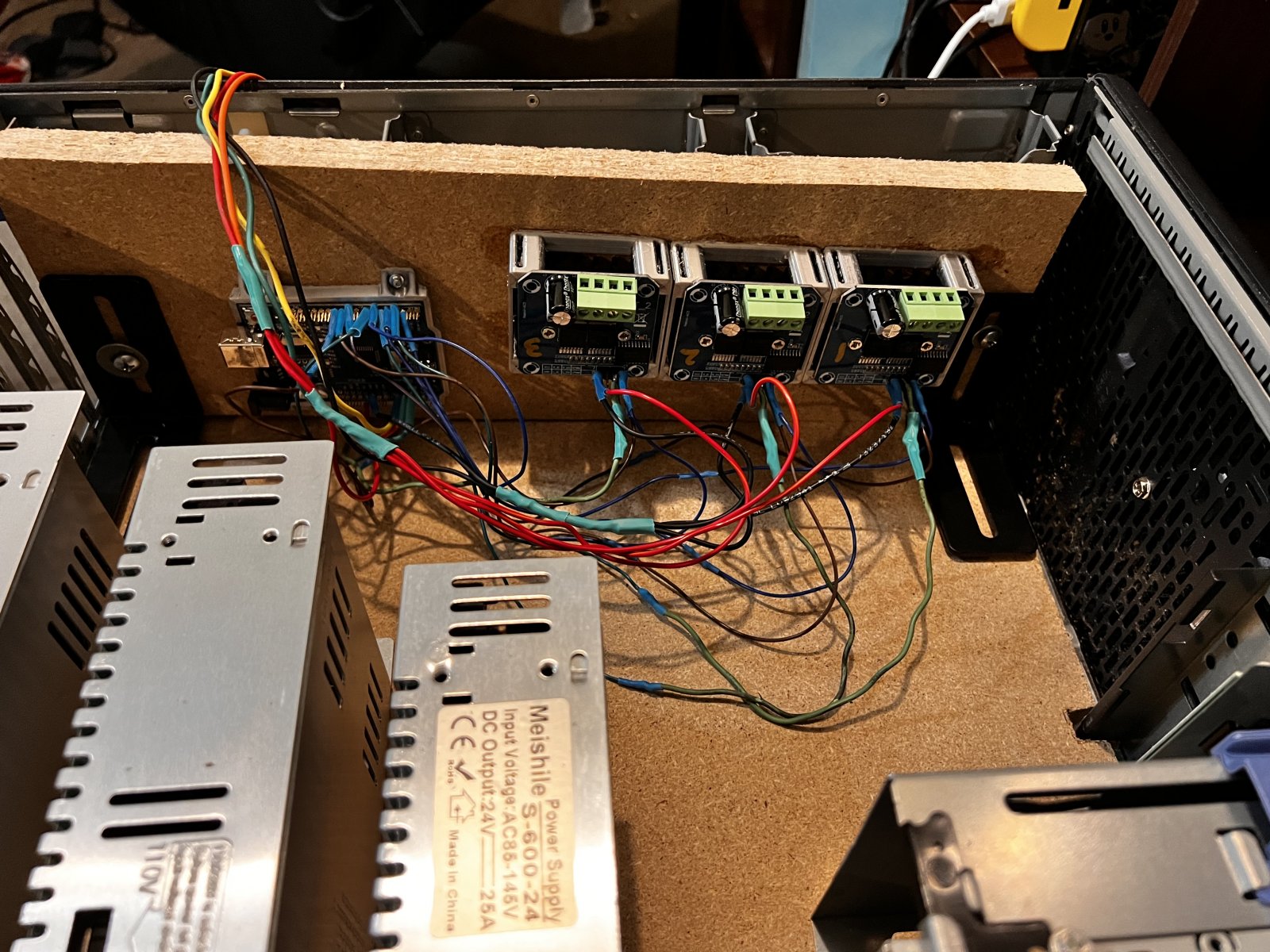

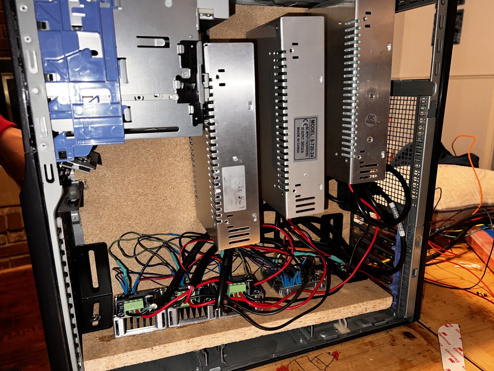

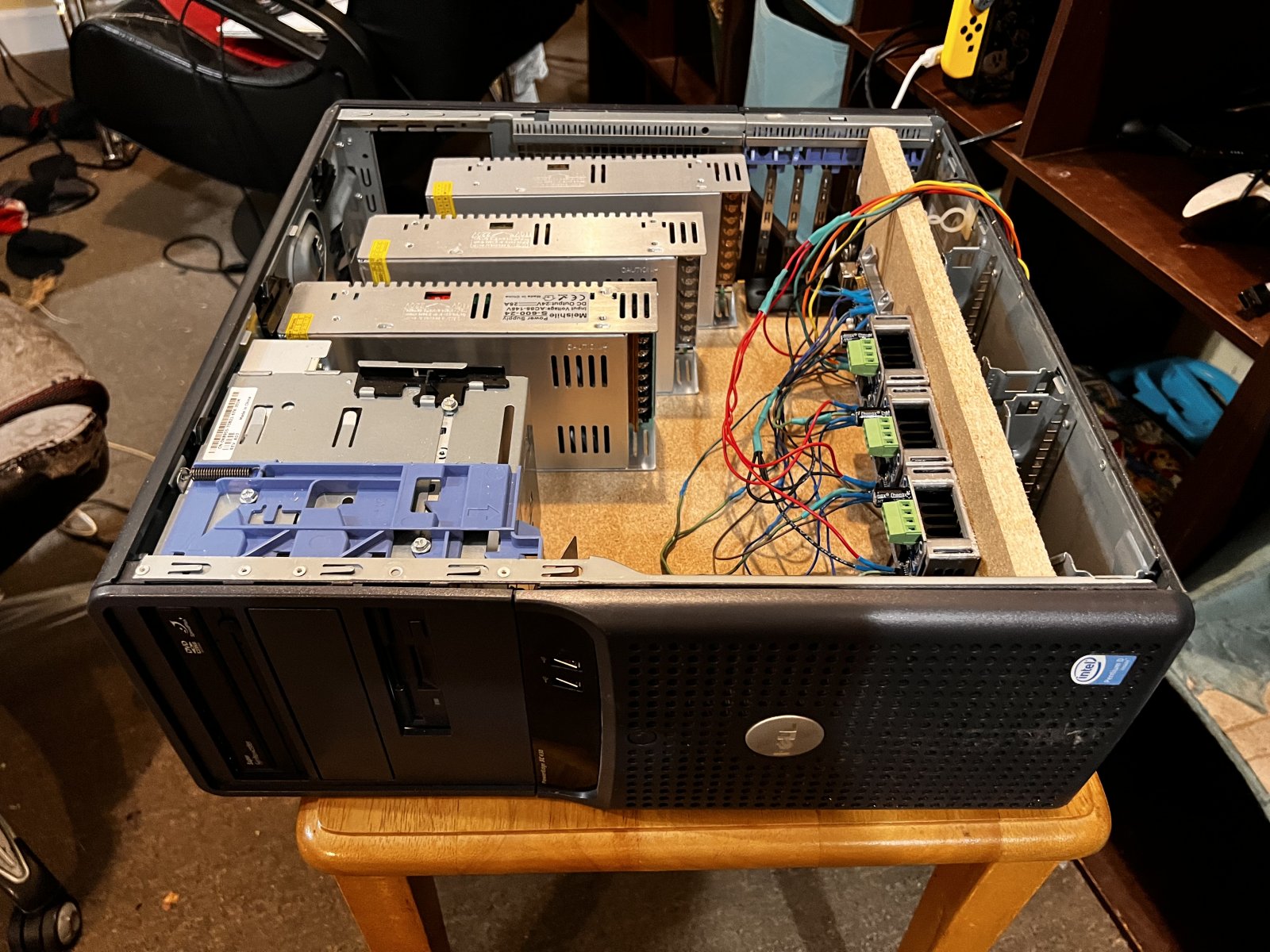

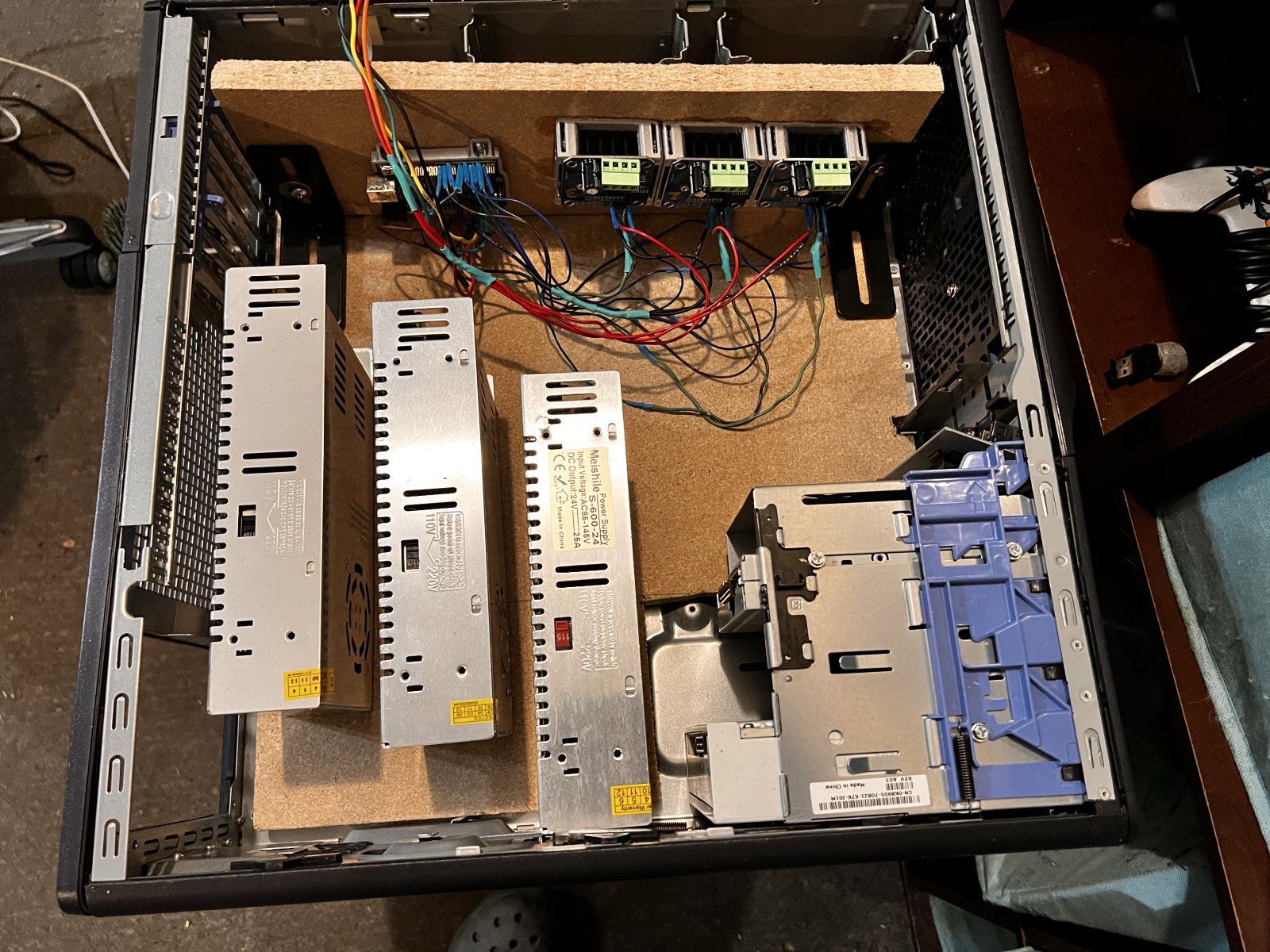

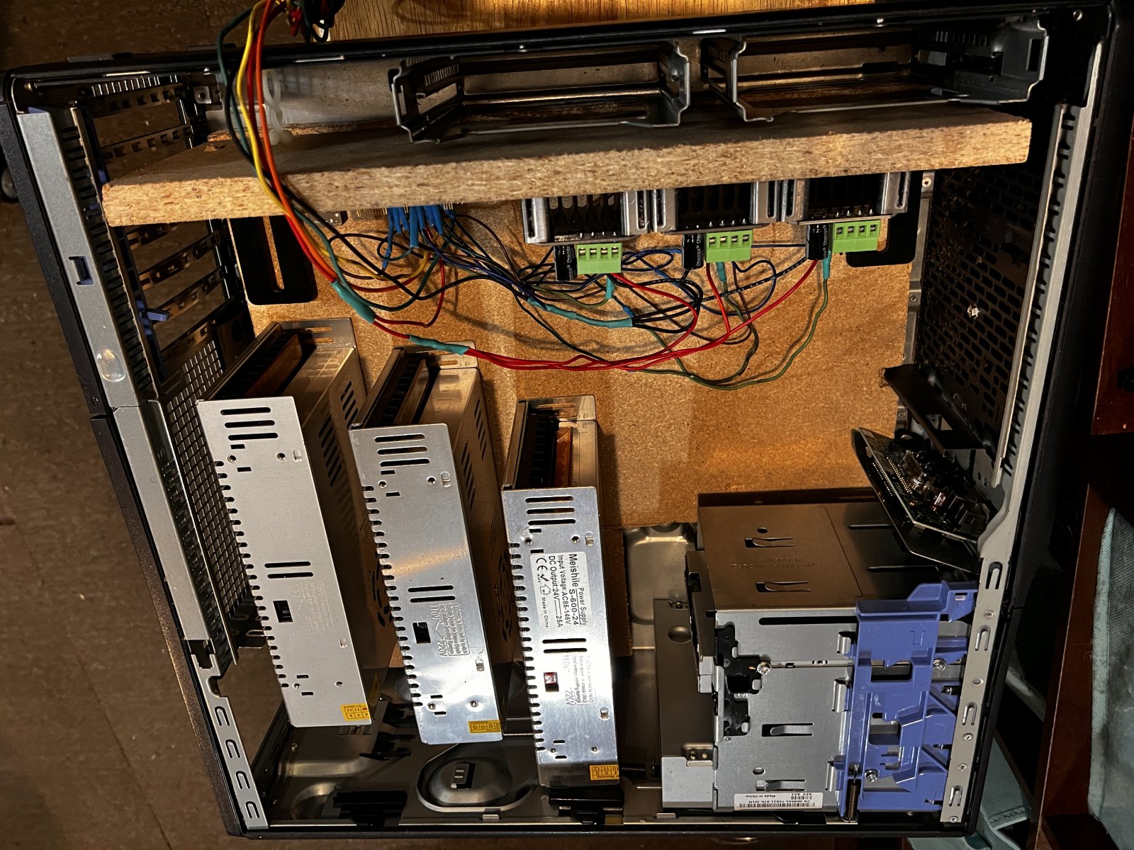

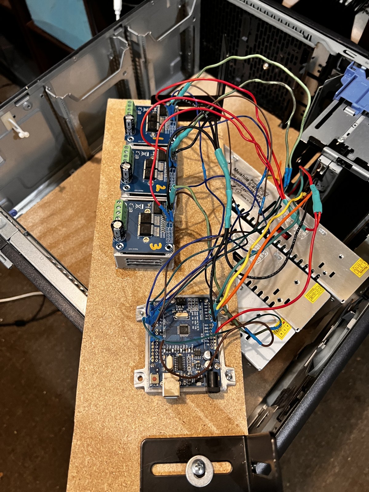

    Using an old dell computer case to house these goodies 8A6481F3-F379-4649-9C6B-0BEE86626A88.jpeg 98175717-38FA-44DC-8F85-DF336D534ED7.jpeg 7BE849AA-4667-4545-95BF-199906C42A17.jpeg

    All wired up

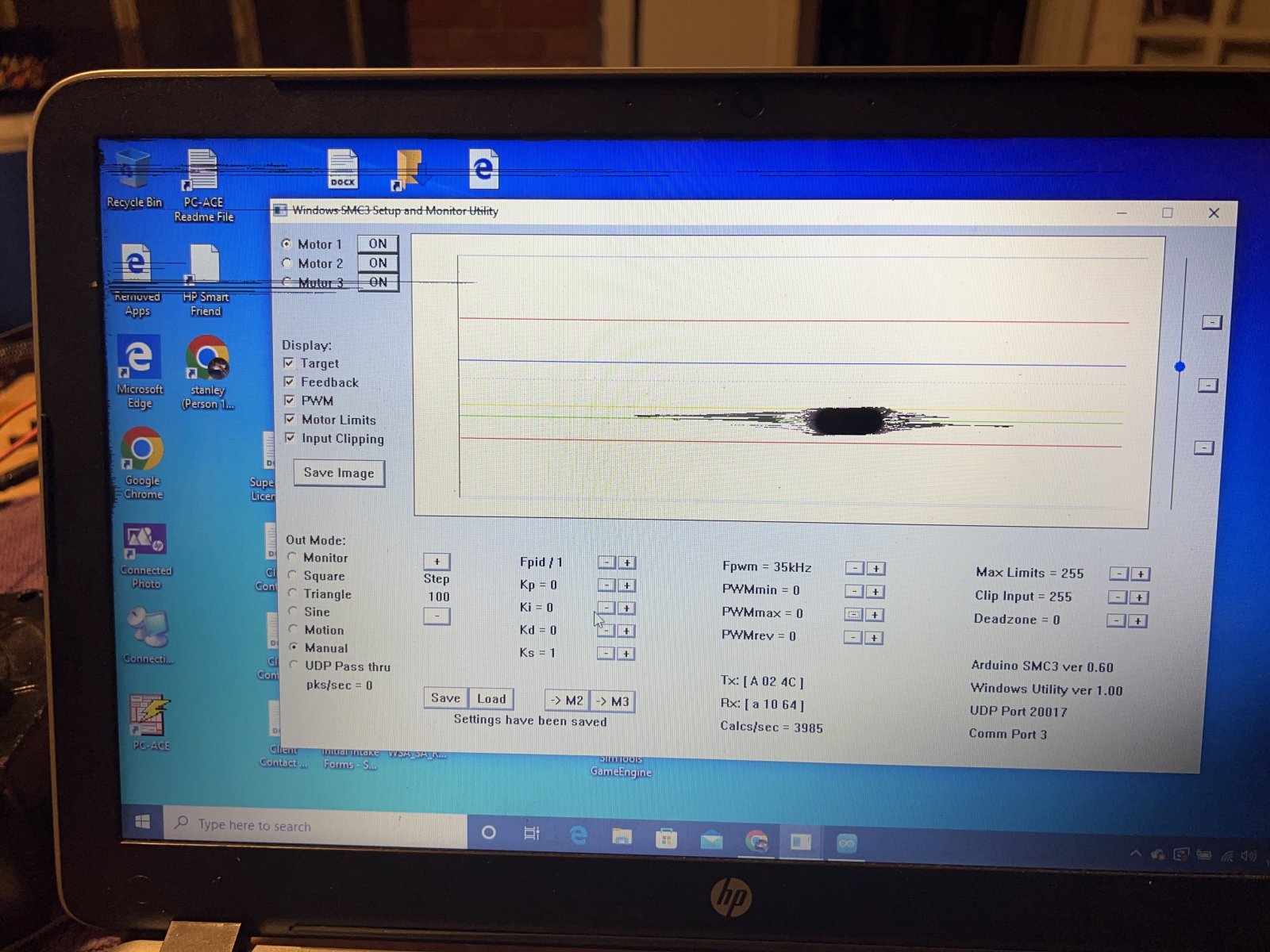

    I forgot to mention about the spot in the middle of the computer screen, thinking the screen is burnt just ignore it

    The
    The pots need to be centered when attached to the motors, and SMC3 properly configured.
    Have you followed the Initial Setup steps in the SMC3 instructions: https://www.xsimulator.net/communit...3dof-motor-driver-and-windows-utilities.4957/
    Initial Setup
    I strongly recommend you follow the steps below if this is the first time you are using SMC3 with your simulator to reduce the risk of damaging anything.
    8. Set Kp to about 400
    10. Do the above for each motor

    image.jpg even with everything at 0, the motor still jerk when powered up
    21,581
    151,100Coins
    +11,030 / 56 / -2
    Fpwm should likely be 25, ensure the pots are centered (motor off check track line in SMC3) and the pot brackets don't flex. Step - set to 1.

    What’s track line?
  14. stanley johnson
    stanley johnson Active Member
    Sep 14, 2022
    117
    Diesel tech
    Nashville
    82Coins
    +40 / 0 / -0
    Is track lines the lines on the smc3 graph?sorry I’m still learning

  16. noorbeast
    21,581
    151,100Coins
    +11,030 / 56 / -2
    I
    In the Display settings of SMC3 (left side of UI) you can temporarily turn everything off except the line tracking the pot, to ensure the line, and hence pot, is centered in the graph when the pot is attached to the motor.

    It’s either high or low, it will not go to center
  18. stanley johnson
    Sep 14, 2022
    117
    Diesel tech
    Nashville
    82Coins
    +40 / 0 / -0
    Rotated it to the left and it moved to center, do this mean my pot is centered?

    But what I noticed is the motor in top left turns off , is that normal? All three showing off
  20. noorbeast
    21,581
    151,100Coins
    +11,030 / 56 / -2
    Just checking, is the pot perhaps 180 degrees out of rotation?
