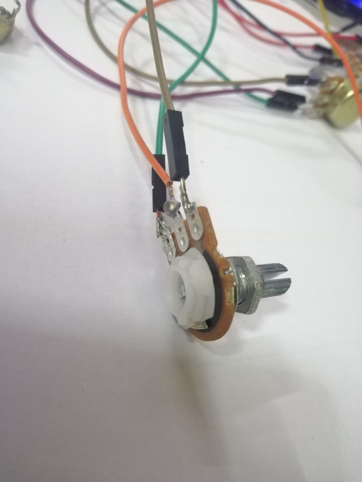

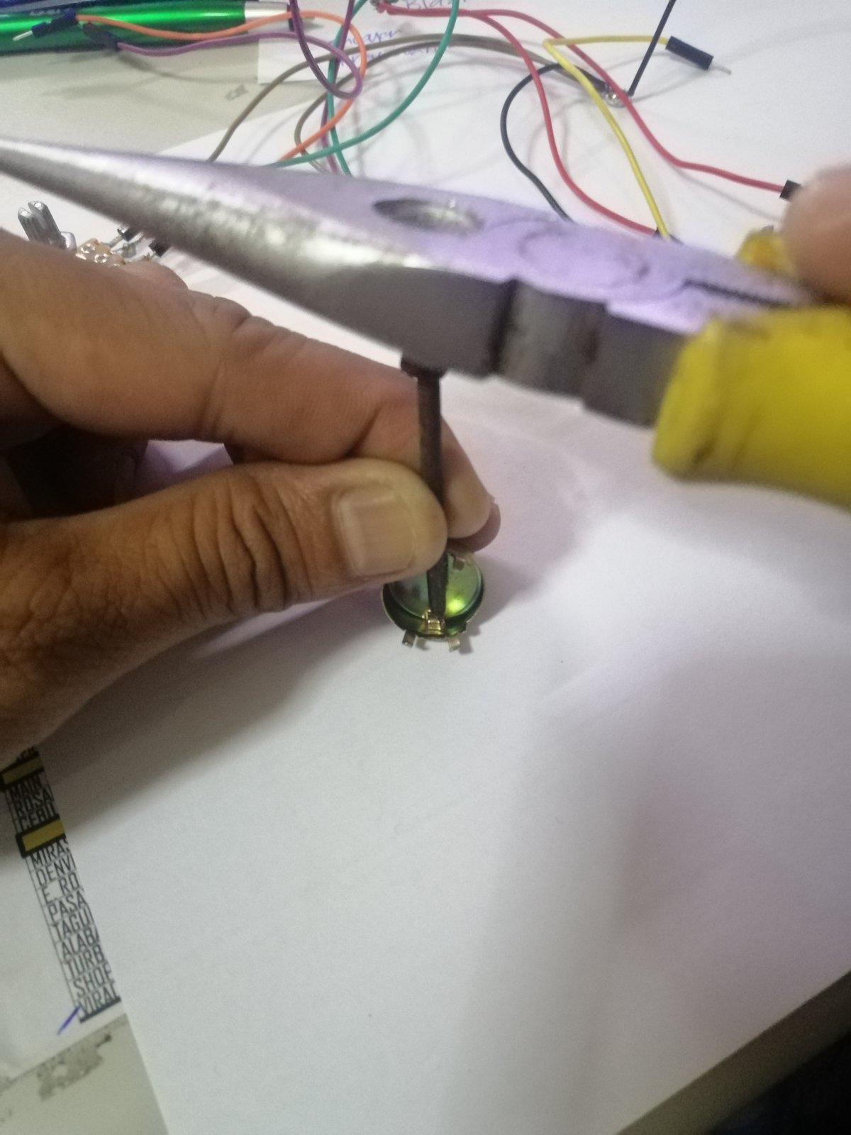

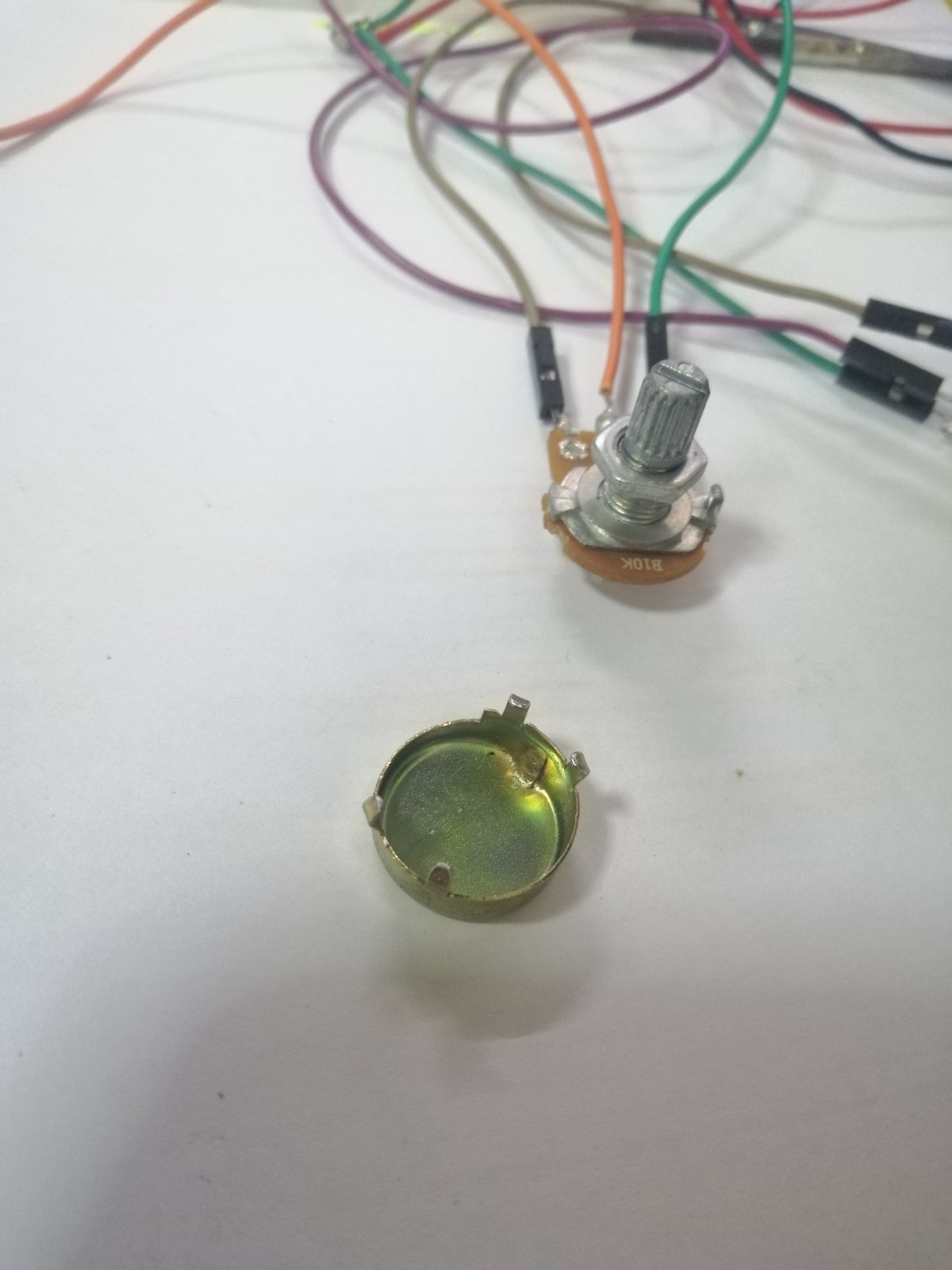

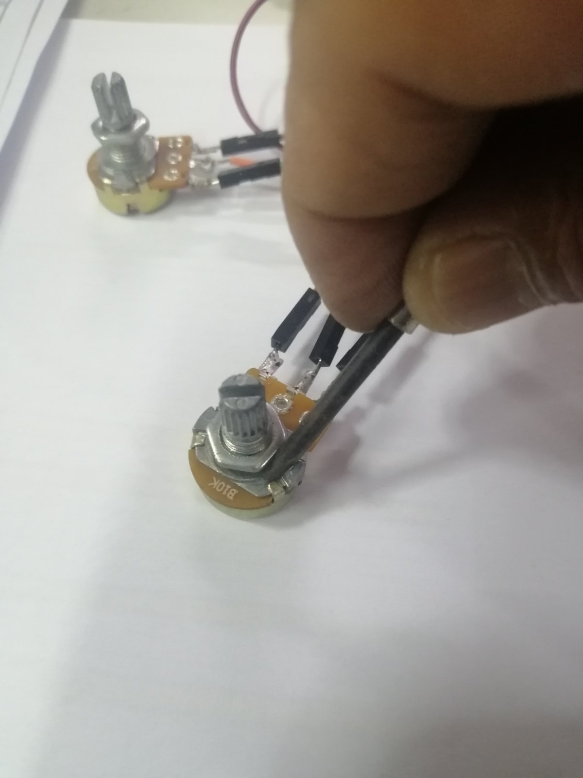

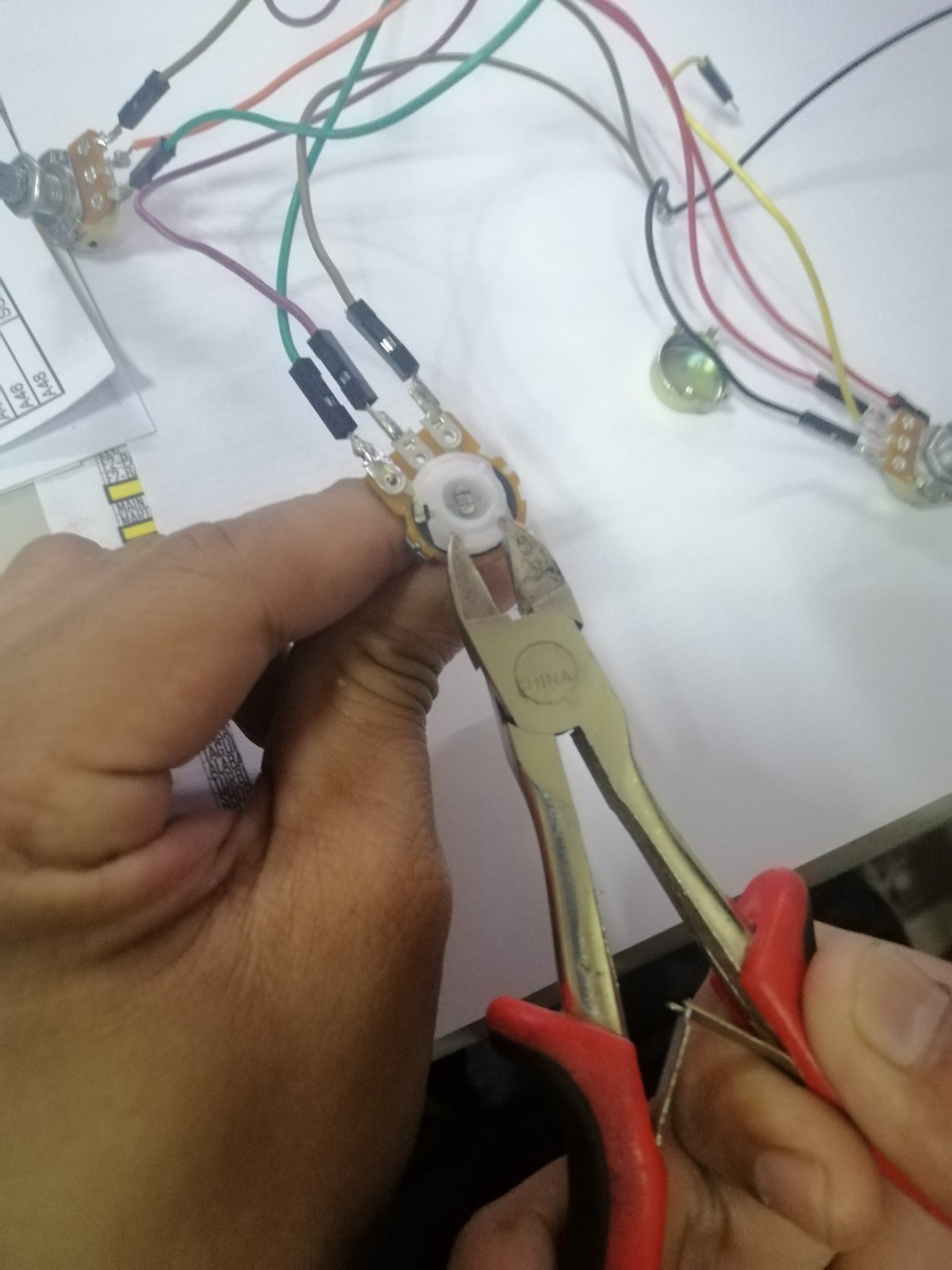

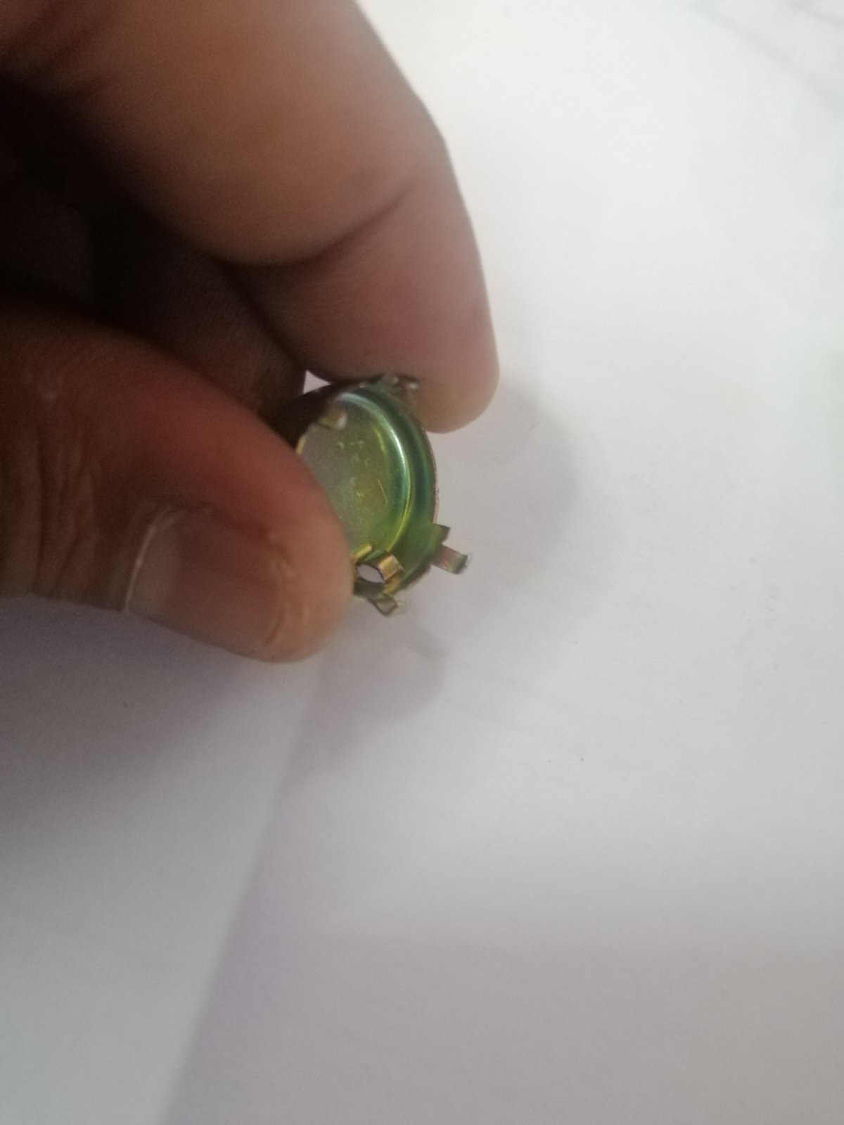

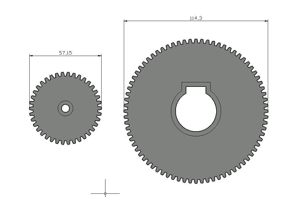

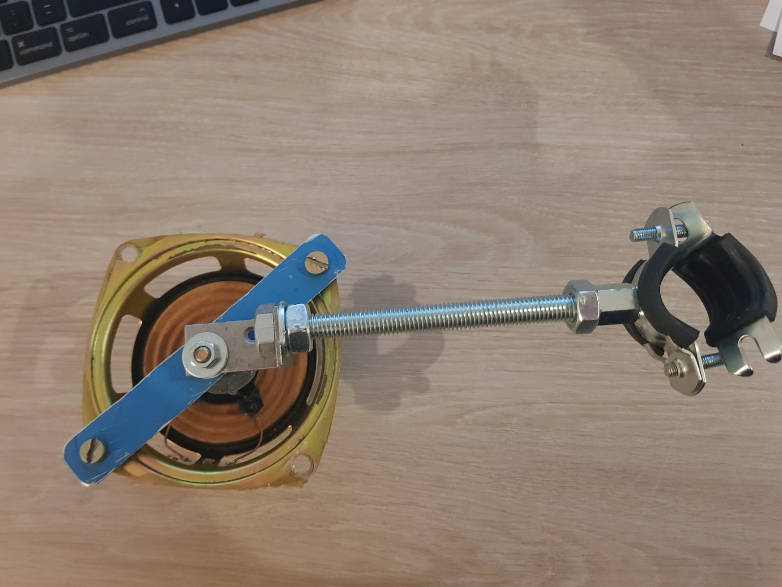

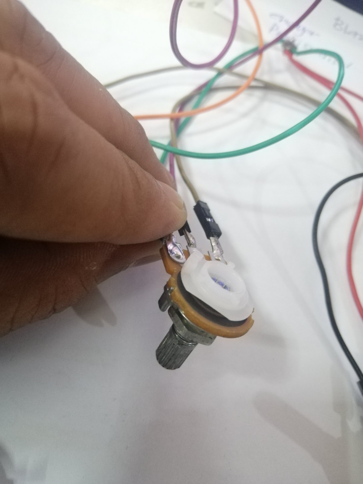

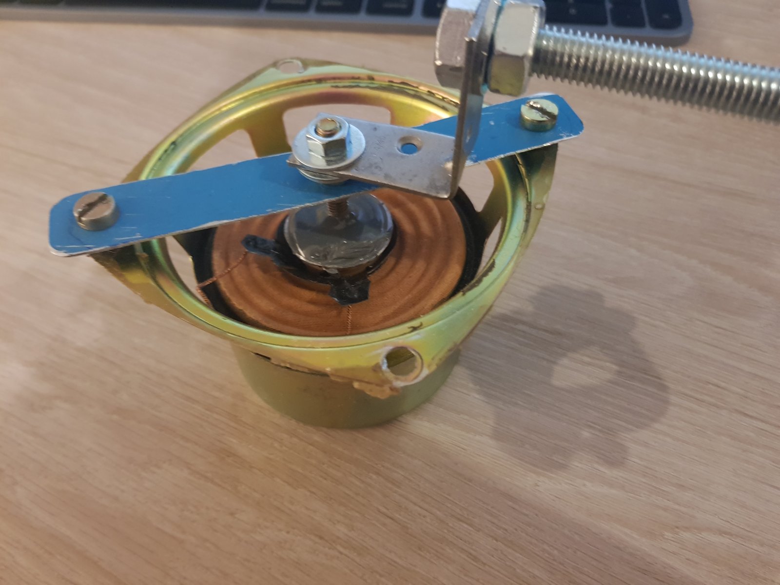

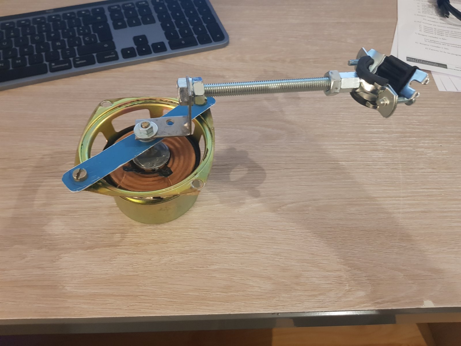

    After several queries, thanks to @noorbeast for sharing the @Alexey project http://www.xsimulator.net/community/threads/how-to-remove-the-end-stop-in-a-potentiometer.7198/. Finally done with cutting off the tab and the stopper to prevent destroying my potentiometer due to levers going out of range coz in my case I only have 180%, not 360%. Here how it works. IMG_20191201_173056.jpg
    Carefully unlock 4 sides
    Carefully cut off the tab
    Straight out using any pointed or plat screw

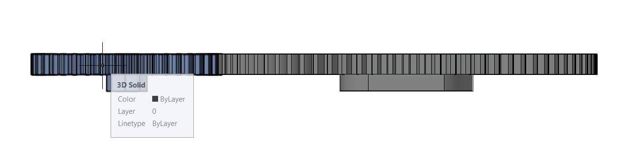

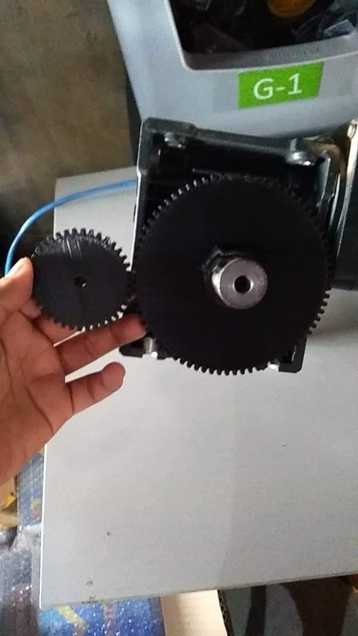

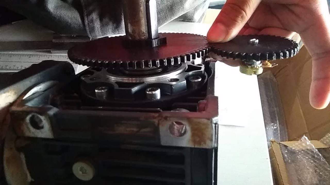

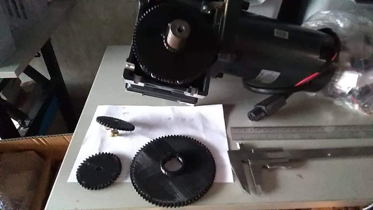

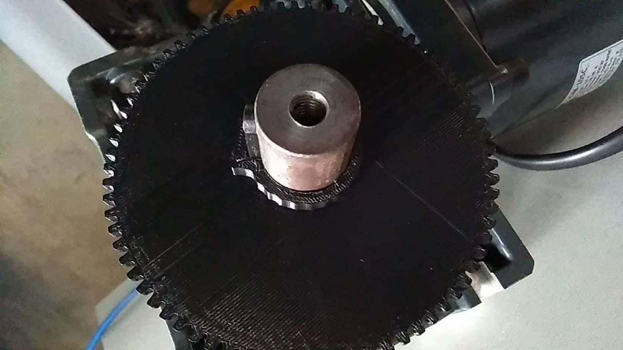

    I also, include here with the gears, It consists of Big gear with 76 teeth, 114.3mm and the small gear with 38 teeth, 57.15mm and thickness of 6mm.

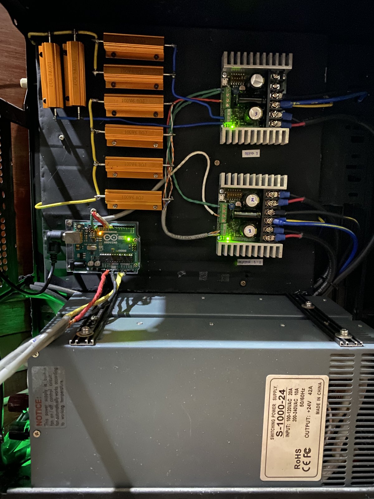

    @noorbeast I did the connections as u say but the problem still there are no movements. I check/tested all the wires and replace them and also add the 2 resistance for engine 4 (for future engine upgrade) updated setup.JPG

    You could try testing them with the SMC3 code and its handy calibration application.

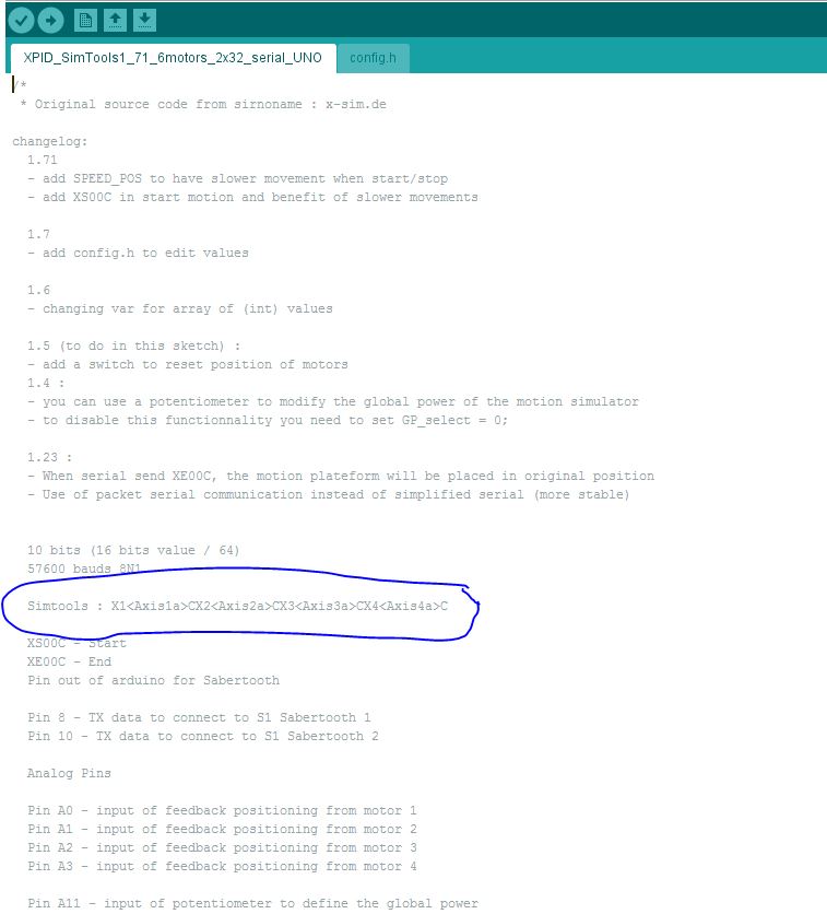

  5. MENANDRO DALIDA JR
    MENANDRO DALIDA JR Member
    Apr 19, 2019
    53
    51Coins
    +17 / 0 / -0

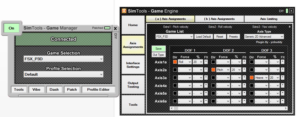

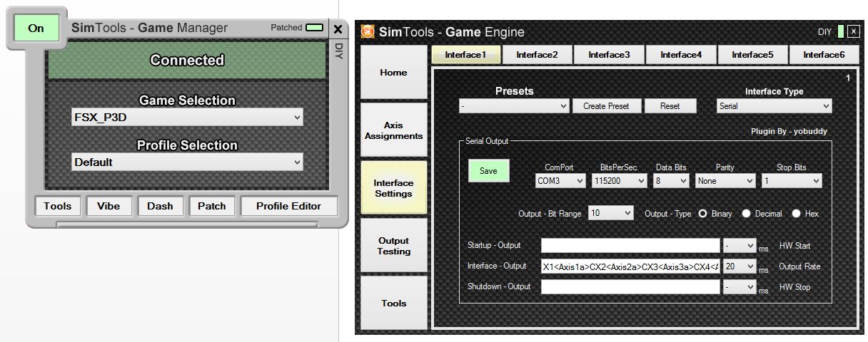

    Interface settings and set the speed at 57600
    Startup - Output : XS00C (10ms)
    Interface - Output : X1<Axis1a>CX2<Axis2a>CX3<Axis3a>C (10ms)
    Shutdown - Output : XE00C (10ms)
    Finally got the movement with motor for that interface, the problem was I can't control the motors. The motor 1 & 3 are still on shaking/vibrating movement while motor #2 is on continuously rotating.
    22,185
    154,732Coins
    +11,194 / 57 / -2
    What pots are being used?
    Setting in SMC3 have to be fully sorted before messing with SimTools.

    Go for exclusion .... take a potentiometer of motor 1 or 3 that works well and put it on motor 2 .... in this way you understand if it is the potentiometer that creates problems.
    Which Wanegain code you have installed, 1_6 or 1_7 ..... in version 1_6 the codes are directly in the program, while in version 1_7 they are in "configh" file.

    Thanks for your encouragement. I used XPID_SimTools1_71_6motors_2x32_serial_UNO.
    I just noticed earlier that when I pulled out the pin for pot motor#2, still they synchronized with motor #1 whenever I move.
    Ok, good idea. let me used the potentiometer of other motors just to see if its the potentiometer itself has the problem.

    Its a bit confusing now. A while ago I take the potentiometer from motor #3 to motor #2. It's the same problem, which means it's not the potentiometer that has the problem and aside from that, motor #3 is still working without the potentiometer, it follows to my command. It's a weird thing happened. HAHAHA. I'm losing my mind.

    It seems very strange to me that motor 3 follows your command without a potentiometer ....

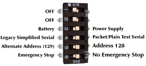

    Make sure that the DIP switches of Saberthoot 1-2 are off, in the picture it is not clear.
    I don't know what else to advise you.
    Maybe it's better than contacts again PCSHM, Simon or Wanegain

    Yes, already switch OFF both Saberthoot 1-2.

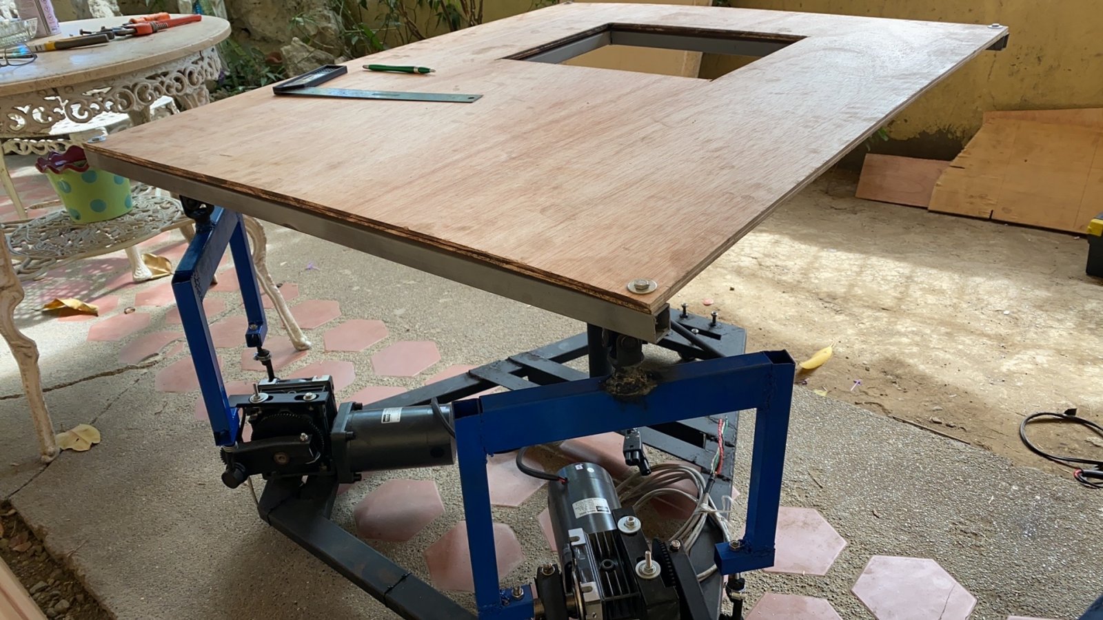

    Hi Menandro Dalida Jr.Congrats for your work, is awsome!!

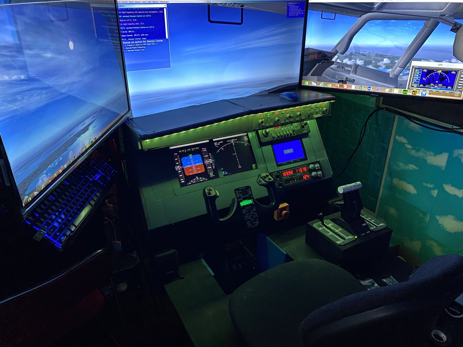

    I'm in the way to build my own 3DOF motion sim for flights. I still didn't start coz first I wanted learn the basics. I've read all the links that, at the first time, noorbeast share with you and also I ride across the forum to search some examples. Your example (and the Milano Fabio one) is the best that fit with my purpose (I decide that after your last video). I want to build a motion sim but with the 737 structure scaled to a smaller model and with less components, only aesthetics, but what I want is to place two seats. Have the motors you used enough power to move around 200 kg? I thniked about increase the triangle created by the motors area.
    Thanks you!!
  14. MENANDRO DALIDA JR
    Apr 19, 2019
    53
    51Coins
    +17 / 0 / -0
    Hi Josh, (Thanks)
    Sorry for the late response, very busy with my work.

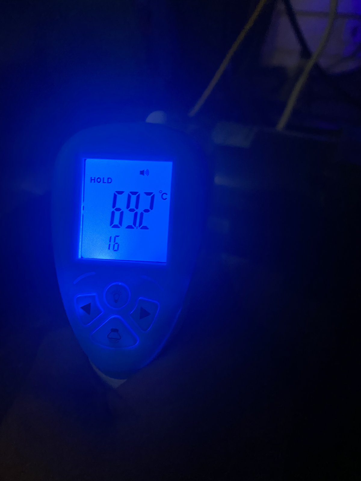

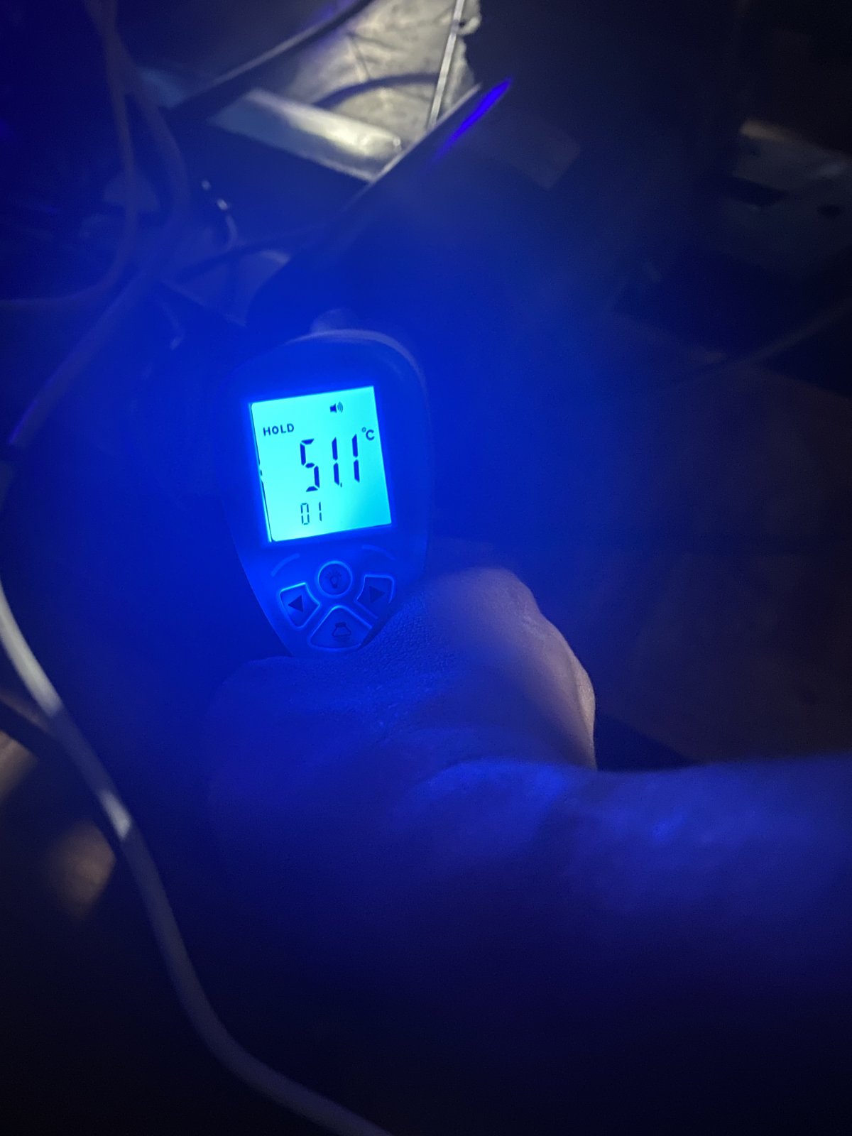

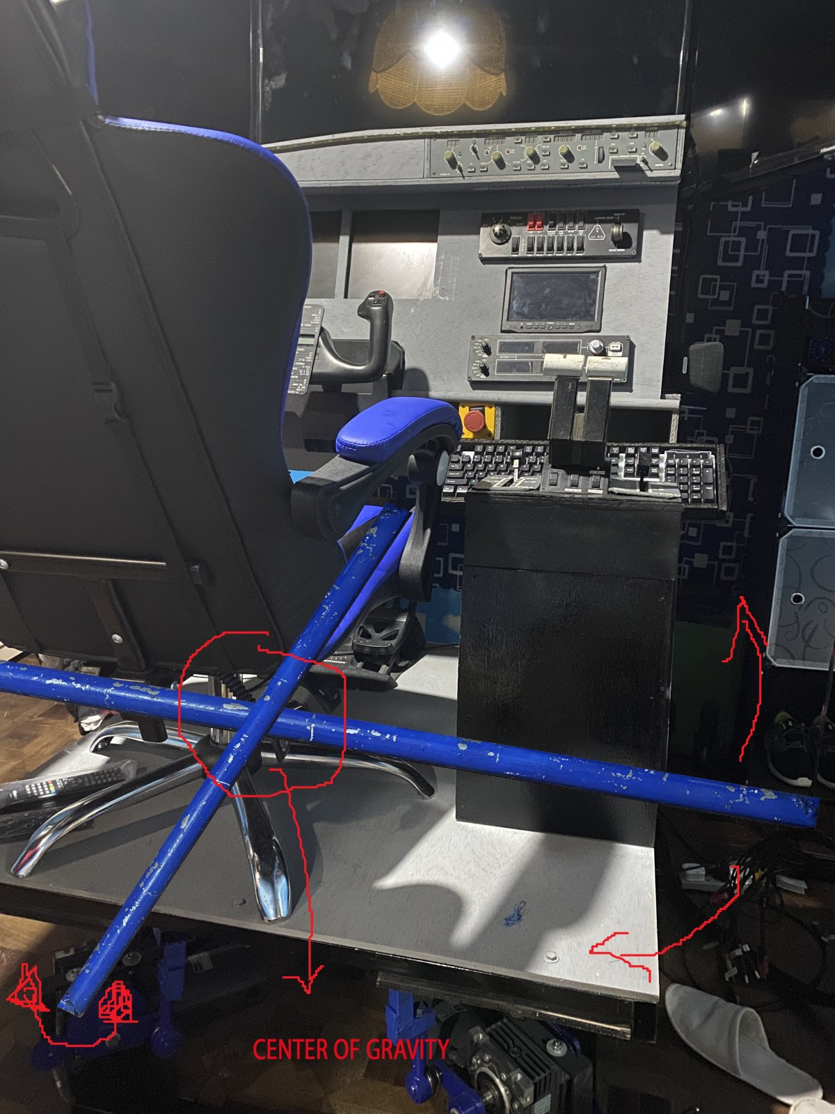

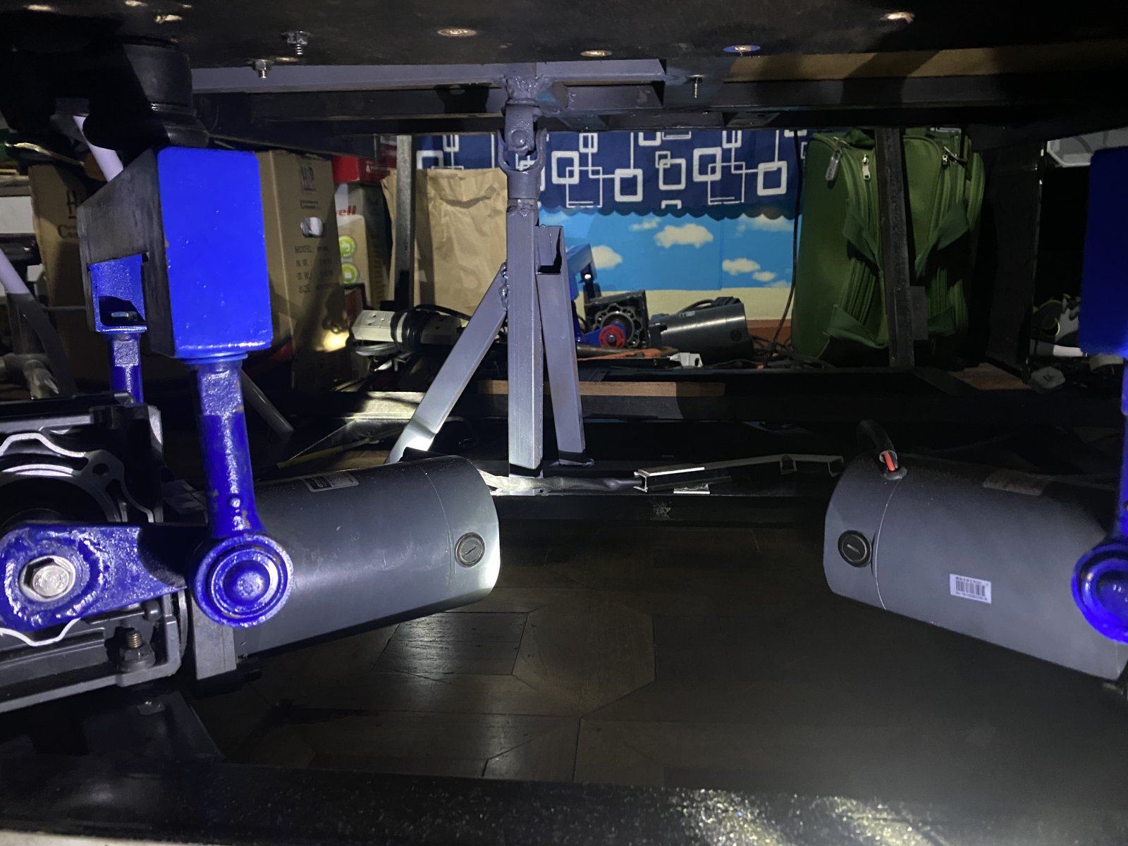

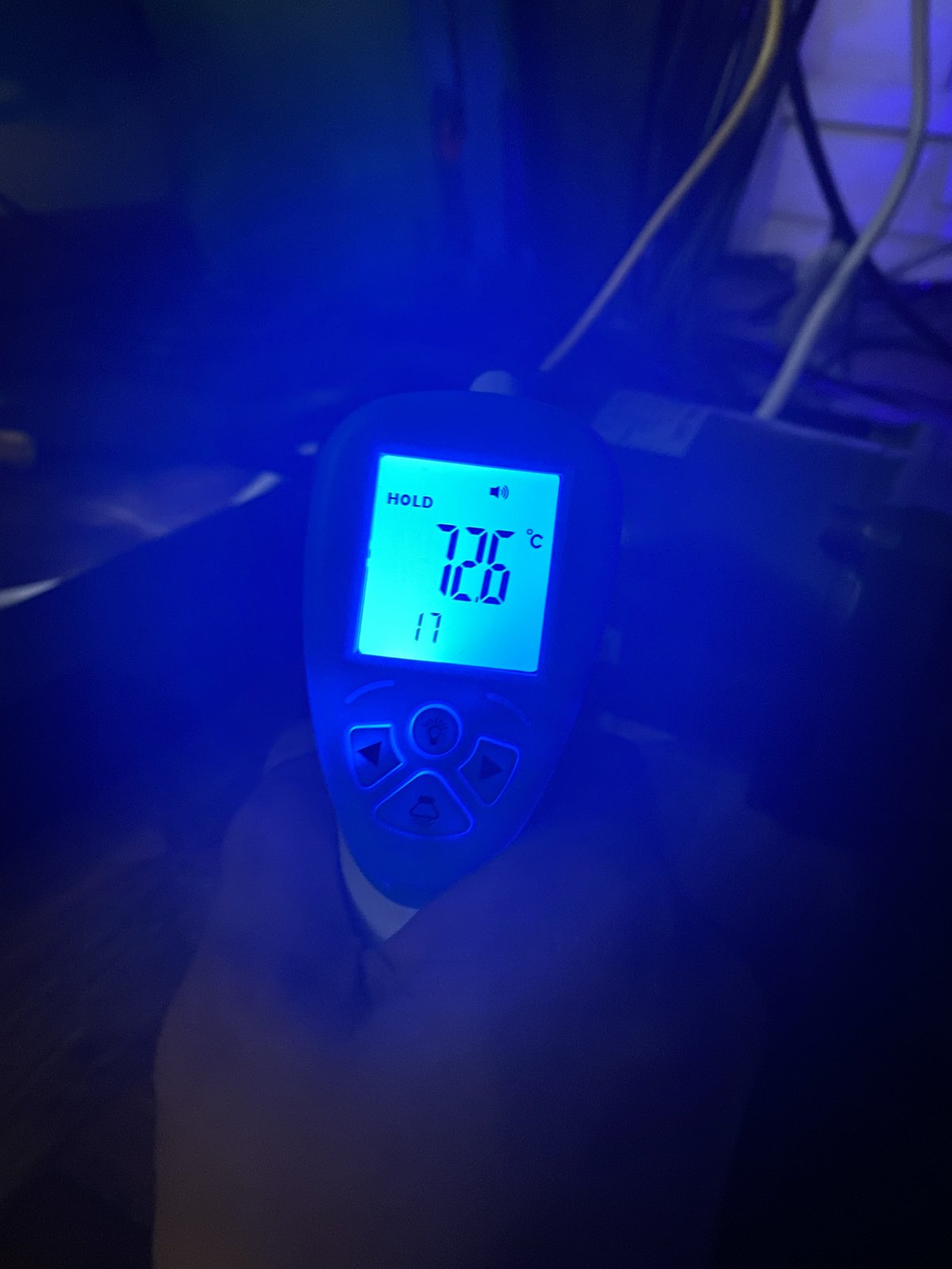

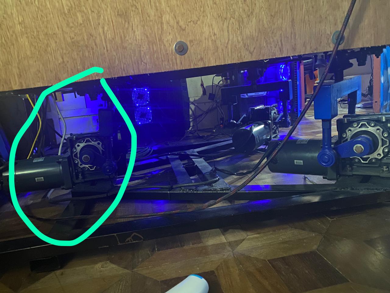

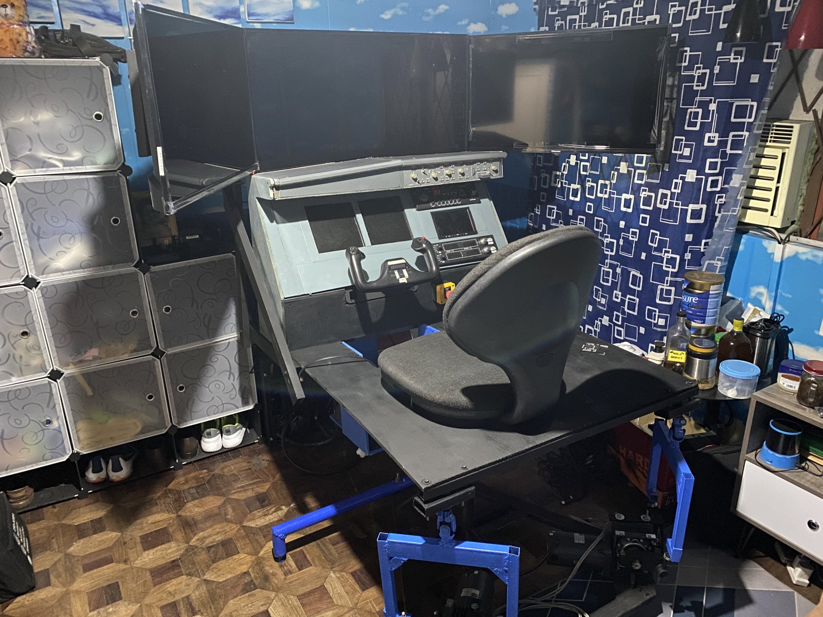

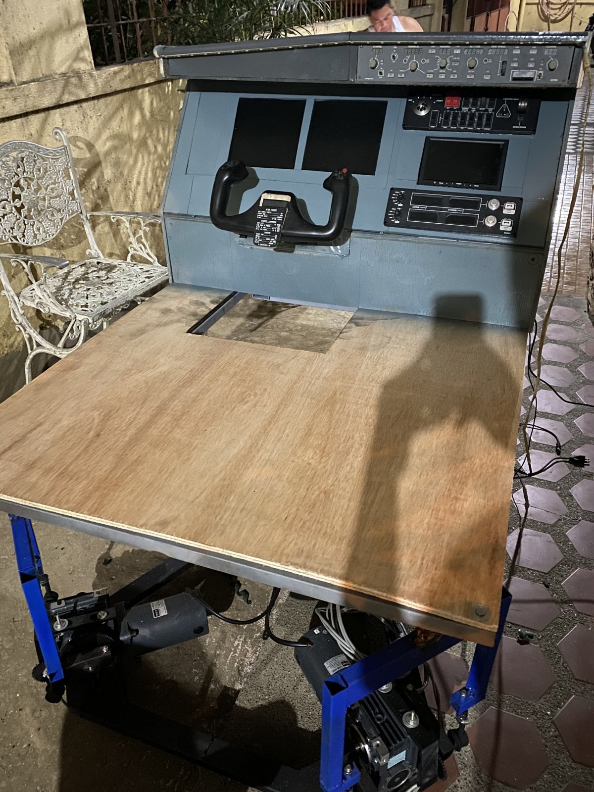

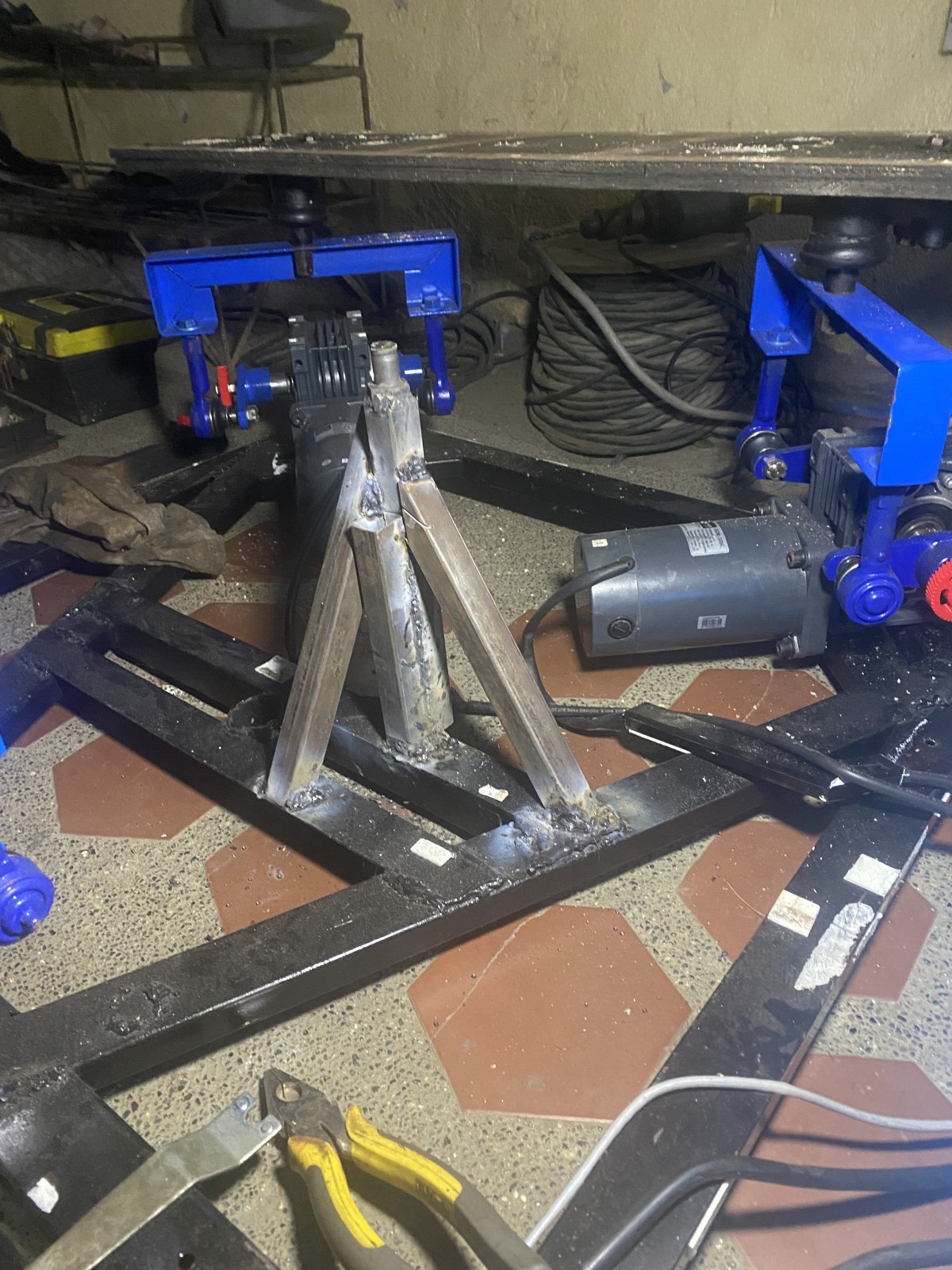

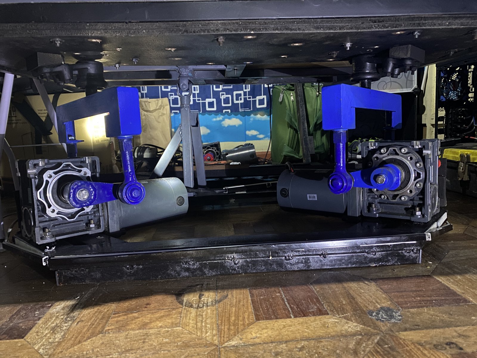

    I suggest you buy bigger motors. At first, I thought that my 3 motors can carry enough loads for my project, sad to say but the 2 motors overheat. (see attached photo).

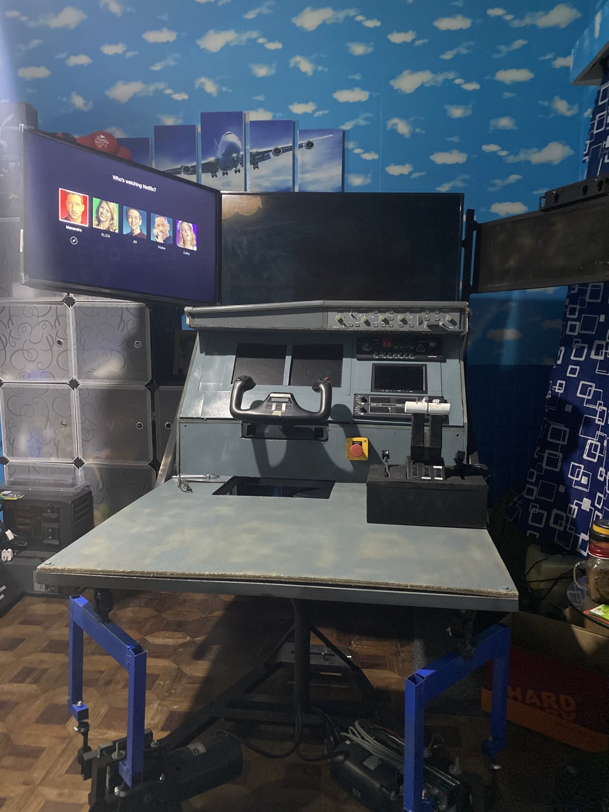

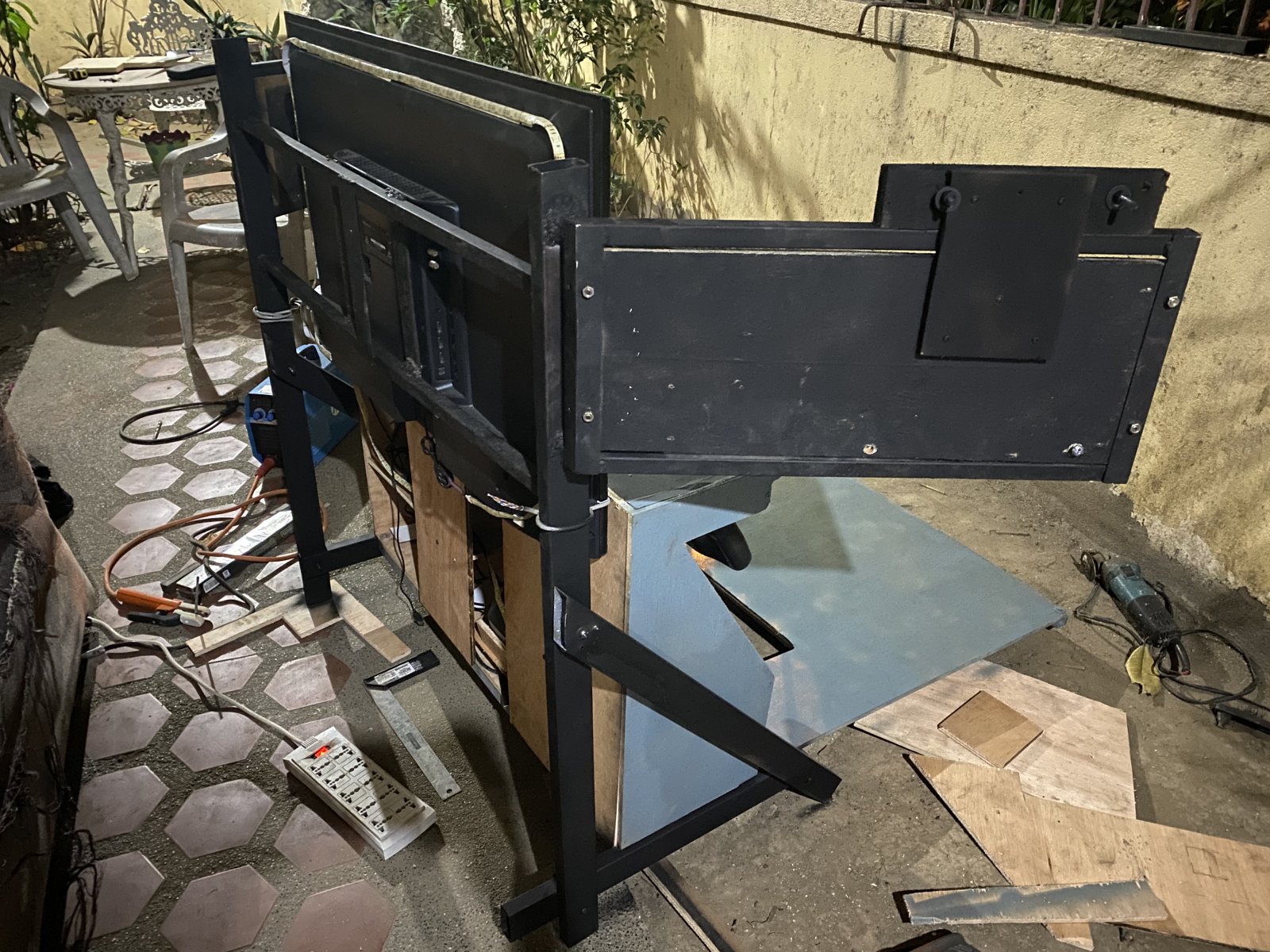

    I end up using only 2 motors and placing a bar to the center to support the weight. In my case, I find the center of gravity in my platform with all components in place including me sitting on the platform, placing a temporary round pipe underneath the platform, and a friend to help to balance my motion simulator (see attached photo). Click the link below for more specific details.
    http://www.xsimulator.net/community/threads/from-atoz-2dof-arduino-wiper-playseat.4616/#post-45417
    Also, as you can see in the platform, the center of my gravity was located a bit left portion because I was sitting on the left side while on the other side's just a control panel that not much loads to carry.
