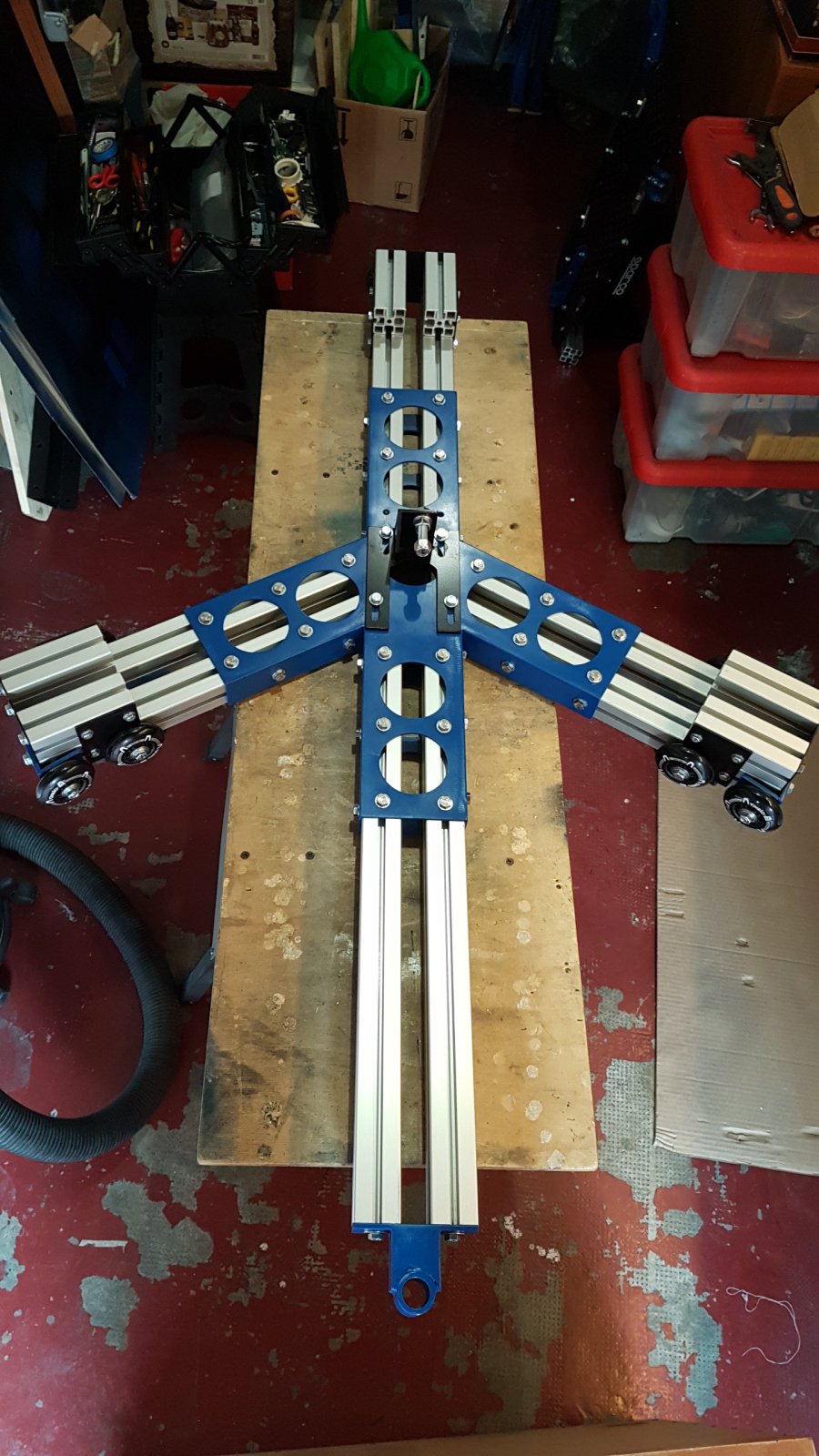

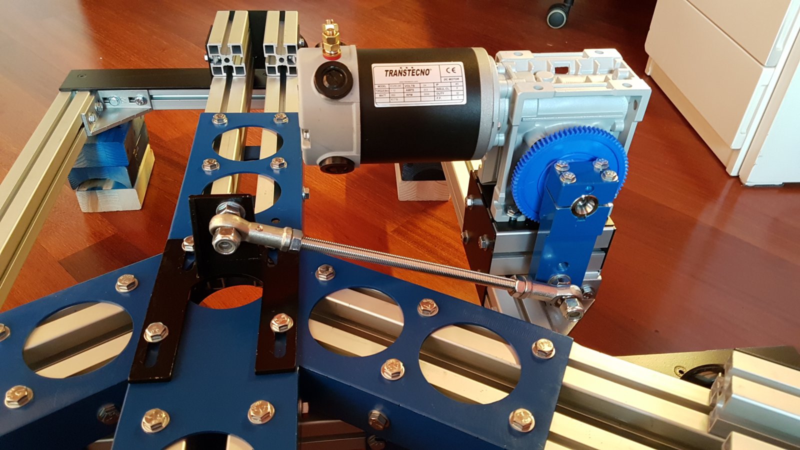

    Mobile base
    Anti-overturning trolley

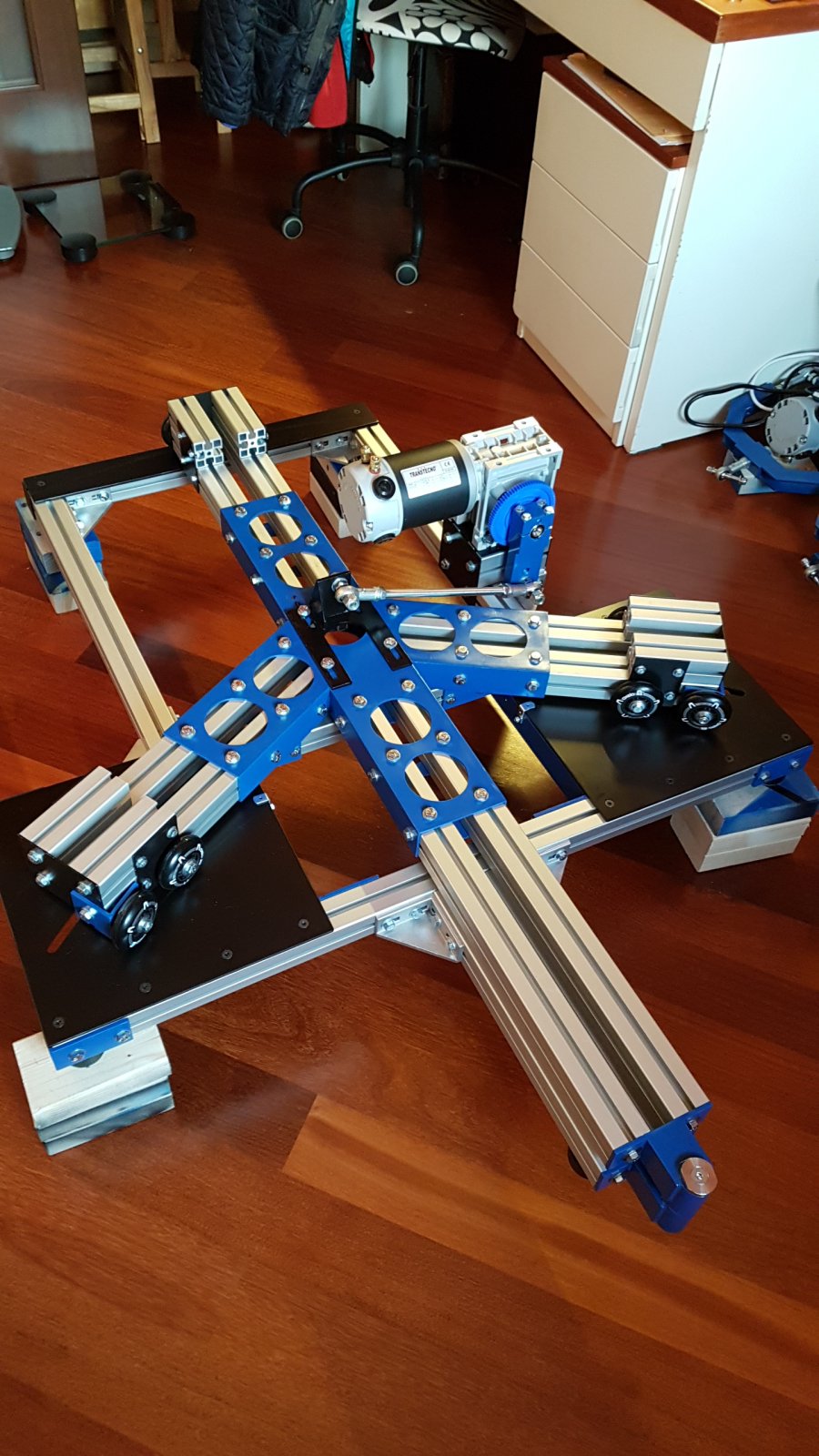

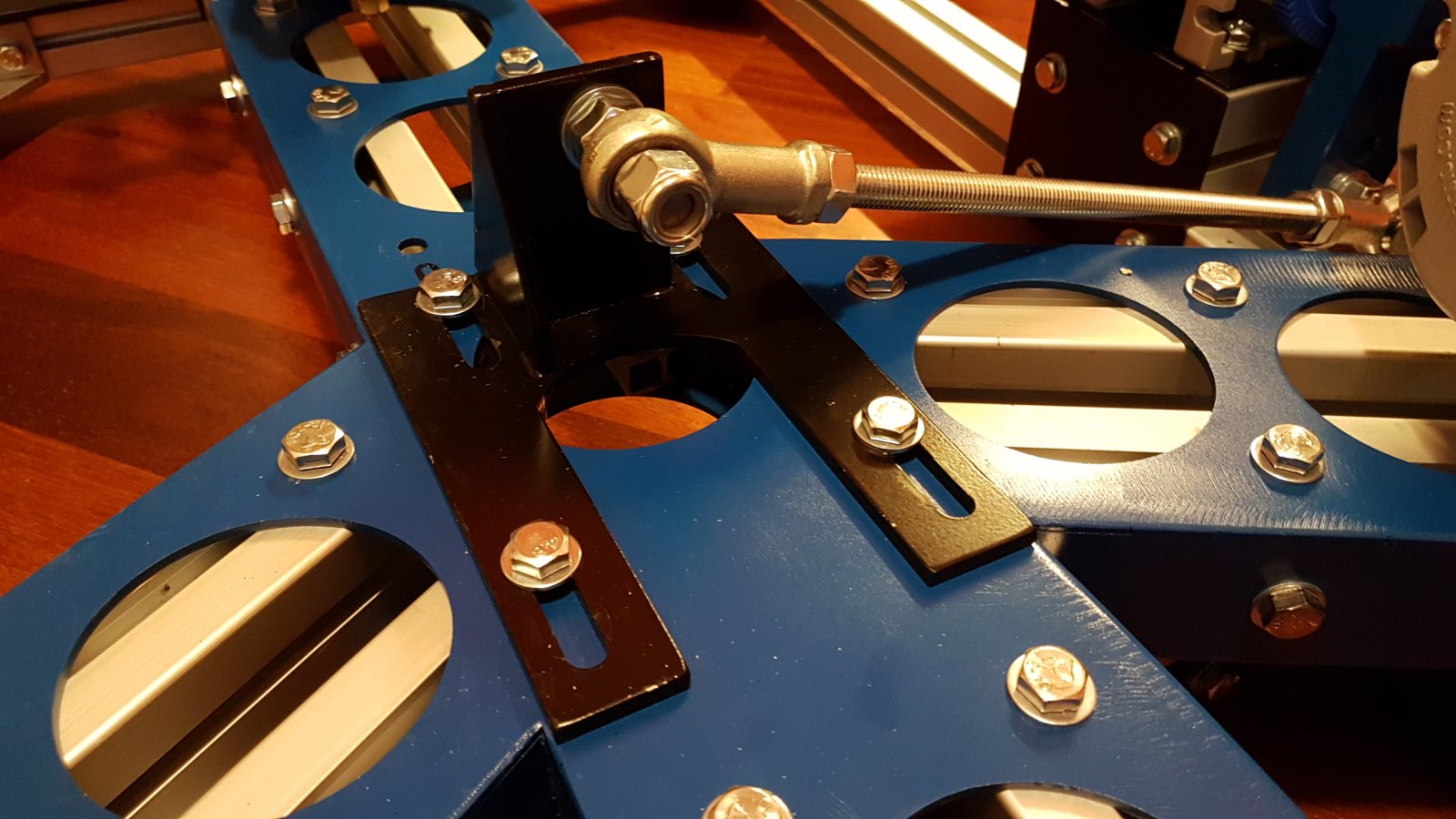

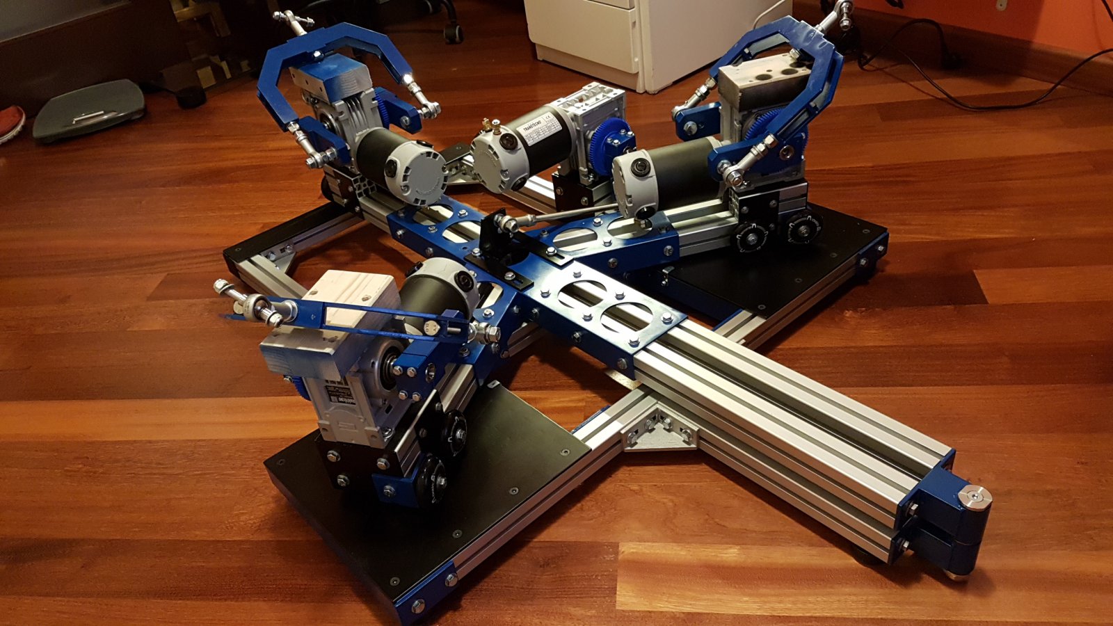

    Work progress 4DPOF upgrade
    20200116_163217.jpg 20200116_172117.jpg 20200116_163224.jpg 20200116_172412.jpg

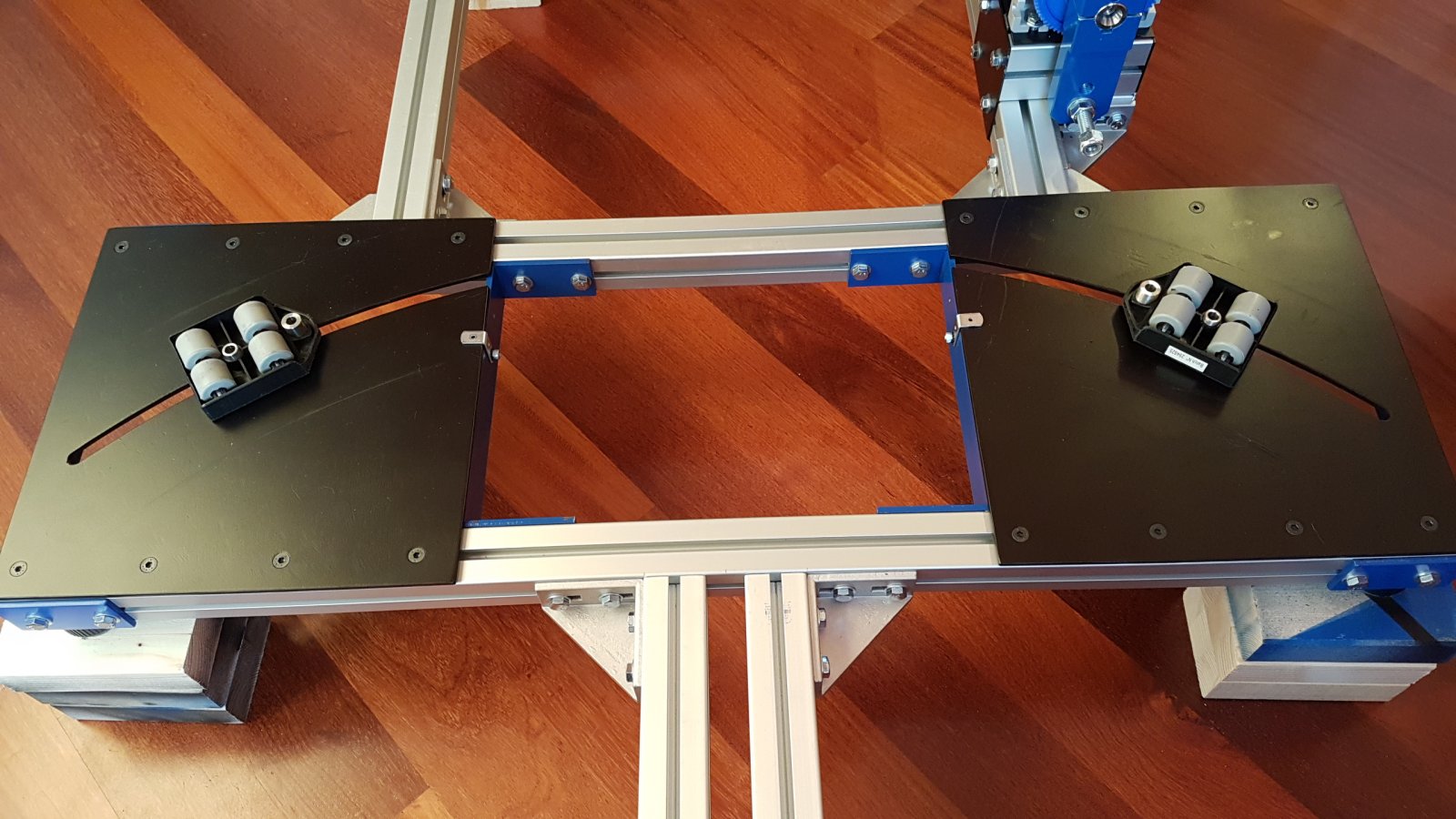

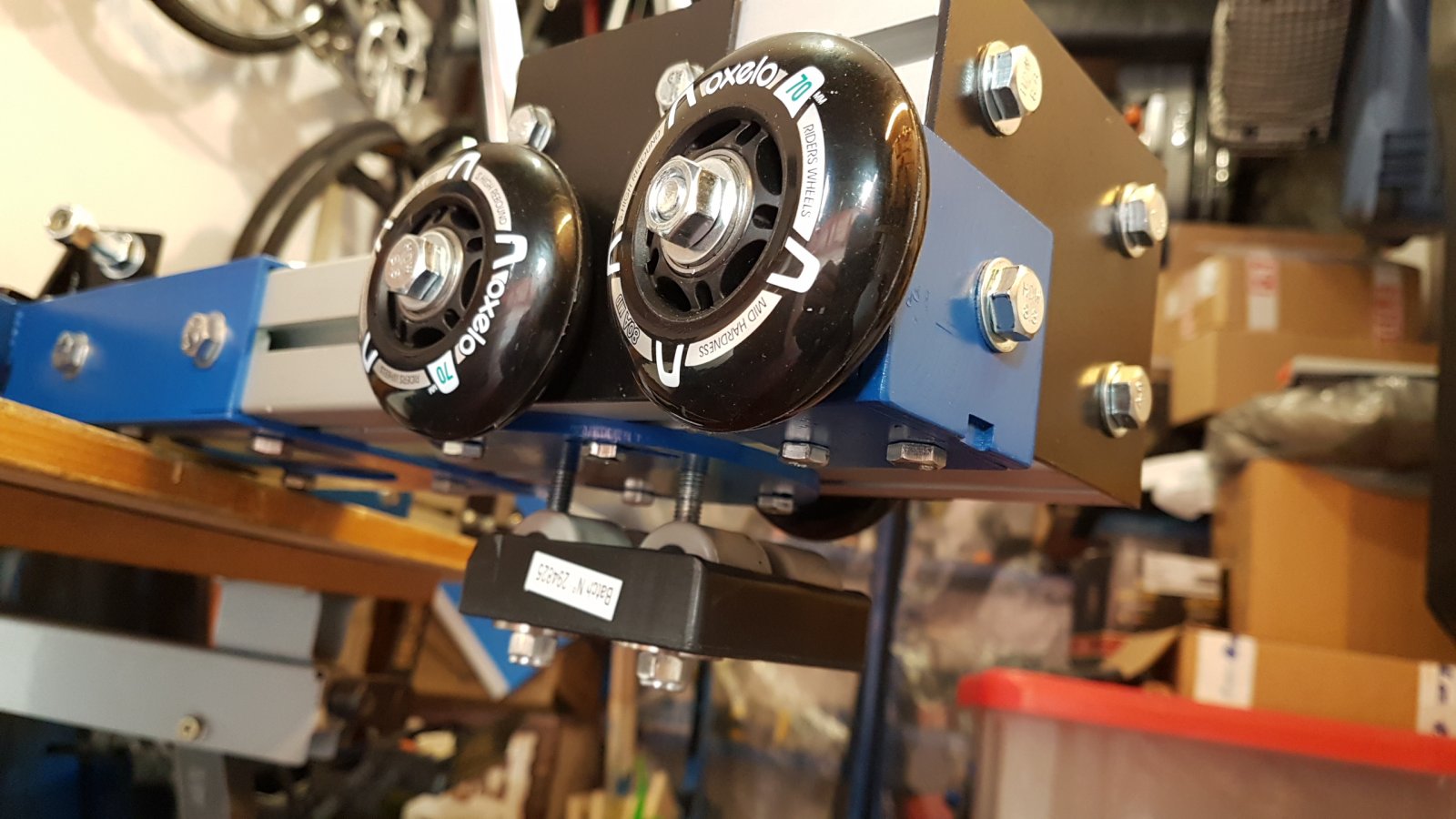

    I assembled everything and as planned, I was a little worried .... but everything works perfectly.
    the upper base is the same as 3DOF.
    I added the wheels, left and right I put as many as possible to distribute the weight, in fact 70% of the weight is placed on the side wheels.
    Under the side wheels there is an anti-overturning trolley that serves above all in the chicane when the weight moves quickly from one side to the other, see the previous video.
    The leverage of the loss of traction is about halfway between the fulcrum and the rear wheels, the total travel of the liva corresponds to about 14 cm of rear movement.

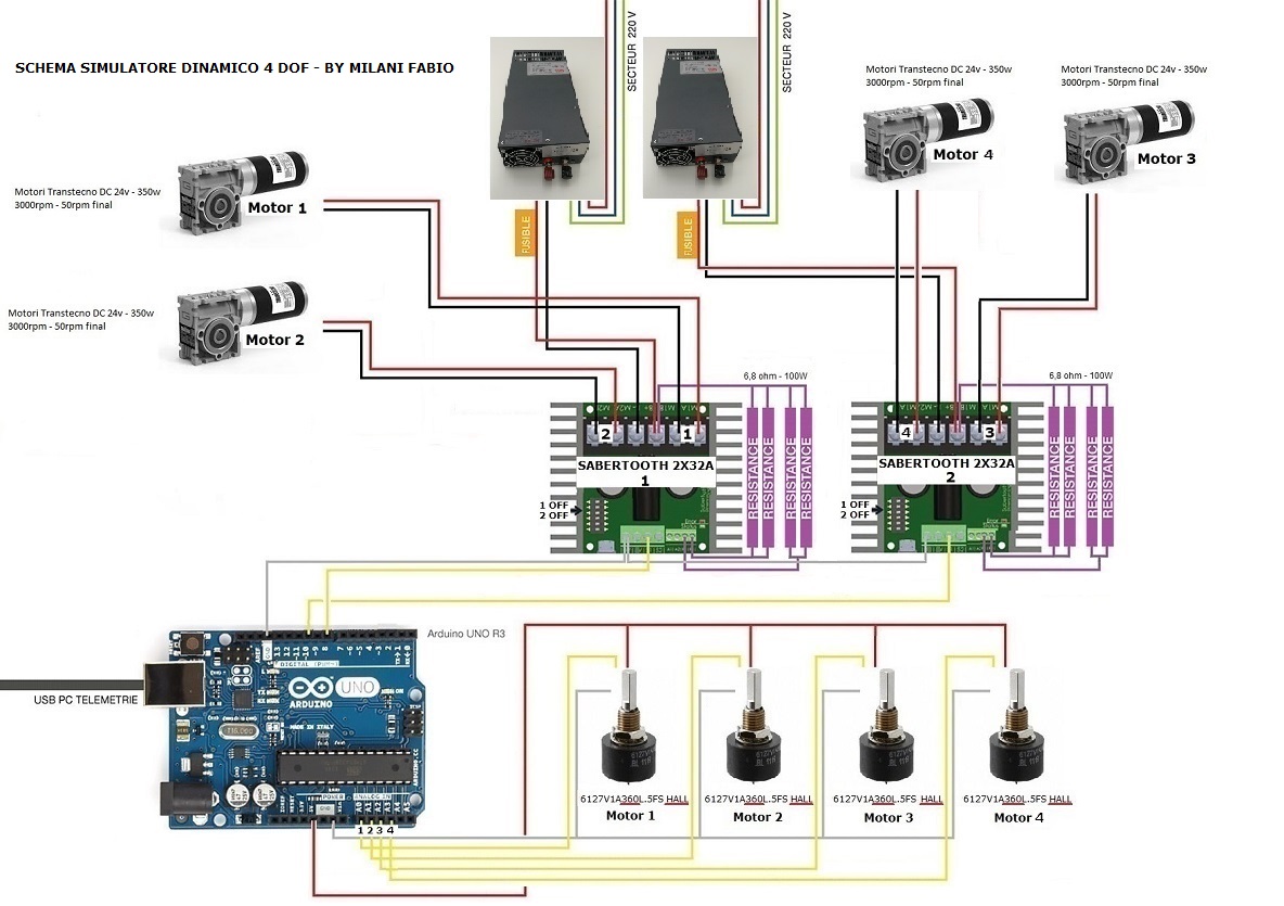

    For a good reading I recommend these hall effect potentiometers with 360 ° reading 6127V1A360L.5FS HALL
  15. Milani Fabio
    Milani Fabio Active Member
    Feb 21, 2019
    105
    Italia
    720Coins
    +74 / 2 / -0
    Update scheme 4 DOF Milani Fabio

    Hello Fabio. I am building a very similar motion sim as you did. Difference is I'm using 4 Cytron 30 amp motor drivers with 4 power supplies. Im wondering if I should go with 1 or two Arduino boards? What did you use for programming? Very nice rig by the way. Any help would be greatly appreciated.
  19. Milani Fabio
    Feb 21, 2019
    105
    Italia
    720Coins
    +74 / 2 / -0
    Hi Hale,
    I don't know the Cytron 30 A, I used 2 Sabertooth 2x32 A which control 4 motors, because each sabertooth can control 2 motors.
    So I connected 4 potentiometers to arduino uno
    If I wanted I could put 4 sabertoot for 4 engines, so I think you can connect 4 Cytron ..... but better informed ...
    For the arduino code I used the @Wanegain ..... you have to ask him.
