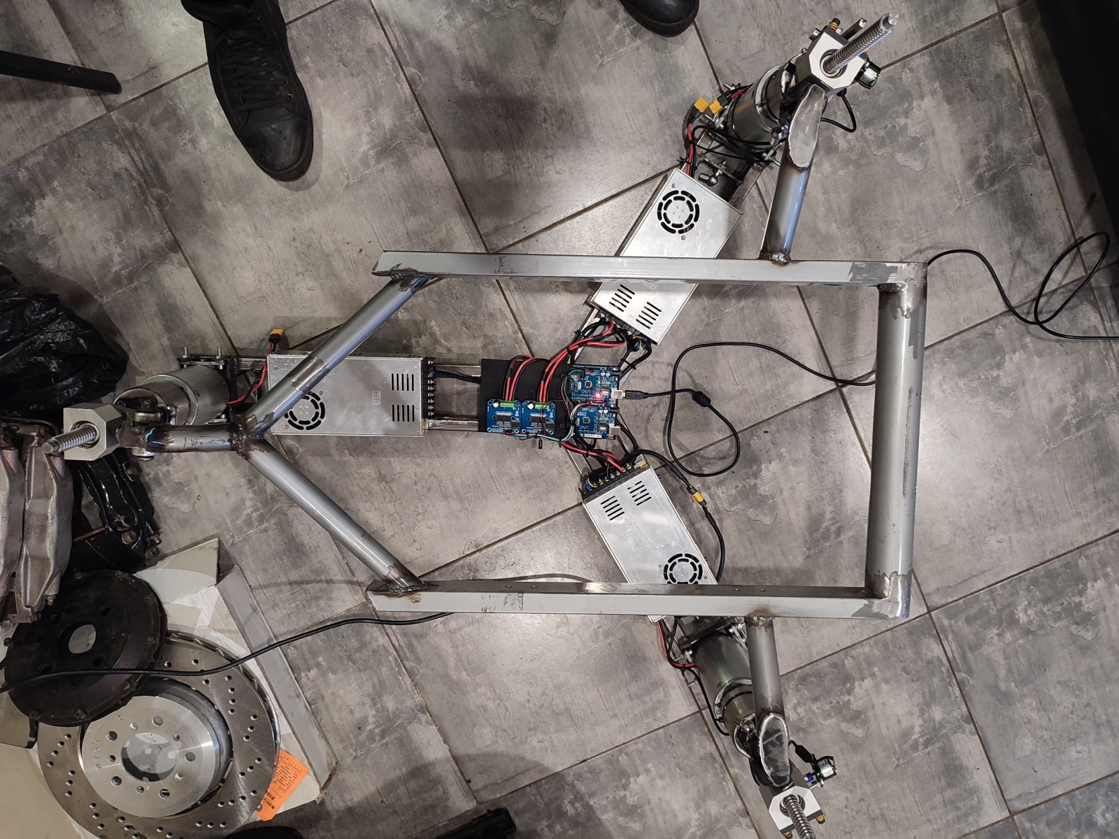

    It's alive !!!
    And working not bad
    Put my legs to add load )

    Your rig certainly looks fast enough :thumbs

    Looks like T800 without flesh :)

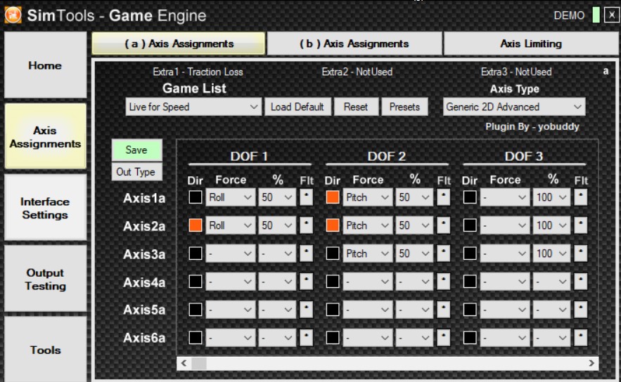

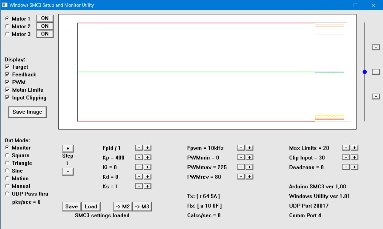

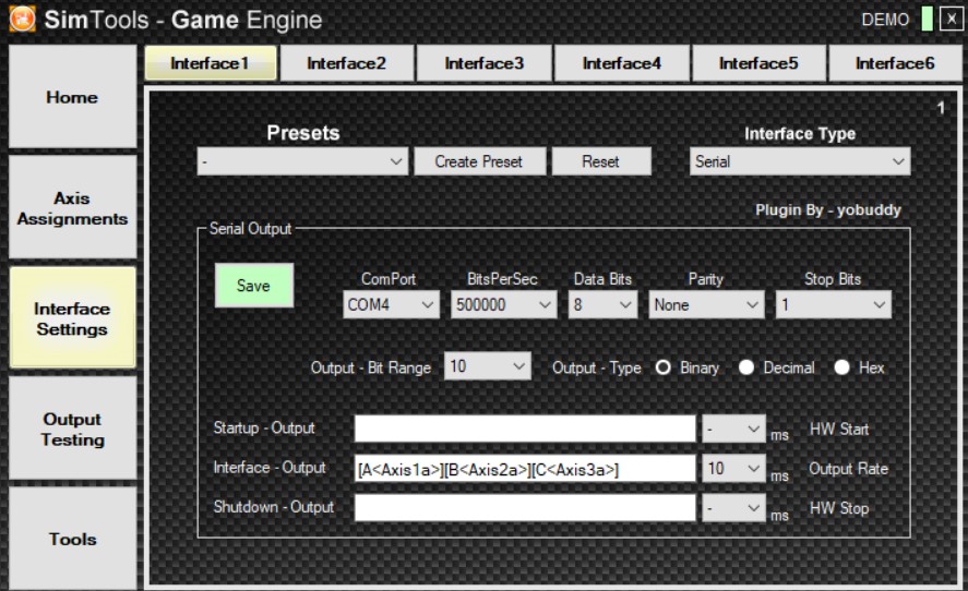

    So, there is a problem - everything is fine and smooth in SMC3 utility, but in SimTools something goes wrong:
    1. After launching Simtools all motors going lower simultaneously - about 40% of all height
    2. In Output Testing everything works, but jerking a lot

    Yes
    Settings SMC3:
    Settings SimTools:
    Video SMC3
    Video SimTools:

    For language - Simtools and LiveForSpeed works with motion, but jerking.
    I will try to change language, ok )

    New question - there is a very little movements in LFS - is it ok ? About 10-15% of rig's ability
    In Output Testing it works for whole range
    Update: in rally-cross it is ok ))))

    Axis allocation is only part of refining a motion profile, you also need to first capture then refine the Tuning Center values, see the motion profile tuning tips in the FAQs, and take note of first doing one axis at a a time, then combine and refine: https://www.xsimulator.net/community/faq/steps-to-create-a-motion-profile.228/

    After language change it works like a charm, God bless you ))

    That has been a pesky Windows rather than SimTools bug, that only seems to affect some computers in specific circumstances, and it has been difficult to pin down why, but at least it is a simple fix and I very much look forward to seeing your rig in action.
