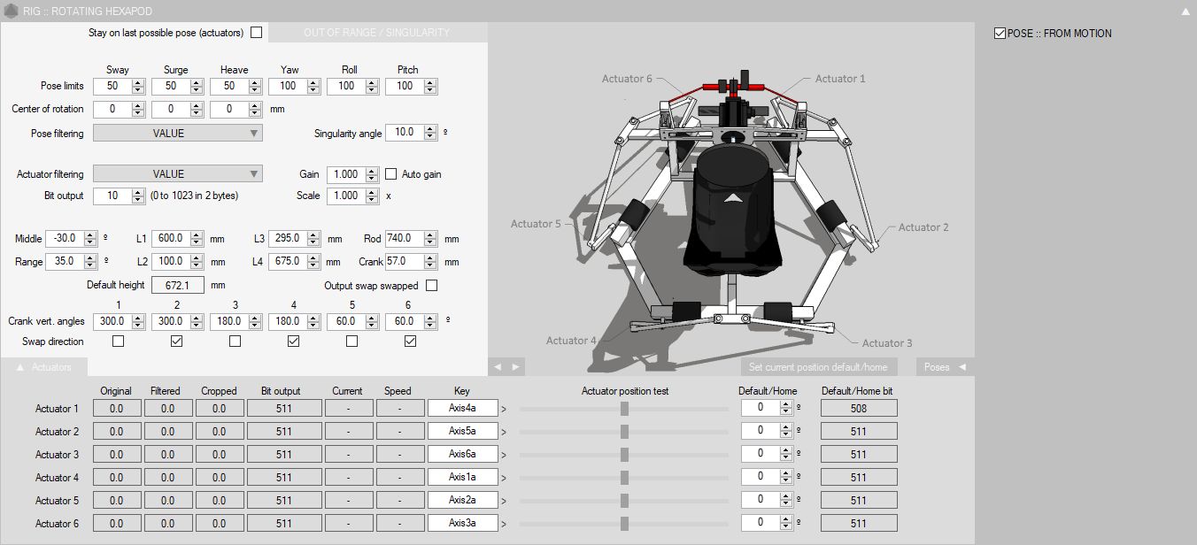

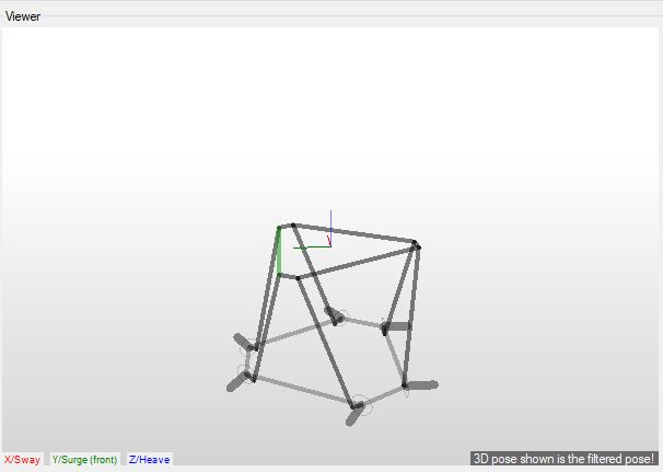

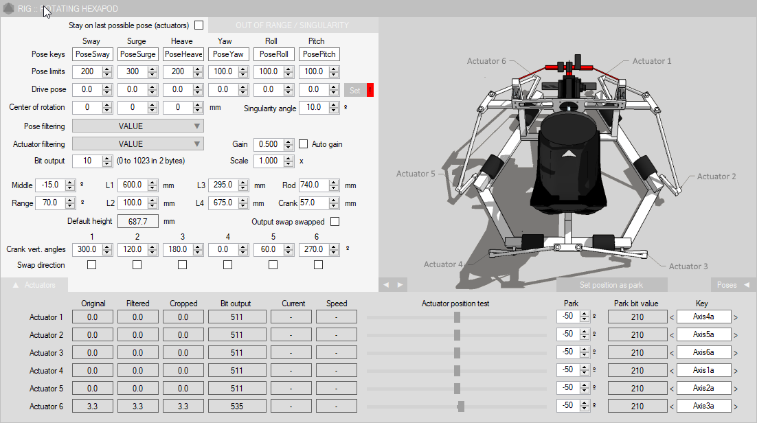

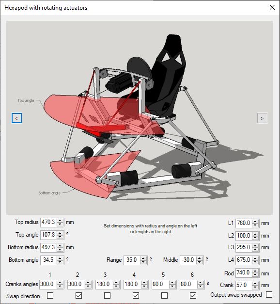

    Hi
    i got the rig running, but everything in wrong direction.
    If i turn the heave slider to the left in FlyPT-Hexapod the rig is moving down
    If i turn the heave slider to the left in FlyPT-Mover the rig is moving up.
    But both use the same settings.
    3d looks also the same and shows the correct movement:
    FlyPT-Hexapod:
    FlyPT-Mover:
    When i use "output swap swapped" it moves yaw instead of heave.
    @pmvcda Can you help me please?

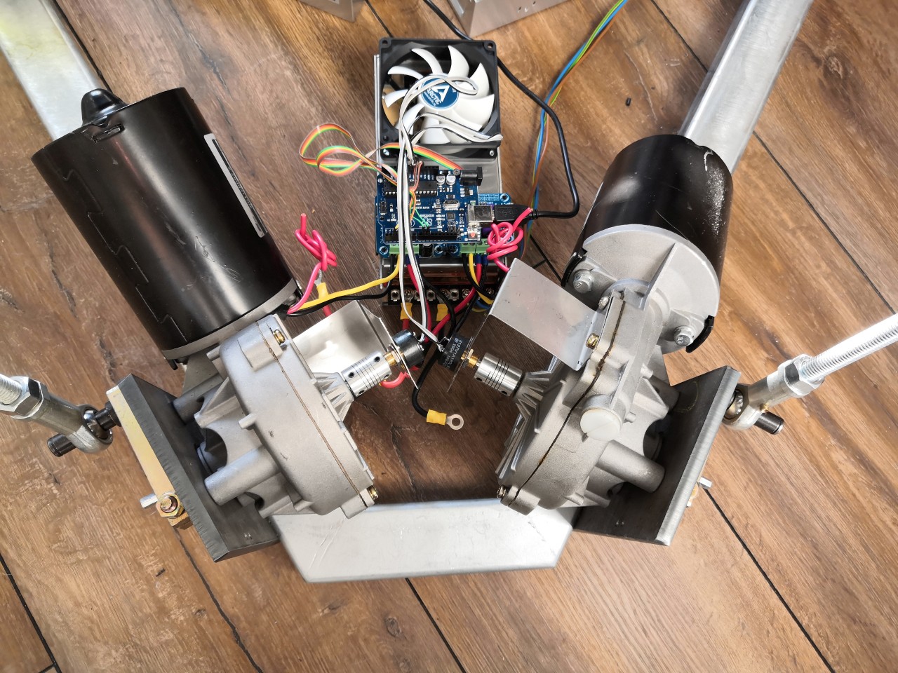

    the Problem with the wrong direction is found.
    I use 180°-hal-poti with 5V output instead of normal potis
    This hal-potis have one big disadvantage: you cant change polarity by switching GND and +5V
    So they only work correct, wenn you put them in the front of the motor.
    I placed them in the backside and so they give back the inverted direction.
    No idea how to solve it in hardware.

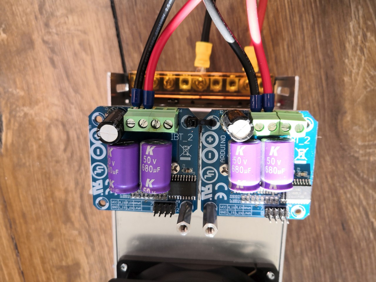

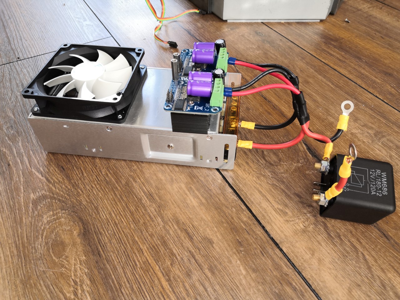

    I optimized the harness of the motors.
    its now ~30cm shorter and 6mm² instead of 4mm² between PSU and IBT_2
    I also prepared the harness for the super-caps and attached 12v 100A relays to shut off the super-caps
    Now it looks like this:
    IMG_20200422_184752.jpg IMG_20200422_184824.jpg IMG_20200422_190221.jpg IMG_20200422_190235.jpg
    In the first test-movement still without the super-caps i was very positive impressed.
    No stucking or overcurrent.
    It will hopefully work nearly perfect with the assambled super-caps.

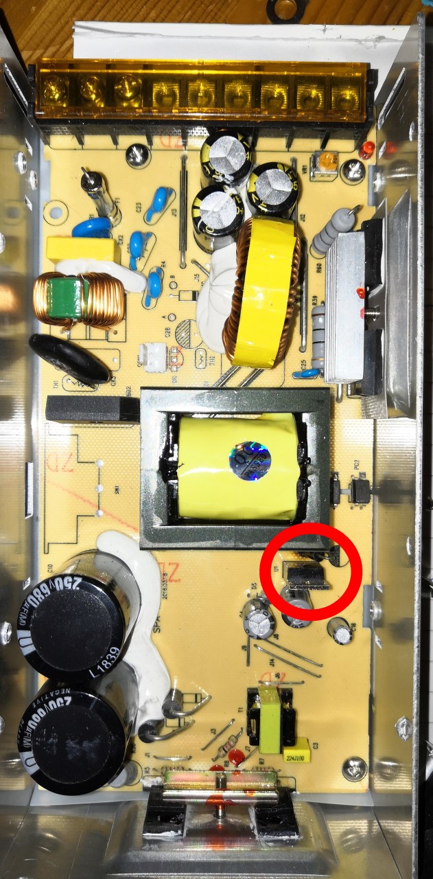

    FU*K
    I killed one PSU
    I was testing and playing around with the SMC3 software workaround for the inverted problem, so I disassembled the arduino.
    Unfortunately I accidentally put the ardunio on the fan of the PSU.
    Because of this the PSU got no more ventilation and smoked up.
    New PSU is ordered and will be delivered hopefully today
    regards
    Peer

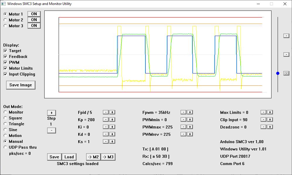

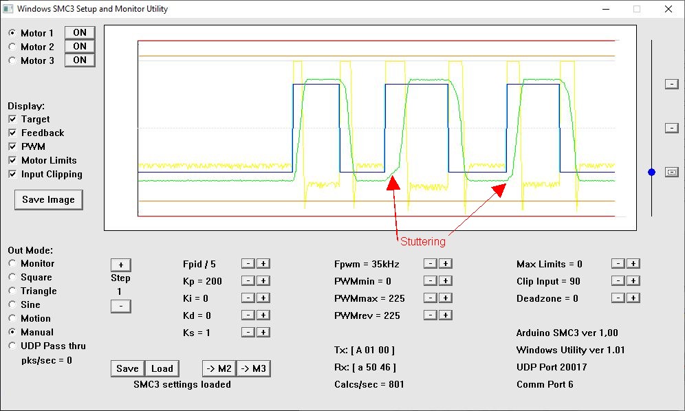

    The new PSU was delivered today and modified in 20 minutes
    The new harness needed a bit more time.
    But now i can switch on the caps to see if there is an improvement or not
    And? YES it´s a massive improvement.
    It fells like 10-15% faster, but most importantly, it no longer stutters.
    Here you can see the different just in SMC3:
    Without caps:
    WITH caps:
    As you can see at the green line (feedback) it is realy much faster and also there is no stuttering anymore.
    I´m really happy with it.
    But you have to be careful: The CAPS need a lot of current to fill up.
    it takes about 10-30 seconds. I can see it at the fan of the PSU.
    If its running with normal speed, the cap is fully loaded.
    Next step is to improve my mover settings.
    c u soon

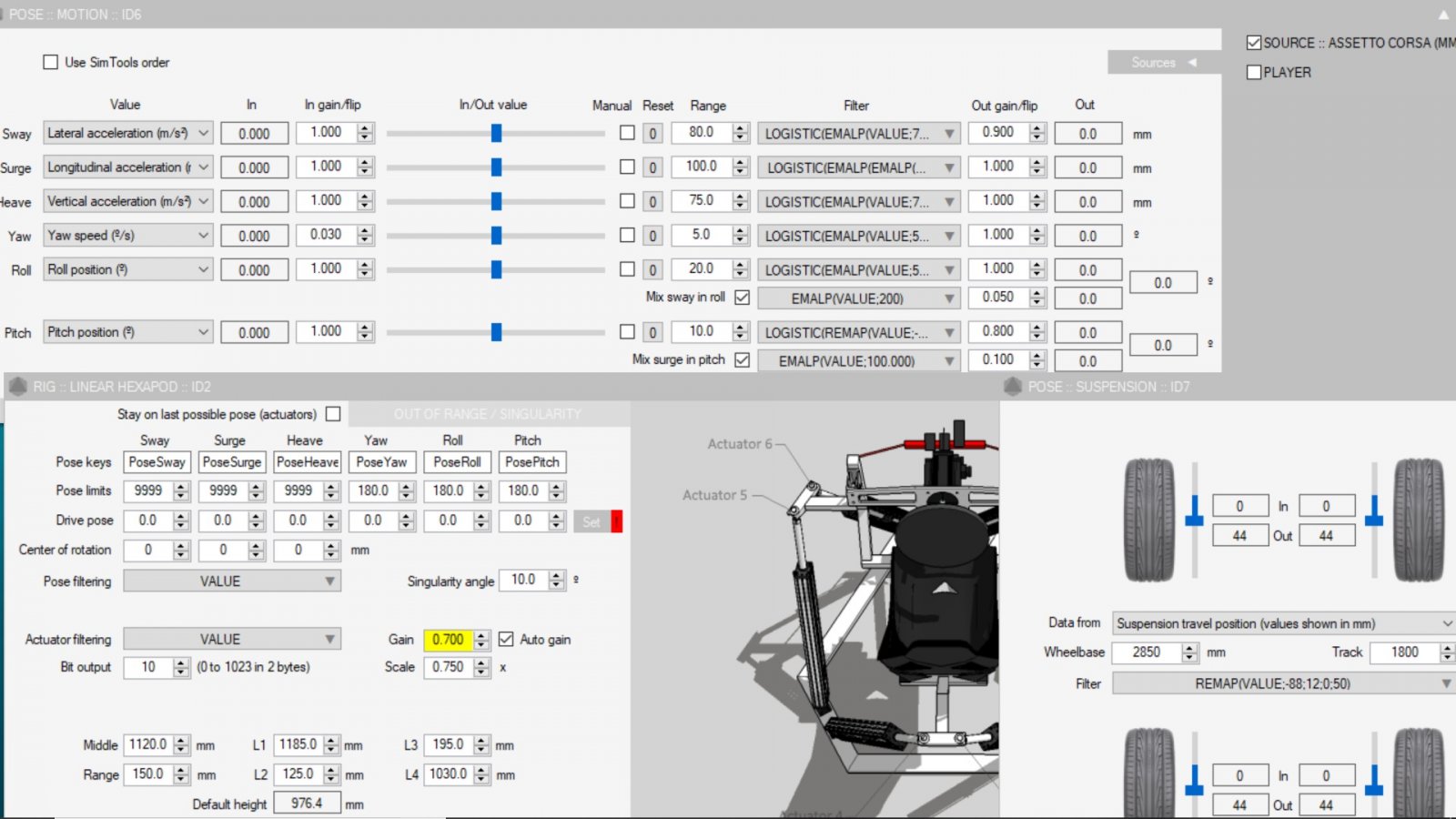

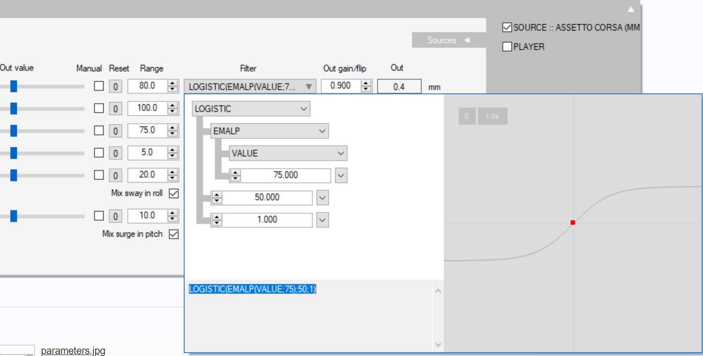

    If I may, I recommend for your filters in Mover to use the Logistic and the Emalp in cascade.
    The Logistic clamp the max value.
    The Emalp filter the high noise.
    Knowing that would have saved me a lot of time.

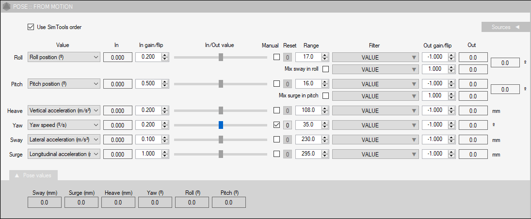

    Here are my actual settings in FlyPT-Mover:
    You can see: No filters at the moment
    Thanks in advance
    Peer

    First, make sure you have the right dimension of your rig entered into the mover diagrams.
    Now, you can go here for a way to calibrate the option Scale in mover. Notice that in Simtools, I do not put my actuator limitor to 70% anymore. I put 100% and reduce it in mover now. You can now use Mover instead of Simtools to test your maximum heave, by grabbing the blue scare in the In/Out value of the Pose window.
    6 DOF from scratch
    Once you are at the right scale. You decide how much distance each forces can travel. For me, it was trial and error. Sometimes, if you give too much distance to too many forces, you will reach your max distance rapidly, because they add together.
    For safety, start with a low Gain (in the Hexapod window) and remove Auto gain. I'm not sure if it can add gain or not. Put it back after to limit big inputs. You add Gain slowly while testing until you get your max.
    Filters: There is a manual in the download. Look at it. It gives many good advises.
    What you get from Mover is a Value. The filters will influence that value. So, you put it inside a filter and change parameters to influence it. Example with Assetto Corsa:
    I have the force sway that stay at 0 for 99 samples and goes to 100 at this sample. My VALUE is inside a EMALP with the parameter 75. It looks the 75 last samples values (0) and this new one (100). It makes a average and you get around 2 or 3. That slows down rapid changes. If you put only 10 as a parameter, it will change fast; 500, it will go slow. And that is the value that is send to your motors. But before, I put it inside another filters (LOGISTIC) that will smoothly clamp the value to 50 with a curve, if the value goes that high. The clipping value depends of the forces send by the game. The parameter 1 affect the shape of the curve.
    That's my way of doing it. There must be many others ways, with so many types of filters.
    Right away, I would like to say that I never found a satisfactory way to have a good acceleration feeling, and a limited force in crashes. I have to compromise my acceleration so I don't destroy my rig on crashes.
    For the suspension, it is a bit weird. I use a Remap (-88;12;0;50). It put my suspension to the middle, but my front and back are not at the same height, so that was my compromise. When the input is -88, the ouput is 0; when the input is 12, the output is 50. At first, the last value was 100, but I reduce it to 50 because the suspensions was making my rig move to strongly.

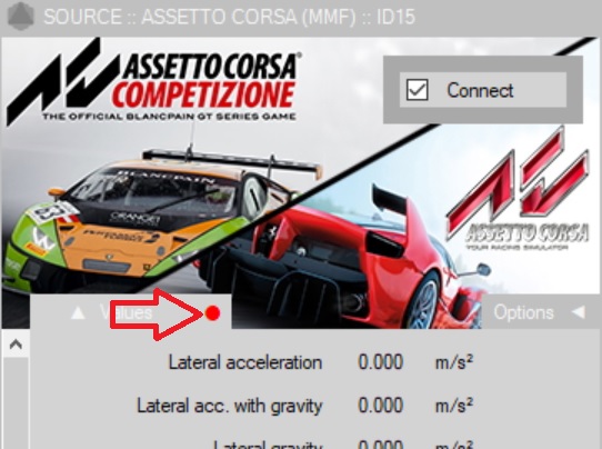

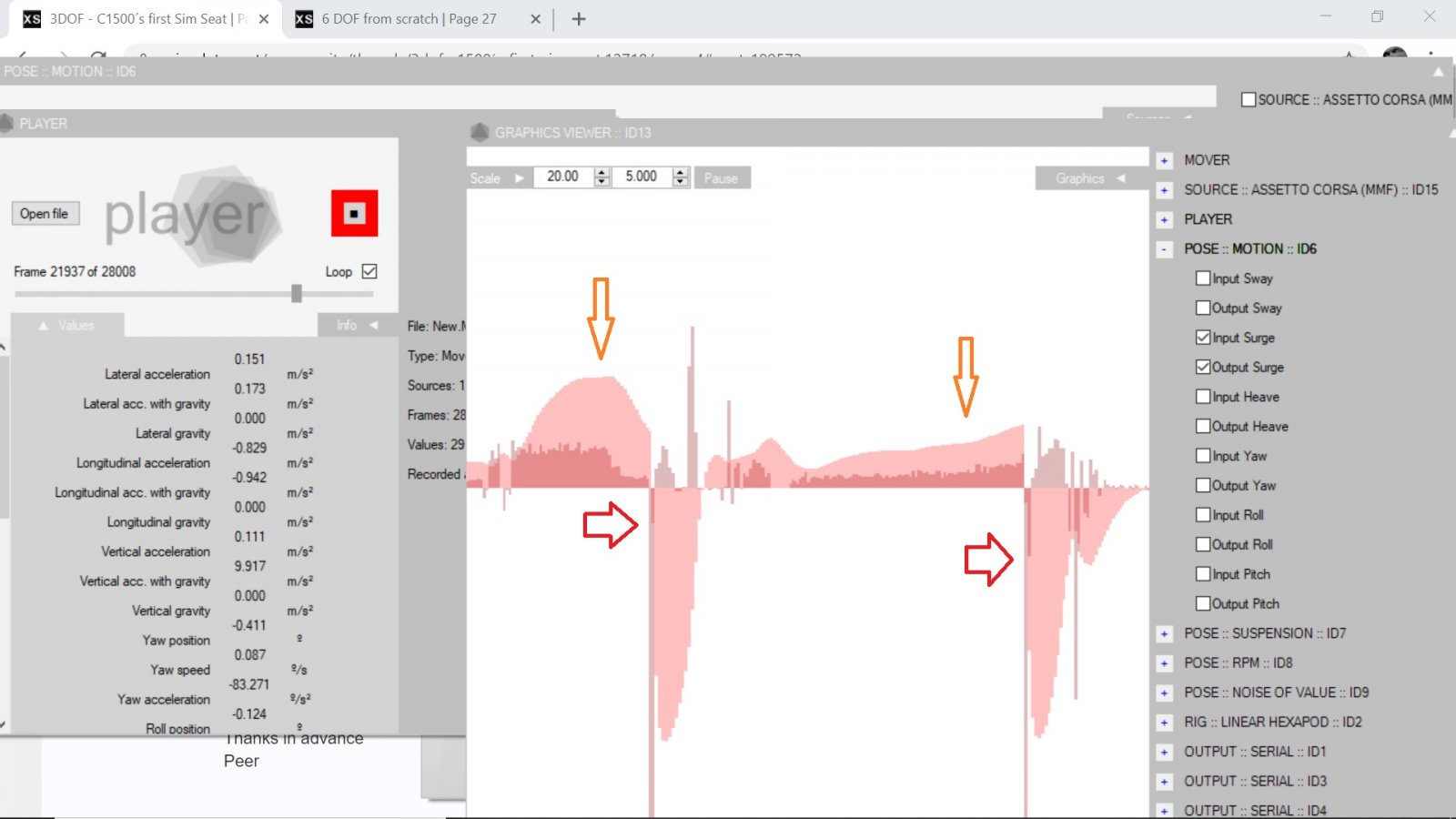

    You can record a run with Mover by pressing the red dot here:
    You can then use a Player Source to load the file and drive your Hexapod in Mover with it. Nice way to test. Then use the Graphics Viewer to compare acceleration with crashes, and the results of different filters.
    There you go. I hope it will help you.

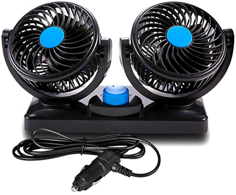

    I also tried a lot of fans for the wind simulation.
    Some 12cm som 14cm case fan, but nothing makes me happy.
    Then i found these car-fan on amazon:
    They cost only 13€ and lock like this:
    Now they look like this and are working perfectly:

    It would be great to see a video of the fans in action, when you get the time, to get a better sense of the air volume they put out.
    Here is an link to the 12v dual fans @C1500 is using, for anyone who is interested:
