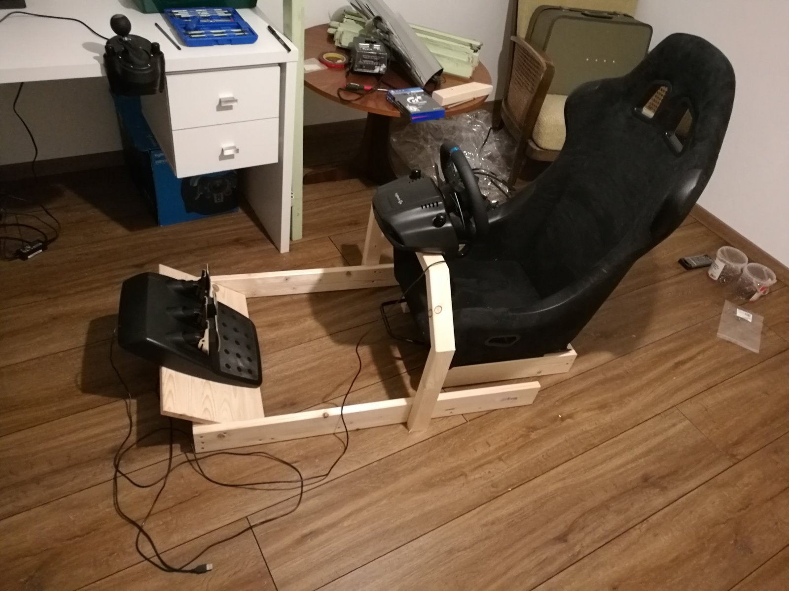

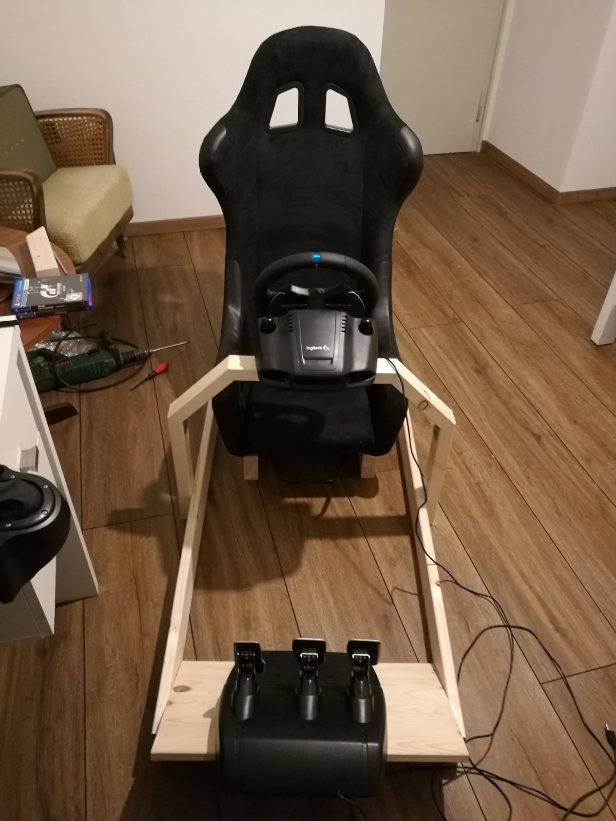

    Last winter i build my racing seat with normal light wight car-seat, a Logitech G29 and a lot of wood ;o)
    It looks like this:
    It makes a lot of fun to drive GT with VR on the PS4 but i´m missing the motion a lot

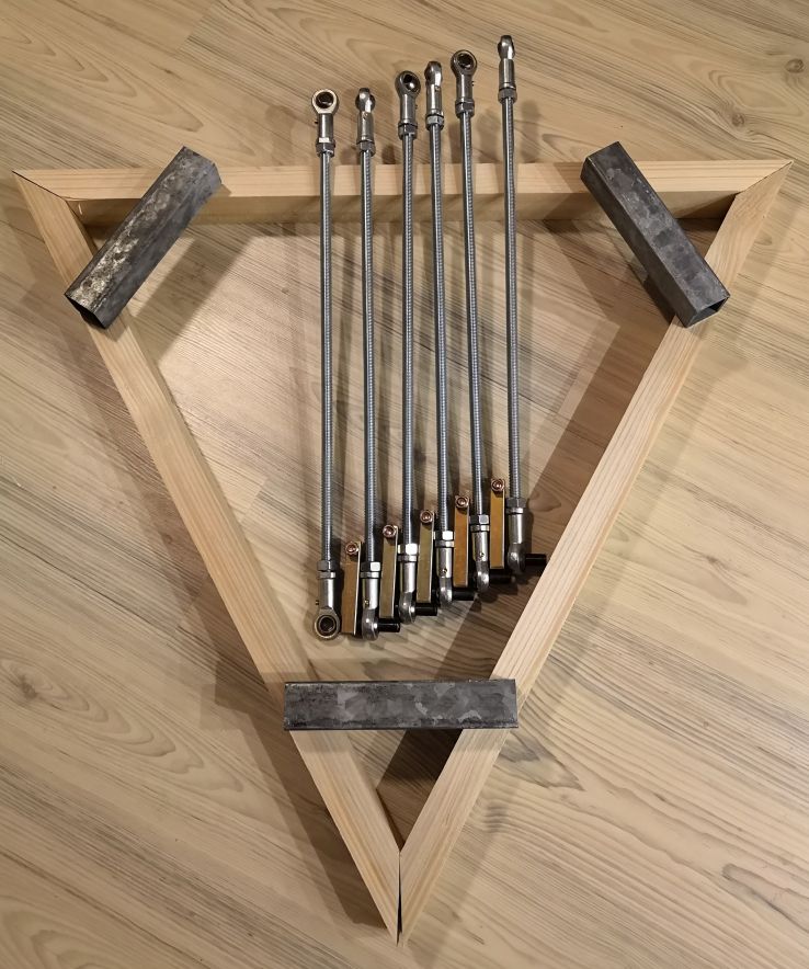

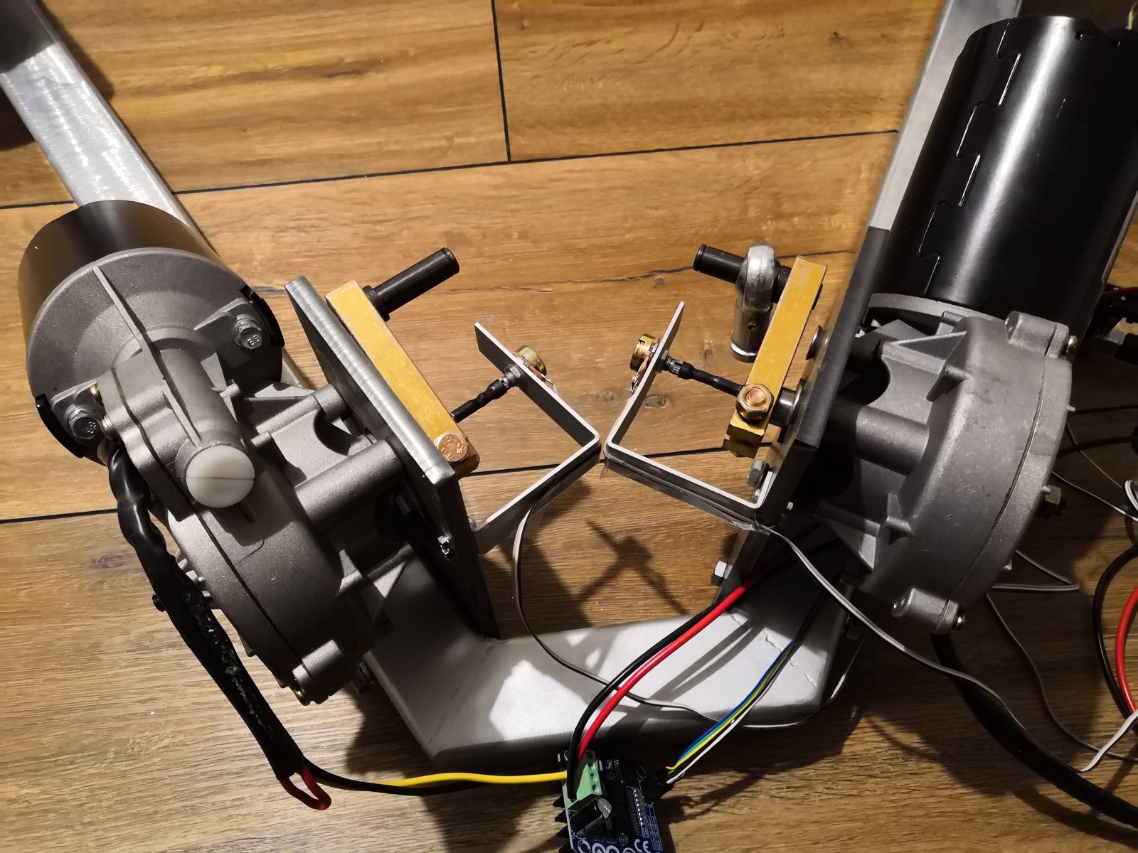

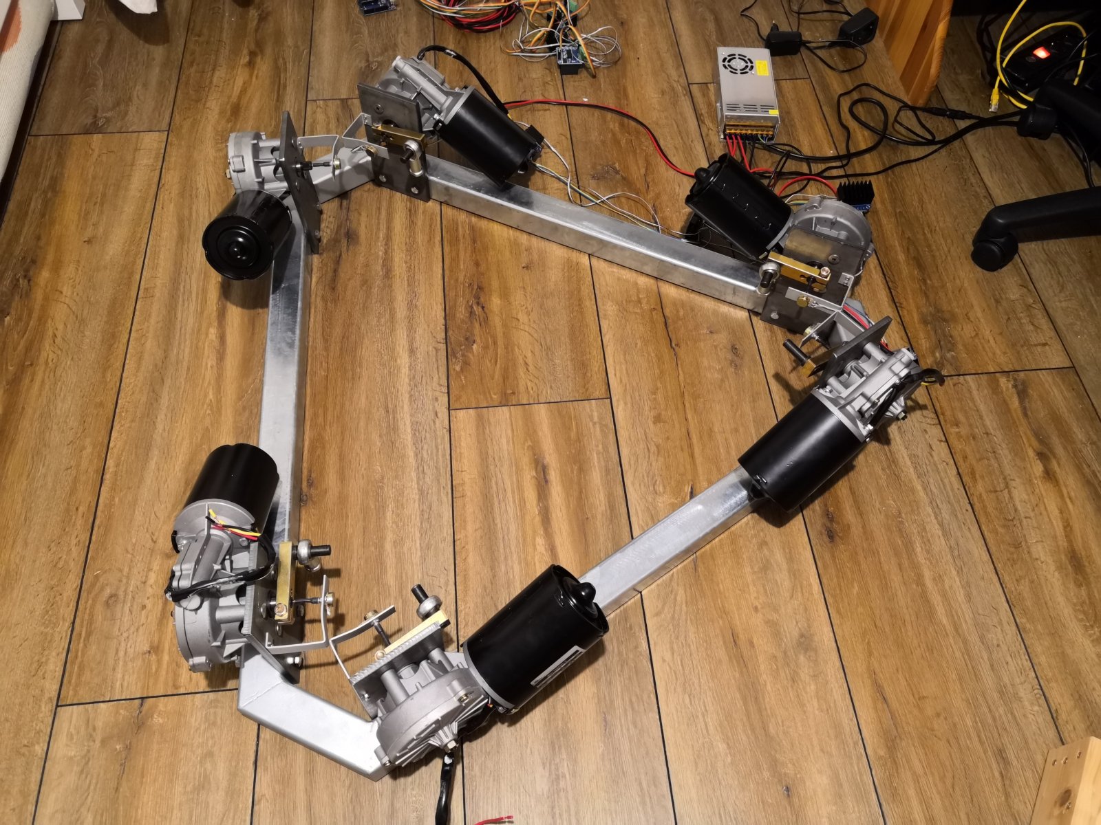

    Hi
    here is another update from my 6DOF construction.
    I ordert a lot of metal for the base also M12 threaded bars and ball hitch
    The base will be welded by a friend cause i don´t have
    The top frame is tested actually with a wooden Frame.

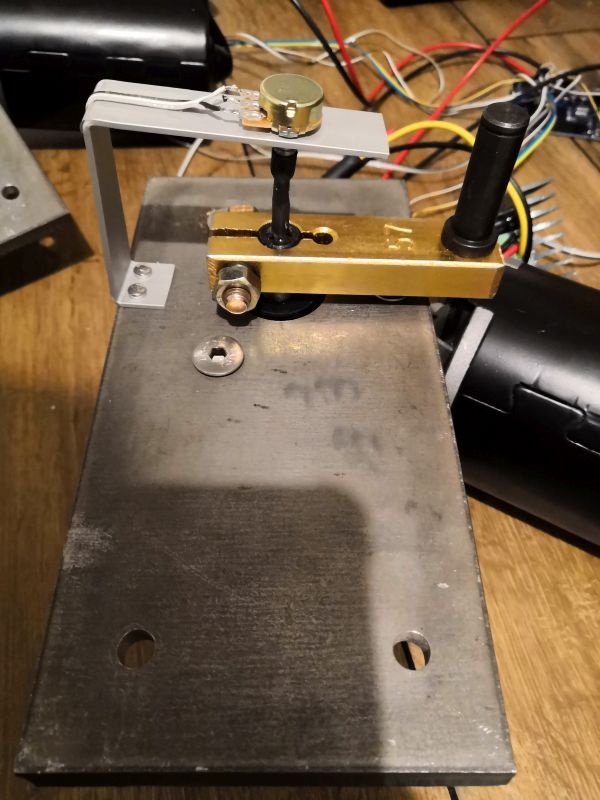

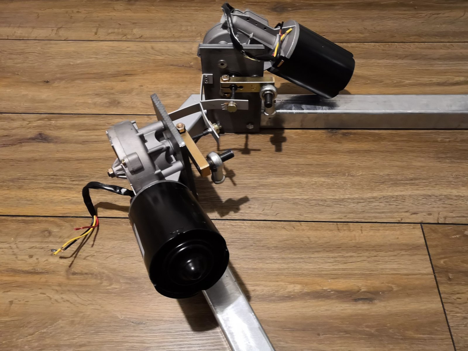

    The next three motors have arrived.
    The mountingplates of the motors have been cuttet and drilled.
    I used 8mm steel plate
    The Potis for feedback are mounted to a Aluminium holder.
    the contakt to the Motor is made by heat shrink tubing
    The first Engin is running
    Next step is to mount the motors to the base Frame
    cu
    Peer

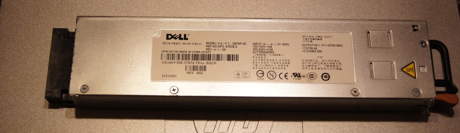

    i found new powersupplys for only 20€ each, so i ordered 6 of this one here:
    Dell Poweredge 1950 Power Supply DPS-670CB A Z670P-S0
    So hopefully this will be enough power for my 120W motors ;)

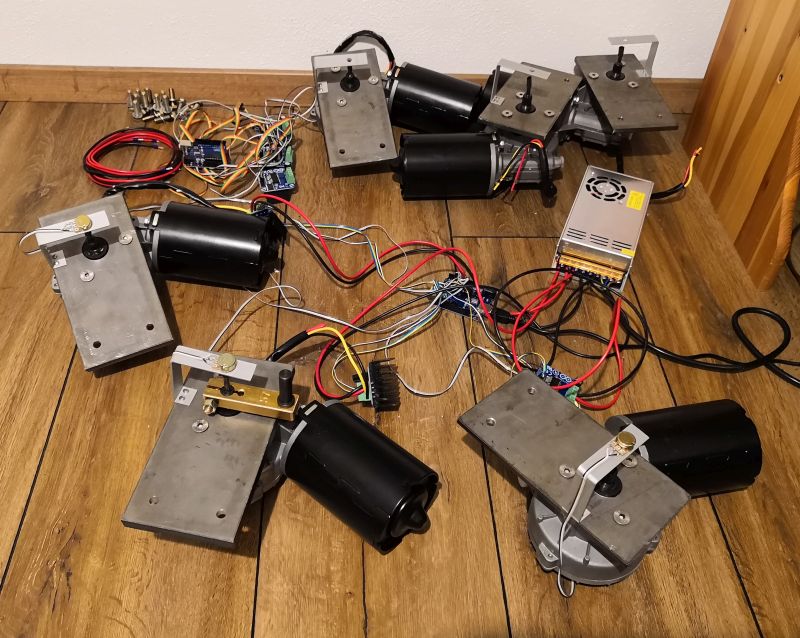

    But here ist also a new problem
    I´ve tried to move slowly all 3 motors on one of the Arduinos.
    On the Arduino is SMC3 1.0 and it is configured in mode2 cause of my 3 IBT_2 each i use.
    For testing i started SMC3Utils v1.01
    In the first trie, only Motor 3 is working.
    Then i measured cabeling (no failures found) an restartet the whole system.
    Now motor 1 and 2 are, lets say "controlable" but they work with completly different Settings.
    Now my Question: Could this happen due to only one powersupply?
    The current limit is not reached.
    But why are not all 3 motors working at the same time?
    Is there something else then mode1/2 to configure before flashing the Arduino?
    Kind regards
    Peer

  11. C1500
    C1500 Active Member
    Nov 19, 2018
    165
    1,120Coins
    +86 / 1 / -0
    AC motor, 6DOF
    Good news
    All 3 motors are running
    The problem was that motor 3 was out of position limit.
    I reduced the limit without watching the position of motor 3
    So it runs into stop directly after powering up.
    And yes, one powersupply is definitly to less power ;o)
    Its OK for 2 motors or 3 very slow running motors.
    But if there is a little bit of speed, the powesupply goes into overcurrent
    So now i´m waiting for the welded main frame AND the power supplys

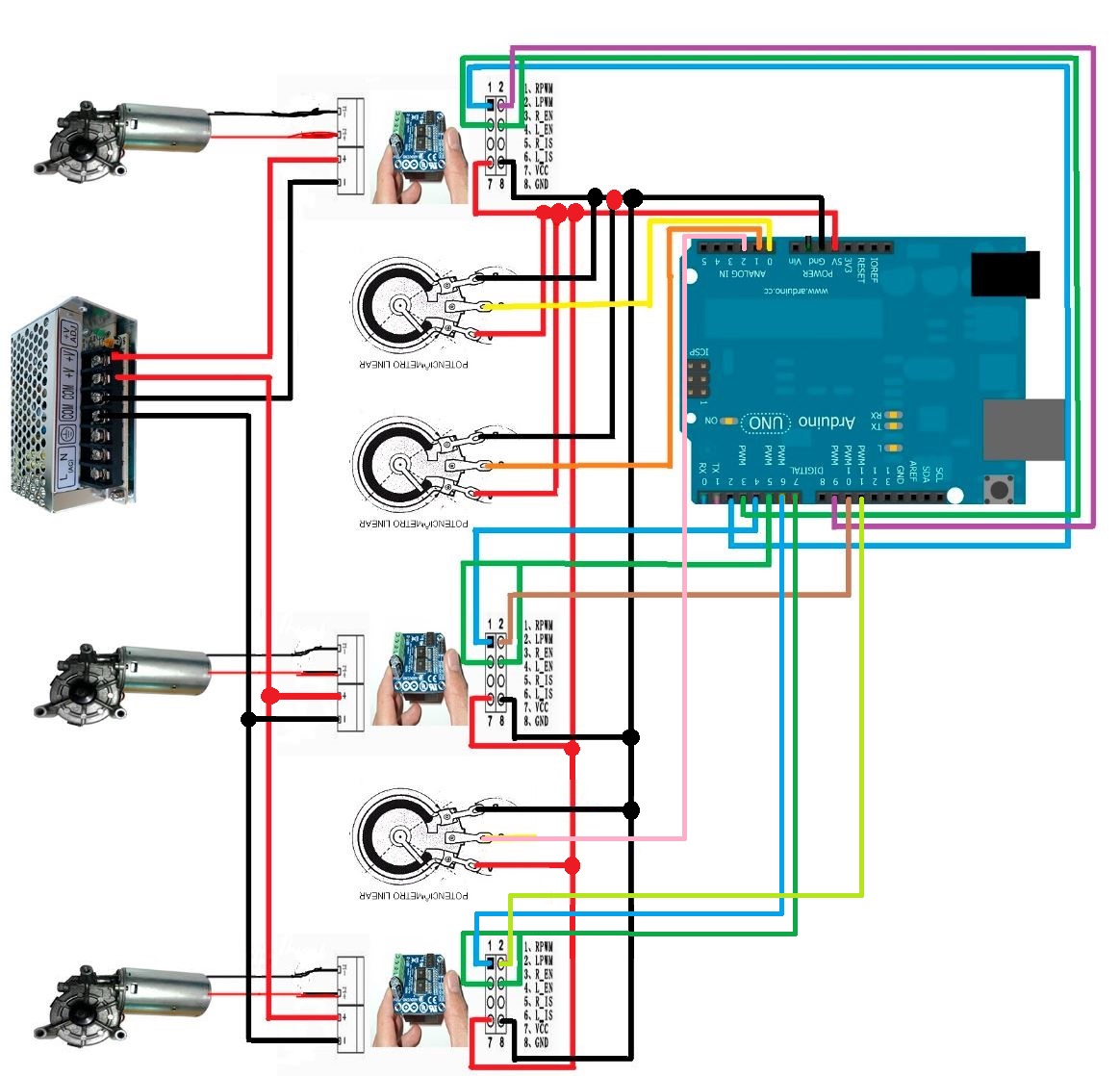

    BTW: This is how i connected the Arduino and the IBT_2

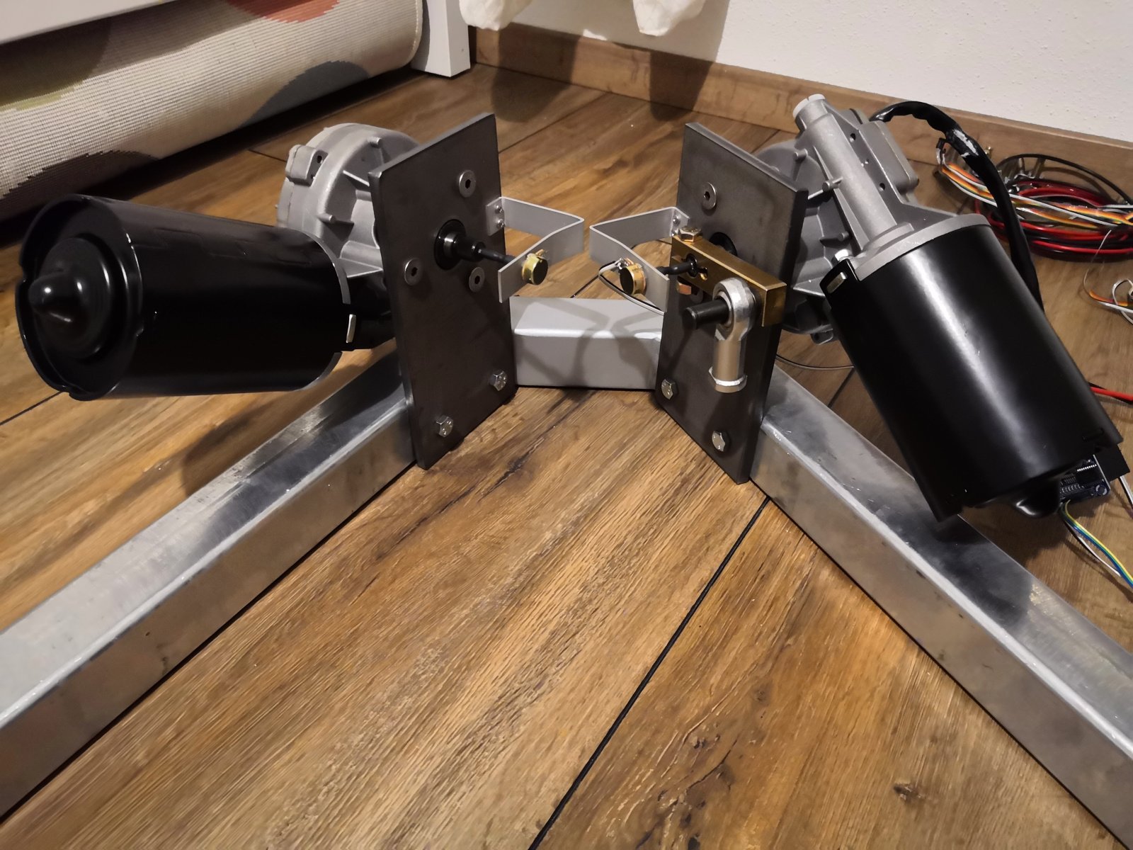

    I got my main-frame back from welding. I drilled 24 holes for the motor-holder-plats.
    Now it looks as follows:
    IMG_20181225_181642.jpg IMG_20181225_181652.jpg IMG_20181225_181700.jpg IMG_20181225_181716.jpg
    Next step is cabeling the other 3 motors.
    The first 3 are running very well.
    I´m still waiting for the 6 power supplies.
    One is definitely not enough :)
    Cheers,
    Peer

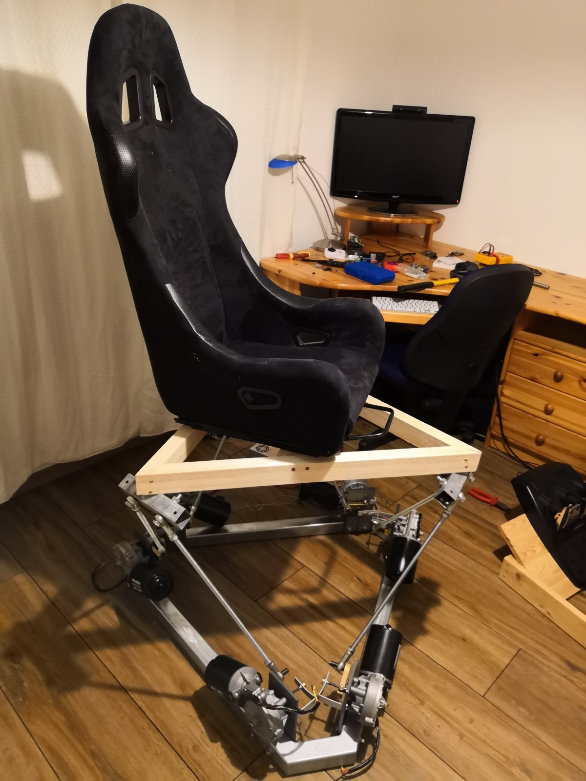

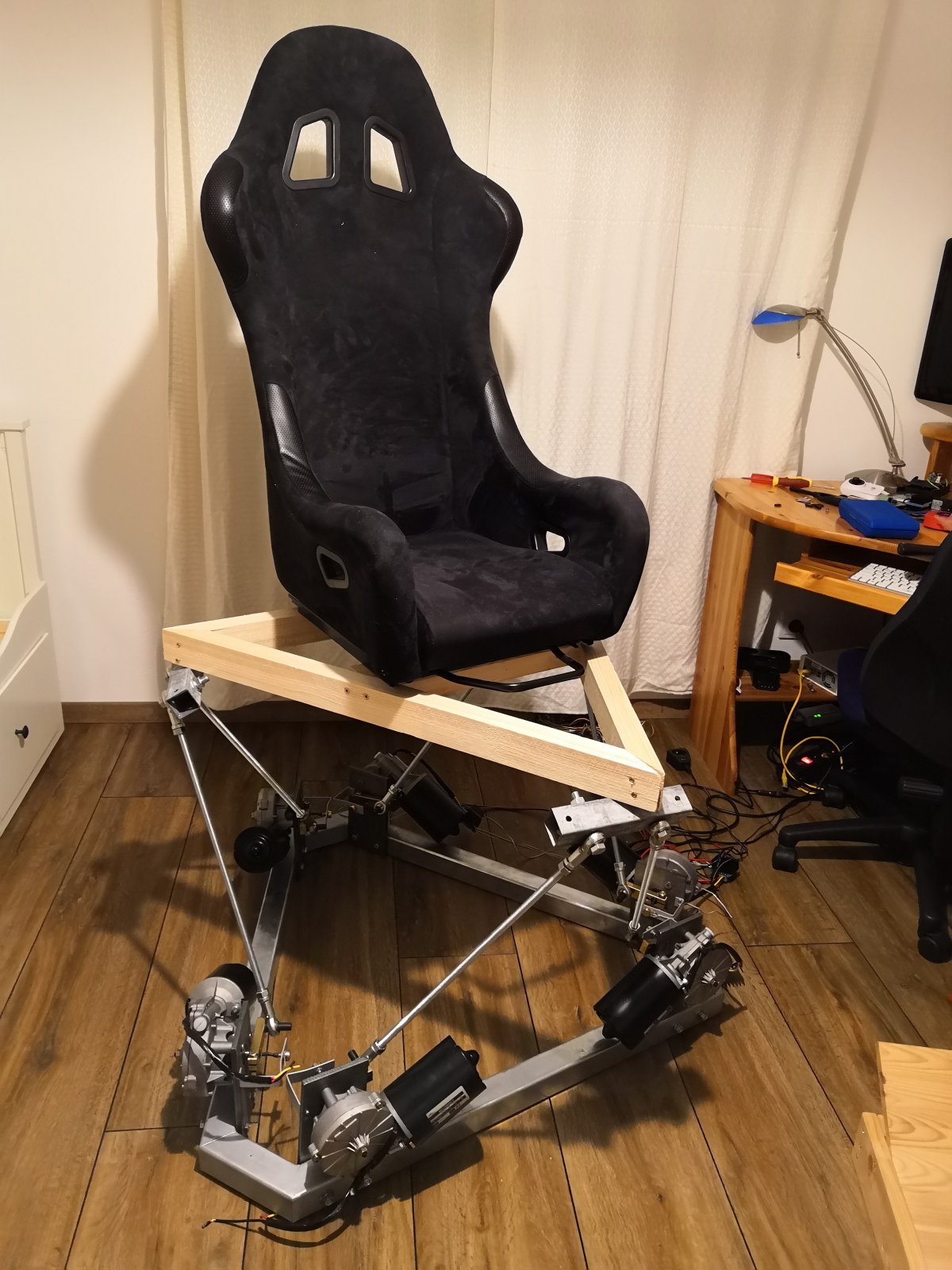

    I wanted to get a feeling how high this construction would become.
    Therefore, I mounted the seat on the upper frame and put it very carefully on the lower construction.
    Here is a first "impression"
    I LIKE IT ;) ;) ;)
    regards
    Peer

    Today the power supplies were delivered. The first test was extreamly disappointing.
    I use 6 of these: "Dell Poweredge 1950 Power Supply DPS-670CB A Z670P-S0"
    If I try a littel bit faster movements with "SimTools GameEngine - Output testing", lets say 15% of speed, the overcurrent protecton switches on, the powersupplies switch off and orange LEDs turn on.
    Then I have to switch of the complete power supplyies and start them again.
    @SilentChill : Have you modded the overcurrent protection?
    Does anybody use the same power supplies?
    Does anyone have an idea how to use the complete current of 54.4A of the power supplies?
    Regrads,
    Peer
  15. SilentChill
    2,645
    20,604Coins
    +3,570 / 34 / -0
    This is why I switched to Chinese LED PSU's as they don't trip out. Server PSU's were always tripping out on me I did buy some diodes and also tried big Caps but just ended up getting the LED PSU's as someone else had used them with no issues.

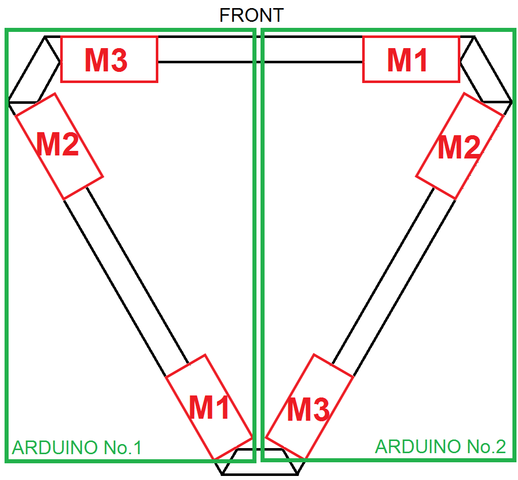

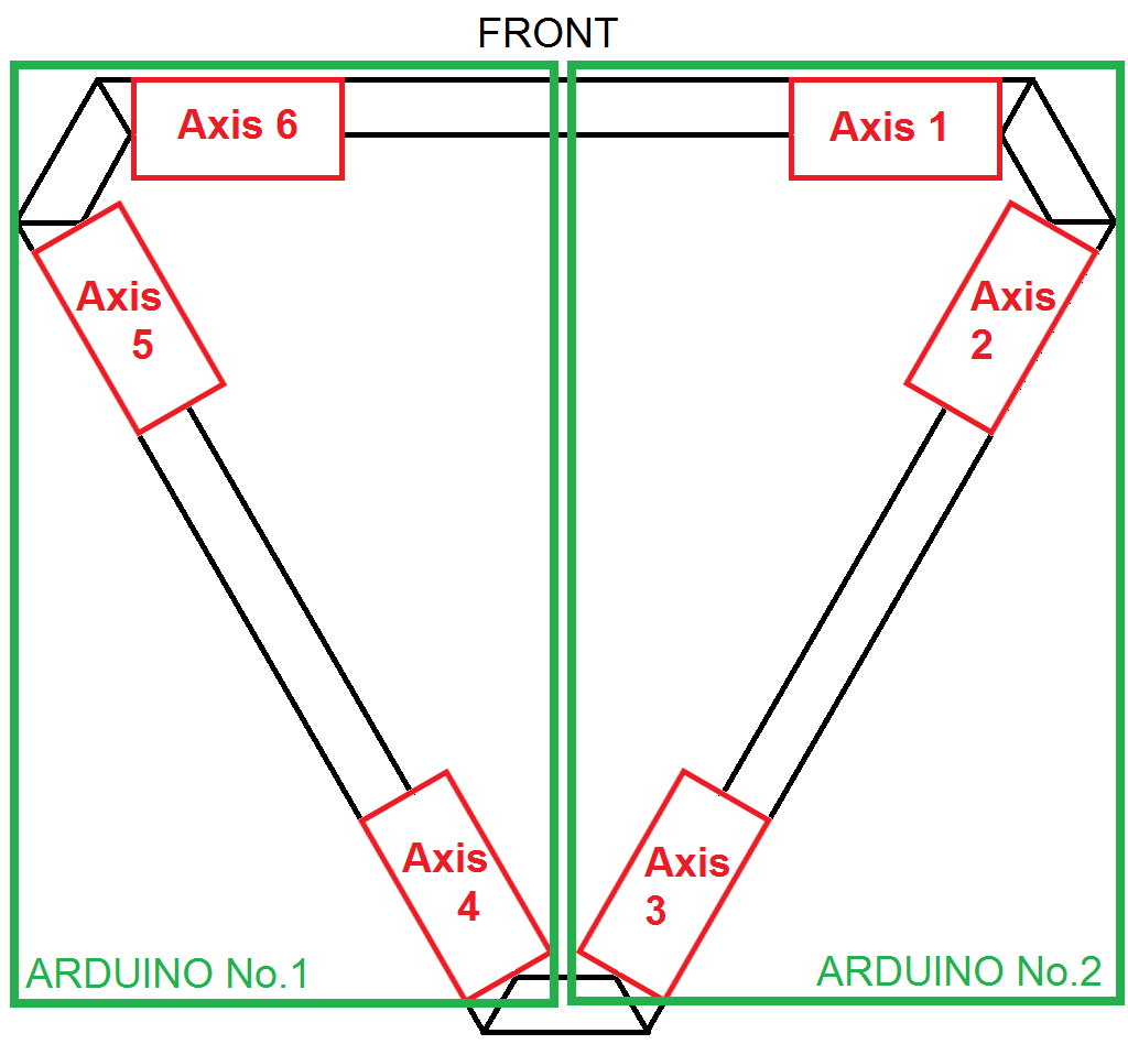

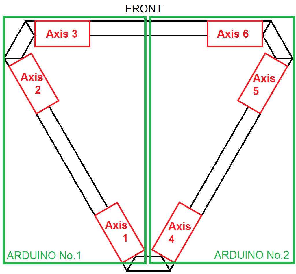

    I have another question
    Is there lets say "a best way" for sorting the 6 axis respectively the motors?
    Clockwise or counterclockwise ?
    Where to start?
    In the driving direction?
    Thanks for your help
    Peer

    Hi Gadget999
    Yes, all motors are running in SMC3 test program
    Sorry for the missunderstanding but my question was a little bit different.
    i´ve made a graphic to explain my question
    The motors are actually connected like this:
    My question is: Which is the best way to sort the axis?
    Here are 2 examples
    1: sorted clockwise
    2: rear to front
    I know that i have to reconnect the motors when I change the axis.
    But thats the no problem.
    How did you connect the motors / axis ?
    Kind regards
    Peer
