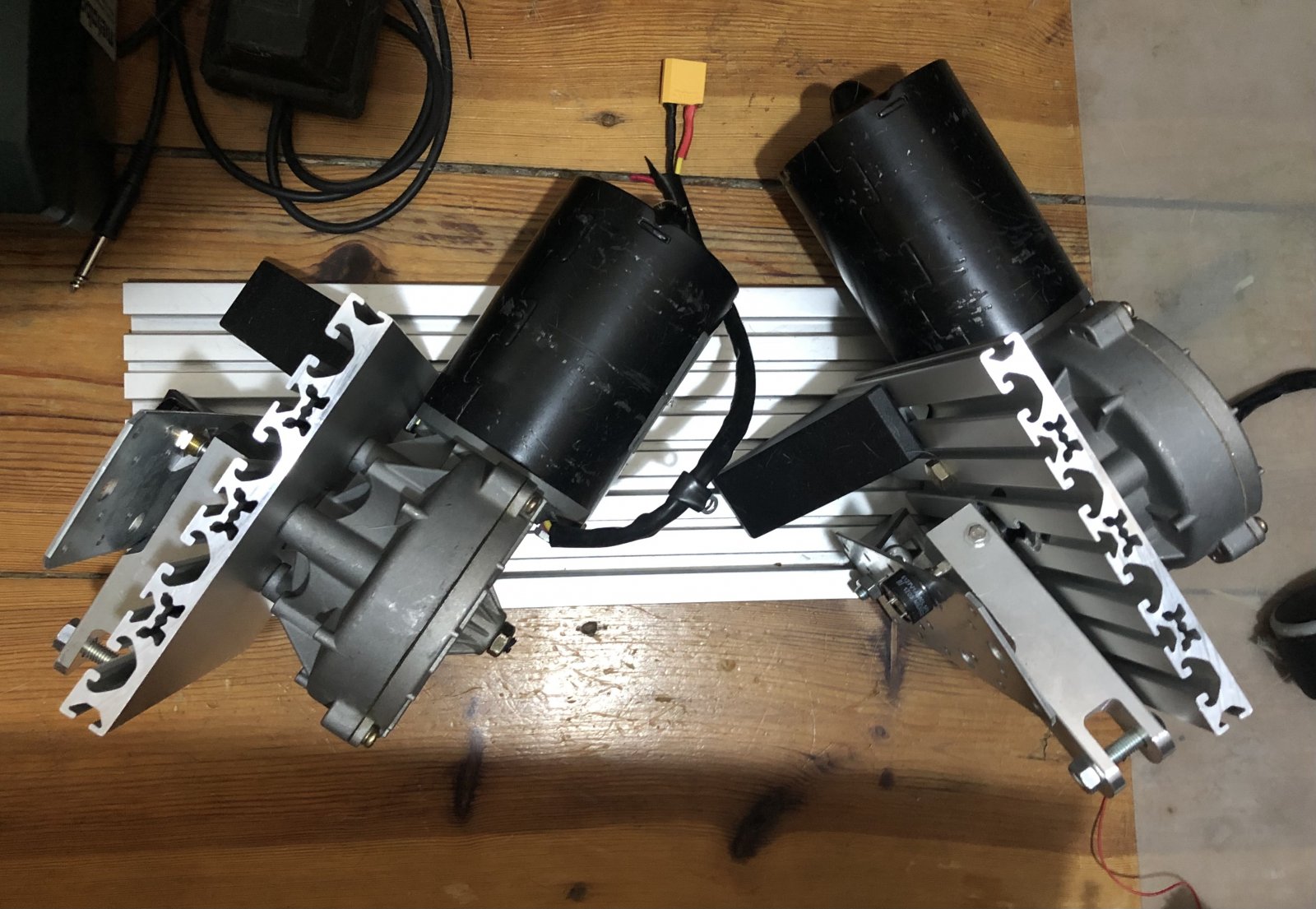

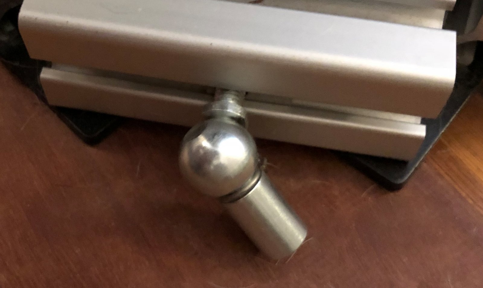

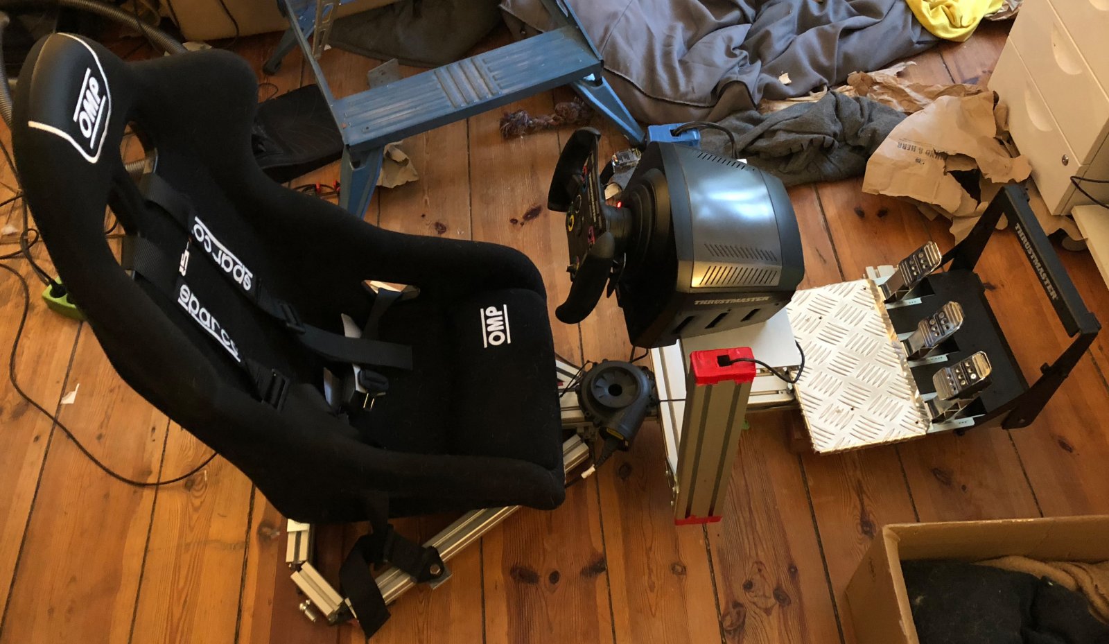

    Hey Folks,
    now that I have all the parts together, I will try to build up my own 3DOF plattform mover (I think it is).
    First I build up the Rig to drive without motion and I love it.
    I have used Alu profiles I-Type for the Rig, Thrustmaster TS-PC Racer Wheel and Thrustmaster T3PA Pro pedals. And I am driving with my Oculus so I don't need a monitor attachement.
    Next thing to do is building up the motion. For that I use 3 winch motors with 95 Nm torque Max. and 55 rpm, a sabertooth 2 x 32A and a SyRen 25A, two 12V power units with 600W.
    Also ready to use are some different Arduinos.

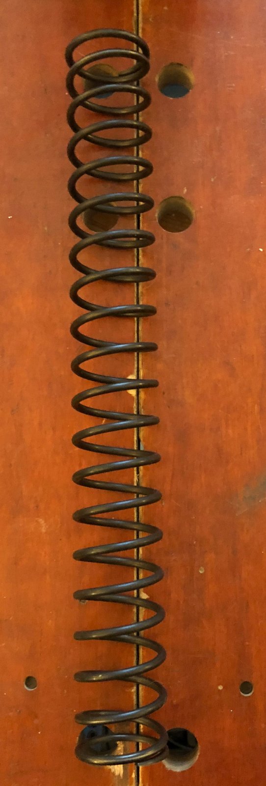

    Now we come to the funny part, bring it all together. To support the motors, I bought 4 steel springs with a capability of 30kg each.
    Going to be fun, I think.
    MotionSimulatorParts-1.jpg MotionSimulatorParts-5.jpg MotionSimulatorParts-4.jpg MotionSimulatorParts-3.jpg MotionSimulatorParts-2.jpg

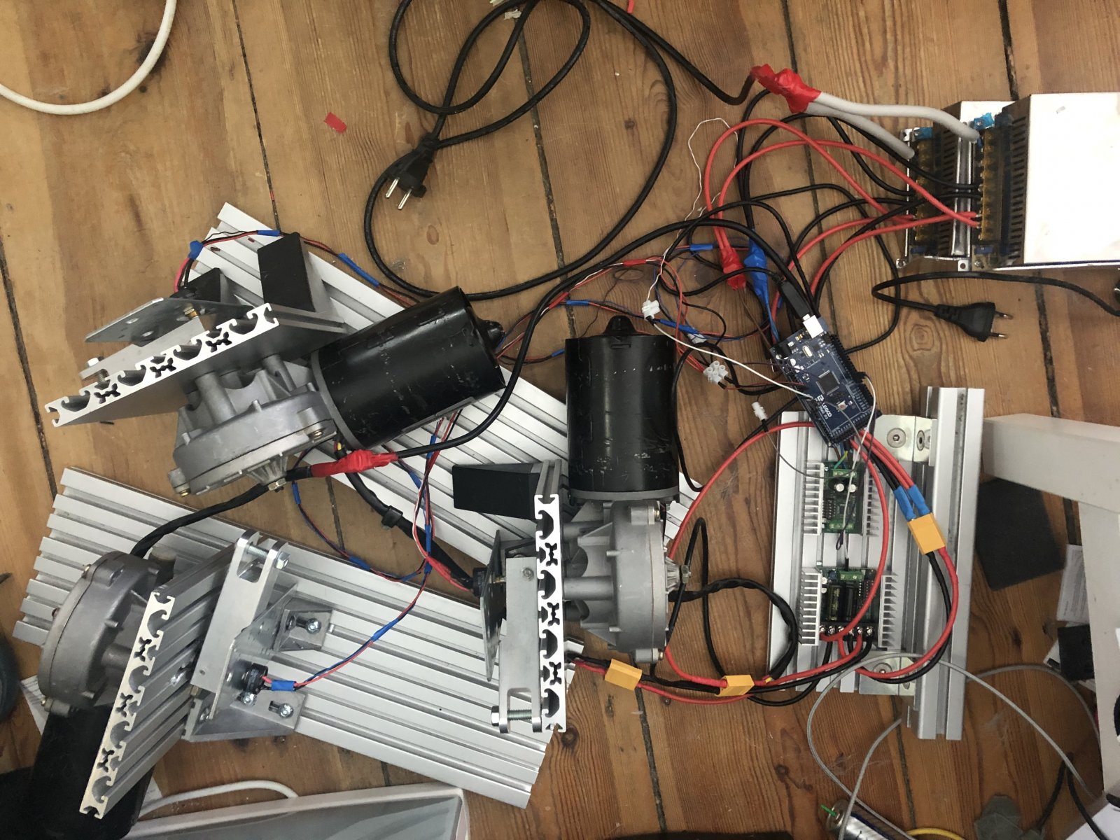

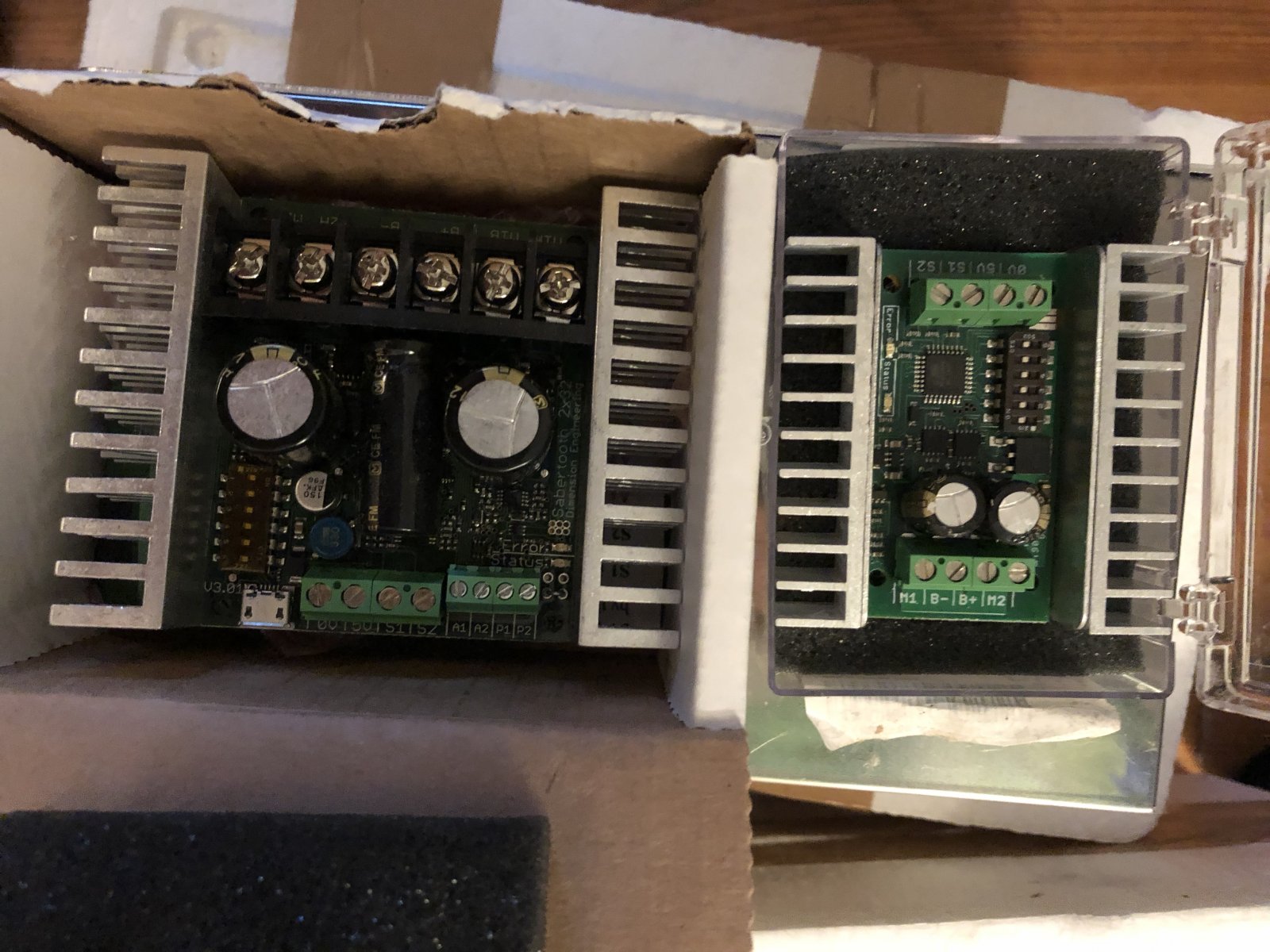

    Ok, some things have changed in the electric department from the start 3 years ago.
    The Sabertooth 2x32A is now a Sabertooth 2x25A, because a sharp object felt on the first board leaving a hole in it.
    Now everything is cabled and maybe the cables are at the right place, who knows, we will see.
    When I powered the whole thing without the Arduino, the motor that is connected to the SyRen start running, while the two motors at the Sabertooth stayed off, which I definetly prefer, when there is no steering signal.
    Is that a knowen „problem“? Or is there something wrong with my board?
  6. Bontekop
    Bontekop New Member
    Jun 14, 2021
    16
    Mechanical Engineer
    Hasselt, Netherlands
    107Coins
    How did you connect the SyRen motor driver? Which mode did you select with the dipswitches?
    According to the manual: S1 is the primary input, and must always be connected. If you are running in analog mode, it is important to have the signal wires to the motor driver connected before applying power to the device. Otherwise, the motor may start unexpectedly.

    Ok, it tooks some time, but now at least something moves. I am now using SMC3 from @RufusDufus but to be honest, something is still wrong. Just look at the Video attached. Only one Motor is moving at all and it is just stuttering around…
    Has anyone had the same problem?
    21,497
    150,602Coins
    +11,017 / 55 / -2
    A couple of thoughts.
    If those are wiper motors have they been ground isolated: https://www.xsimulator.net/community/faq/wiper-motor-mandatory-ground-isolation.25/
    Your SMC3 settings seem odd, how did you get them? For example I would have expected a higher kp, probably zero for ki and kd, and 1 for ks, same with oter settings, they just seem odd. So I would suggest stepping back through the SMC3 setup from scratch:
    8. Set Kp to about 400
    10. Do the above for each motor
    The second SMC3 post details what each of the settings does, so you can dial them in for your specific hardware: https://www.xsimulator.net/communit...driver-and-windows-utilities.4957/#post-48121
    In the end the settings will be somewhat unique for your specific for your hardware, so don't copy this, it is just more along the lines of what I would expect:
