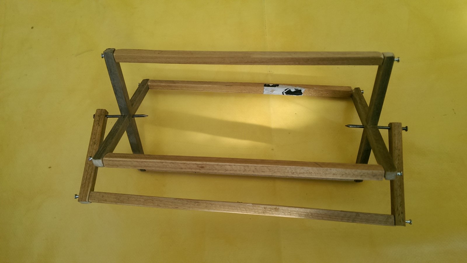

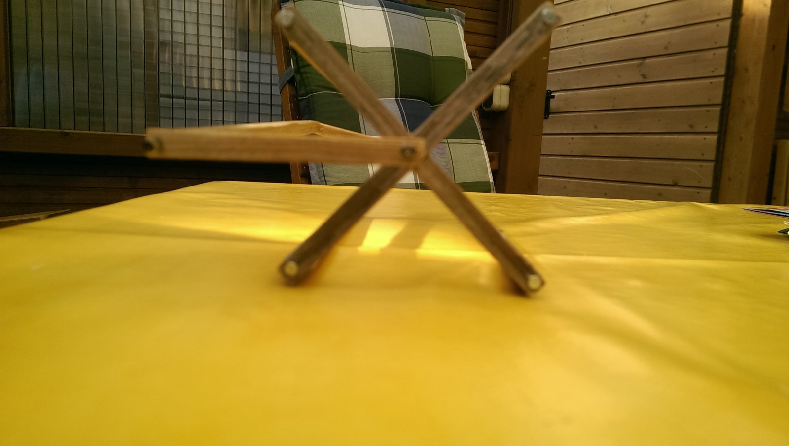

  6. FattySteve
    FattySteve New Member Gold Contributor
    Jun 18, 2015
    20
    YinChuan
    226Coins
    +8 / 0 / -0
    2DOF, 3DOF
    WOW! so cute!!!
    I'm agree with you!
    Actually in my plan the first step is to build an 1:5 or 1:8 model with alunimiun parts and little motors.
    Sorry about the Wrong tittle.. I thouth in ME...that there's roll and pitch free to move so named by 2DOF..

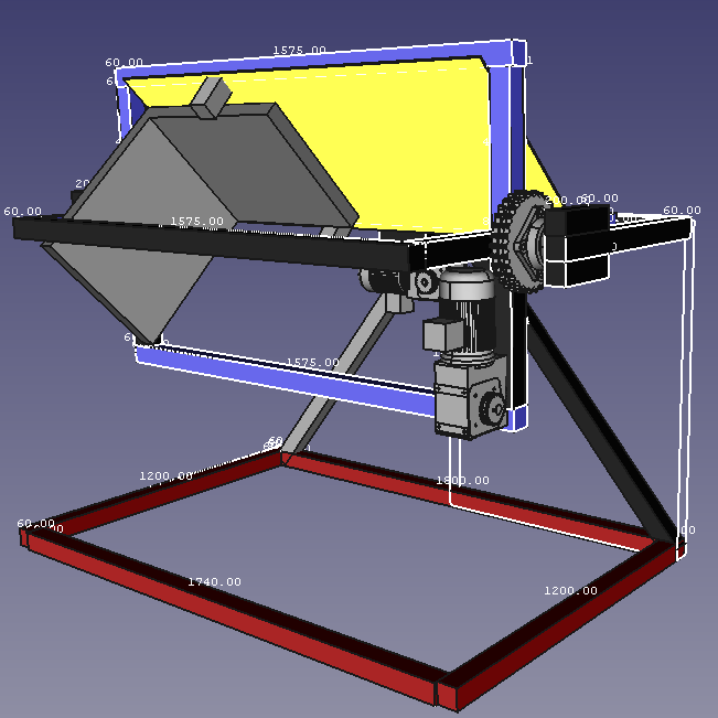

  7. cit
    cit New Member
    May 24, 2015
    6
    649Coins
    don´t forget the chain and gear.
    cause the dimension will change a bit.
  8. cit
    cit New Member
    May 24, 2015
    6
    649Coins
  9. cit
    cit New Member
    May 24, 2015
    6
    649Coins
    but im unsure about the needet power of the engines. 0,25kw wormgear ~350 €. Its not mutch but i think it can work, but better 0,5 KW ?

    Good luck, all the best in your build:thumbs, but even building a model does not adequately exercise the main issues with this build, which are large loads and inertia. Just remember that you could easily maim or kill someone on this if you are not careful. The only really successful ones I have seen built are by people from similar industries Eg. Carnival ride manufactures.

    2DOF, 3DOF
    Mine is plan to use 0.75kw...is that too big?
