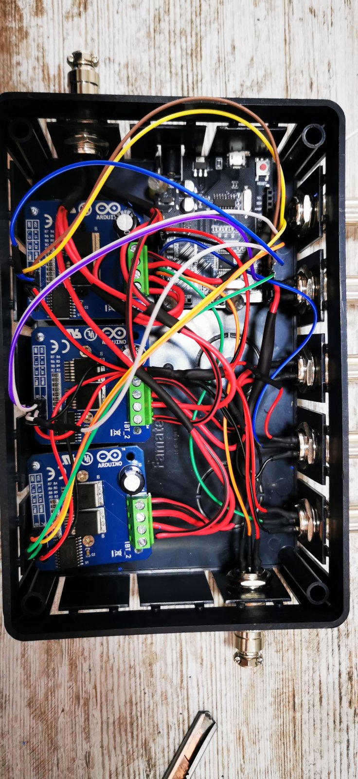

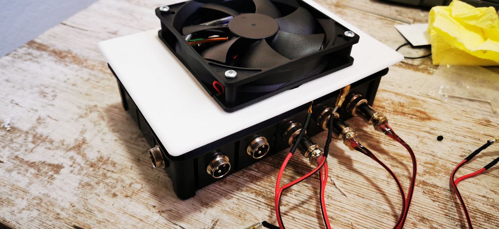

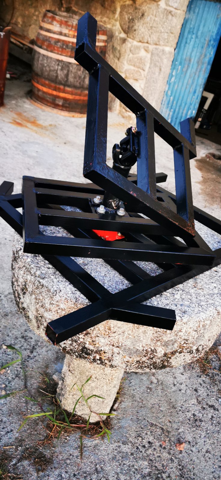

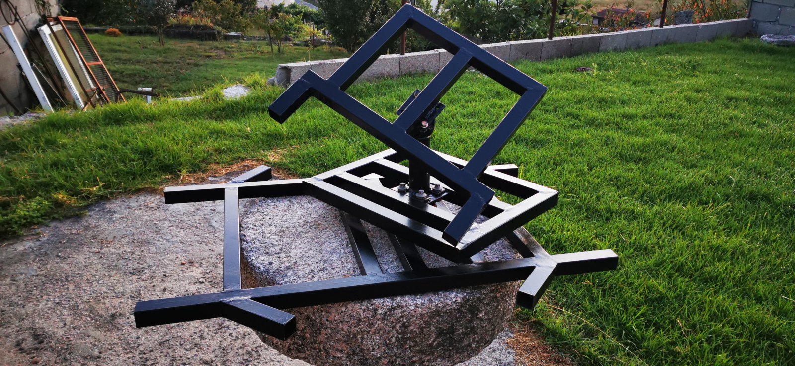

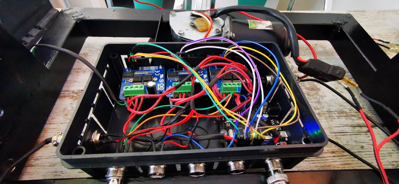

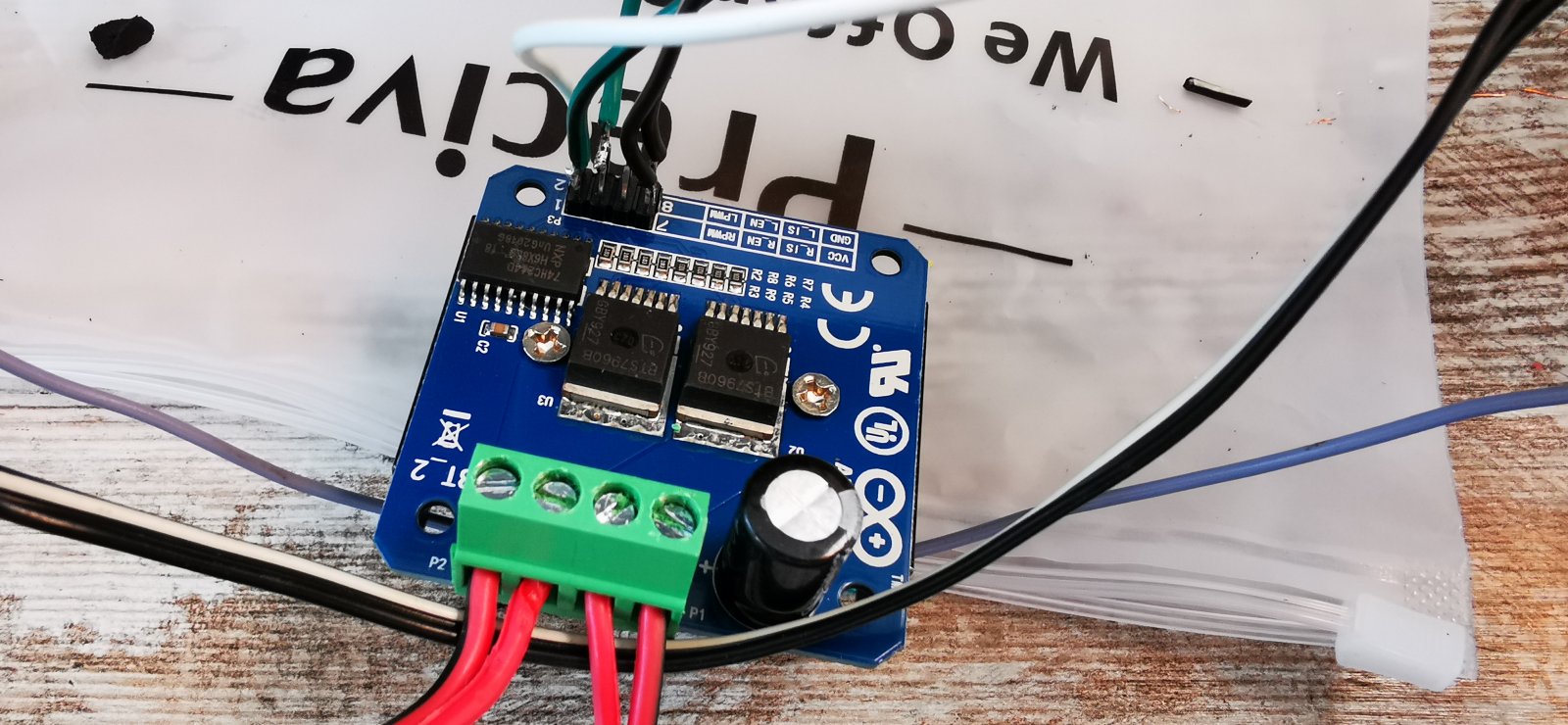

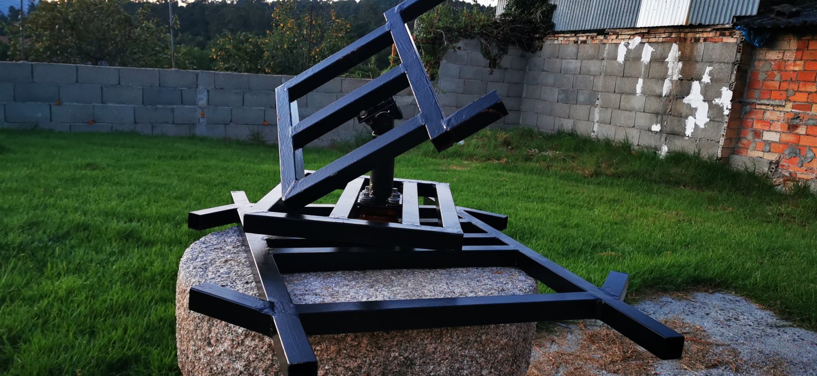

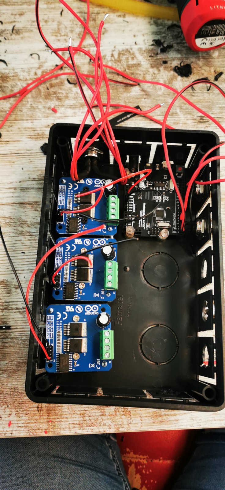

    I have prepared a 3 motor structure with a car hub and a gear shaft.
    The tricky thing with motors is getting rid of the ground connection and unfortunately one of them is bothering me.
    With the electrical part, I worked a lot to create a box with all the connections, as the information in various forums shows errors in the connections.
    After the correction, I managed to get 2 motors running.

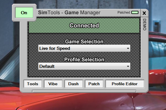

    Now I'm having trouble getting the game to work (Live for Speed) I have checked the Simtools settings, it gives me a connection, but the game doesn't work, I would appreciate help, I don't know what to check.

    I can't tell from the pictures how the pots are attached?
    How did you go about ground isolation?

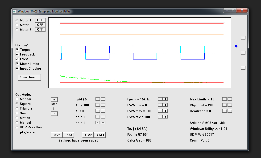

    Do you mean that the motors do not accurately following the input, like Square in SMC3?
    Can you please post a picture using Square in SMC3.
    If you have noise check all wiring layout, connections, cables and ground isolation.

    I have completely reviewed everything, cable to cable, the motors are isolated, the connection diagram is perfect and there is no way.
    When I plug in the USB port the motors make a garter movement and stop.
    I don't know what to check anymore?

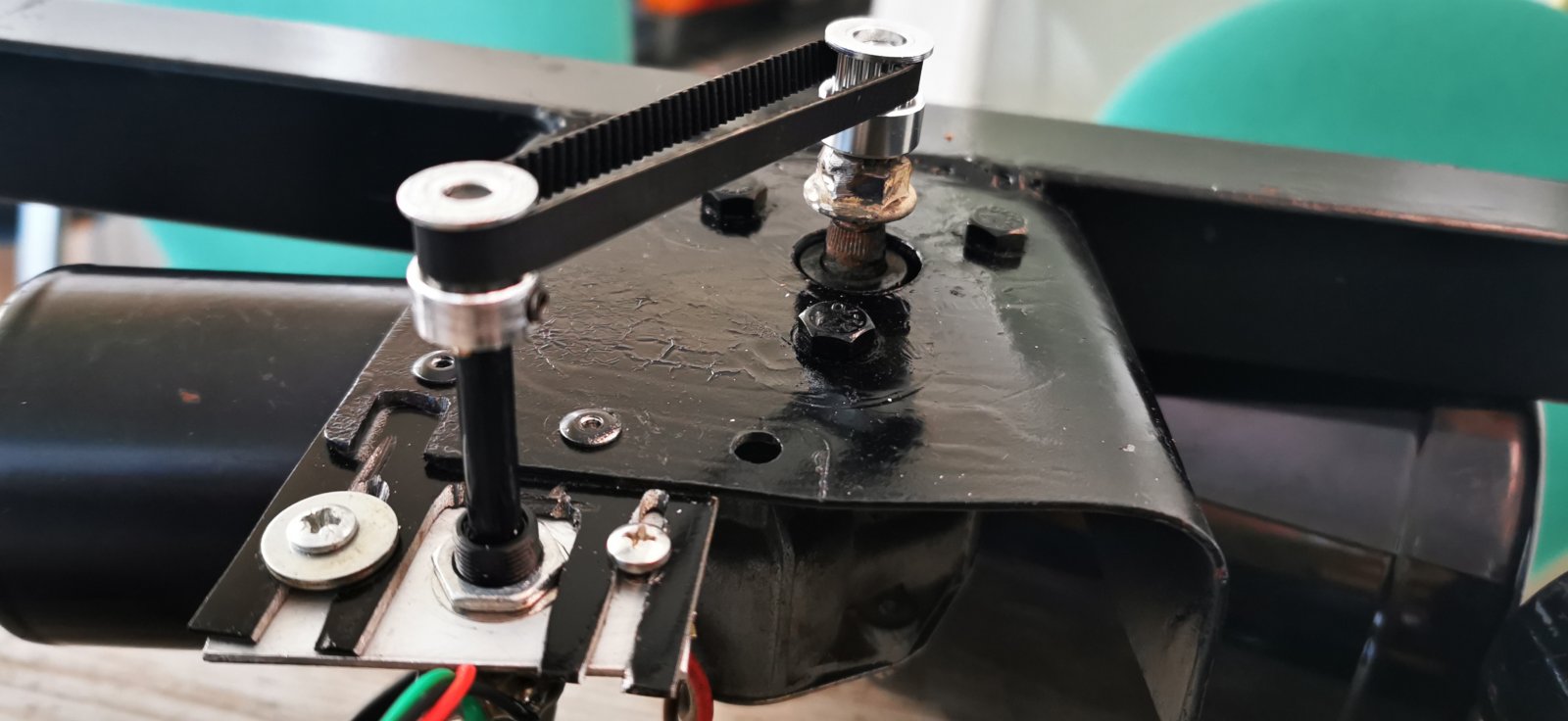

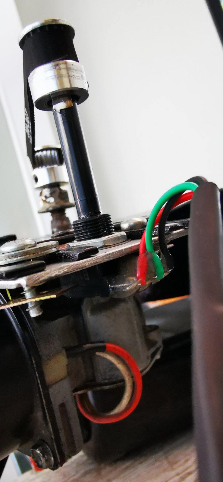

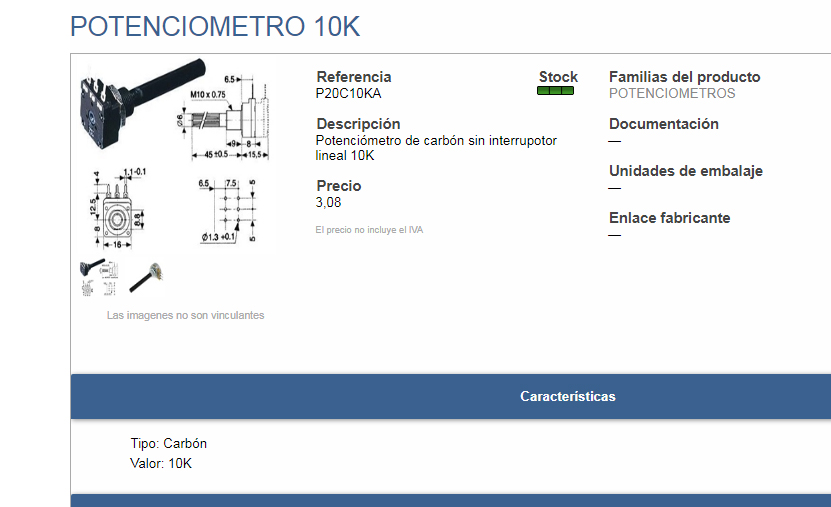

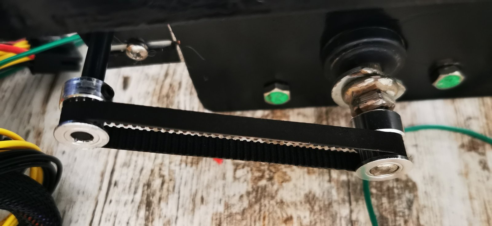

    The potentiometer that I use is the one in the photo, it is 10K and has a return stop, I don't know if the problem is in this?
    21,592
    151,215Coins
    The pots provide positional feedback information and must be attached to the motors to do so, can you please post a picture of how your pots are attached.

    I have put it with some straps

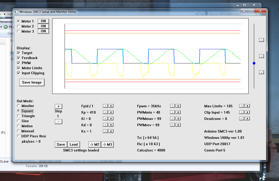

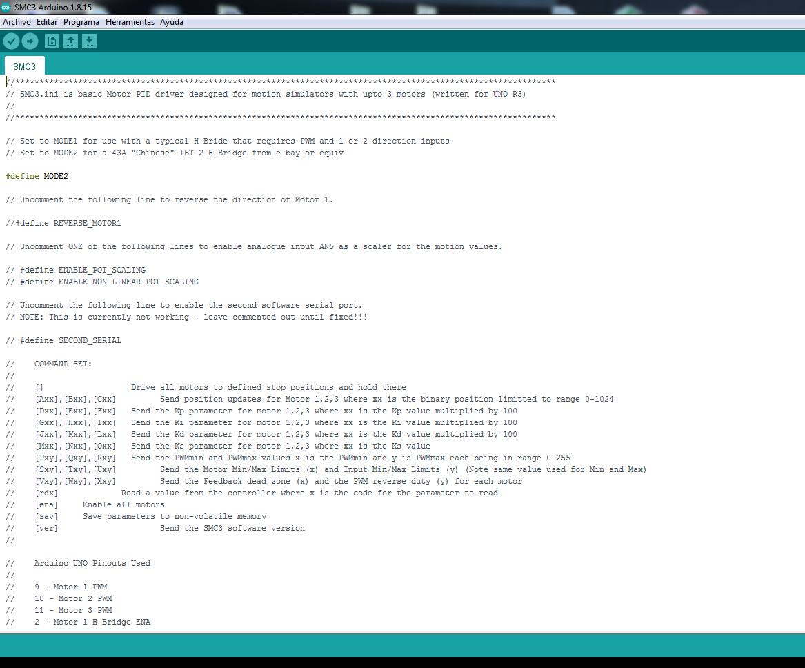

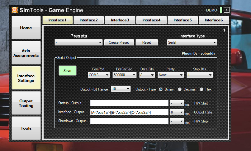

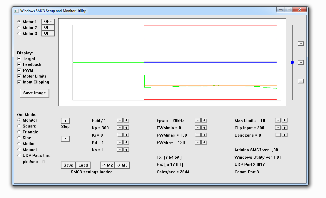

    Good morning, I have ordered a new Arduino Uno board and I have assembled a single motor, something basic.
    I have managed to configure it with SMC3 Utiles and that it moves WELL, I attach a screenshot.
    But I can't get it to move with Simtools Engine Testing, I've already checked the communication port and it's OK.
    What can be?
      File size:
      335.7 KB
      Views:
      245
  19. noorbeast
    21,592
    151,215Coins
    This Arduino is on Com Port 5 and that has to be set in Interface Settings.
    Please post pictures of all settings.
  20. chichog60

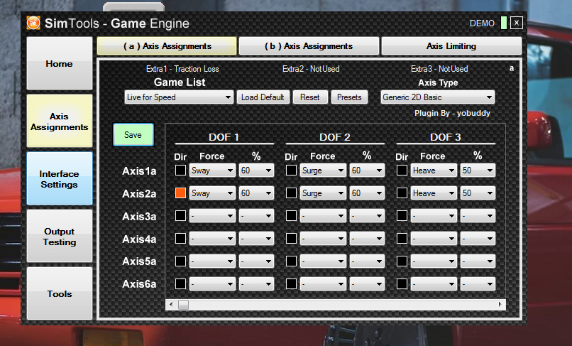

    Hello, the port was fine Com 5
    I pass you photos of the configuration.
