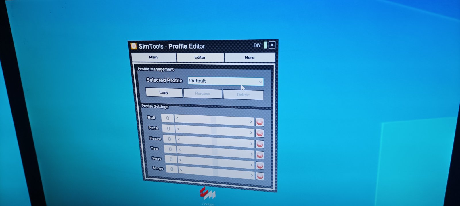

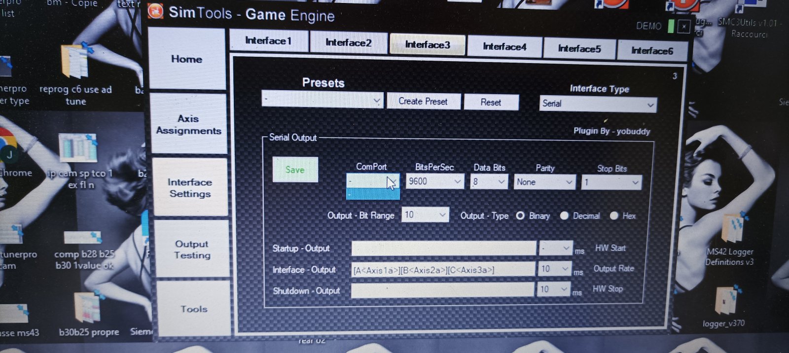

    just need to select serial...
    I managed to fill everything except port which has nothing selectable maybe I have to connect the arduino?

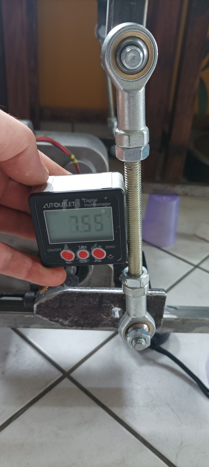

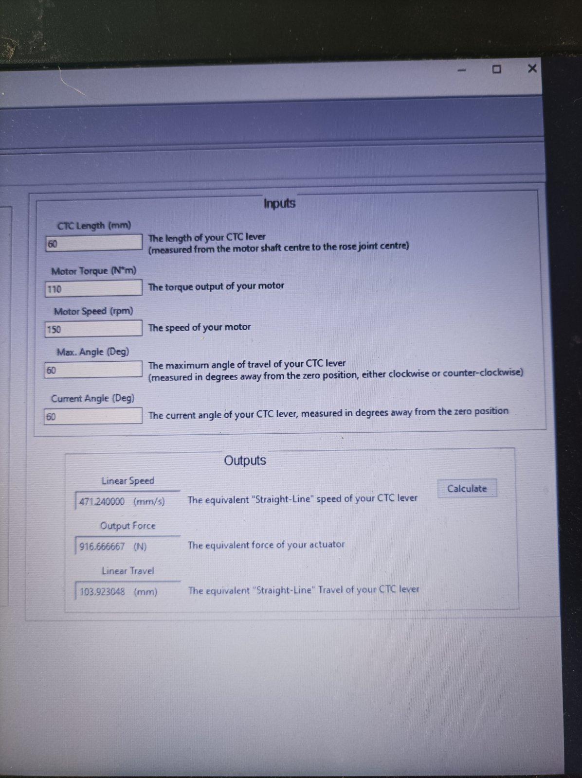

    hello

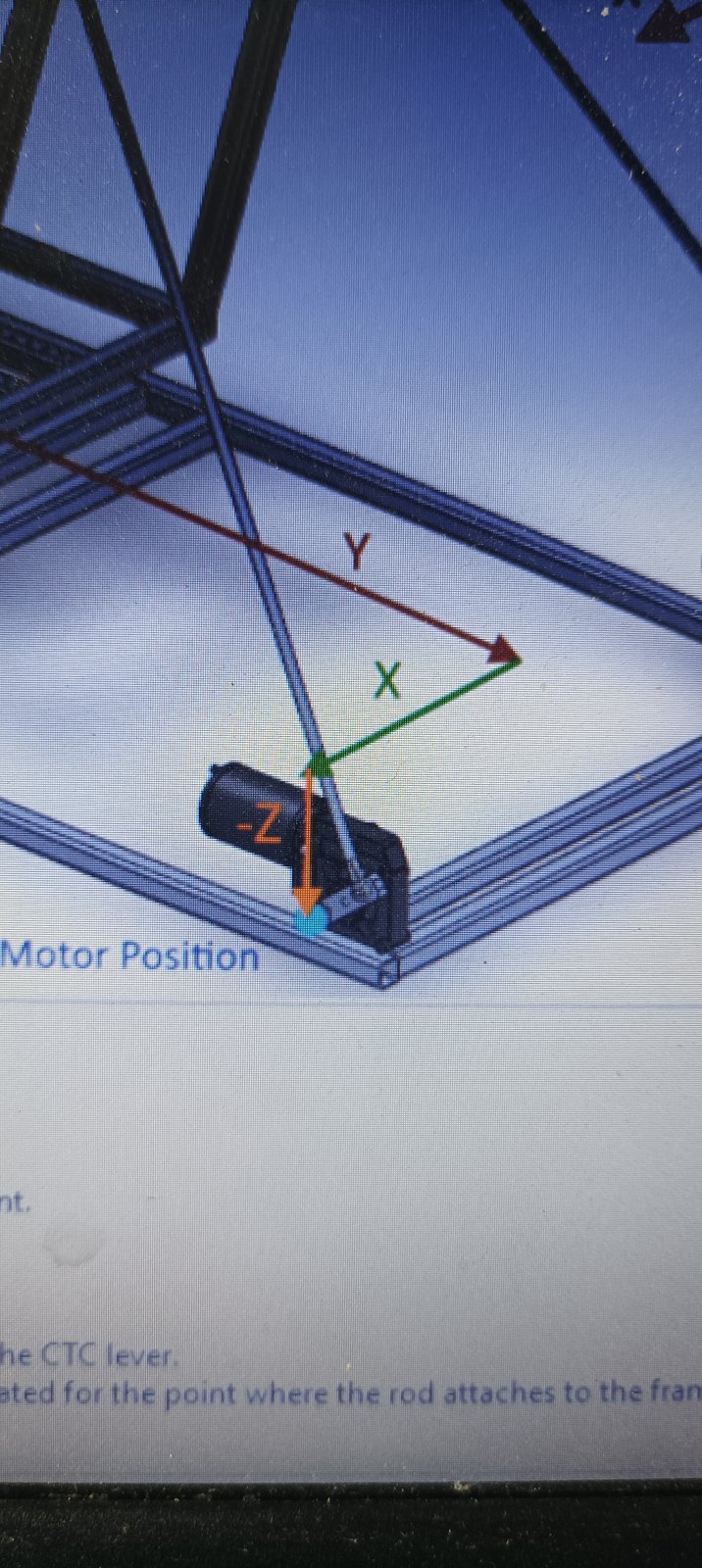

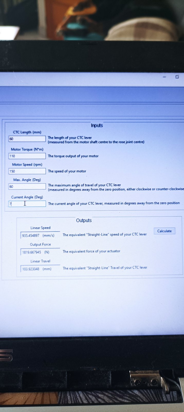

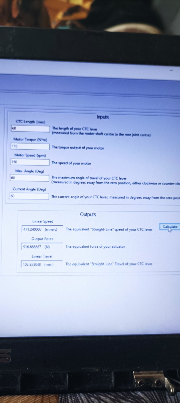

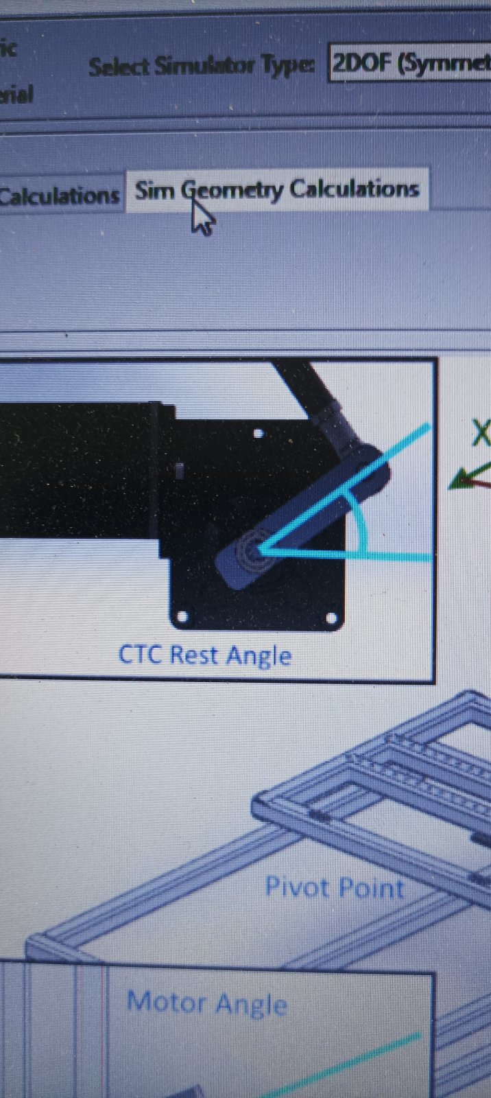

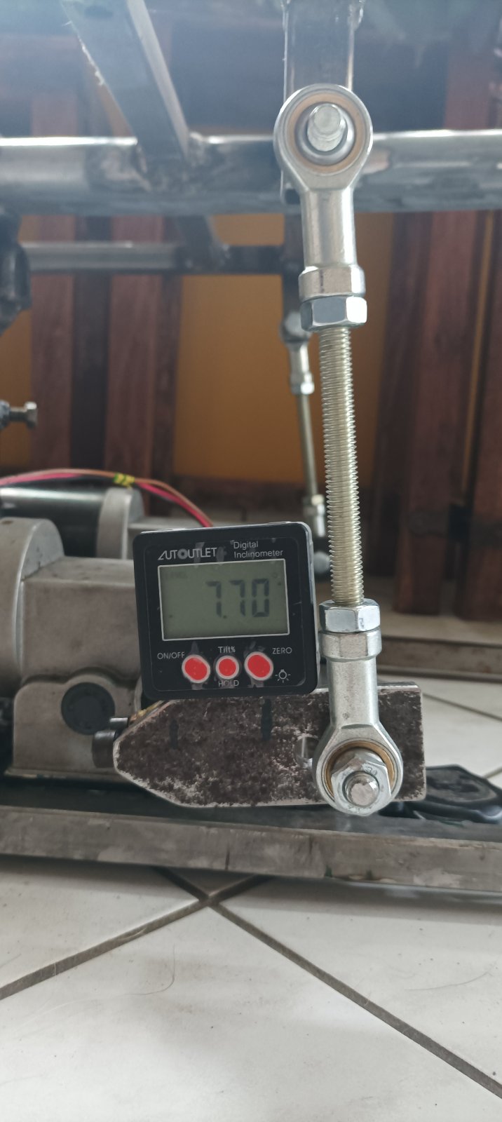

    at the same time as i'm trying to learn how to use sim tool i wanted to check that my simulator respects the expected angles (10degrees for 60 degree crank)
    i followed a tutorial and respect the dimensions,calcul and check with simcalc beta (where I'm not sure I understand everything)
    Simcalc and tutorial give me 10 degrees but it's not..
    In the software with the position of the seat at zero the cranks have an angle of +/-45 degrees (to the eye)
    I thought that the zero position of the seat equals the zero position of the cranks?
    it is written
    "when measuring your motor position, measure from the center of the CTV "
    but in the diagram measuring her after the axe..
    I do not understand what is "ctc rest angle"
    is this angle it illustrate (+ / 45) or angle it can do will set in simtool (60)?
    as I read "when levers is at zero make sure that make the rod angle 90 with ctc levers"
    crank in my case was zero degrees
    (real, parallel to the ground)
    my rod through the center which gives me 83 degrees,so if I want 90 I have to climb the crank 7 degrees
    What is z (-8)?

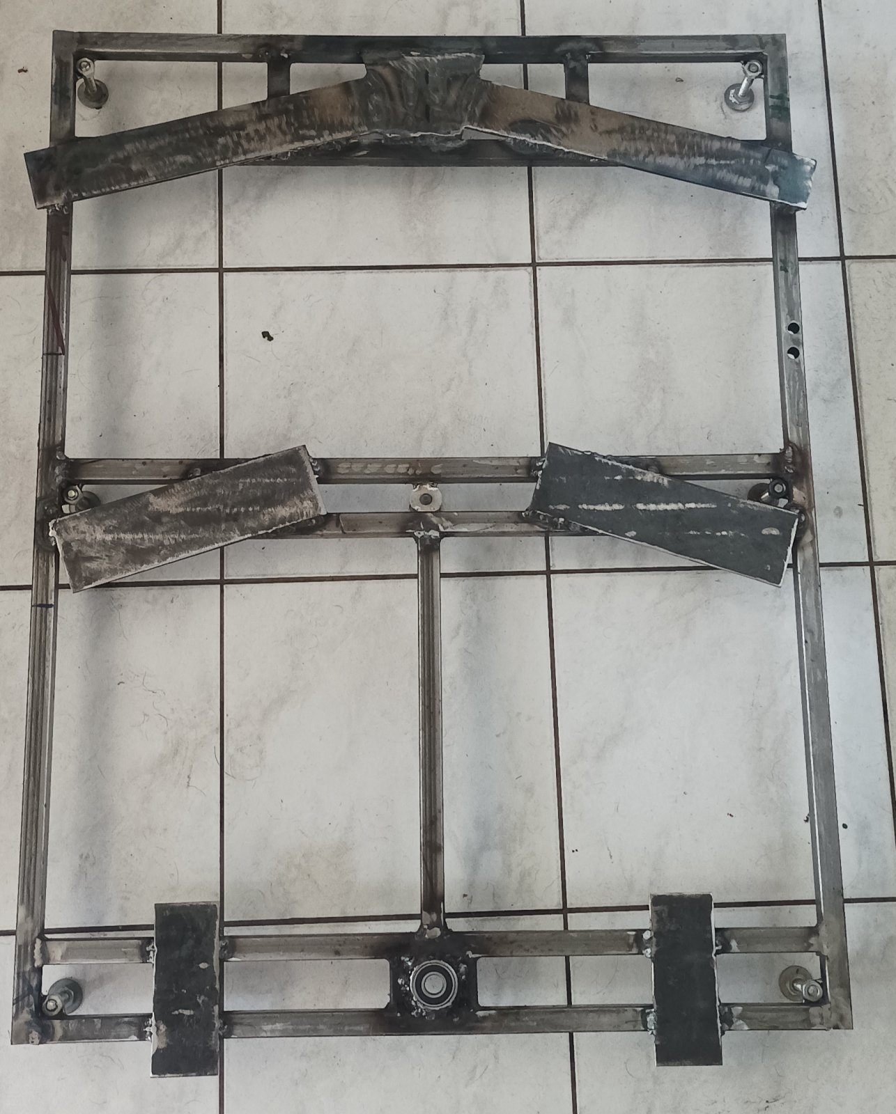

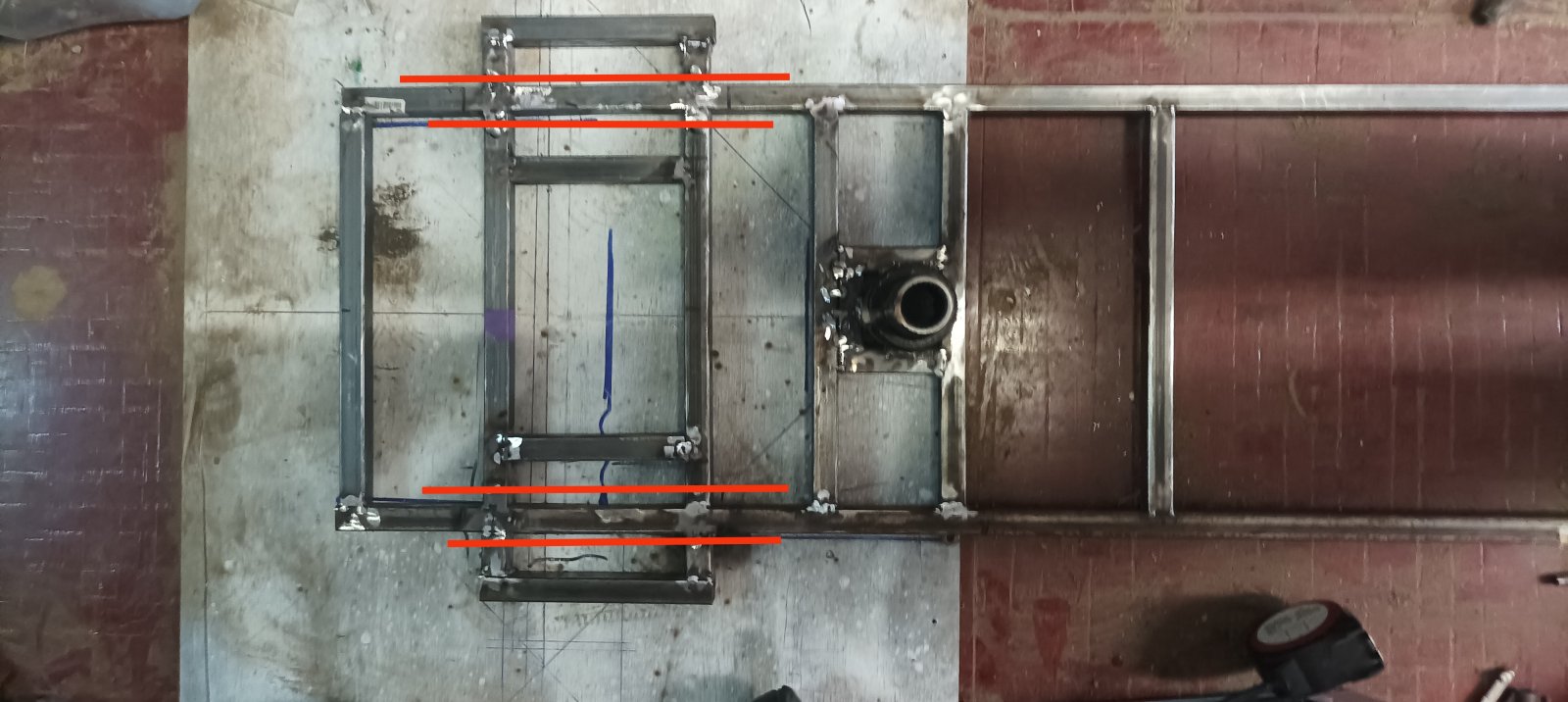

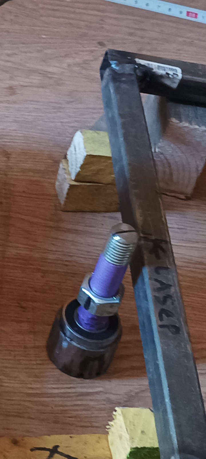

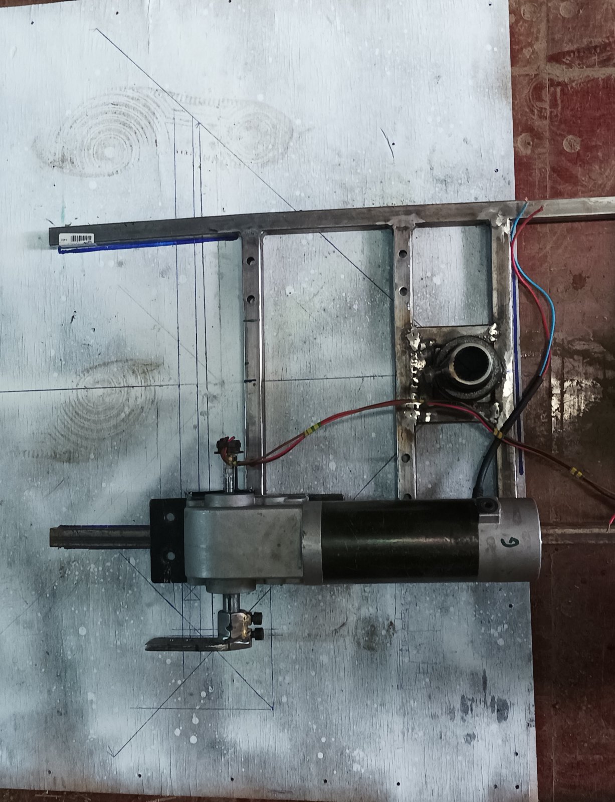

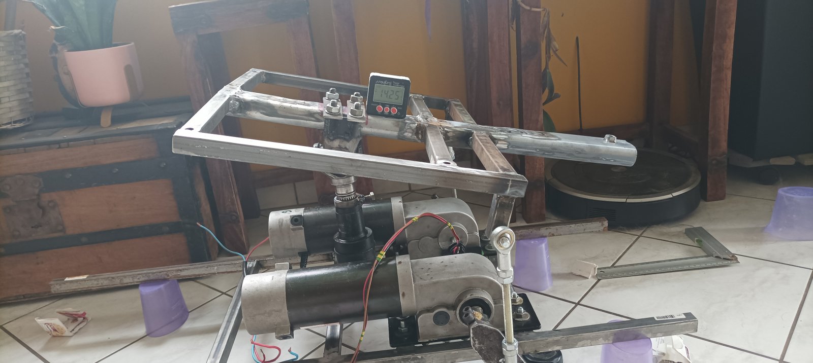

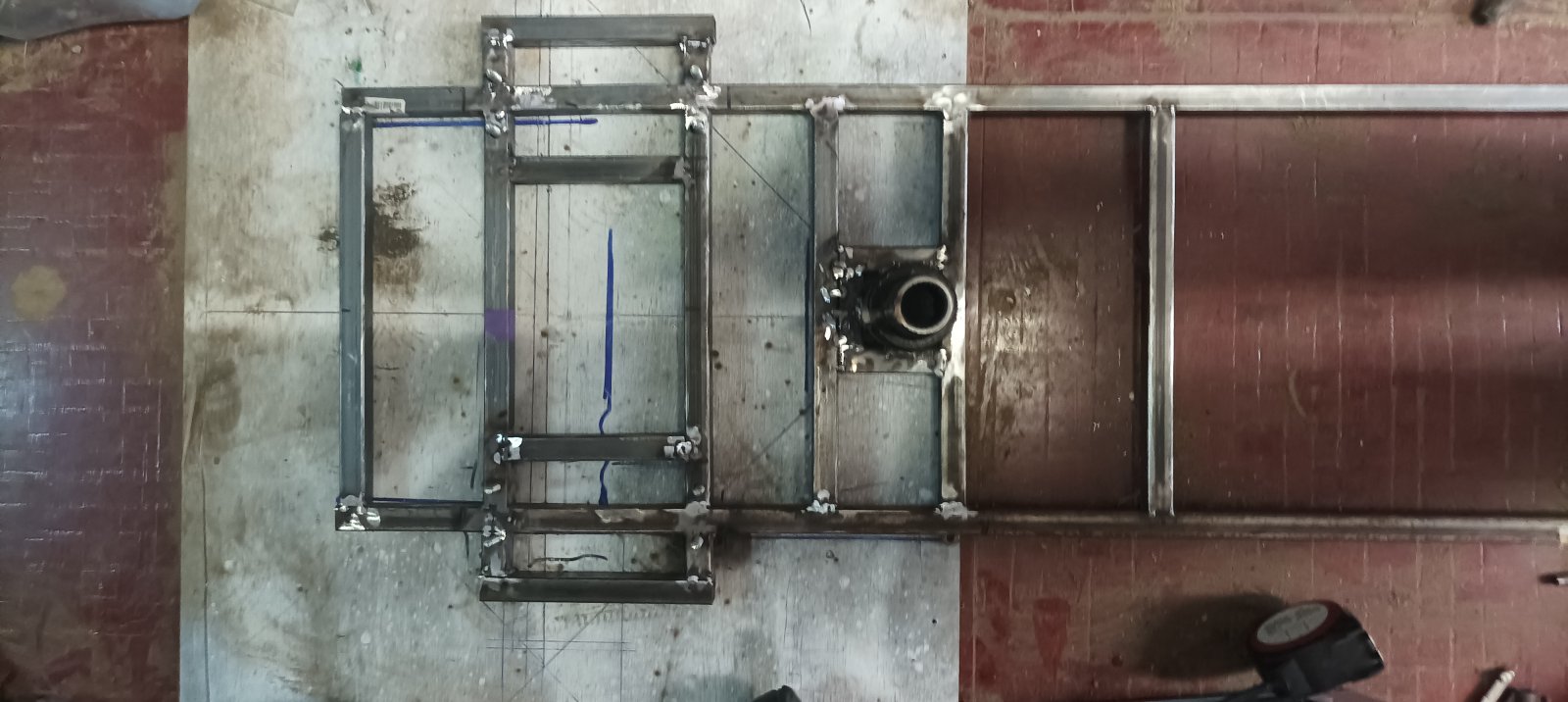

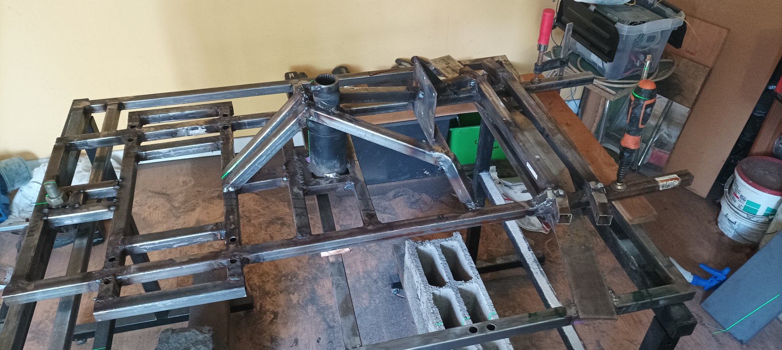

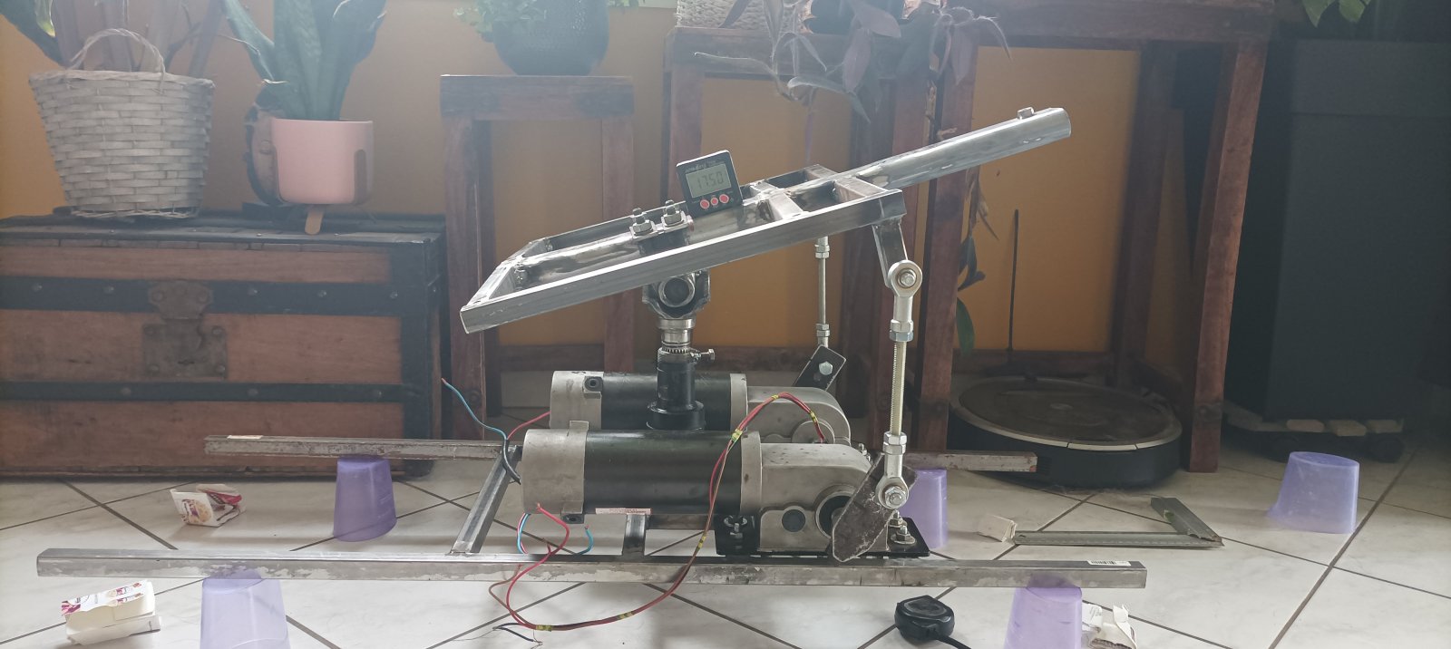

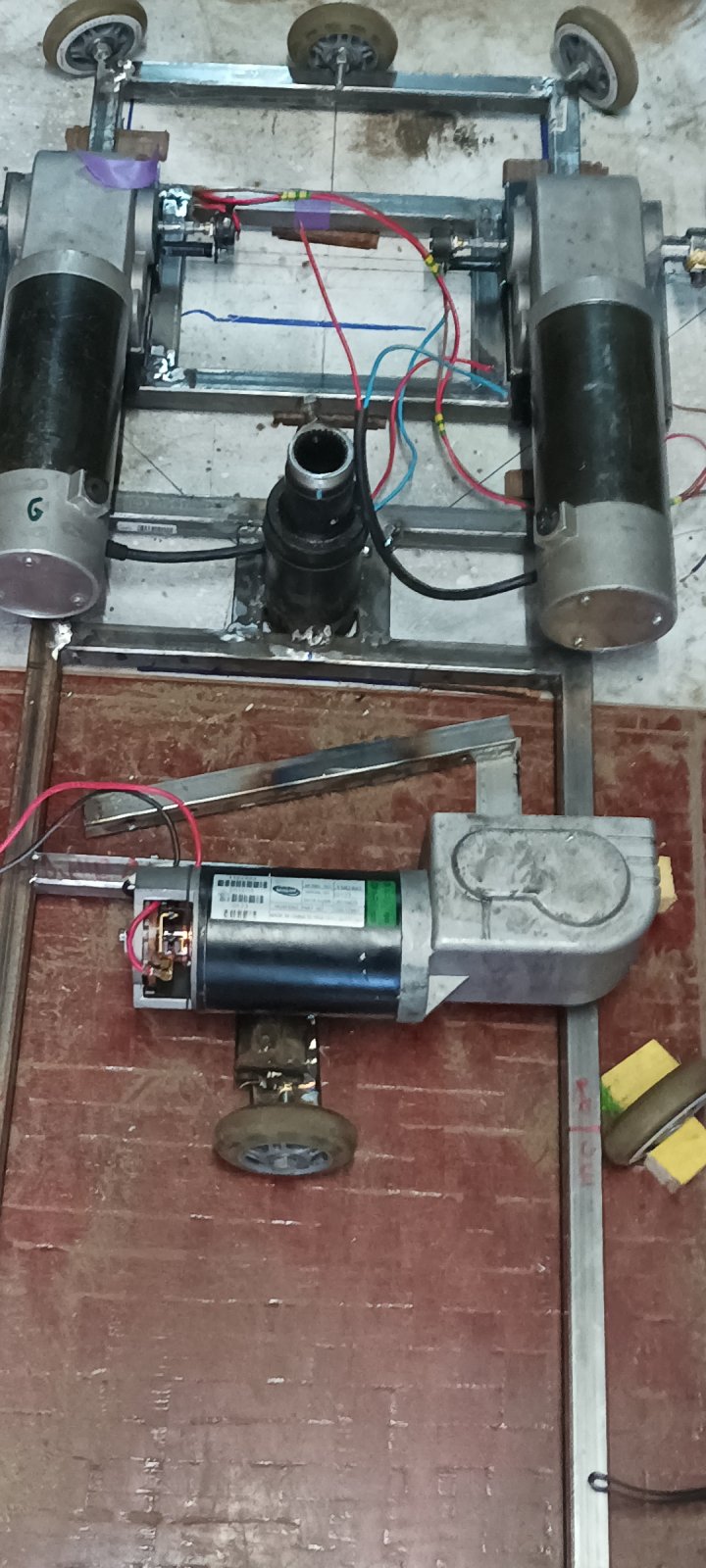

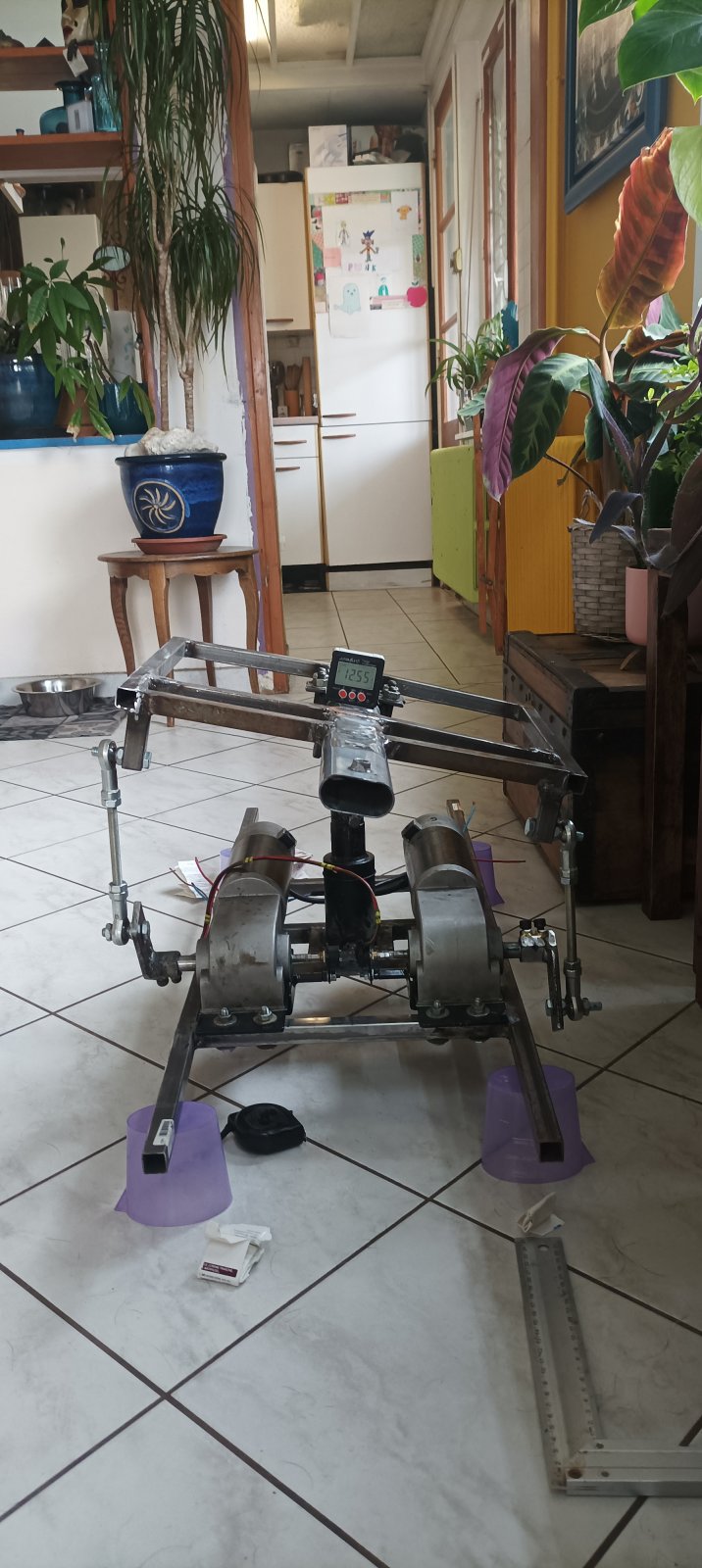

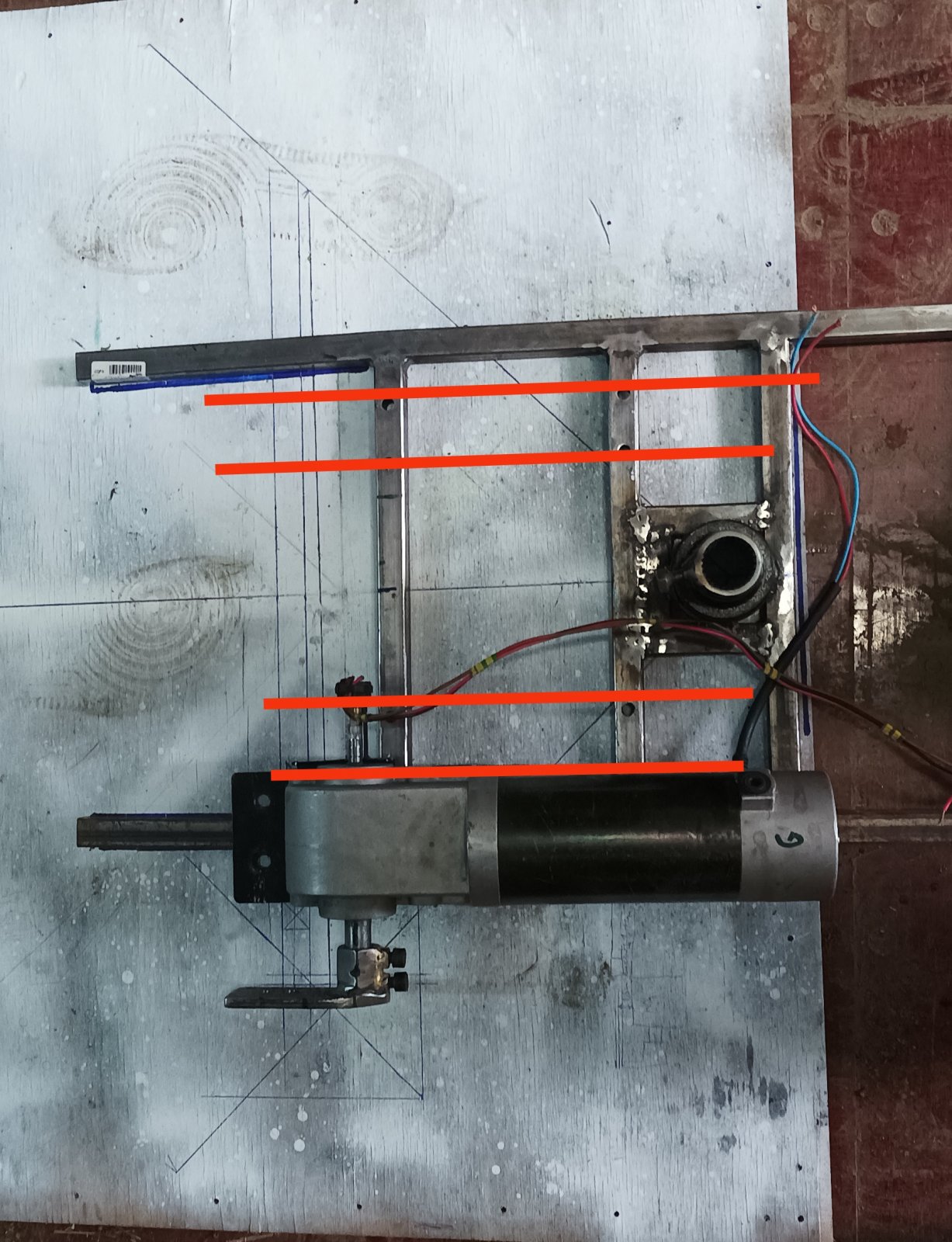

    hello
    after many modifications I can not say that it is finished because this type of project will always evolve but the simulator is functional.
    the engines (2dof) have been moved further from the gimbal (lever arm calculation error)
    the subframe (yaw) was manufactured
    and the 2 dof frame equipped with roller
    wheel and many reinforcements.

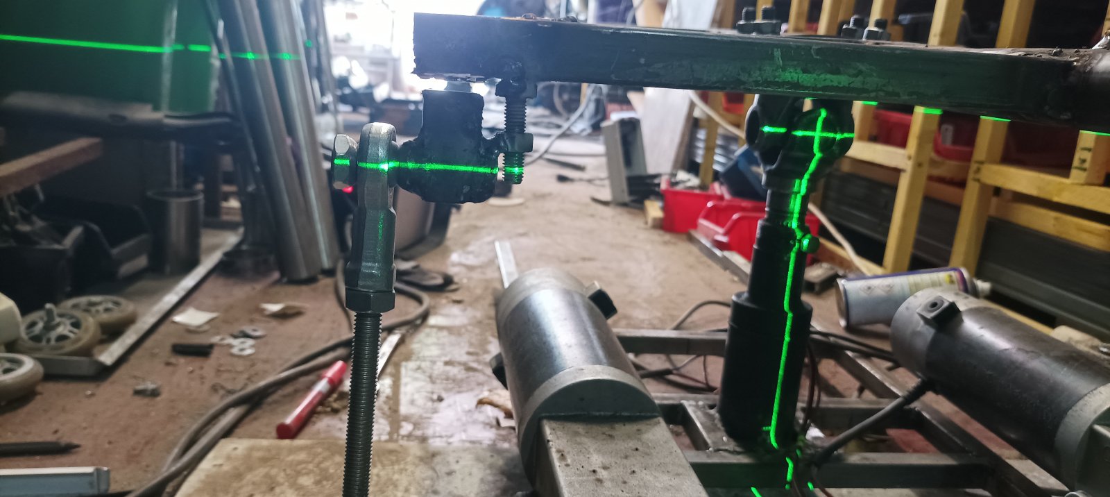

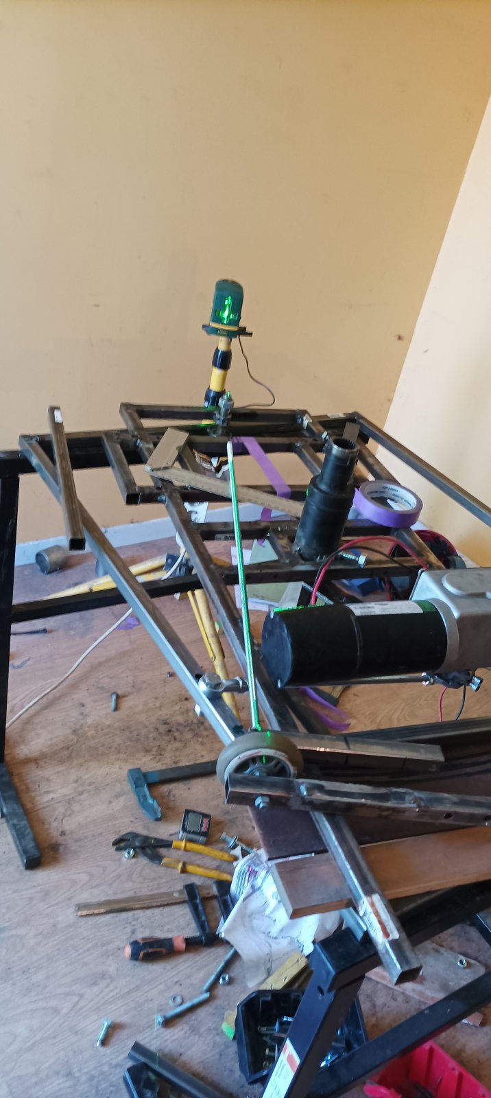

    a difficult point was the precise positioning of the upper connecting rod fixings for the 2 dof part which was welded and unsoldered many times before succeeding exactly in the right place in the 3 axes.
    I used a laser and filleting to position before welding.

    the bearing axle is adjustable in height to follow the wear of the wheels (lower frame) and not to put too much stress on the bearing

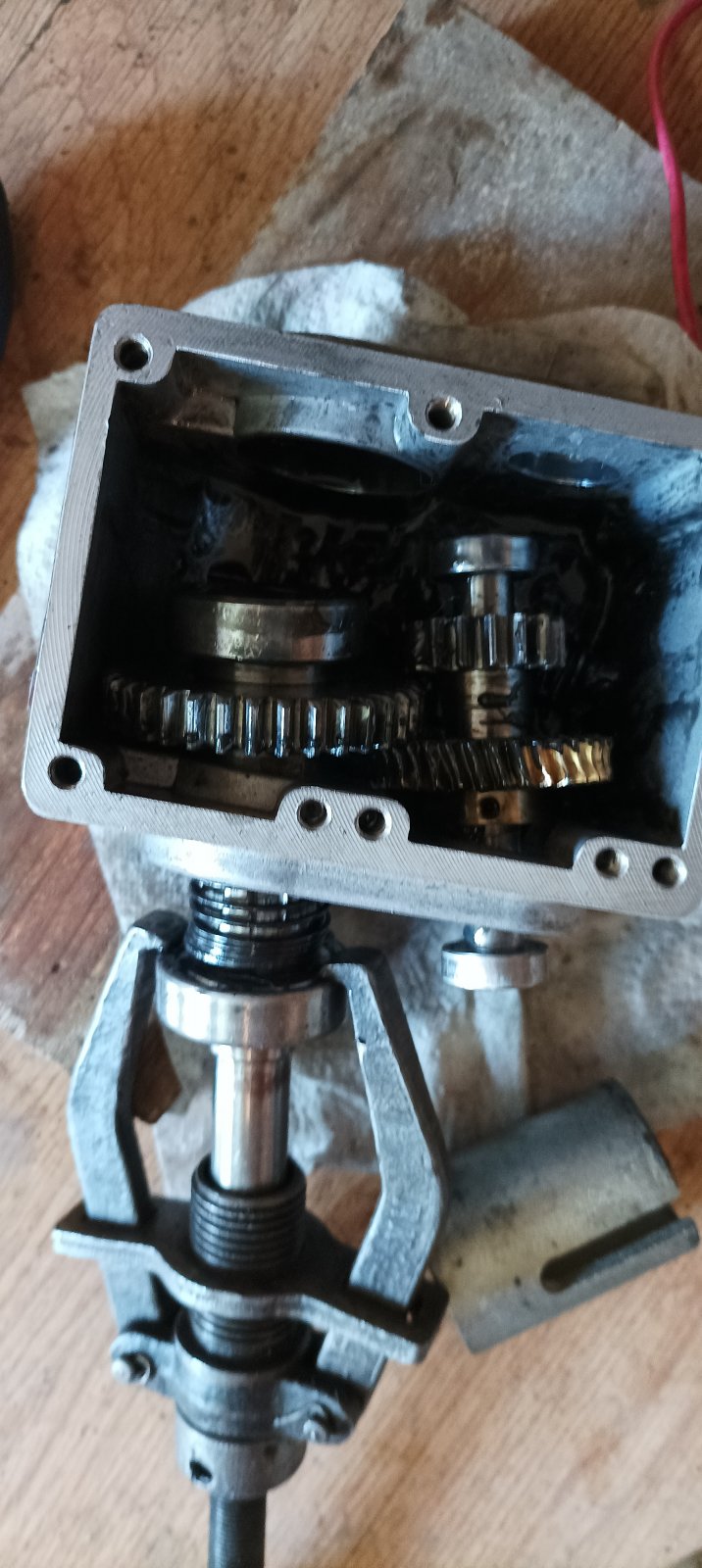

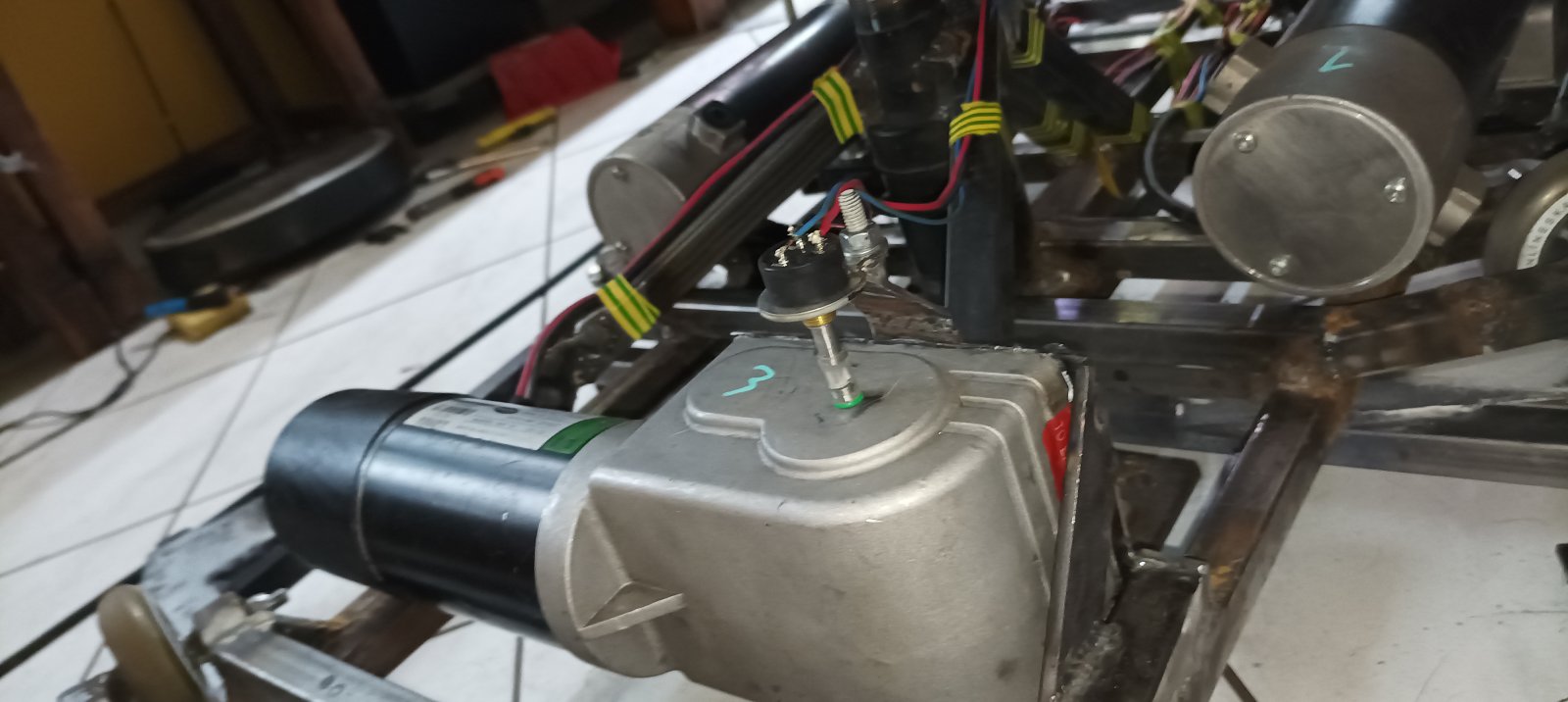

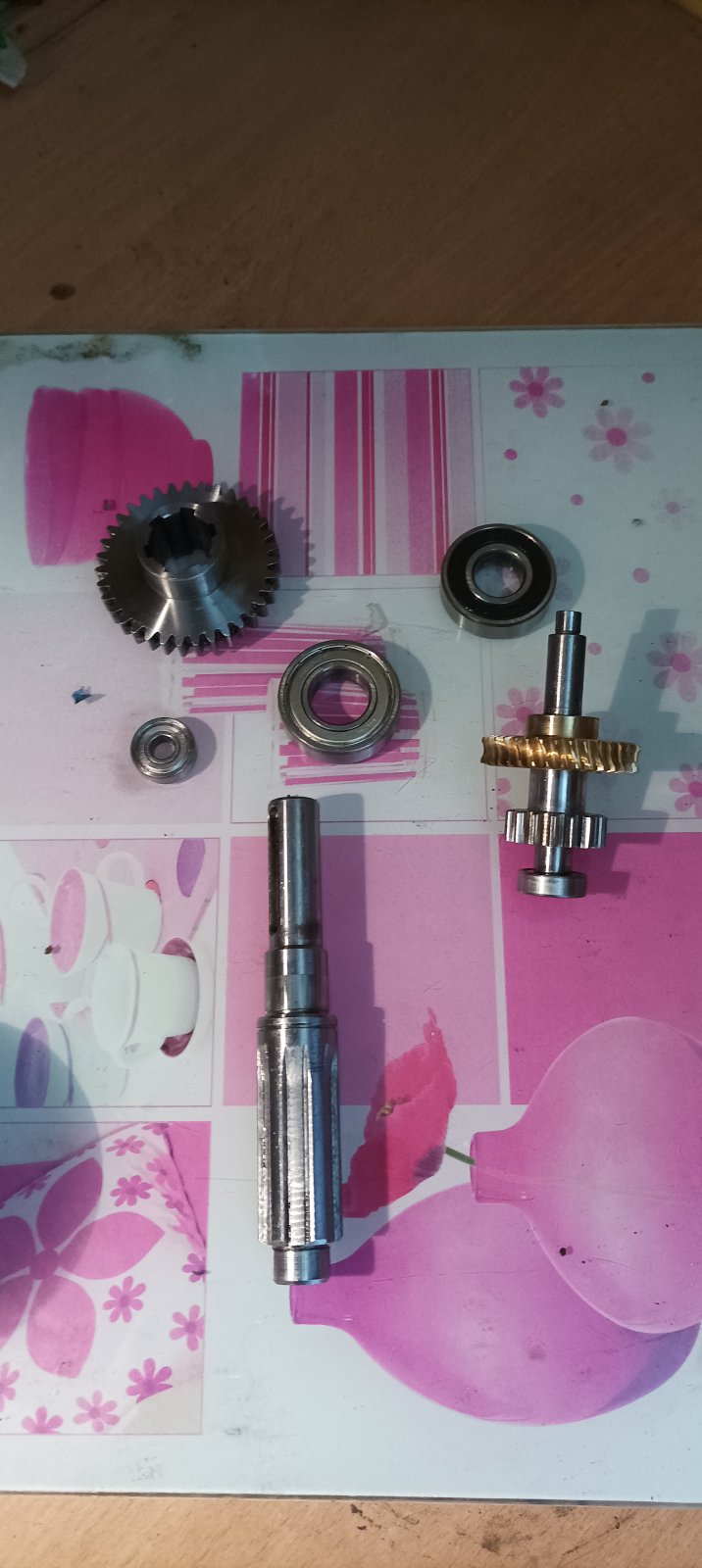

    the yaw motor had to be modified at the level of the axis also like the 2 dof to install the hall sensor.

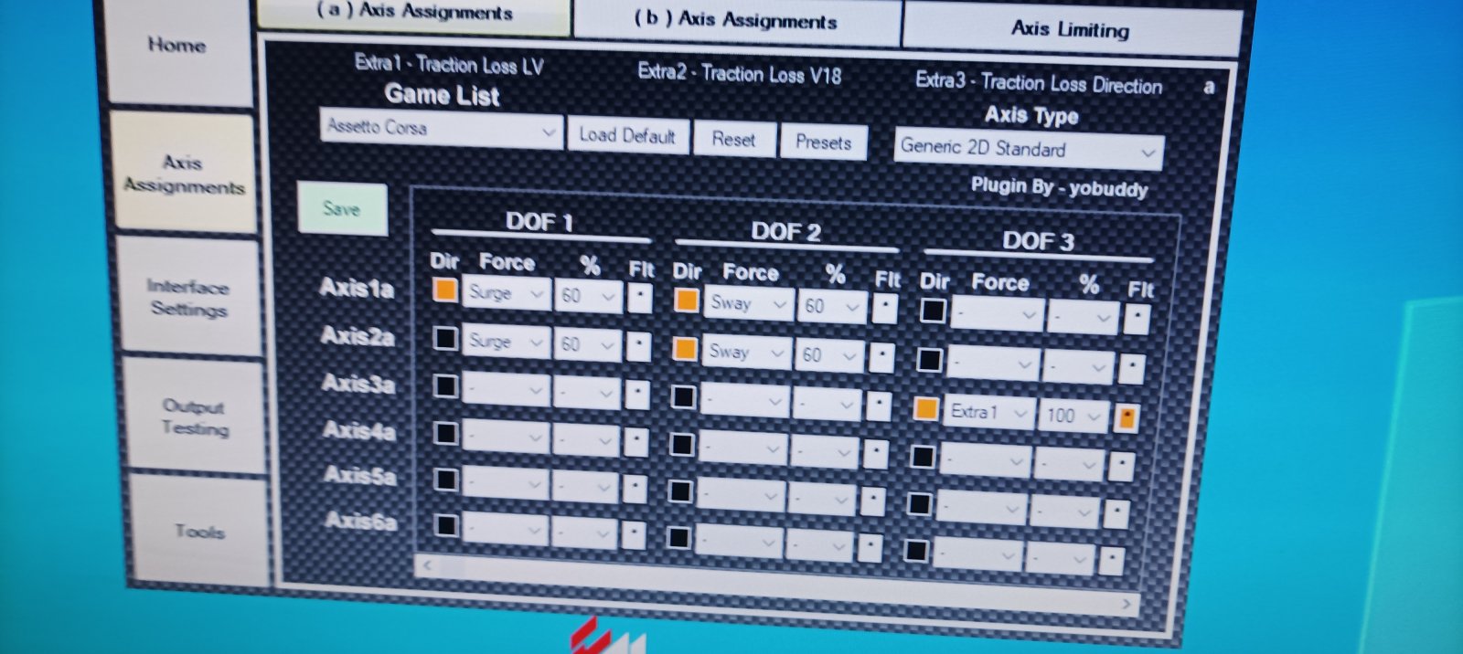

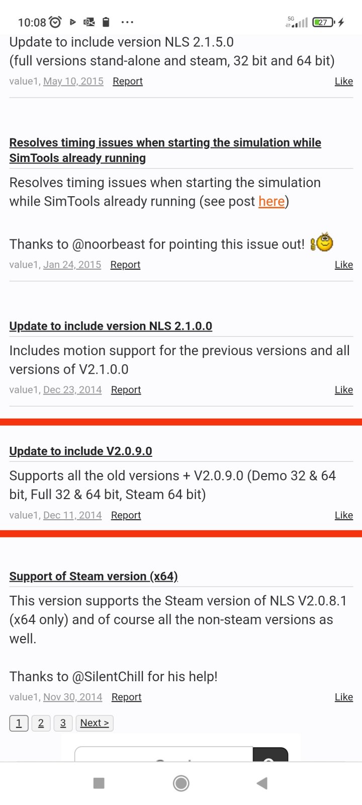

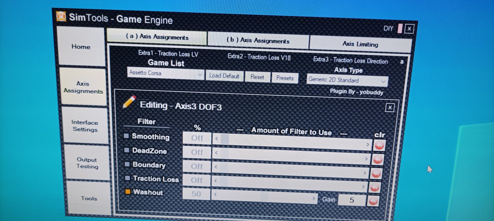

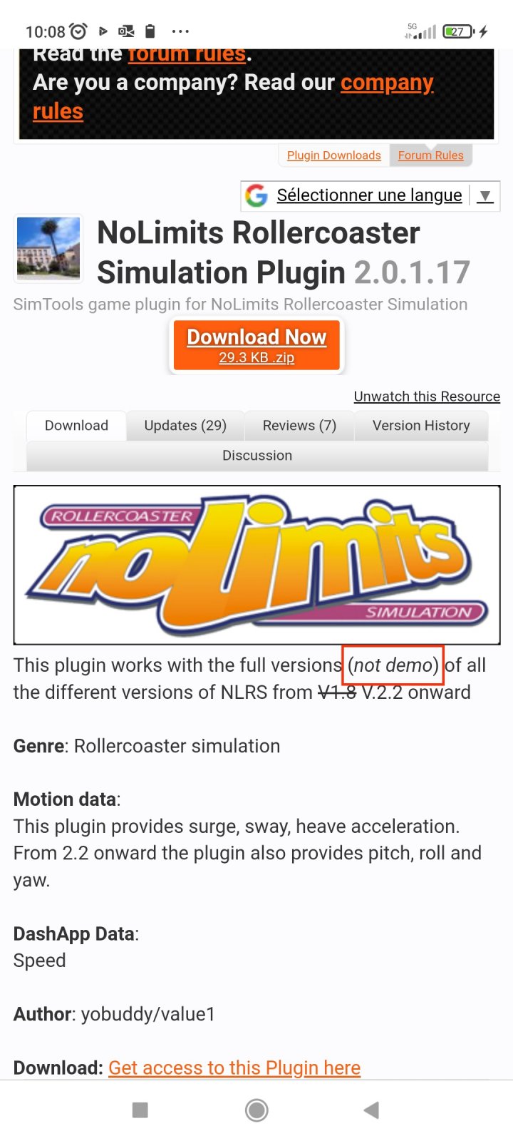

    hi
    i can't connect my simulator with nolimit
    it works with assetto and lfs.
    I patched well I tried Steam and not Steam (demo) I add --telemetry
    sim tool tells me that it is connected but no data input in tuning center and nothing moves.
    in the plugin it is written that 'it doesn't work with the demo but in the updates it says it works so I don't know.
    I followed the video of @Halloween2go but I don't no if it is full or demo
  13. noorbeast
    22,185
    154,750Coins
    +11,196 / 57 / -2
    NL2 requires the telemetry flag plus as far as I am aware the full version: https://www.xsimulator.net/community/faq/no-limits-2-v2-2-and-higher-how-to-activate-telemetry.198/
  14. Jordan Casalini
    Jordan Casalini Member
    Apr 22, 2022
    57
    145Coins
    +18 / 0 / -0
    Thank you very much
    it was just out of curiosity to see the reactions of the simulator.
    I mainly use assetto corsa only in drift
    I spent hours trying different settings following the simtool instructions.
    the min max capture step with a middle power m3 E30 drift (original assetto) as reduced the sway and surge axes enormously, it did not move anymore.
    So i left the original parameters.
    From the start, I was focusing on power and torque of motor because I read that the more there were, the better it would be.
    But finally already in 12v it was too brutal I had to lower pwmmax in smc3 from 255 to 120 to obtain softer, "realistic" movements.
    I wonder what would be the point of using their full power at 24v?
    traction lost effect works great in the output testing (if I move yaw it comes back to the center slowly).
    but in the game it does not come back but just makes the return changing direction (too) faster.
    and for wash out it produces a very strange effect at 5km/h if I turn the steering wheel yaw moves in depending on the steering wheel direction...
    i tried all sorts of % but the most "realistic" result remains to decrease the power of the motors 2 dof with a compromise between losing responsiveness and gaining smoothness and for yaw no effect.

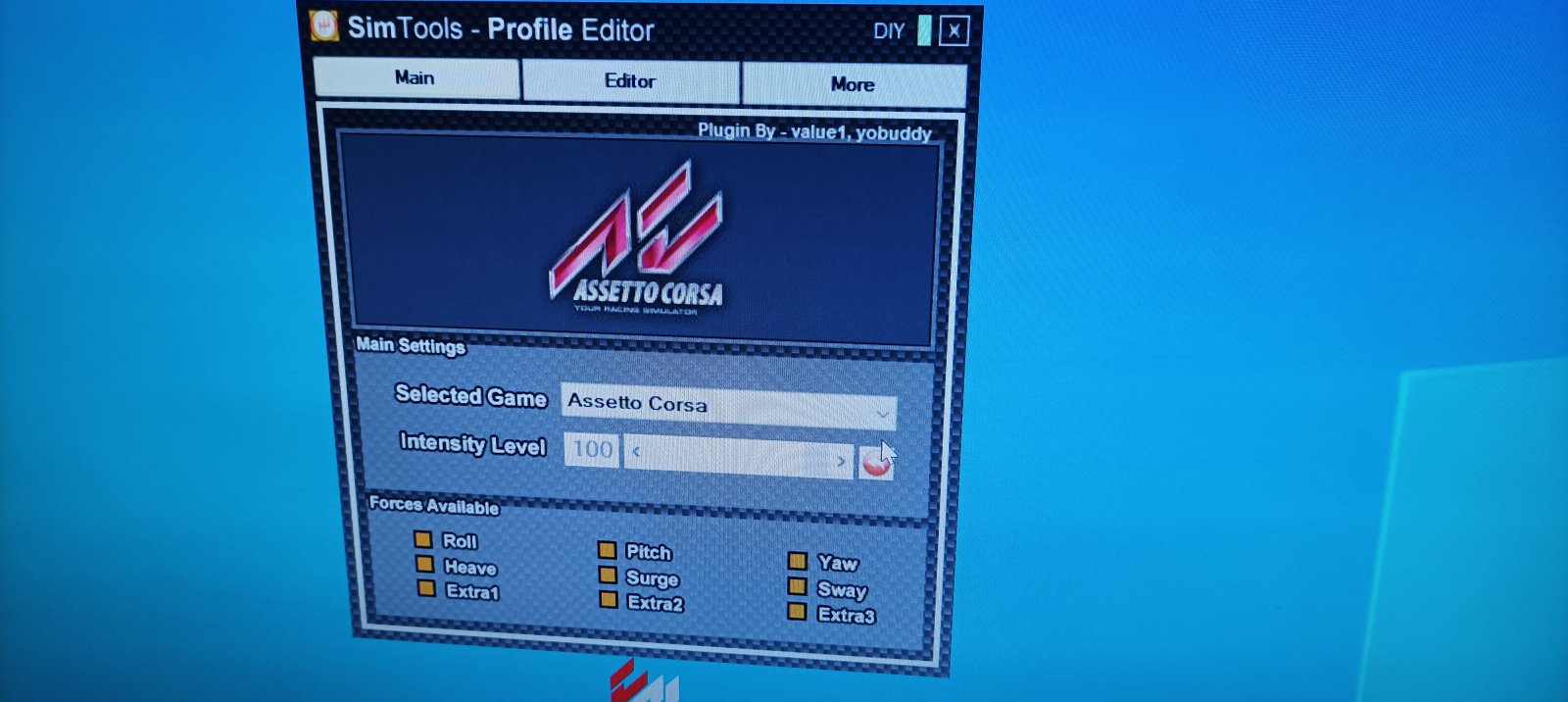

    have you noticed any differences between testing an effect in simtool and in games like me with assetto or another game?

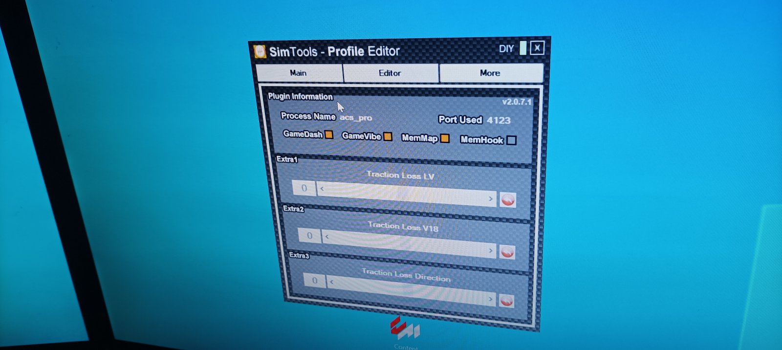

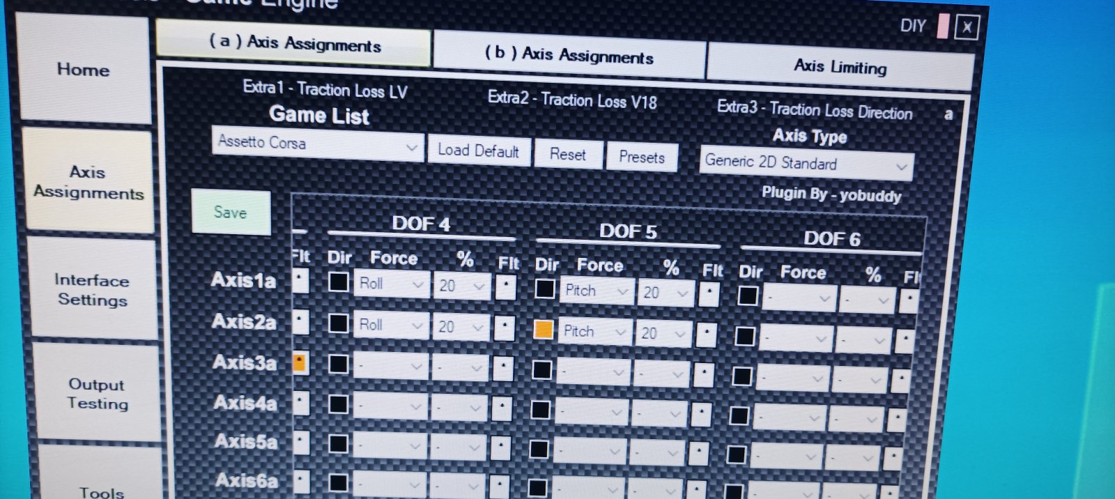

    I tried again with extra1
    I get the same result
    I did other tests washout causes a return to the center in the game but it does not vary with the angle so it amounts to no effect except that it takes less angle
    https://youtube.com/shorts/Ndi03s-k9tU?feature=share
    and gain if I exceed 1% even 5% the loss of traction starts when turning the steering wheel

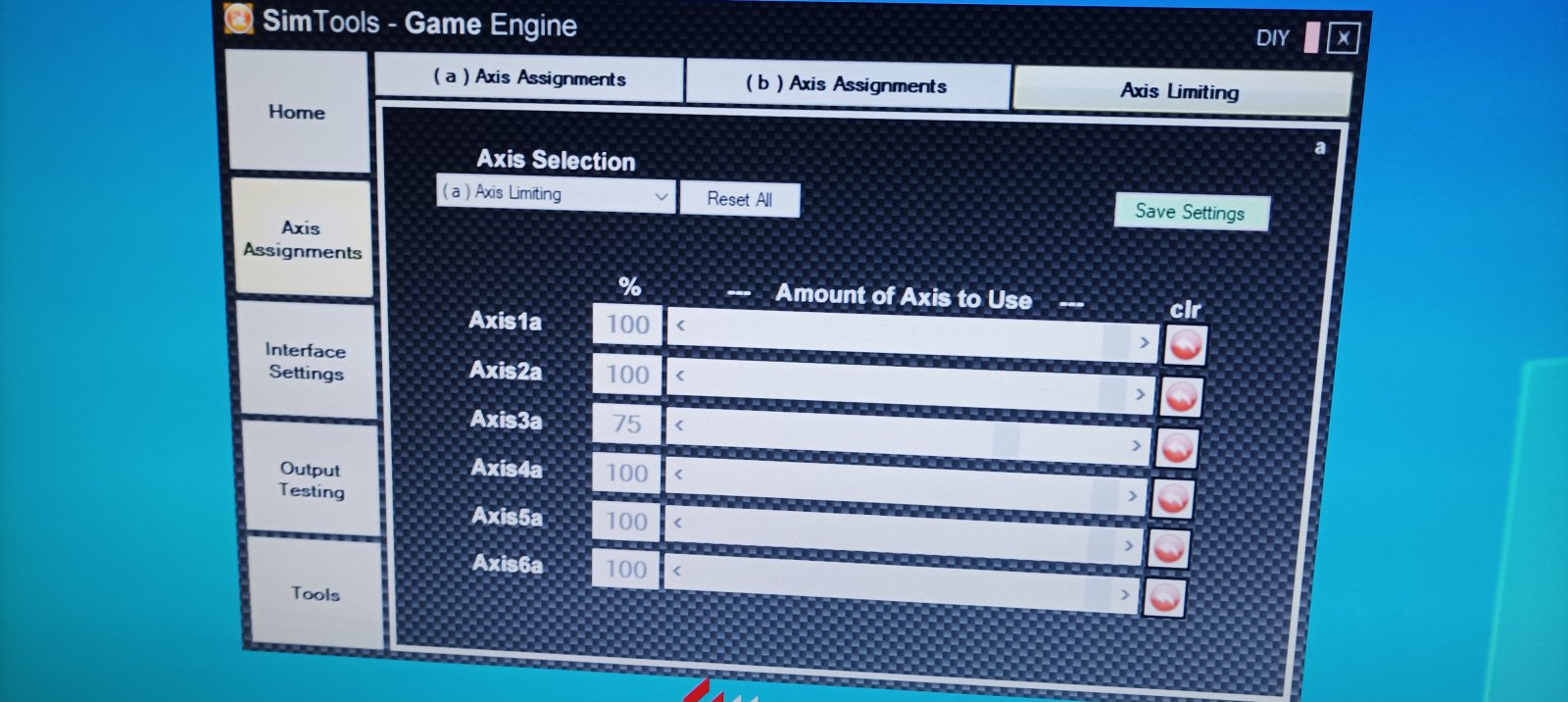

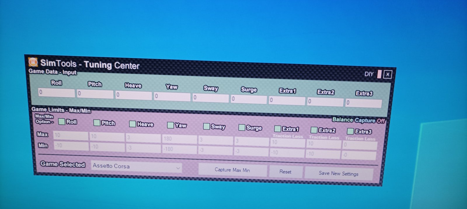

  18. noorbeast
    22,185
    154,750Coins
    +11,196 / 57 / -2

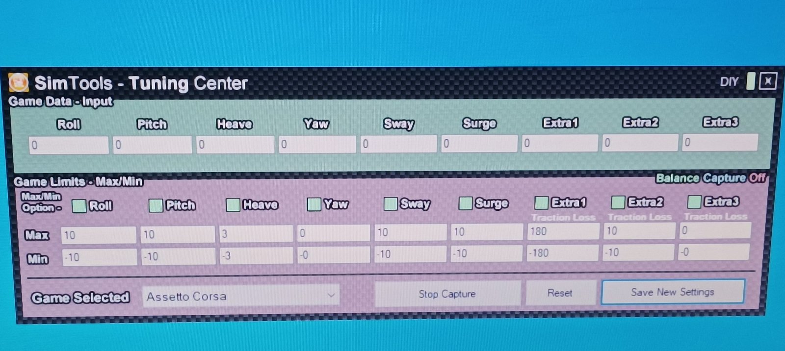

    Please post pictures of all of your settings, in Game Engine, Game Manager and Tuning Center.
  19. Jordan Casalini
    Apr 22, 2022
    57
    145Coins
    +18 / 0 / -0
  20. Jordan Casalini
    Apr 22, 2022
    57
    145Coins
    +18 / 0 / -0
    I modified tuning center manually
    now I can use gain without having a bug
